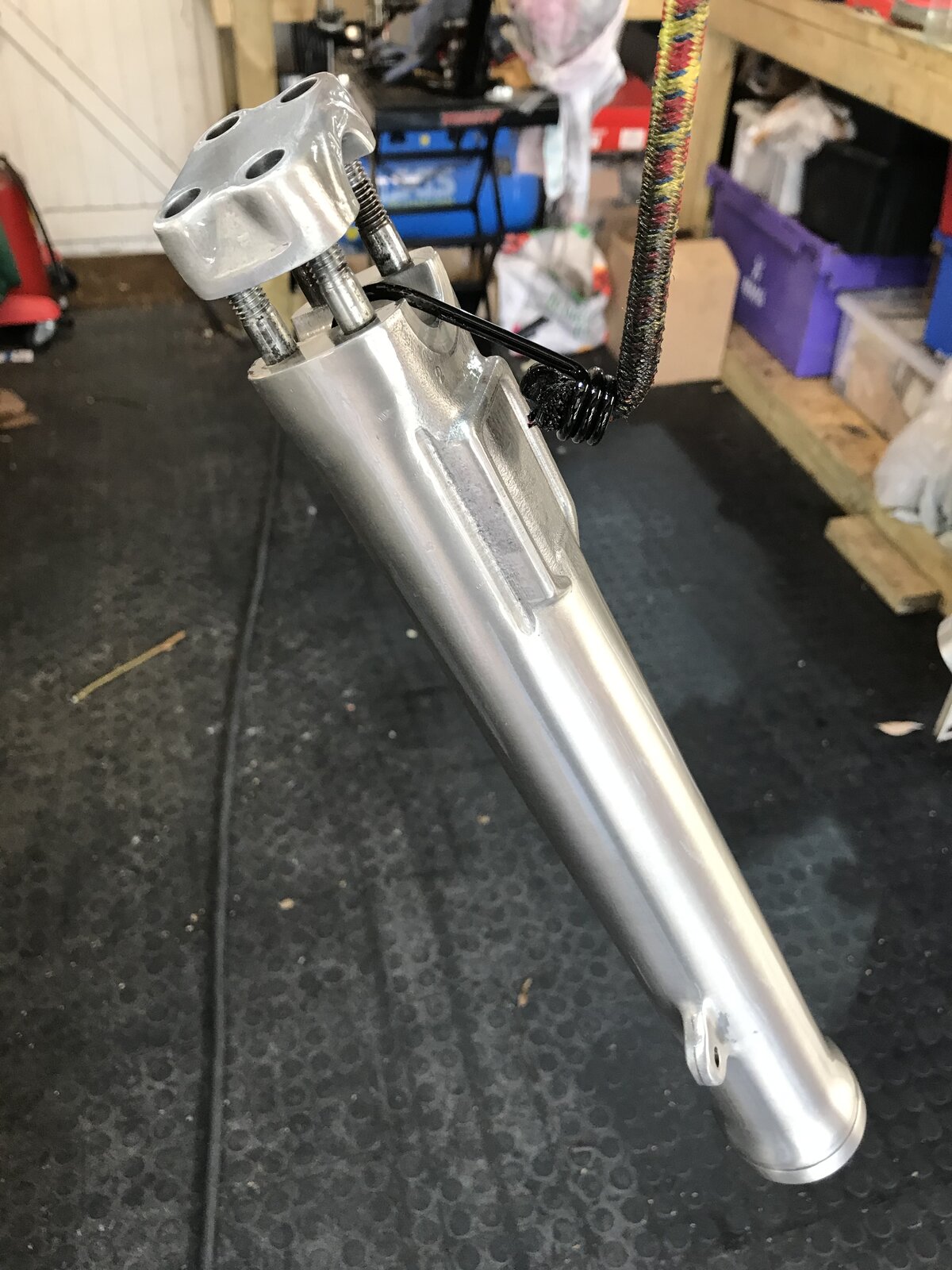

  5. Clearcoat over the polished or , more accurately, brushed aluminium was the OEM finish I believe
    Same as the fork lowers here
  6. How to you get to a brushed alloy finish? is that the beadblast..?
  7. Hand finished with scotchbrite in one direction after sanding out the nicks. Takes a couple of hours per leg

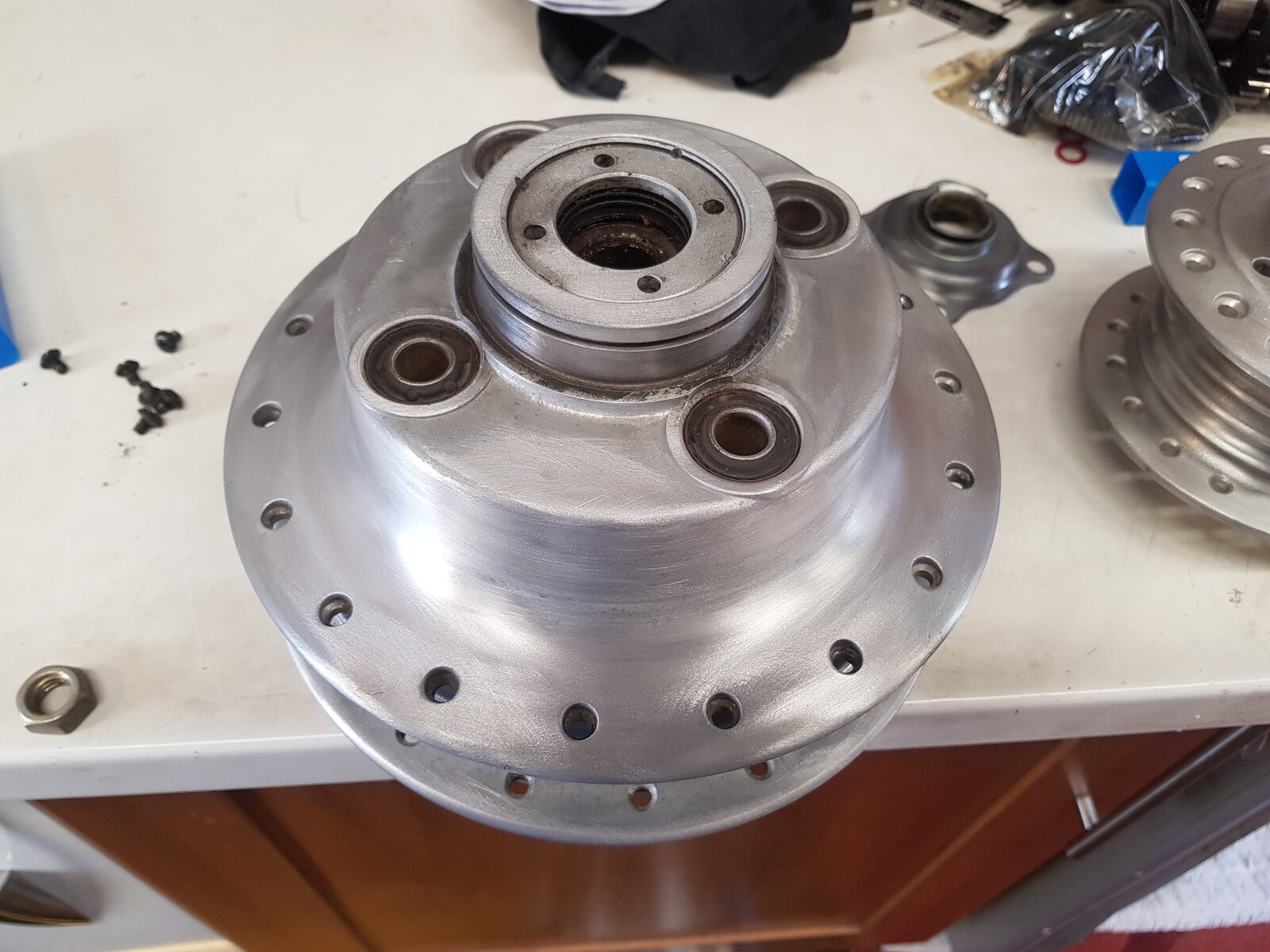

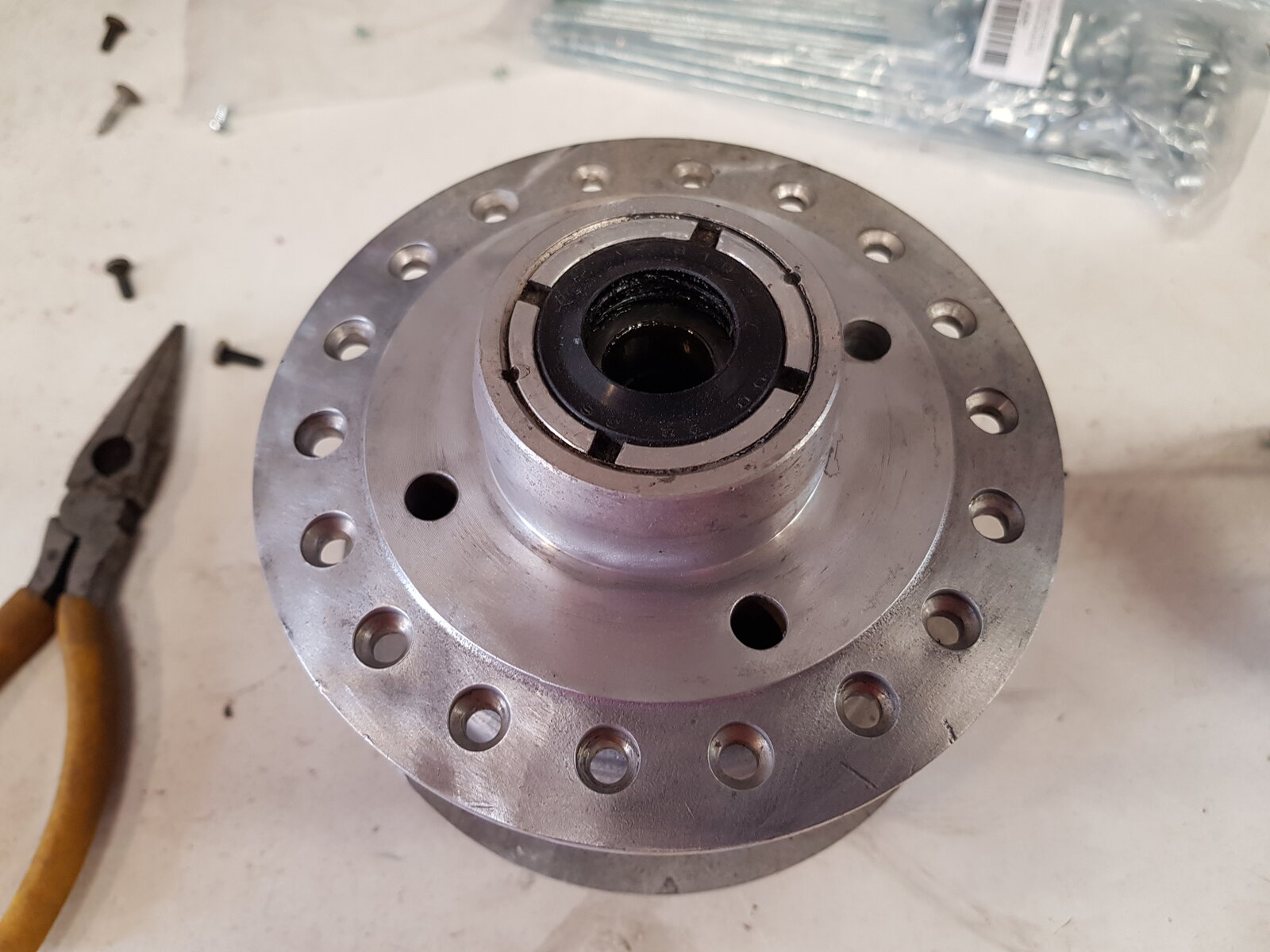

  14. 20200607_121452.jpg 20200607_121452.jpg Rather than sitting around talking about it im now in the garage.....

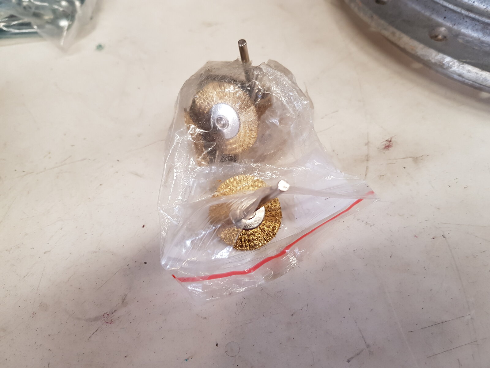

    Had some small plastic scouring wheels for the dremmel......so making a start ive trashed 4 wheels and got under half the surface of the hub looking remotely tidy....just a question - do you go through them that fast?
    Also - my grinder looks like it can take a 6" scotchbrite wheel which seems to me to be more productive...
    Also ive got some small brass dremmel bits....too harsh or no?
  15. Dremel wheels don’t last 5 minutes with that sort of use CS, tiny surface area and big revs, much better to get wheels for you bench grinder.
    Try the brass wheels on a small area but they won’t last long and will probably scratch.
  16. I did try the brass wheels on the centre no they dont scratch but, as you say small surface area so ive not bothered any more....just ordered a burgundy coloured 6" wheel for the big grinder....

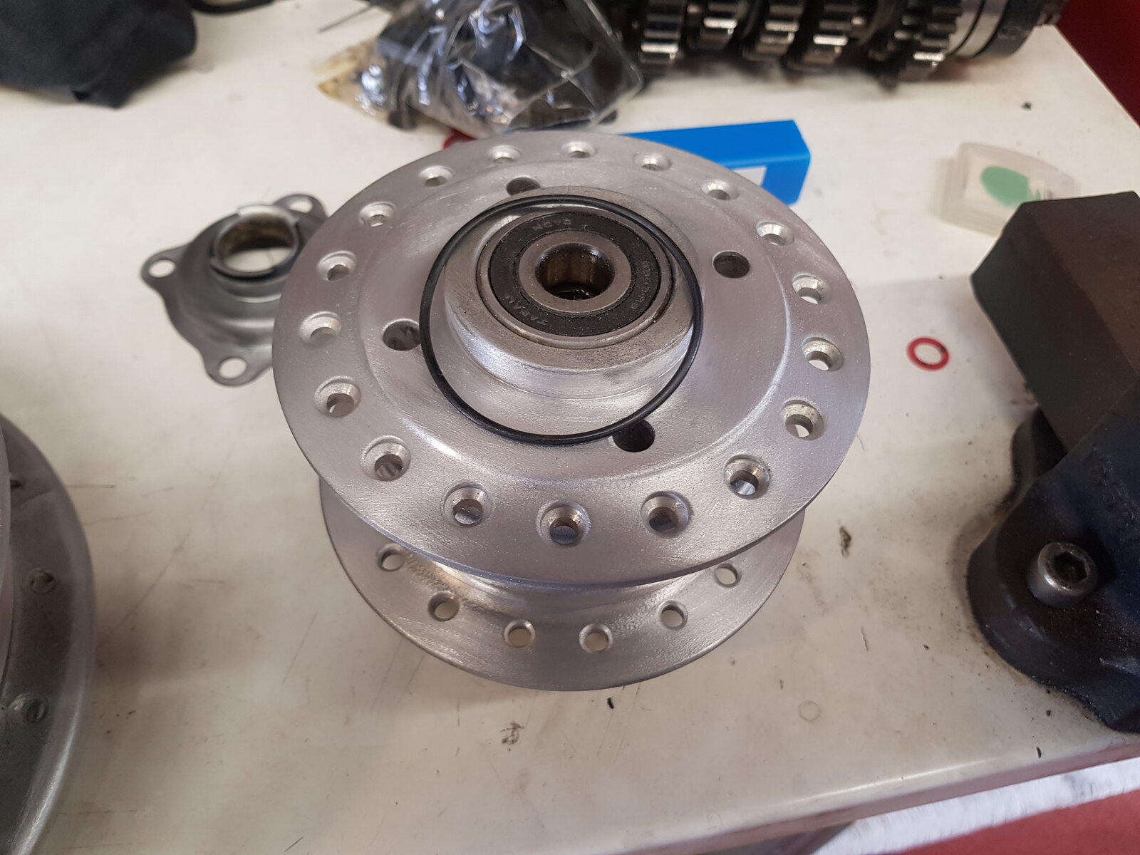

  17. My first time scotchbriting....need more wheels but initially pleased with the initial coarse wheel...
  18. The brass strands all fall out and get in your clothes too. So when you use them, make sure you brush up the floor before you kneel down, as these are instant brass splinters & literally a pain...
  19. Thanks Jez - not gonna use the brass - too abrasive...tried it on a small part of the larger hub.....scotchbrite seems to be the way forward....looking for different wheels now...

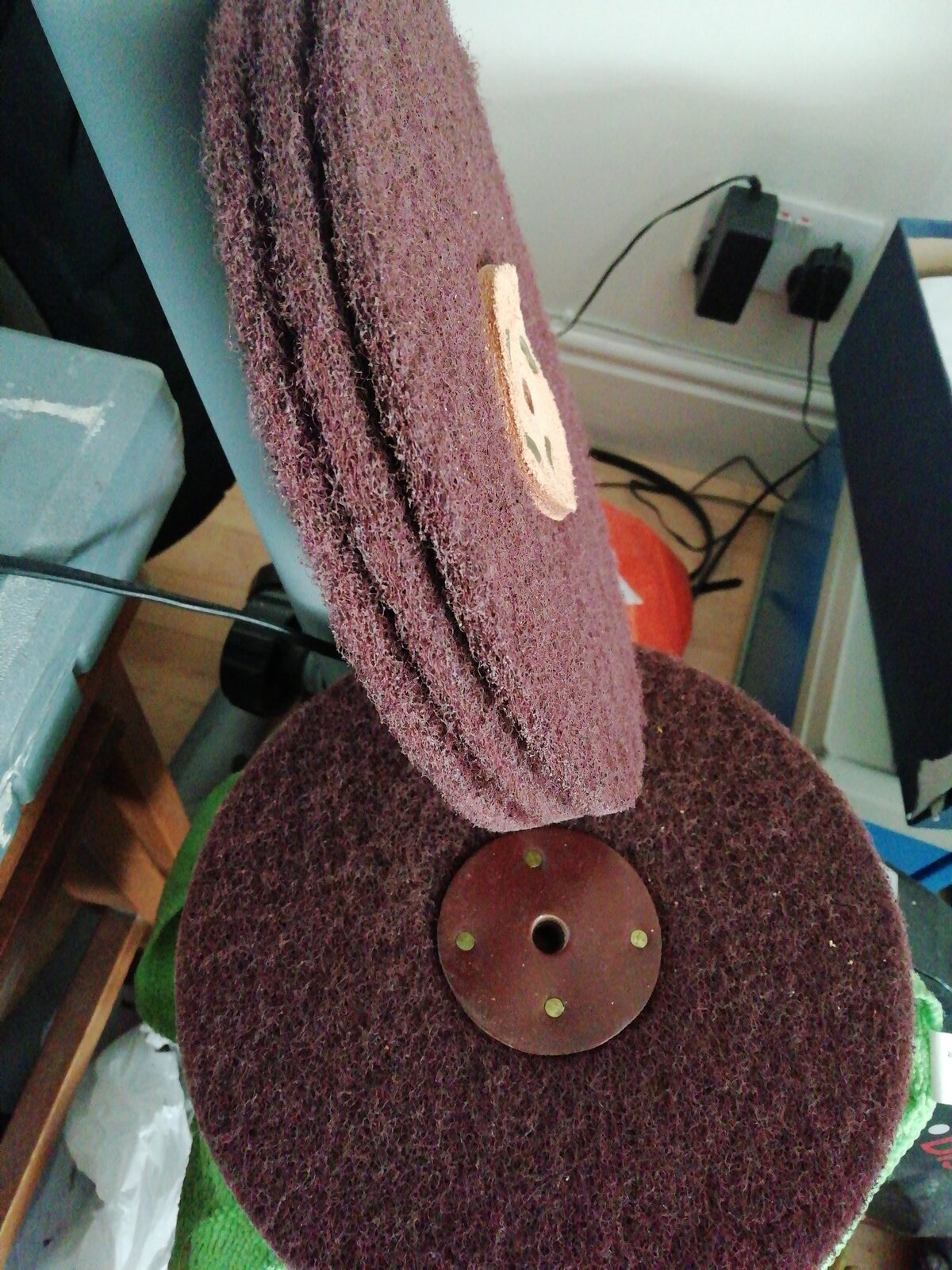

  20. www.thepolishingshop.co.uk
    Look at satin mops, basically scotchbrite wheels in different grades and diameters that fit on
    A taper adaptor for drills or grinders.
    15926742994477462384250571372662.jpg These are 8 inch, think they were about £3 each. Very quick and easy for cleaning ally.
