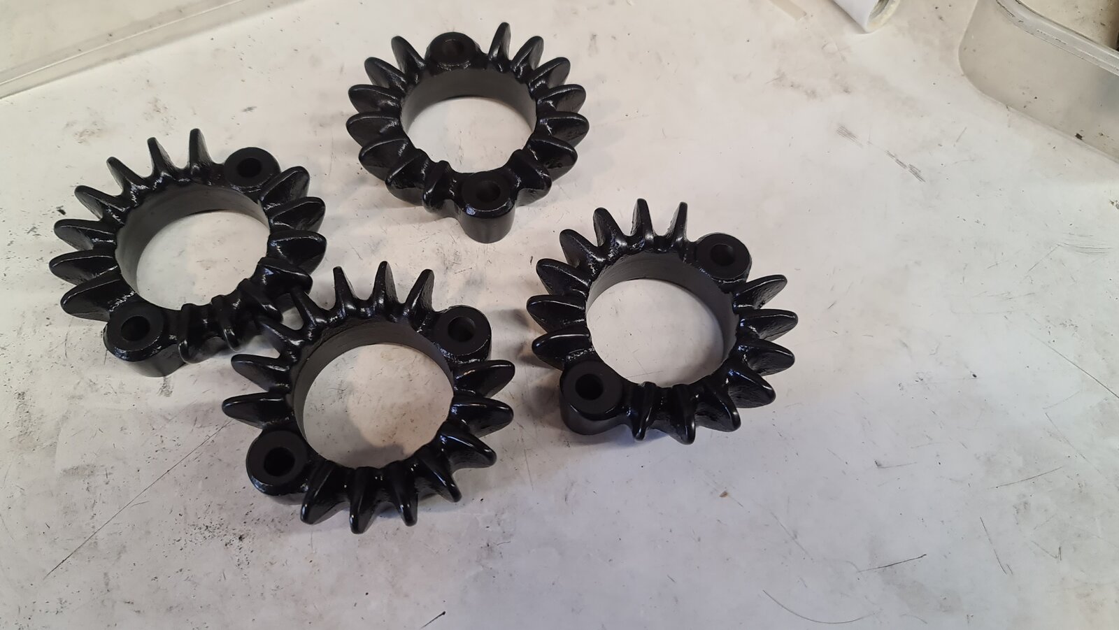

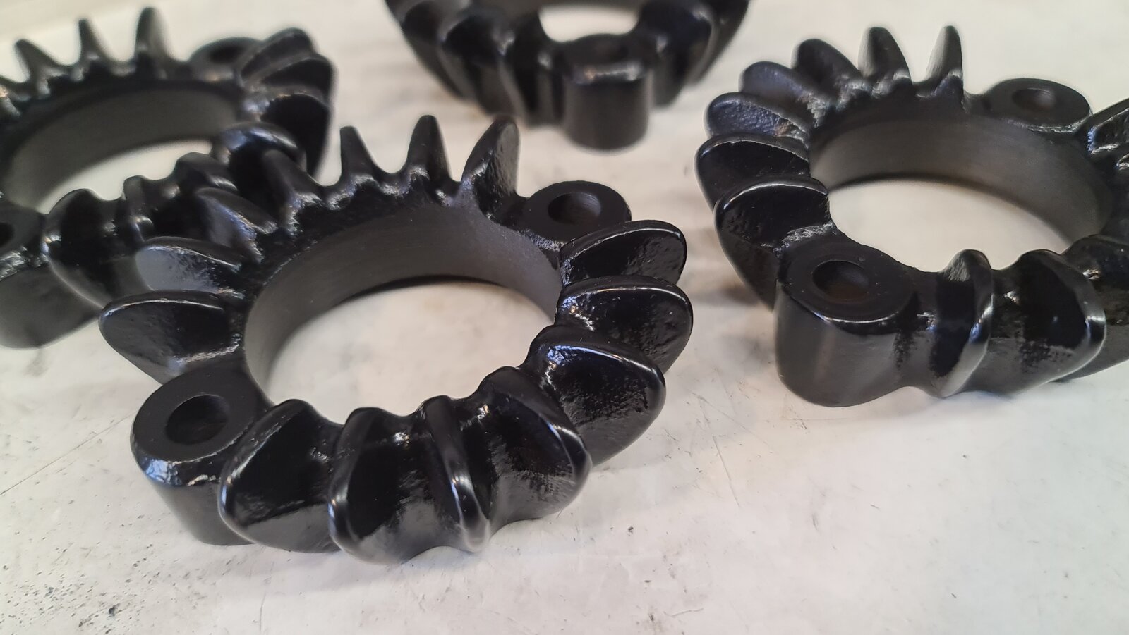

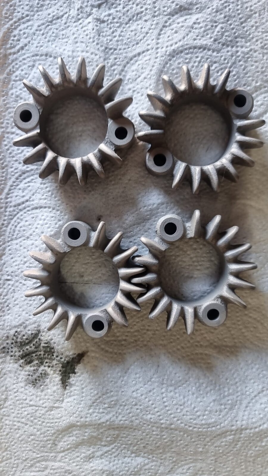

  1. Exhaust collars off for cerakoting....hopefully back by the weekend, then should be able to get the exhaust on....Ill be waiting on the carbs after that....then its on to wiring...
  2. Collars blasted - should be collecting tomorrow getting coated in gloss black...thought it might look nice inbetween the beadblasted engine and the stainless exhaust...

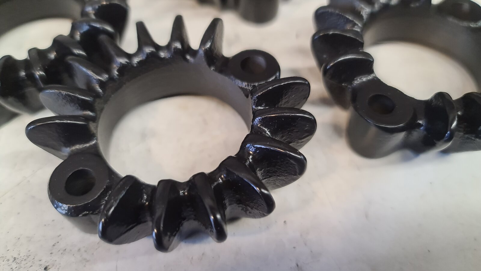

  3. And coated....
  4. No, deliberately to split up the engine from the exhausts.....thought it'd look nice...
  5. It will look great. I was wondering if you had seen the chrome version in the flesh (or on the metal) and decided against for some reason. I'm thinking that I may get my down piles down with it to stop any corrosion, whilst maintaining a similar look.
  6. Yeah - ive seen the stock look...obviously thats how it was....the other factory was the cost of Chrome plating....for those 4 collars they wants upwards of 150....

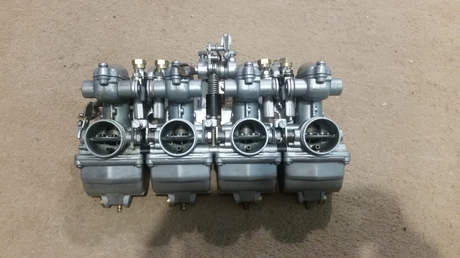

    Both of them look quite surprised.!
    #388 comfysofa, Oct 7, 2022

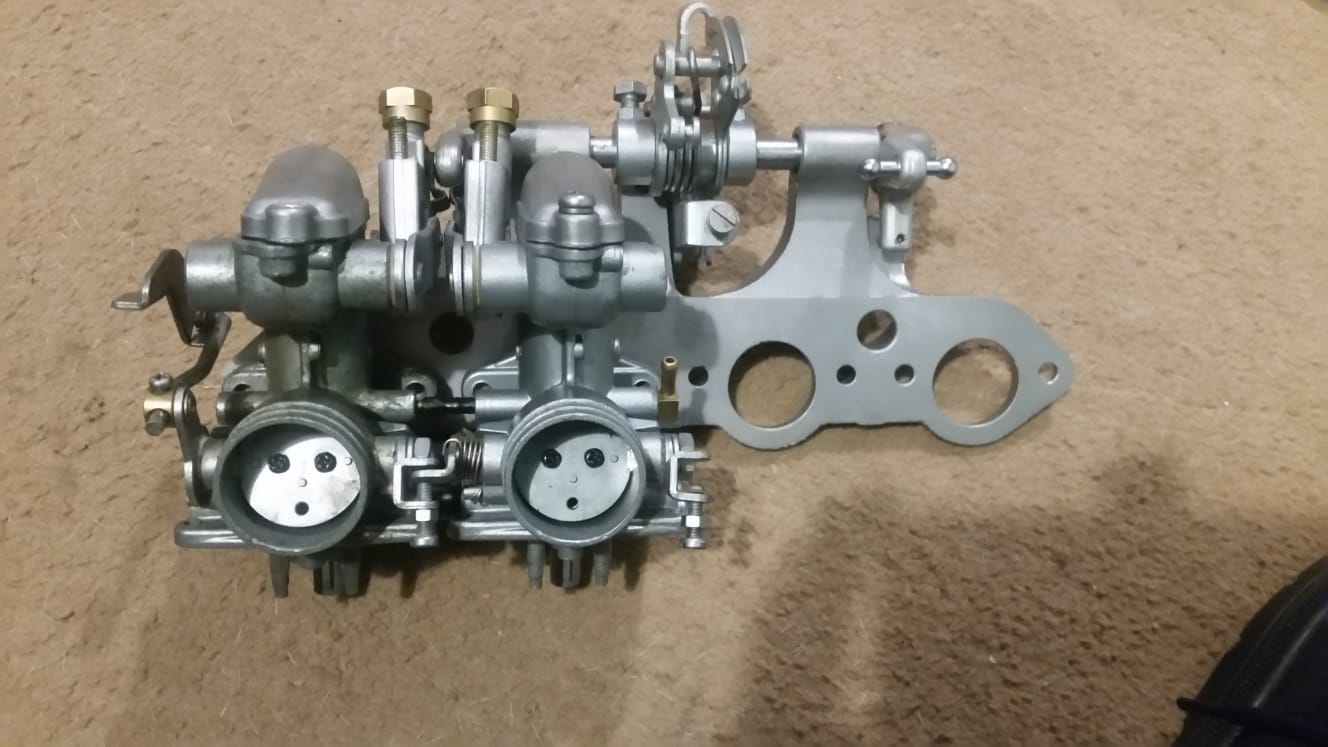

  8. Carbs now rebuilt.
    Hopefully ill be able to pick them up this weekend. Assuming i can that should pretty well complete the mechanical part - then im on to wiring. End of the month ill get the motogadget MUnit and wiring on order.

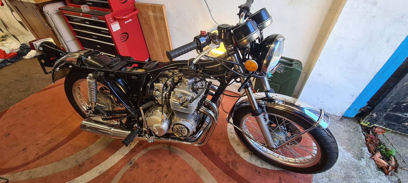

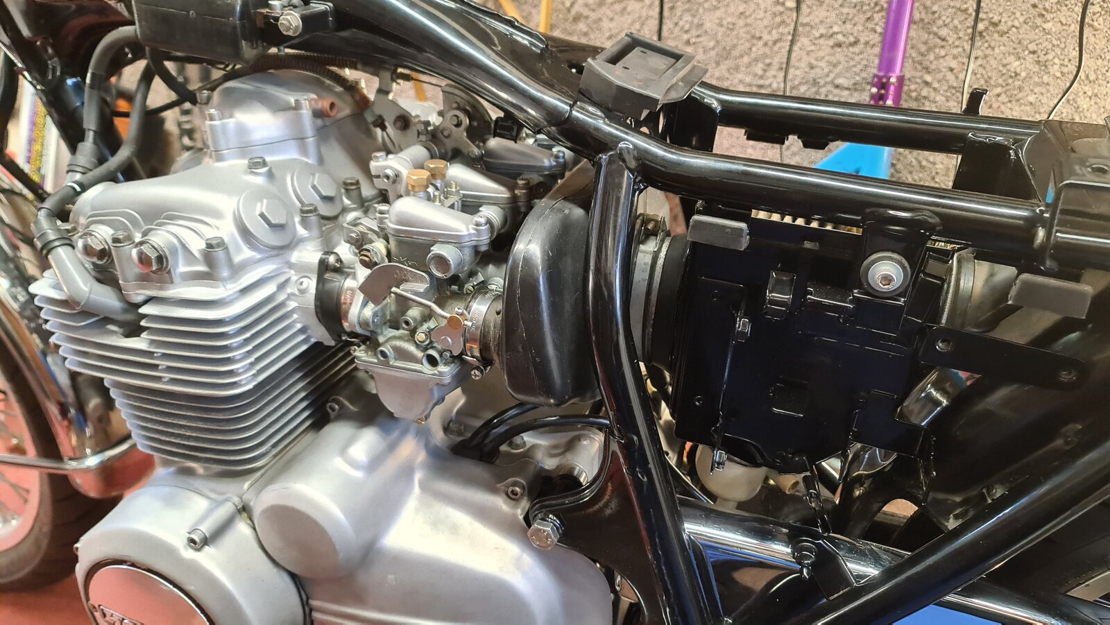

  9. More work completed....carbs on along with airbox. Throttle cables fitted also.

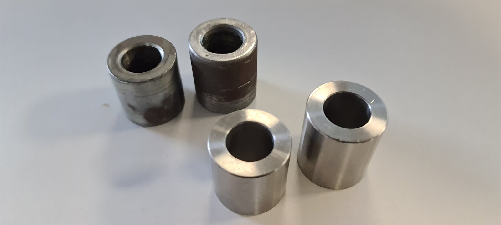

  11. Well, its a bit of 2 steps forward 3 steps back thing.....back wheel has to come apart again as the oem spacers are mild steel so im in the middle of getting some Stainless ones turned out...
  12. As above: Wheel now out and spacers in the post for Stainless equivalents.
  13. Rear wheel spacers took a while but they're back....

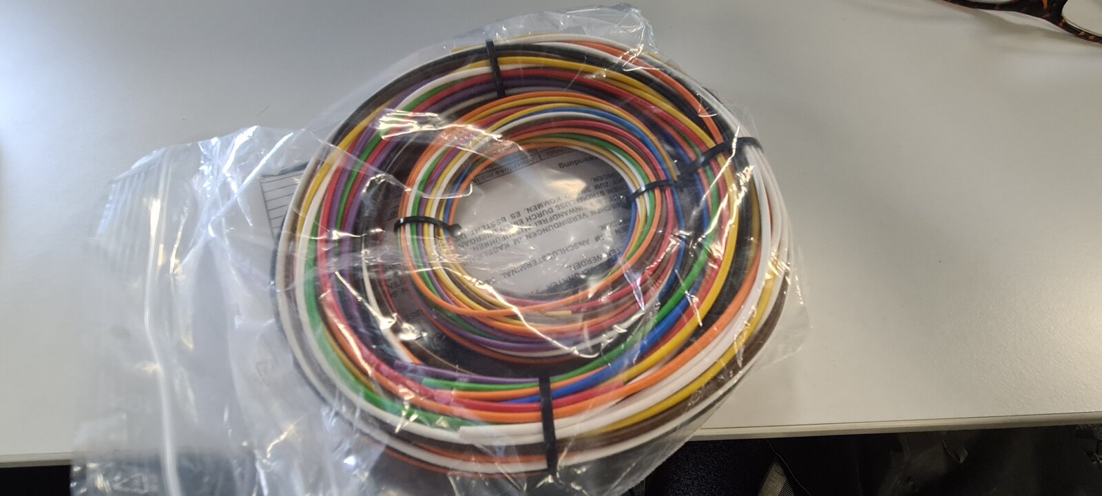

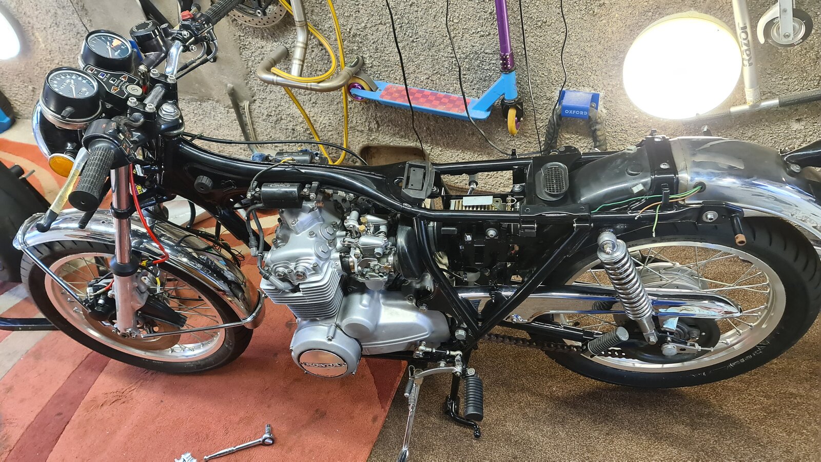

  14. Getting ready for the next stage....wiring... 20221102_124106.jpg 20221102_124052.jpg

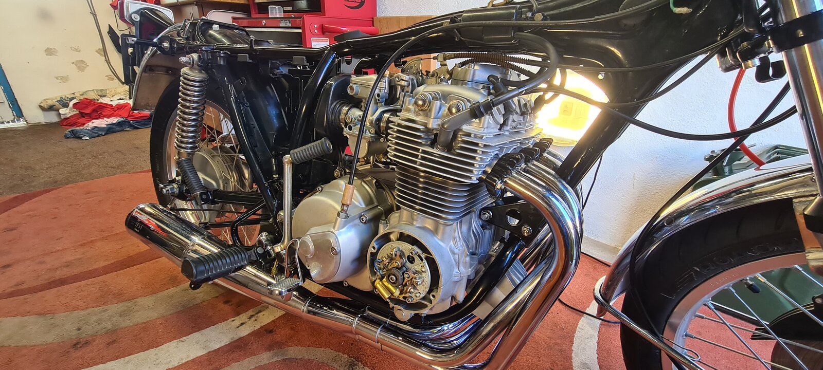

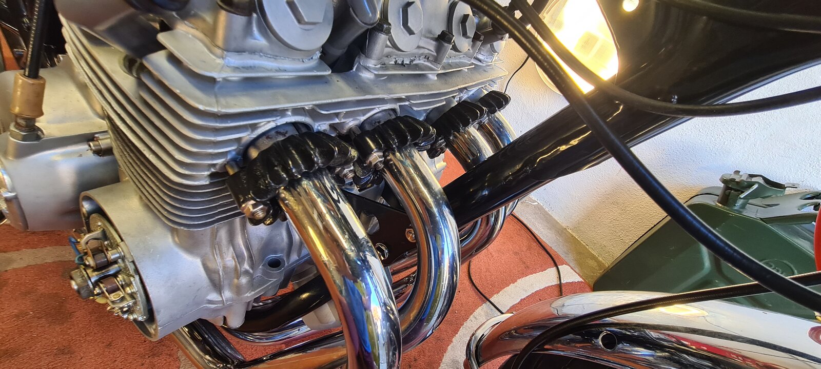

  19. Exhaust fitted. Plugs and caps on...got some more electrical stuff to source before I start the wiring...I think the cerakoted exhaust collars look pretty good...
