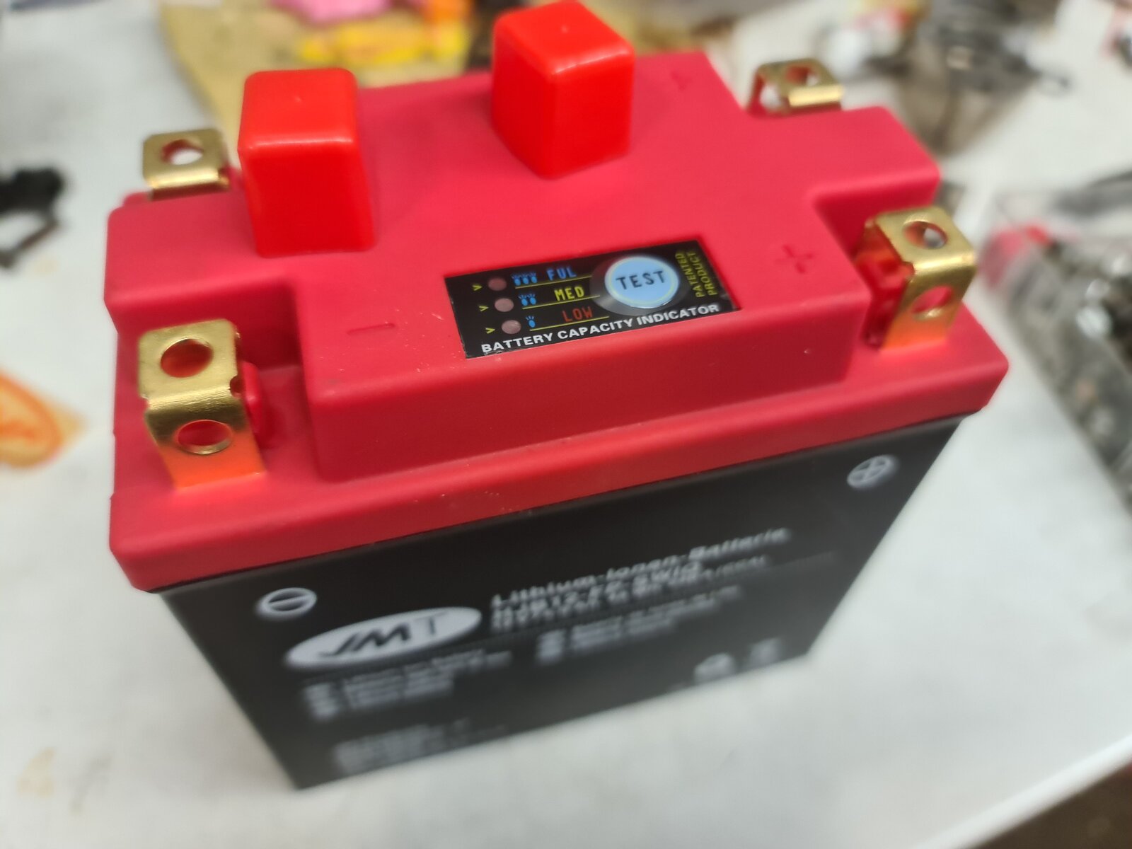

  3. Not much has happened recently... Mainly for the reason I've been amassing electrical parts for the build of the loom... Just received the battery... Now a lithium battery is a lithium battery but this one arrived with 4 point which I thought was worth the photo... Never seen that before... Just got connectors to wait for now... 20221231_120021.jpg

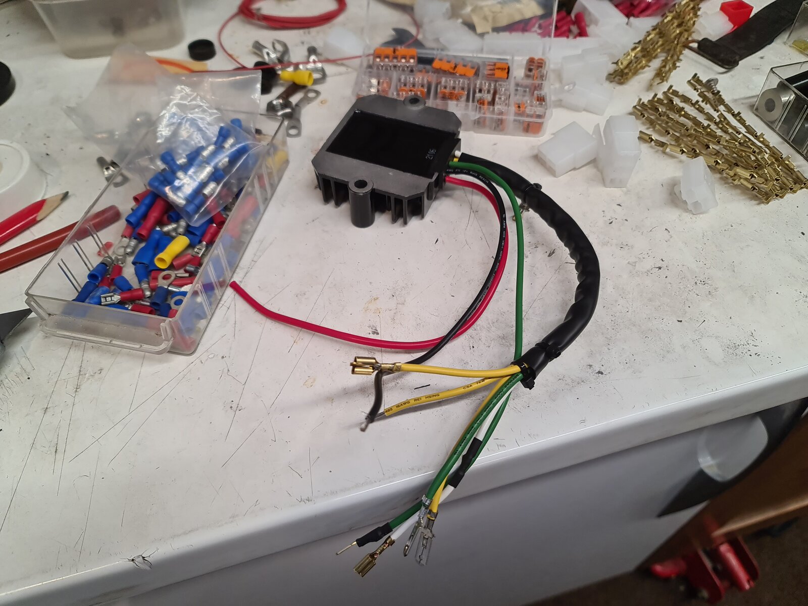

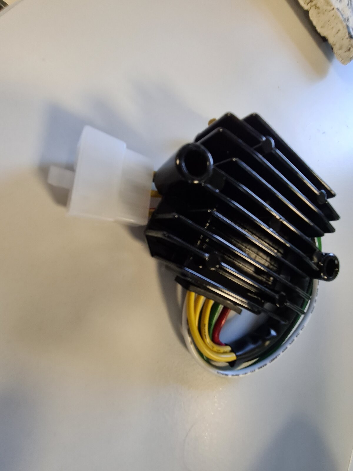

  5. Lithium compatible rectifier is here... Nice build quality but the it was 160 quid... Get what you pays for... 20230113_145034.jpg

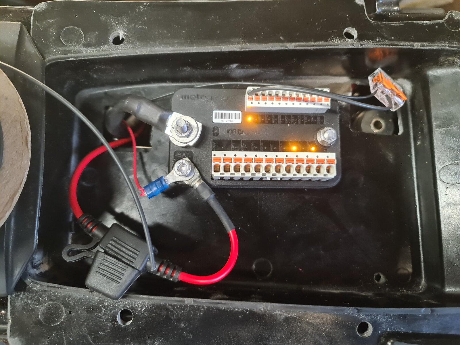

  8. Baby steps on the wiring....started sunday. Munit live. WACO connectors just turned up (never heard of them before - cool little things they are!). Depends if i get out there tonight but will be starting on the ignition switch wiring, if not sunday.
  9. Following on from the Munit going live (only a few wires connected but its a big thing for me..!) Connected the ignition up yesterday so rather than putting the blade fuse into the holder to switch the MUnit on i can now do it from the key....Yey me. Made a start yesterday on converting the RegRec to suit the existing cabling.

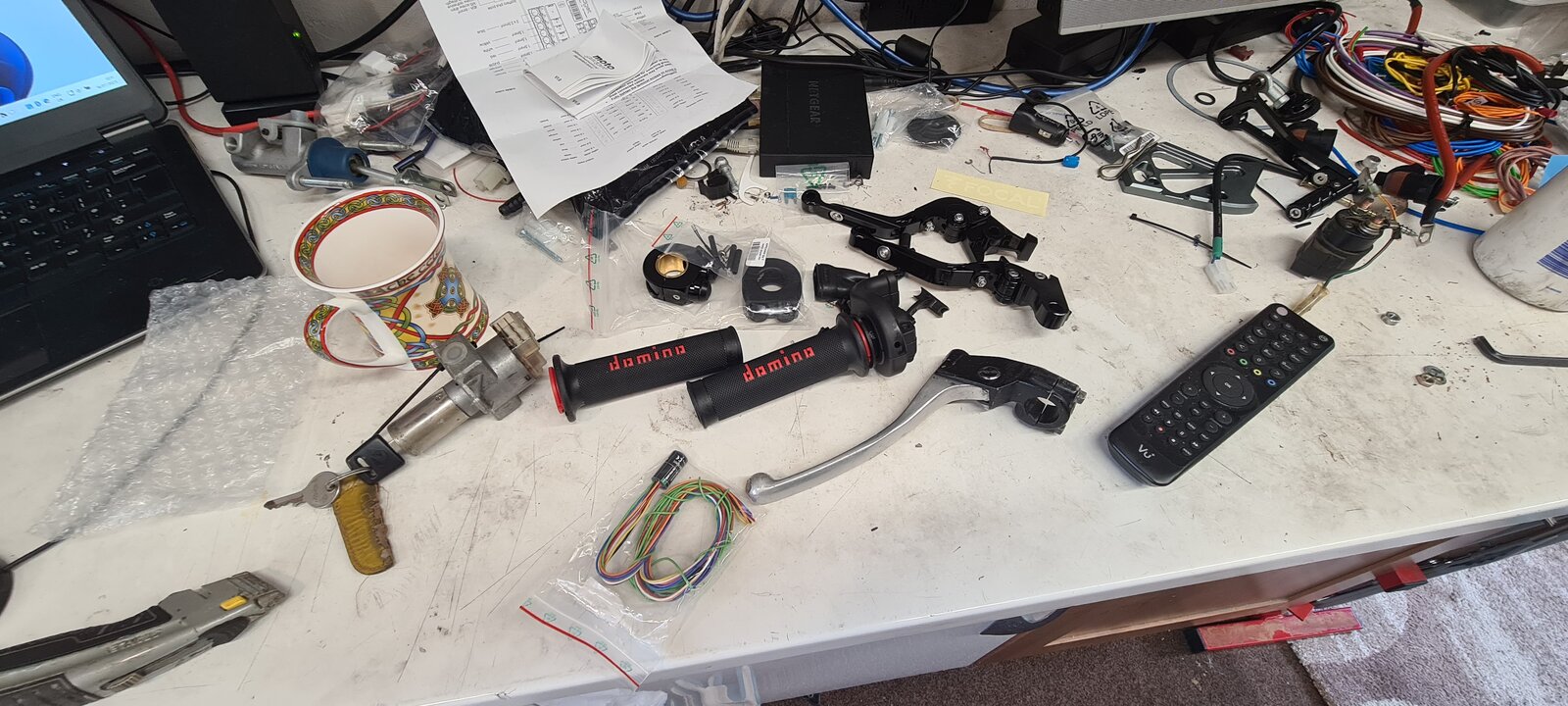

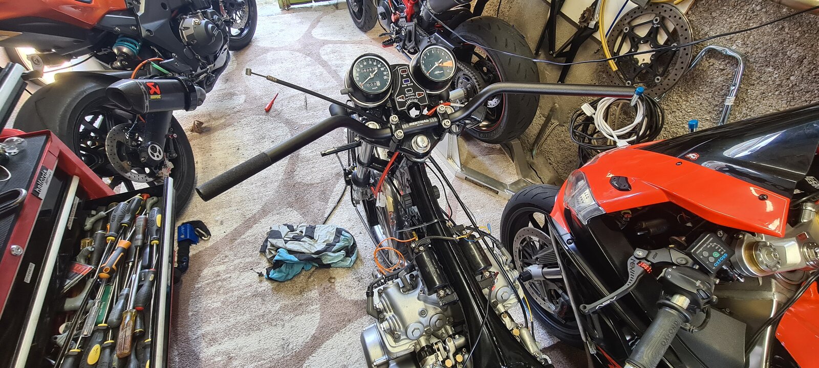

  13. 16894986723098016422905153240930.jpg Day in the garage today....changing the whole handlebar setup and going full mototgadget...
    Main reason is last week we had a full day trying to get the oem switchgear connected to the mototgadget munit - too much hassle and more wiring....swtiching to motogadget buttons means 1 wire goes back to the motogadget munit instead of having to connect 17 wires from the oem switchgear. Which meant the throttle had to come out as thats part of the master cylinder...which then i thought id change the bars as the oem switchgear runs inside the oem bars and its tight...really tight so i thought if i pulled that wiring out to reuse the bars the oem wiring would never go back in!....anyway...see what i can get done today...

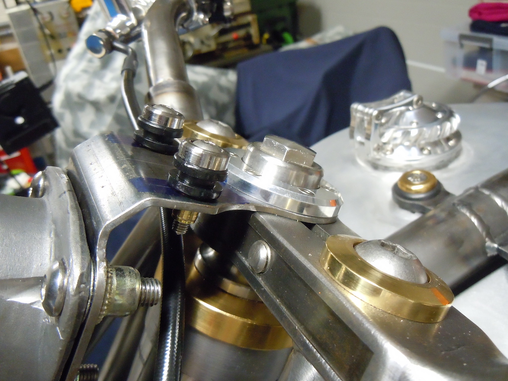

  14. I could well be somewhat late, but .......
    ...... threaded inserts, available in various thread sizes & forms. There are two in this picture, the one in the lower left is a M8 insert & the one below the grommet in the centre of the picture is M5. Basically you drill a hole & them crimp the insert in place, the tool is just like a pair of pop-rivet pliers.
  15. Rivnuts

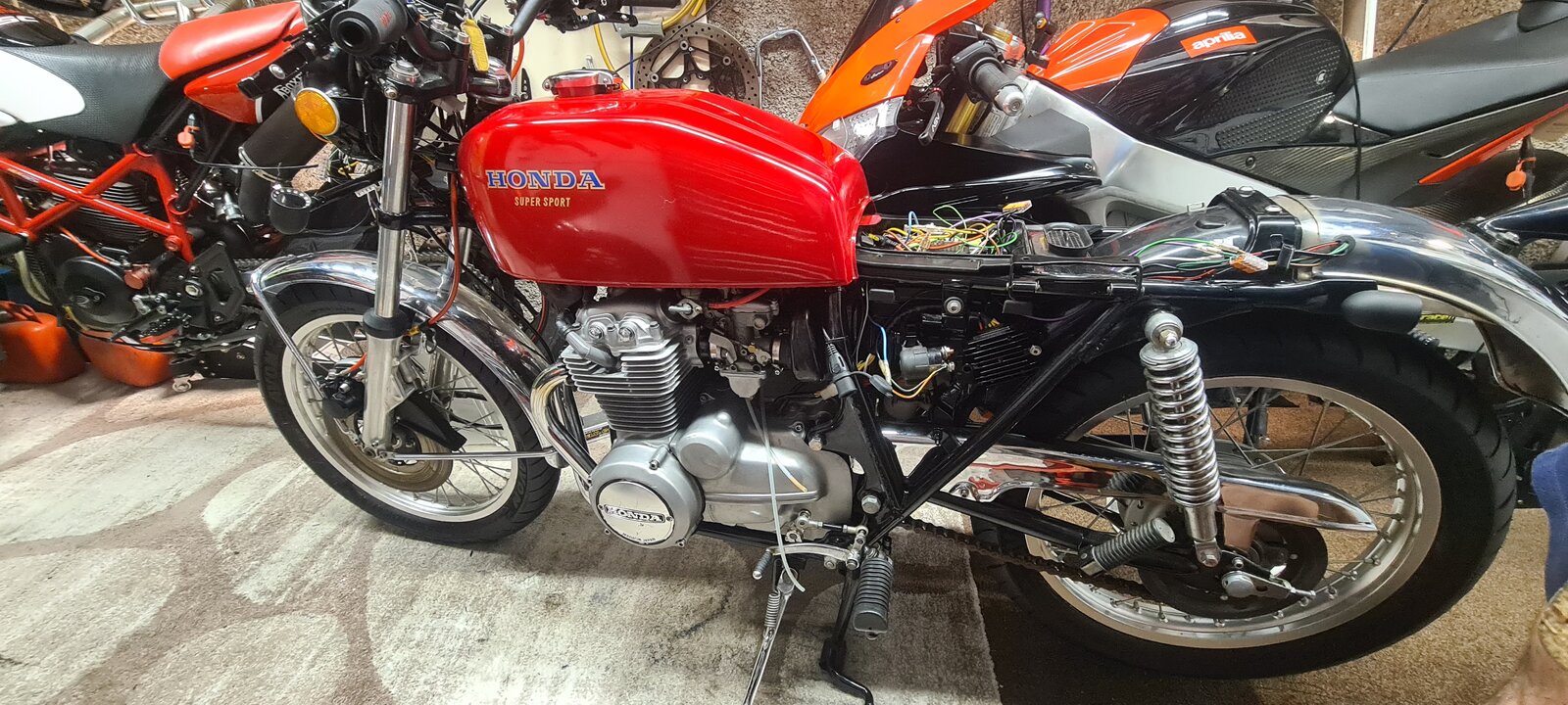

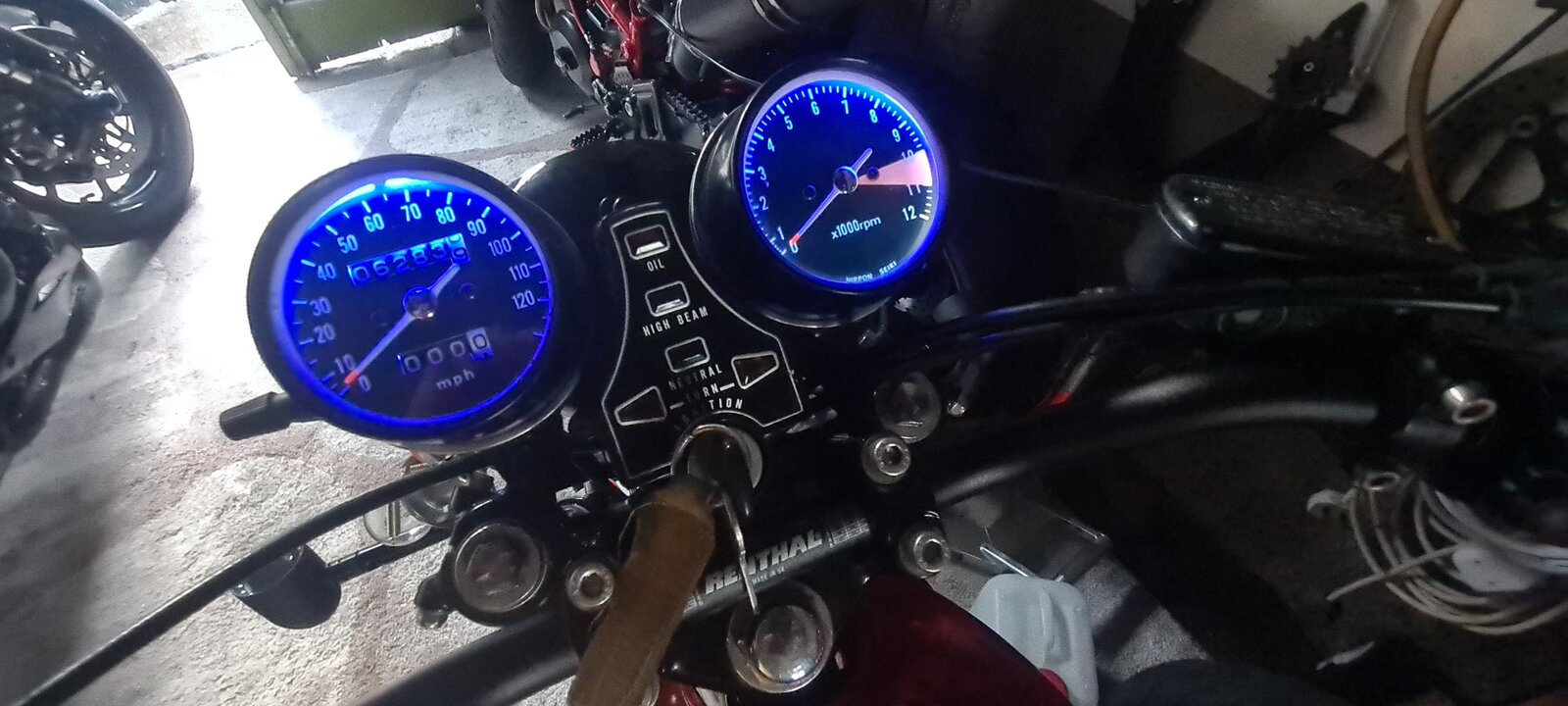

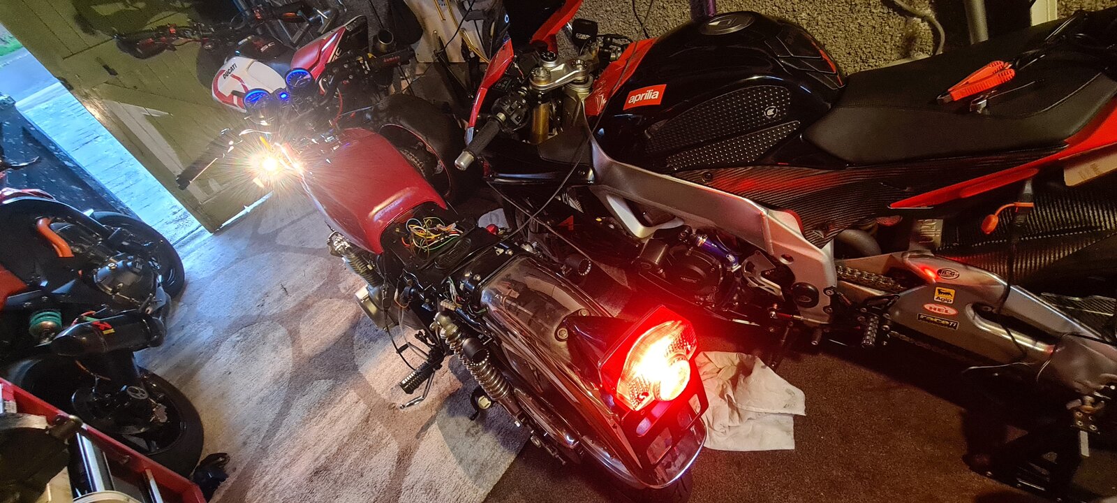

  18. Well, its starting (literally) to come together.....once id connected the motogadget switchgear and got the buttons working the penny dropped on how it worked....very simple....so made a start and ive pretty well got it all wired up now...the only thing left to do (electrically) is to get the neutral and oil light working. I fired it up and it pretty well started first time, leaked a bit of fuel and the tickover is sitting at 4k so one of the lads is coming over in a few days with some vacuum guages to set them up. Home straight...!
    One of the lads gave me a link to a site which sells classic car/bike led kits so everything bar the headlamp bulb is now LED.
