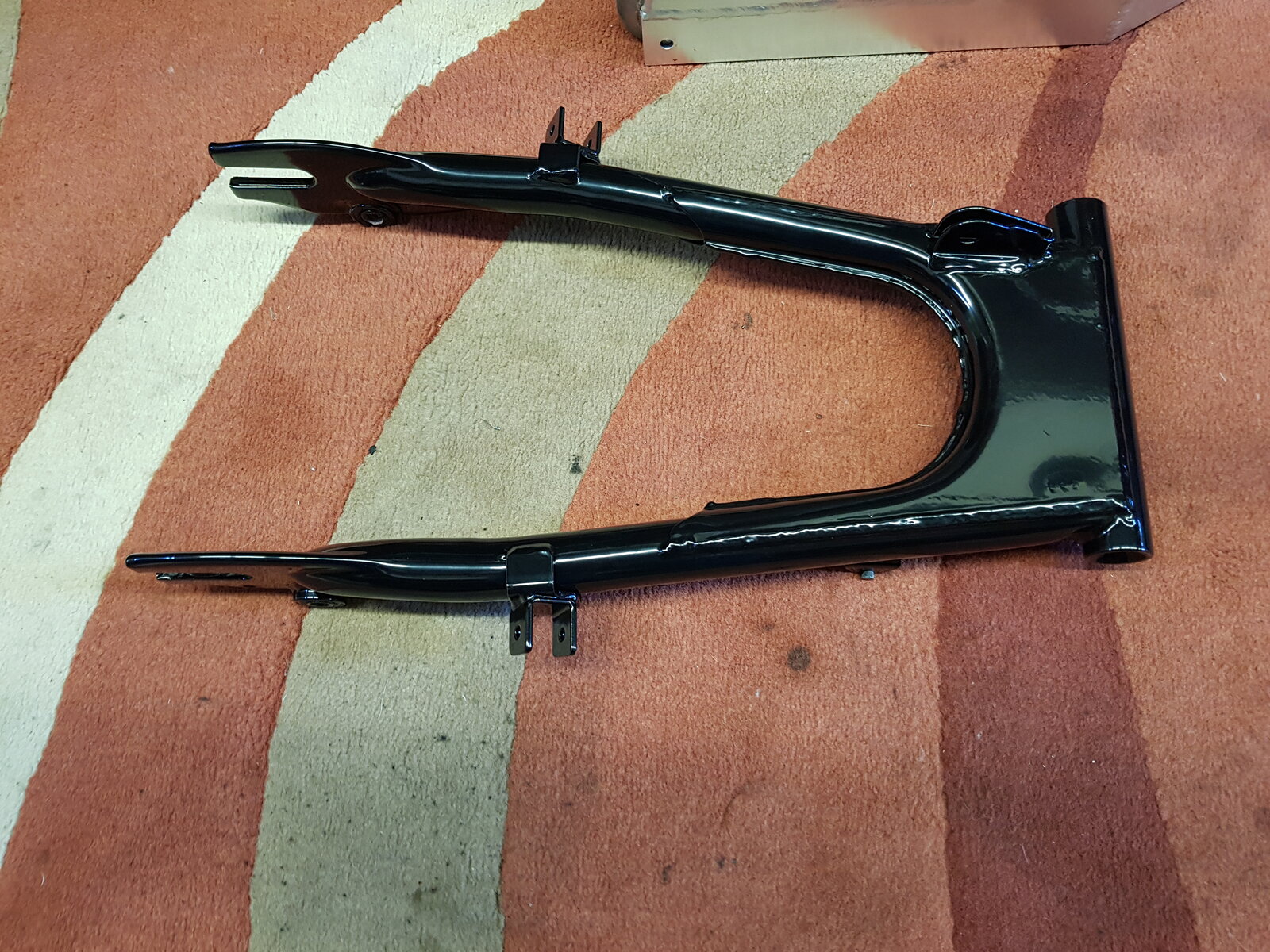

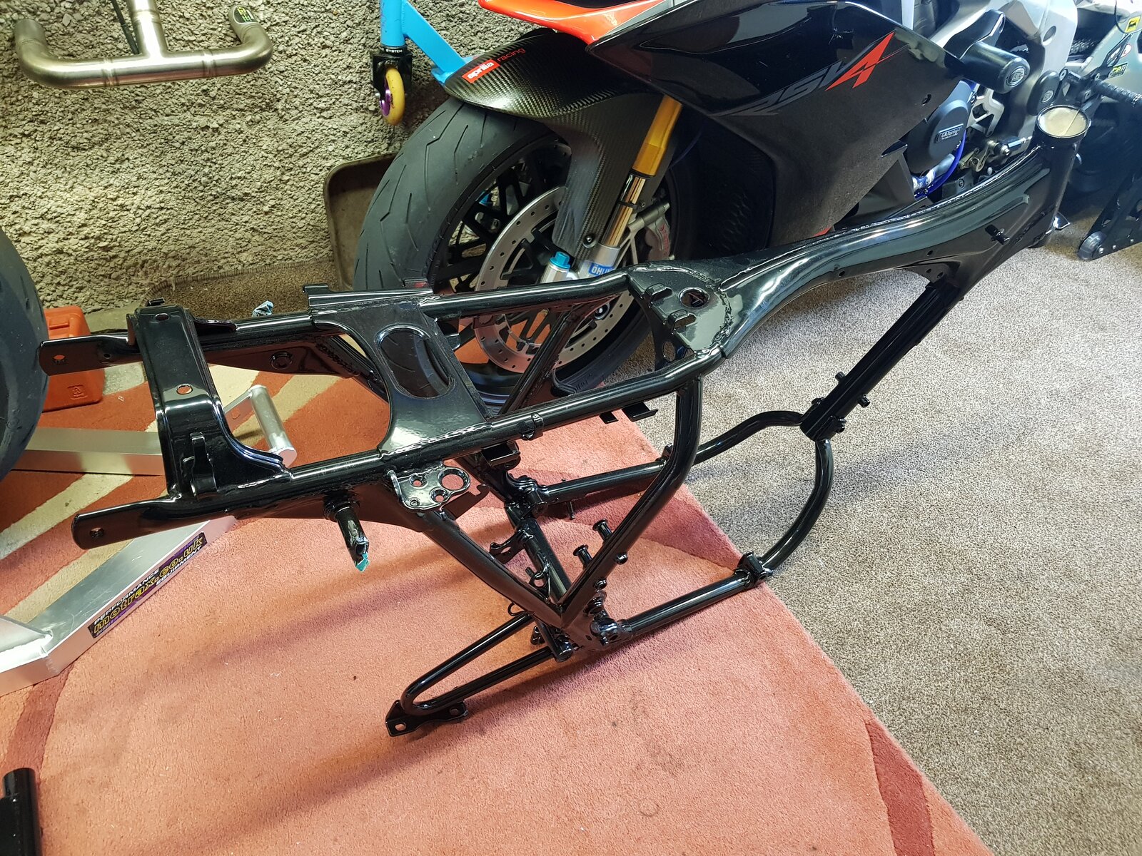

  19. Got the frame and swing arm back....
