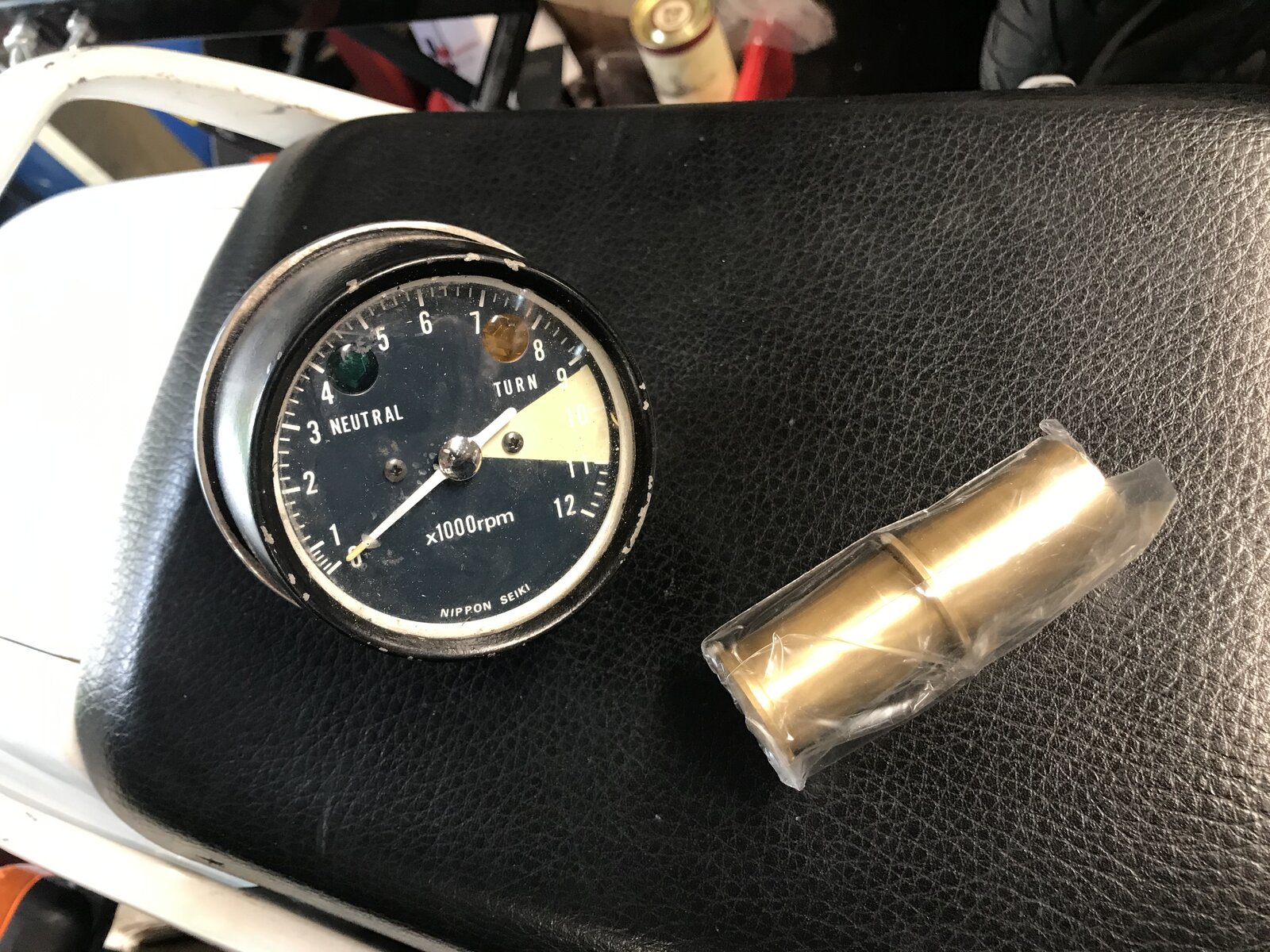

    Clocks aren’t , but they’re free , I’ll dig out some pics
  2. Ok thats great - do you want anything for the bushes - (i think this build is going to be expensive) and some parts hard to find...any consumables would be nice (like the bushes) - do you want me to pm you my address, let me know what the carriage is and ill paypal it over...thanks very much.
  3. While i totally see where your coming from this one is just going to be really built for longevity...performance is not on the cards...!
  4. cant lay my hands on the speedo just yet - pic attached
    Bronze bushes are a tenner - yeah PM address if you want them when I find the Speedo 2067F8E6-79E8-47F7-8287-B15616D721E9.jpeg

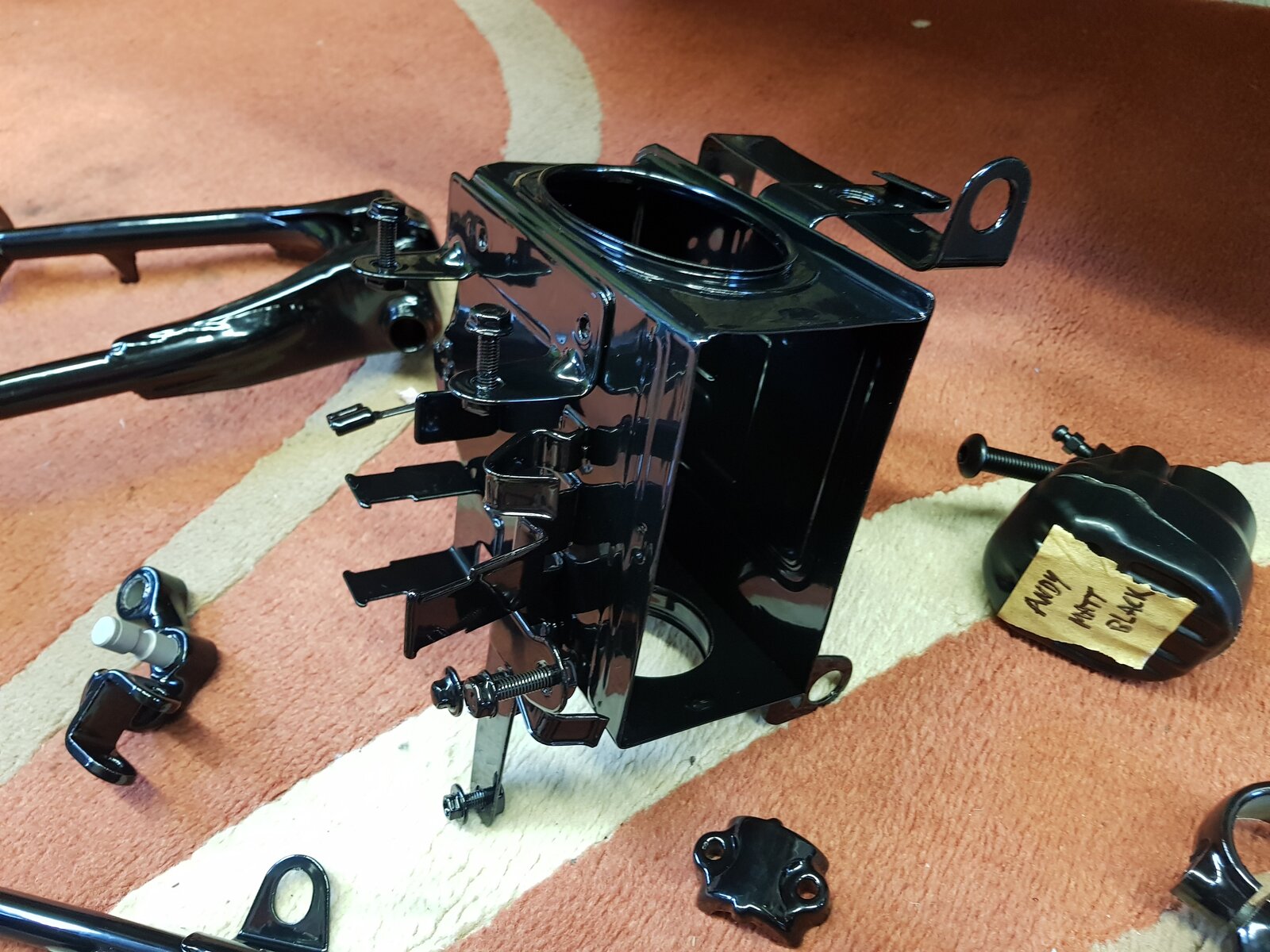

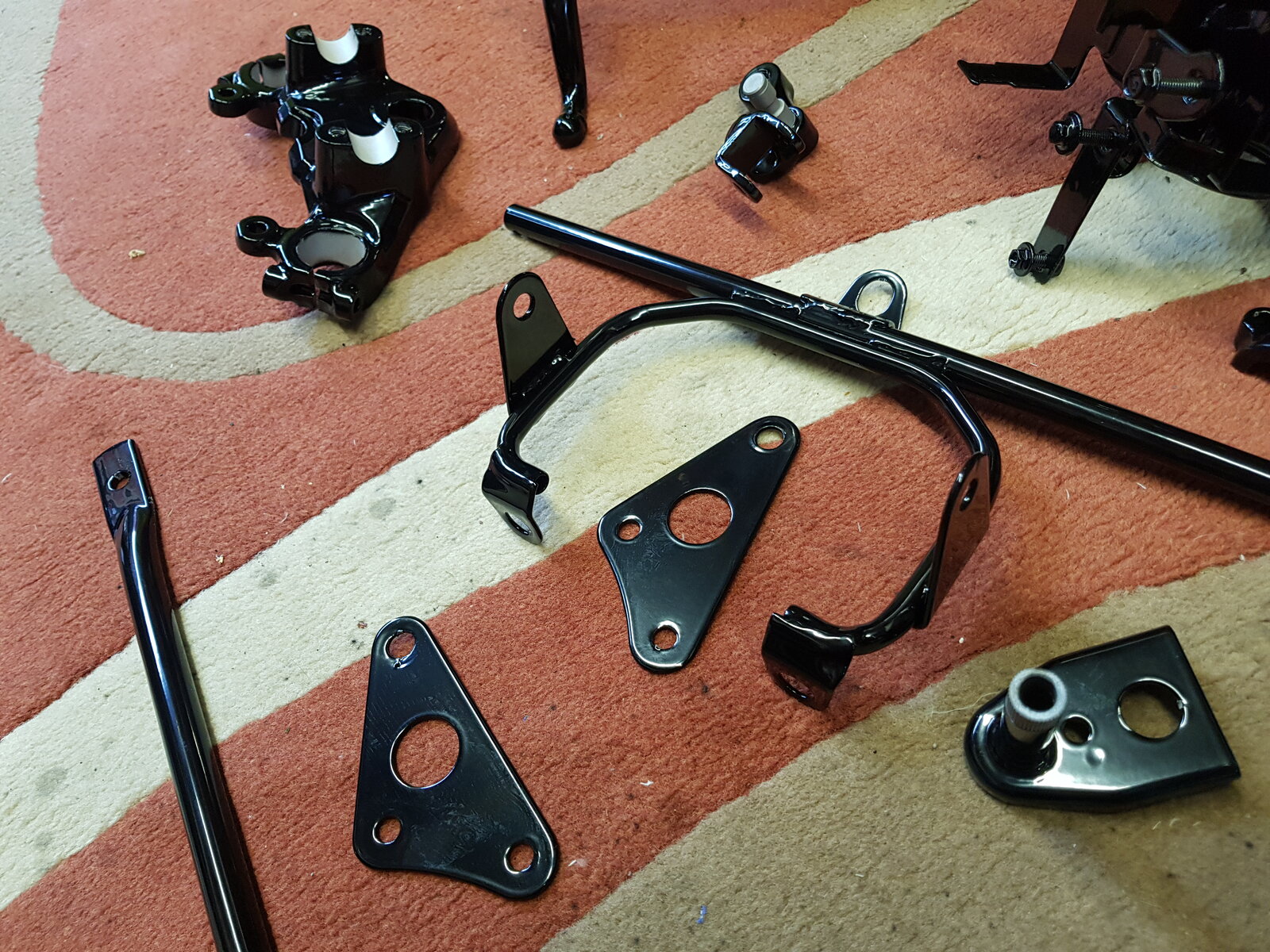

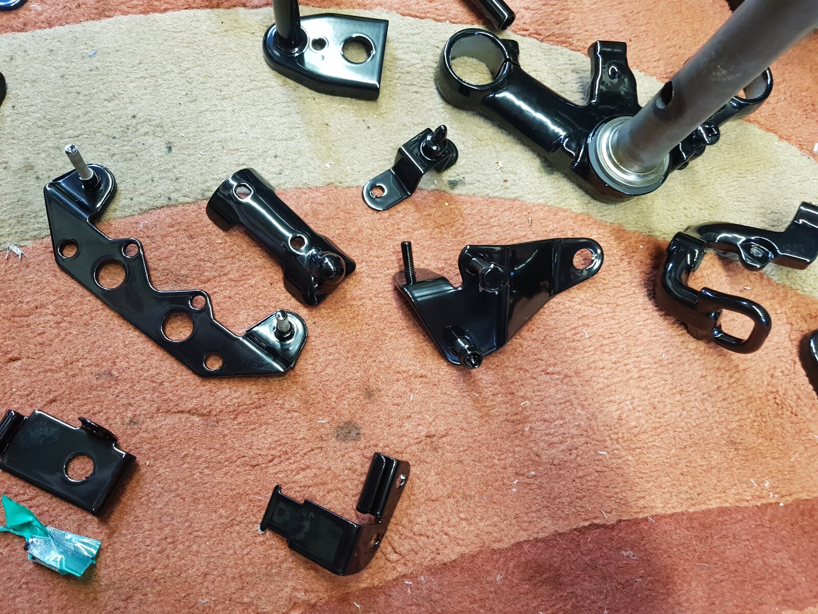

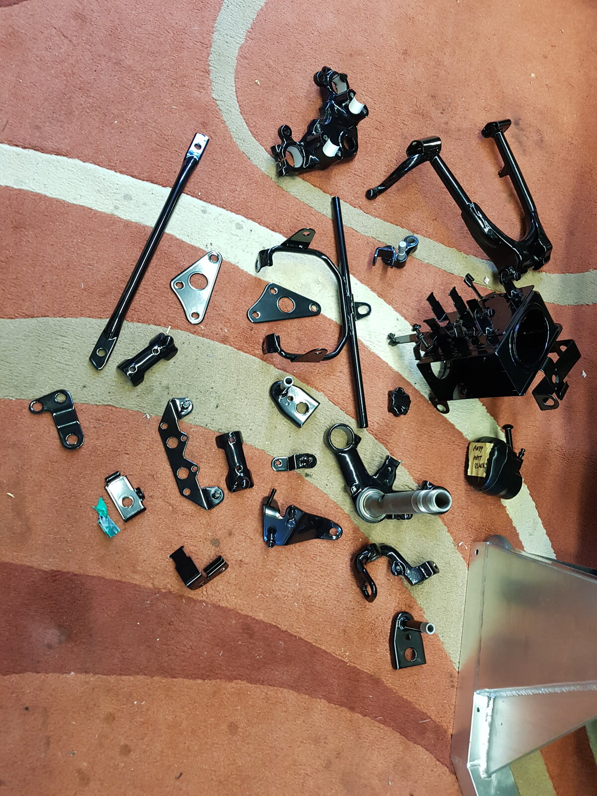

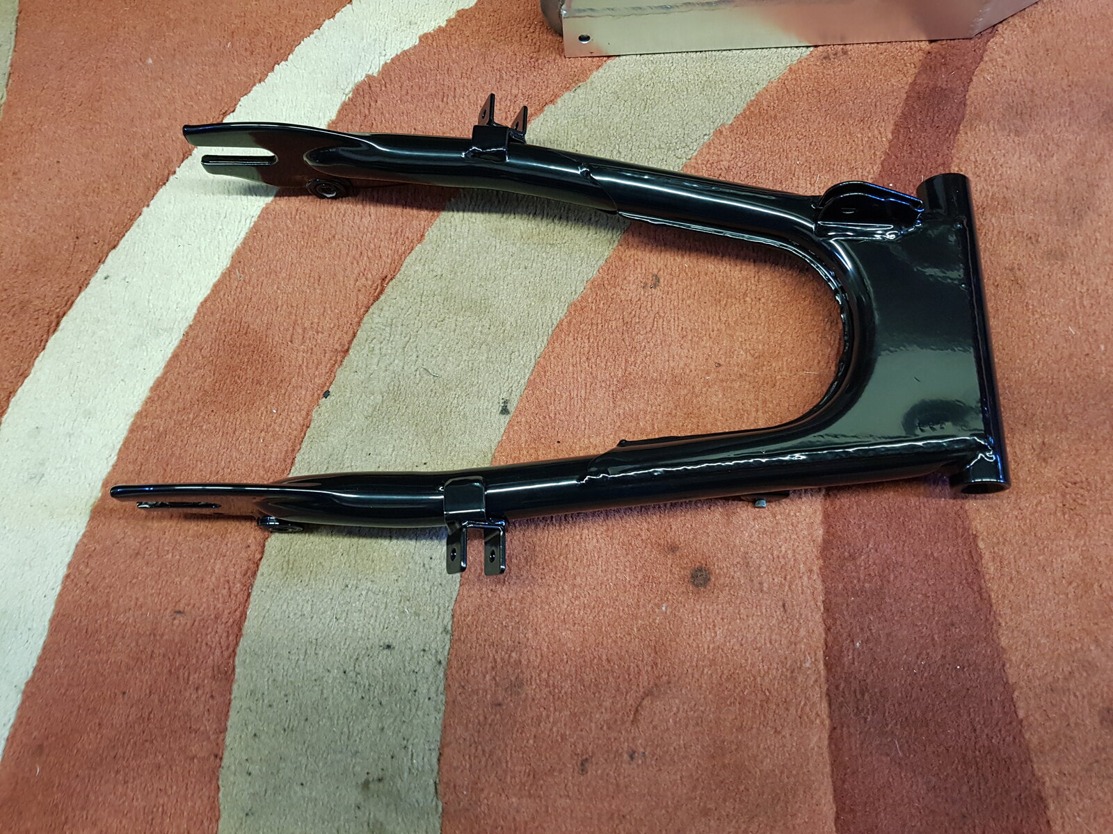

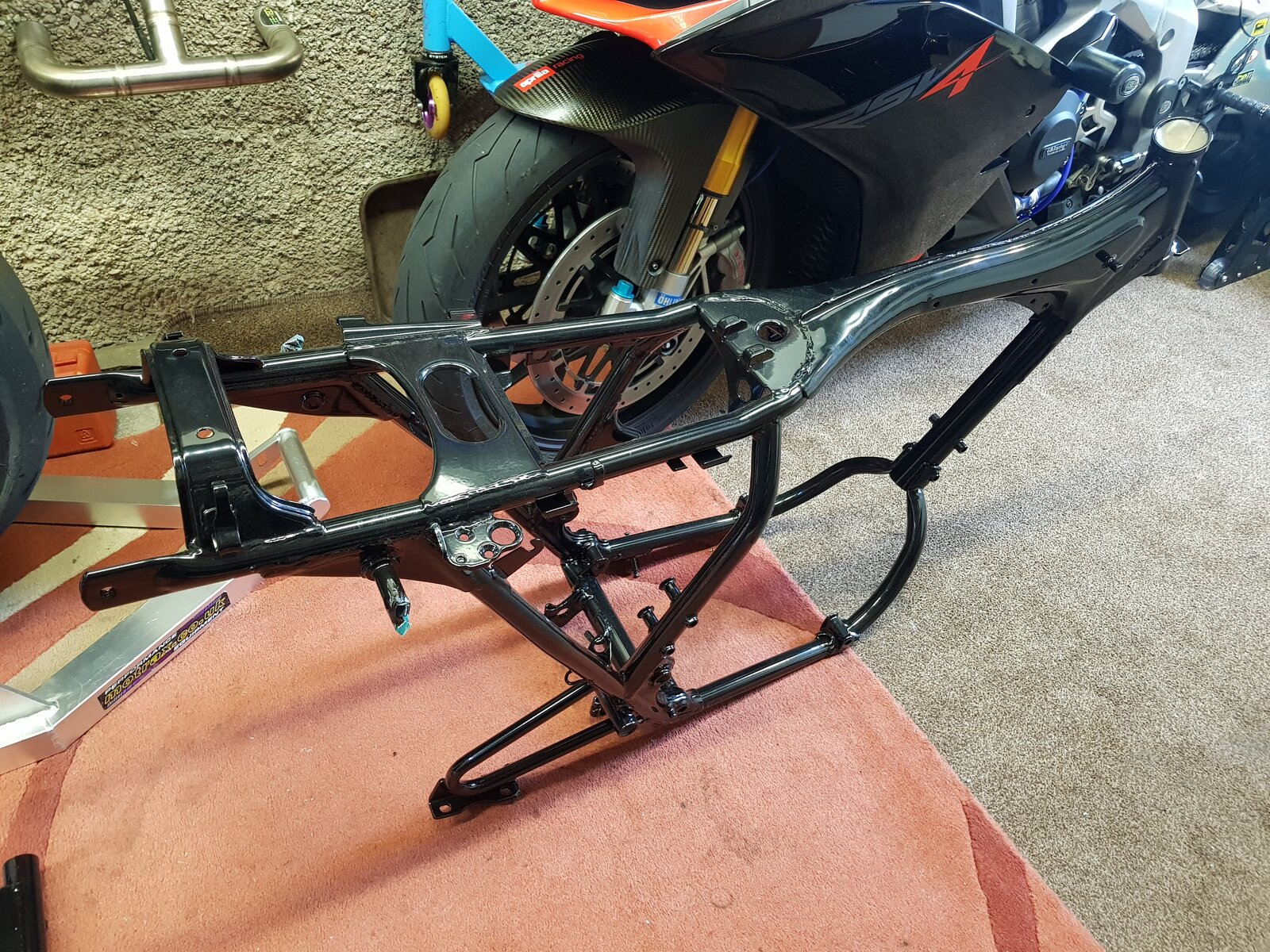

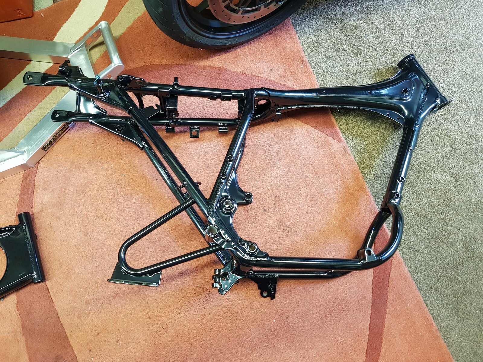

  6. More powder coating back... 20200409_185126.jpg 20200409_185121.jpg 20200409_185131.jpg 20200409_185128.jpg
    That consitutes all of the powder coating...chrome plating next...

  7. Can't believe how quick it's moving on, I've been doing my TZ race bike for 16 years and only managed to get the exhausts repaired and the frame coated along with a couple of sundry little bits and pieces. :upyeah:
  8. Looking at the steering stem brings back nightmares I had when I got my 400/4 frame stove enamelled red..
    For some reason, I didn’t remove the steering yokes before I got it coated and asked the coating people to remove it.
    When I got it back, they had indeed removed top and bottom yokes but then proceeded to stove enamel the whole bloody stem, bearings and cups and all!
    I spent hours scraping it all off so I could fit the new bearings I had already bought.
    Bastard of a job.
  9. Red frame made me think of the Yoshi Honda 460/4 Harrier. Not sure why as apparently they had black frames?
