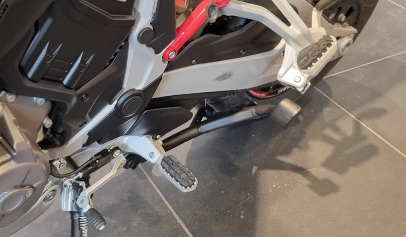

  13. Here's what could happen ... (not my bike - this is one I walked away from when I saw this damage)
