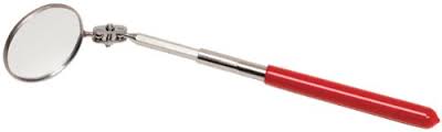

  13. 999 has the rad cap on the radiator itself and you fill via the expansion tank which has a plastic cap with a small valve in it.
    The tank has a window with upper and lower water levels marked on it.
    This is on the inside, presumably so you can check the level without removing the fairing. Problem is I can't see the coolant level as a result and shining a torch in there doesn't seem to help. Anybody got any tips on this ??
  14. if you can top it up with the fairing on, make a dip stick with a cable tie.
  15. Would it matter if was slightly over-full?
    I have a replacement alloy header tank on the 916 (after too many split tanks) and as such I can't see the level so I fill it to where I can see, i.e. the base of the neck which is likely to be over the 'recommended' level and then it just spits out the excess into the overflow tank.
  16. I used a little artists paintbrush as a dipstick, so I do have some idea of the level. It does seem amazing though that Ducati would go to the trouble of providing a window complete with level markers if it is completely unusable, so I was wondering if there is some trick to it...
  17. Haha!
    The window is perfectly visible but the level in it isn't because it's an opaque tank. Shining a torch at it doesn't seem to work. Maybe I could try sticking an led torch down into the top of the tank to light it up.
