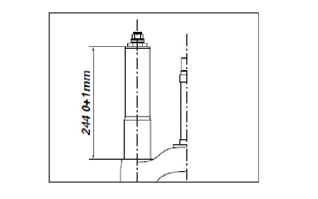

  6. Grandad, this is the factory spec. Measured from the machined top face of the lower yolk where the fork tube clamps, 244mm to the top of the fork tube.
  7. Already have the measurements thanks. They are listed in the Haynes Manual. But thanks for taking an interest.:upyeah: I have the bike working well now to my satisfaction. The 4 rings showing on the inside is good. Out of interest I should measure and see how it compares. Regards Ken.
