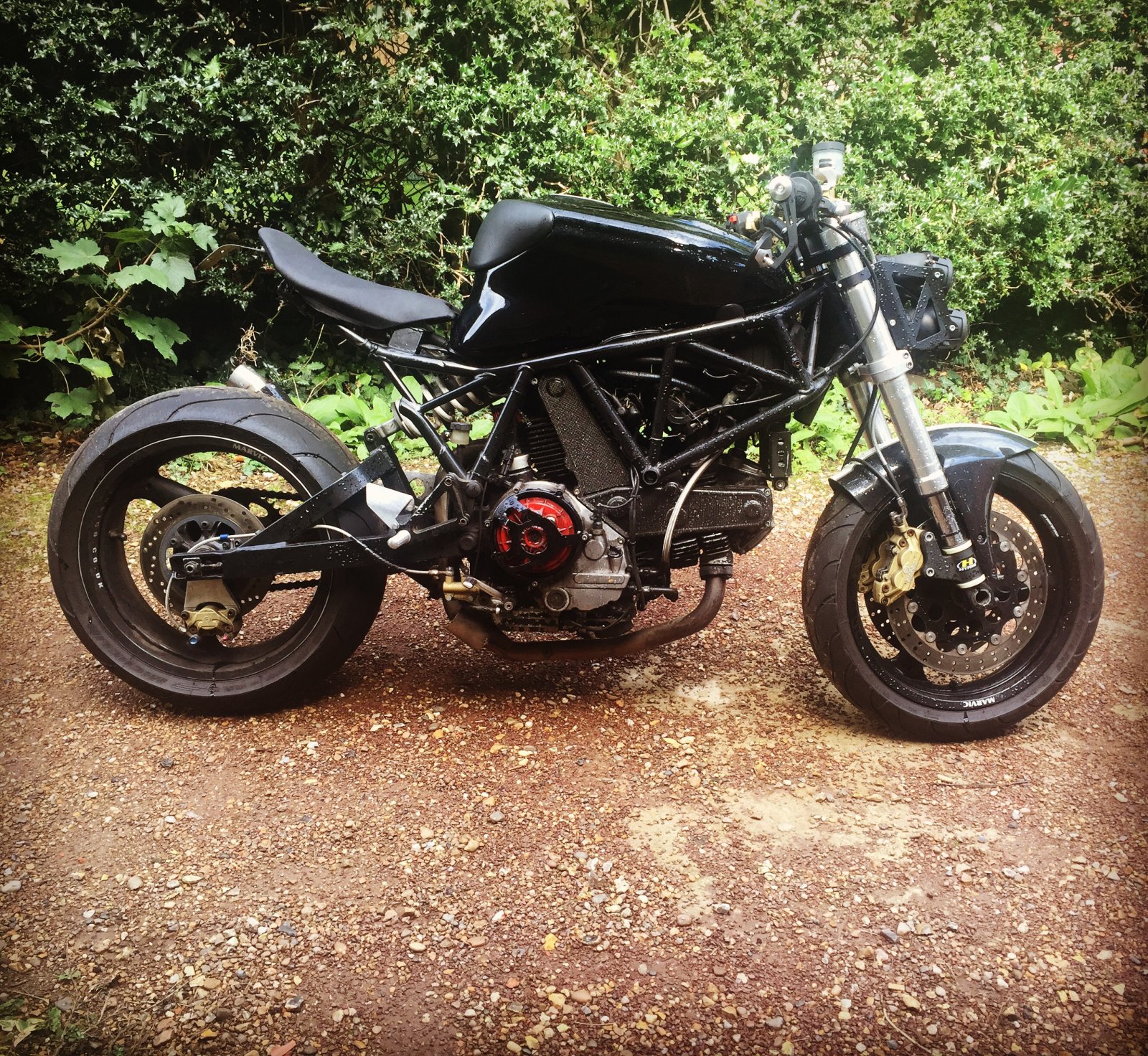

  6. image.jpg I haven't weighed mine but I reckon it's got be be one of the lightest on the road. It's significantly lighter than my Monster S4 which itself has had an awful lot stripped off it.
    • No fairings
    • Most of the rear subframe removed
    • No seat unit (just a Panigale seat pad)
    • Both OE exhaust cans and some of the RHS pipe work removed. Stubby carbon fibre end can fitted.
    • Rear hugger removed
    • Mirrors removed and replaced with bar end mirrors
    • Front light replaced with much smaller and lighter unit
    • Clocks etc removed and replaced with 3" speedo only.
    • Rear lights replaced with tiny "button" LED
    • Aluminium number plate hanger (basically just a bent strip approx 8"x2.5")

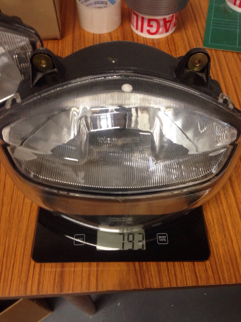

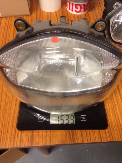

  15. 746g off my nose this morning. The TRIOM lights on the 1000DS have a plastic lens cover. The older ones are glass. So I got myself one for £40 delivered. Easy win compared to making an alloy front sub. Although I don't rule this out either![​IMG][​IMG]

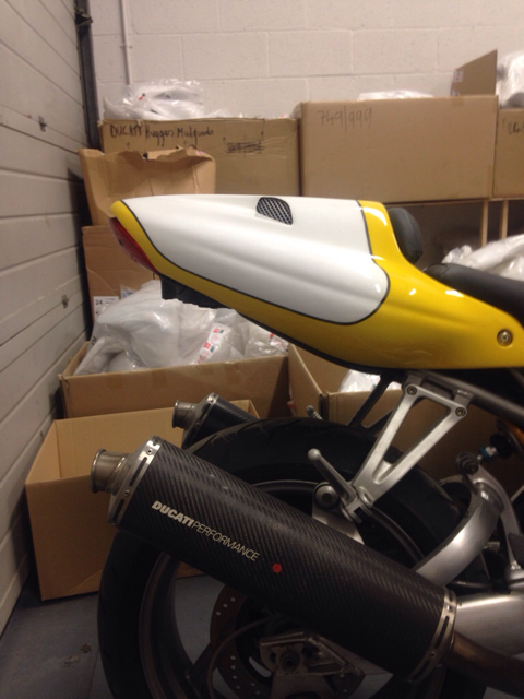

  17. And 1kg off my tail too. The seat unit was the same weight as the original. The weight is saved in the loss of the grab rail[​IMG]

  19. I see you need the pillion footrest hangers to support the cans but could you not remove the pegs?
