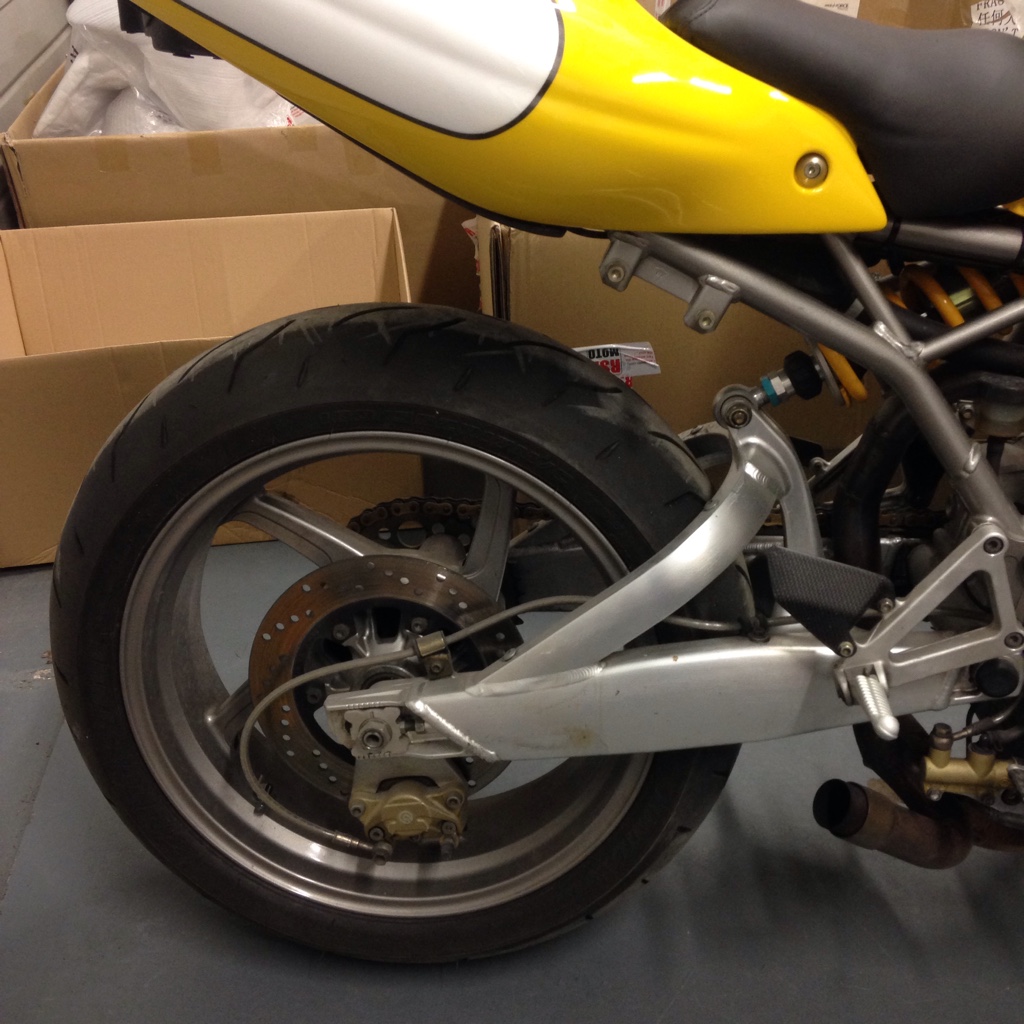

  1. Just lost another 800 [​IMG]grams taking them off to make way for the high mount termis
