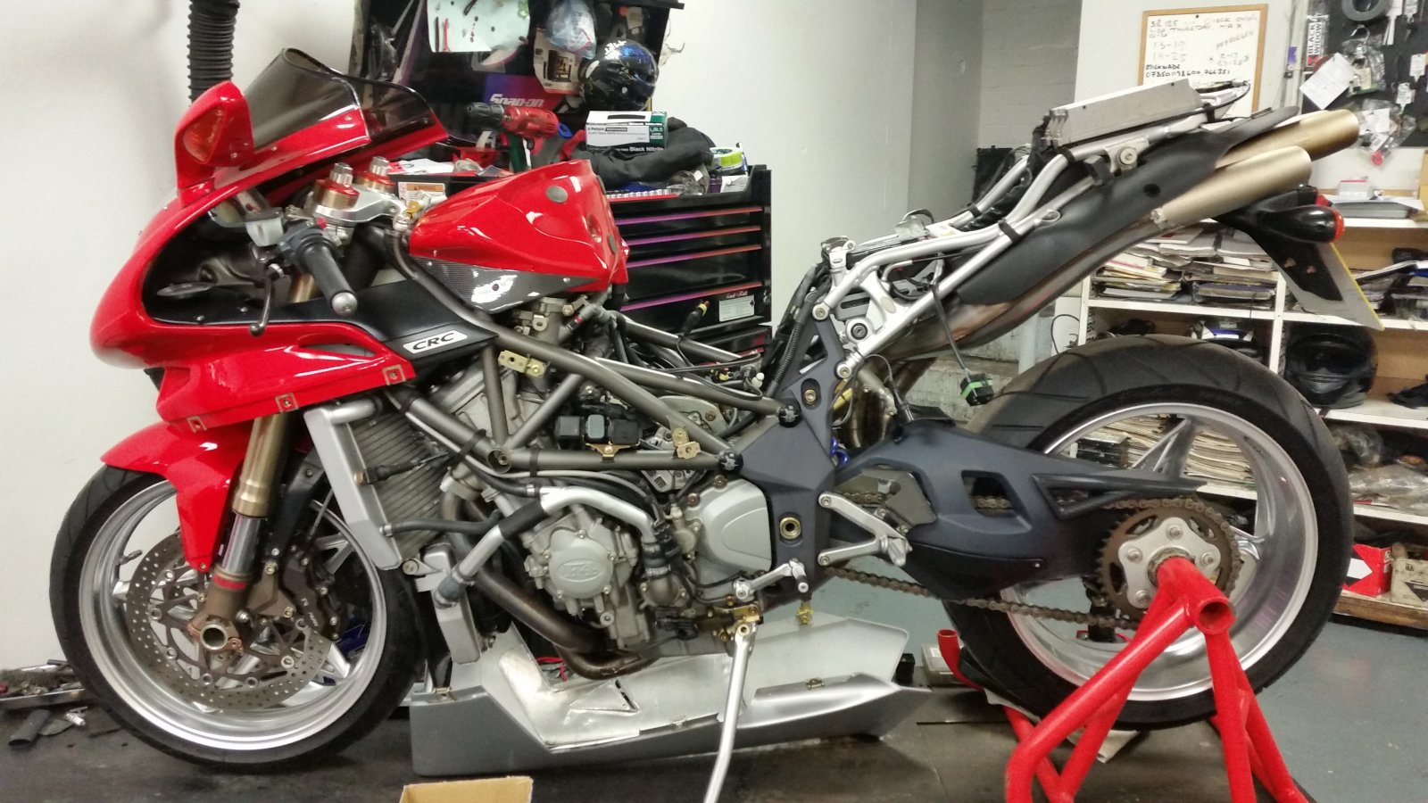

    I had the joys of recomissioning an MV F4 750 SR recently, the bike was split mint, the fuel system was not!.
  8. :grimacing: That is unbelievable! What's the story with the bike?
    • Dislike Dislike x 1
  9. It was a garage ornament by the looks of things, new owner wanted to hear it going but couldn't get it started.
    It had 1/2 a tank of fuel in but had obviously had previously been left to dry out. We managed to salvage the fuel pump hanger, fit new pump/ filter and lines etc.
    Did a 1991 Ducati 907ie last year, had been stood 10 years. Same again was a right mess inside the tank. Manage to save the injectors (ultrasonic cleaner). Got it back on the road, new tyres / belts etc. One of the nicest bikes I've ridden, lovely smooth engine!.
