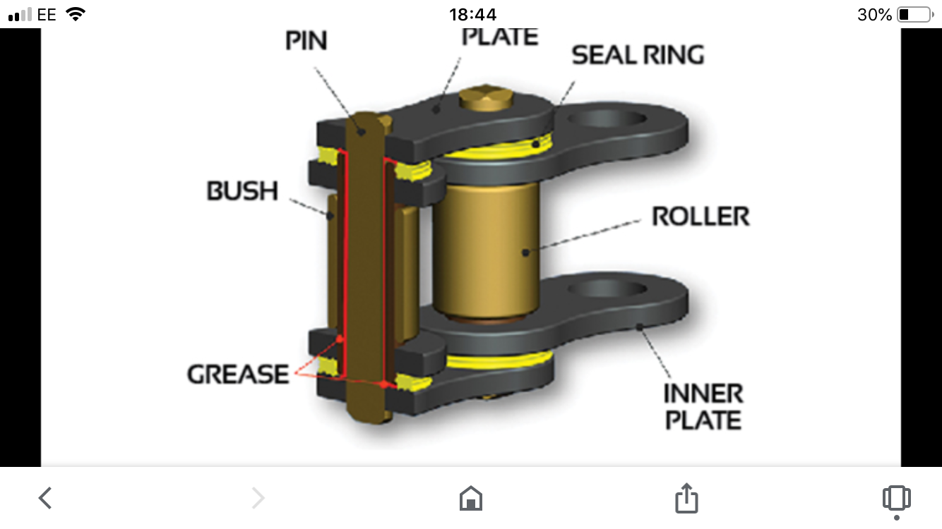

  12. ABB9629A-2277-4FCA-85B3-254D0DED7094.png Motul “C2 Road” chain lube goes on thin so stands a chance of getting between the rollers and pins, it thickens up when on the chain after a few minutes and doesn’t fling much, more convenient to use than gear oil, because it’s in a spray tin, does a good job.
    PS make sure you squirt it between the roller and inner plate, that way it stands a chance of getting under the roller, nothing will get past the O rings but they already have grease trapped behind them, generally spray all over the chain to stop it rusting and wipe the excess off by holding a rag around it and holding it in place whilst rotating the wheel backwards by hand, do this on the bottom run of the chain to stop your hand being dragged into the rear sprocket, never ever do this with the engine running!
