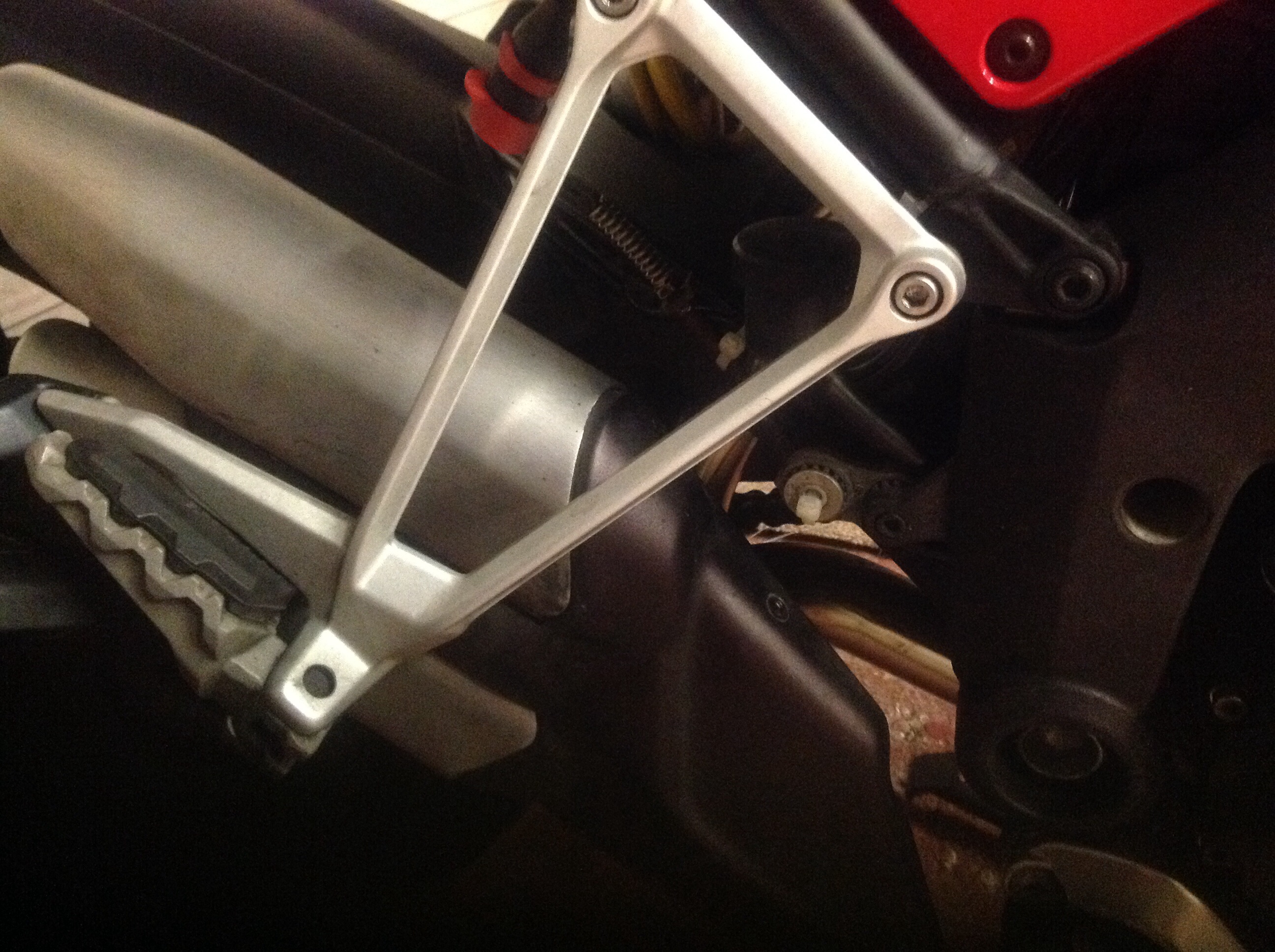

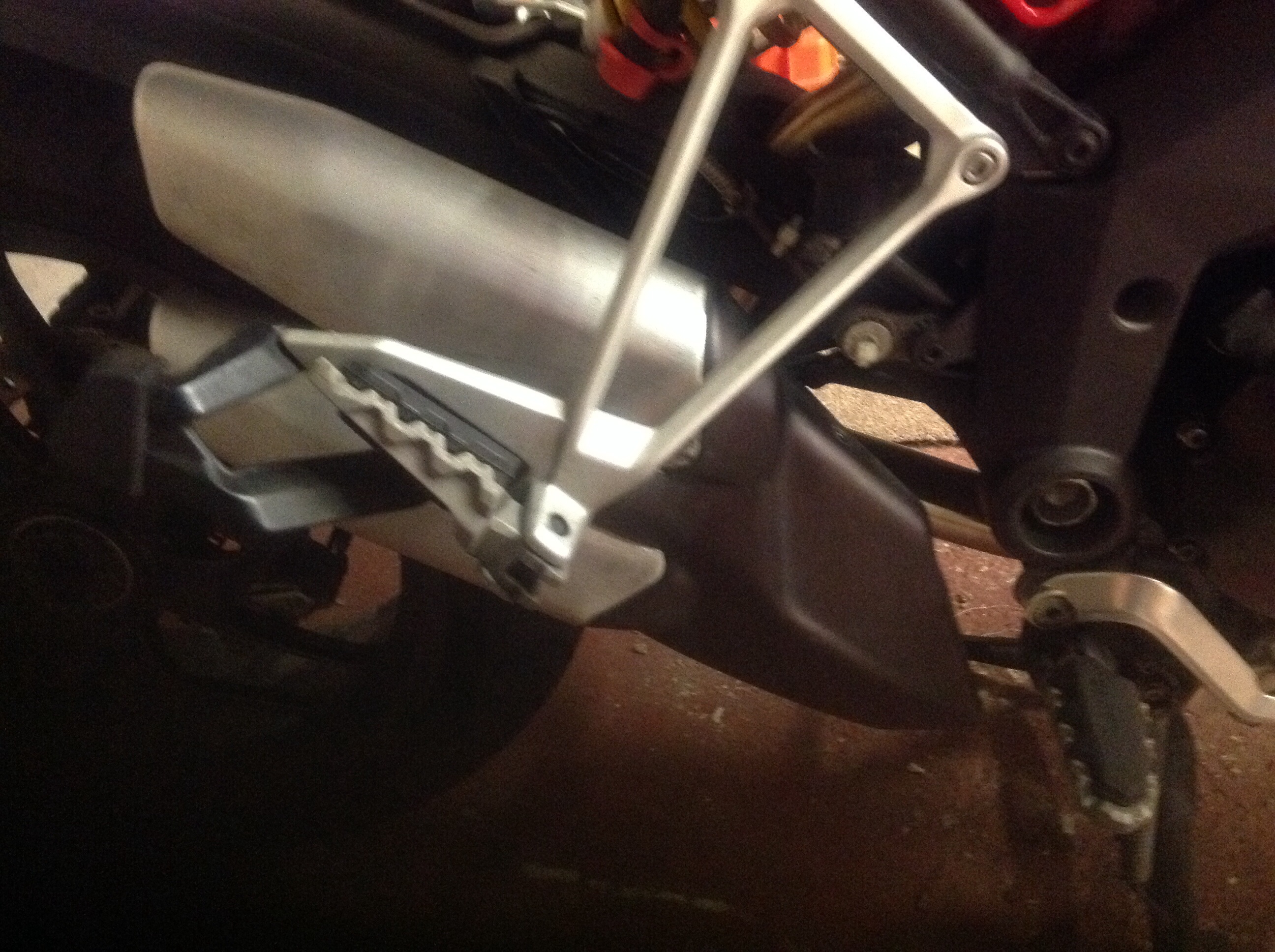

  6. Here goes, all done, loooooud and beefy sound, seems to work, took out and up to 9k and no light anywhere, kinda sorted for now but ne a can as it looks terrible and only one screw sits the outer shroud now on the end can....and for @andyb a couple of pics showing I still have that style of getting around things ;)
