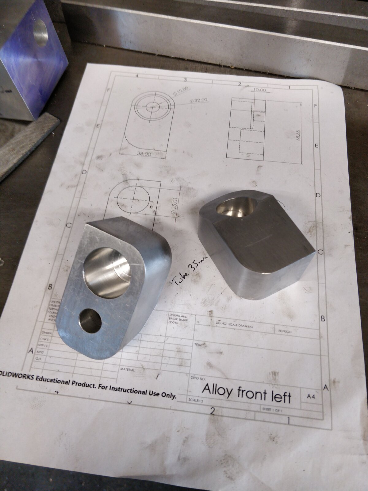

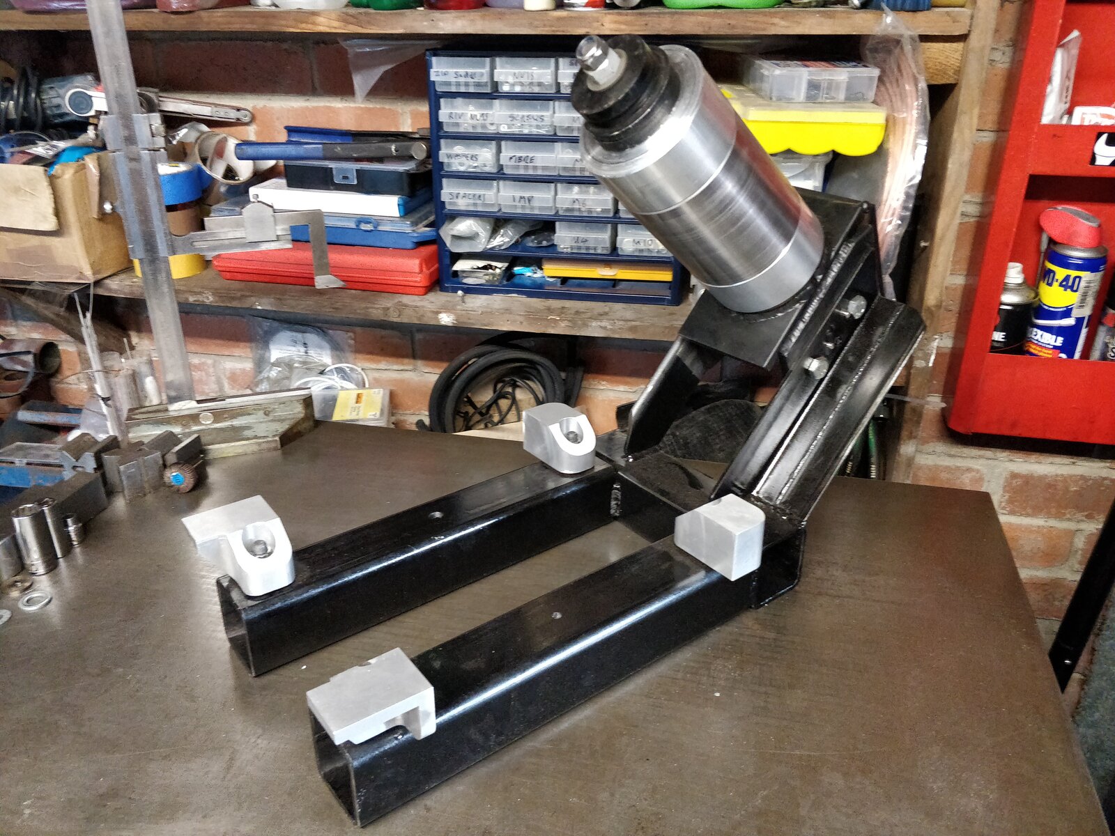

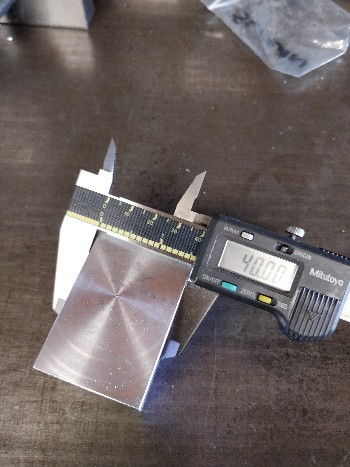

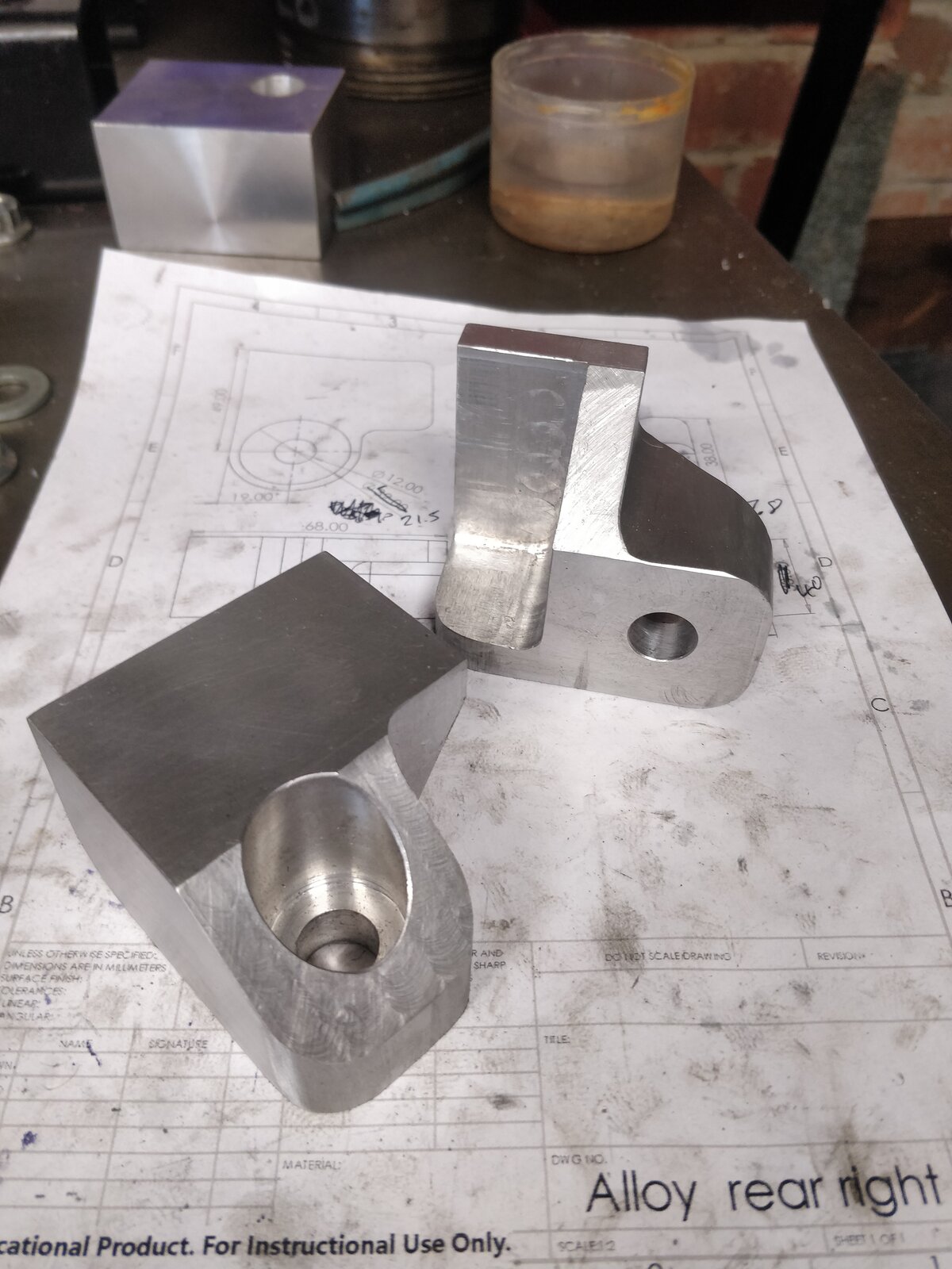

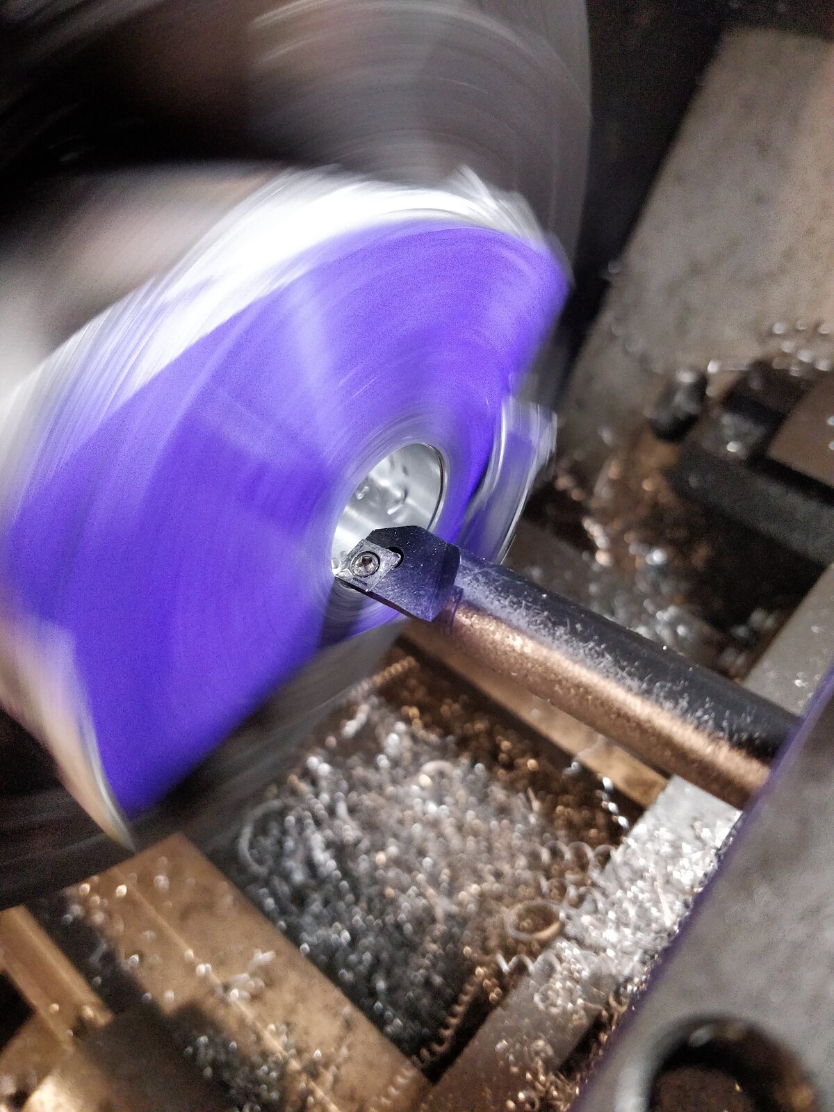

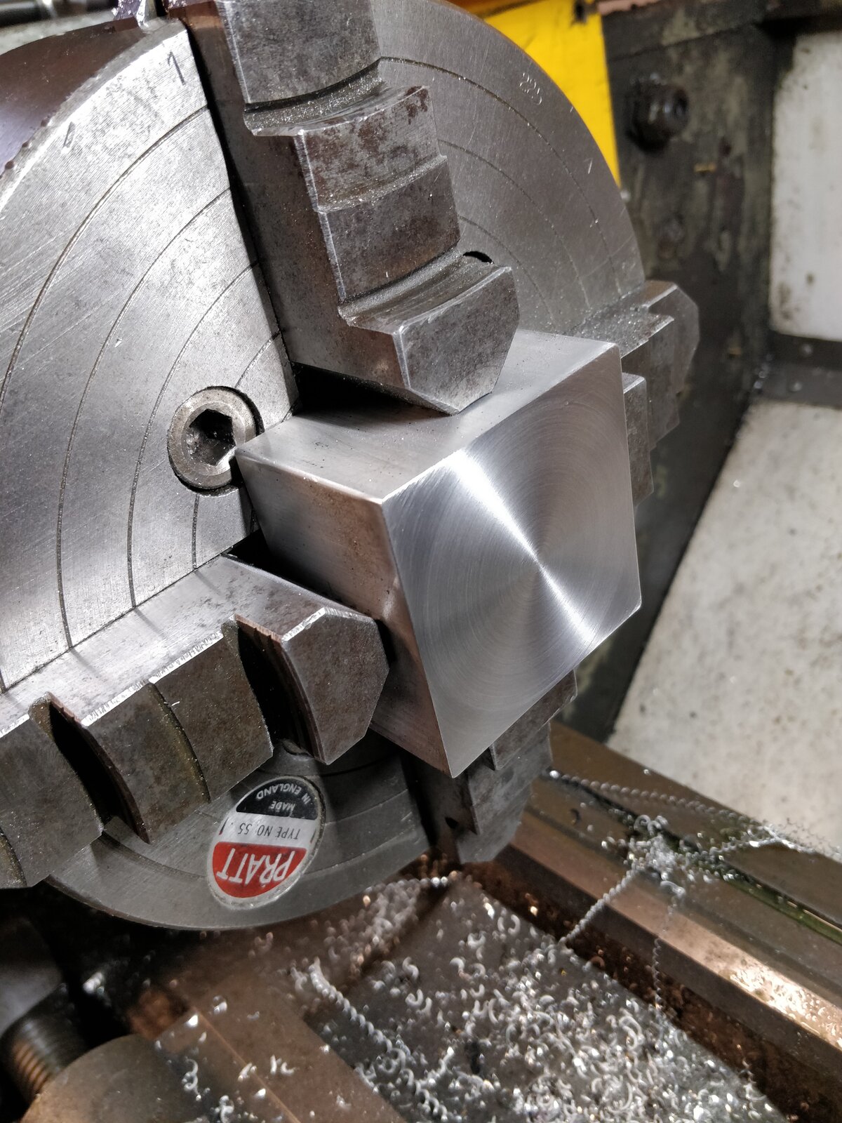

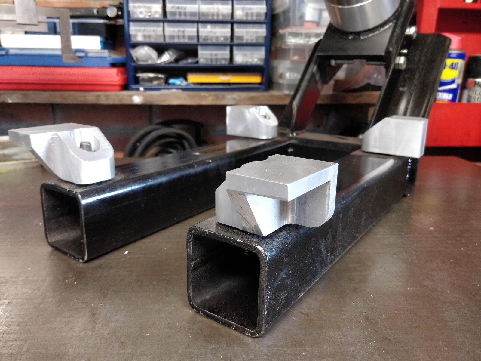

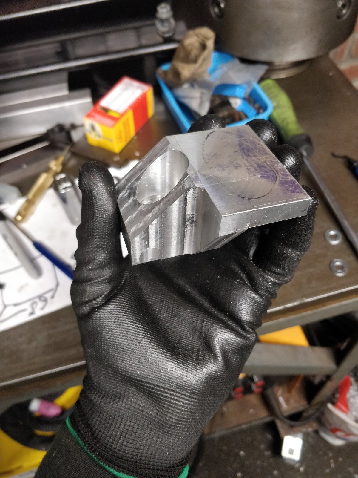

    I've got all the machined parts finished: IMG_20210404_185223.jpg

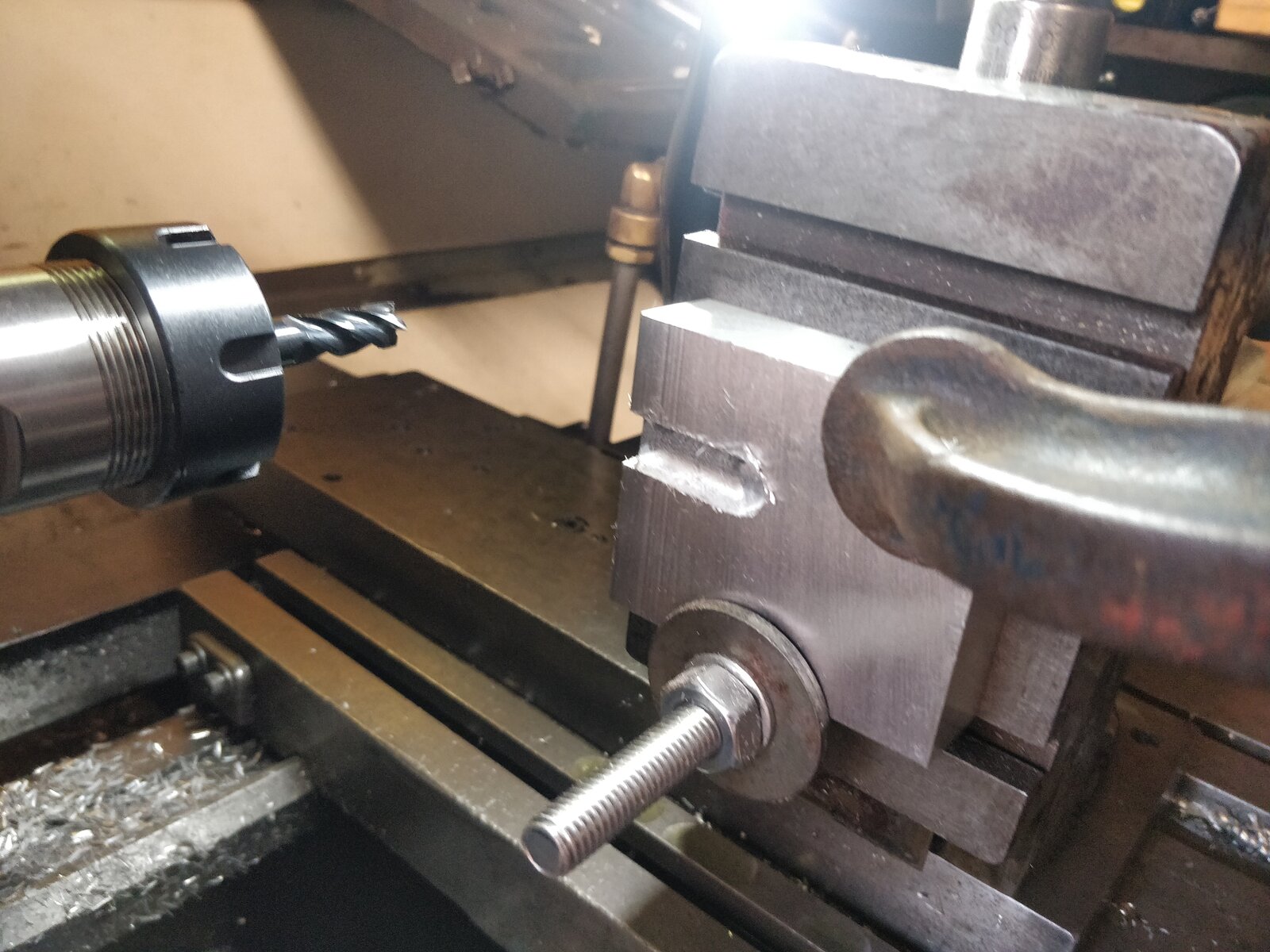

    It blows my mind to think they were made on a lathe, the lathe milling does work on alloy but I wouldn't recommend it. I'm definitely not going to try it on the steel or titanium versions of the chassis.
    I used a 10mm endmill, I planned to use a roundnose to radius the inside corners but it's so over engineered in these parts that it didn't need it.
    ..I also lost the end mill.
    It's nice to be able to get really good precision on these parts, few surfaces are actually that important in terms of dimension accuracy, but I get a little obsessed and want everything to be spot and have a great surface finish... That will be lost under powder coating later. Sad!
    I can't tell you how much I love that four jaw, the stuff it can do is incredible, buying the lathe is certainly one of my better decisions!

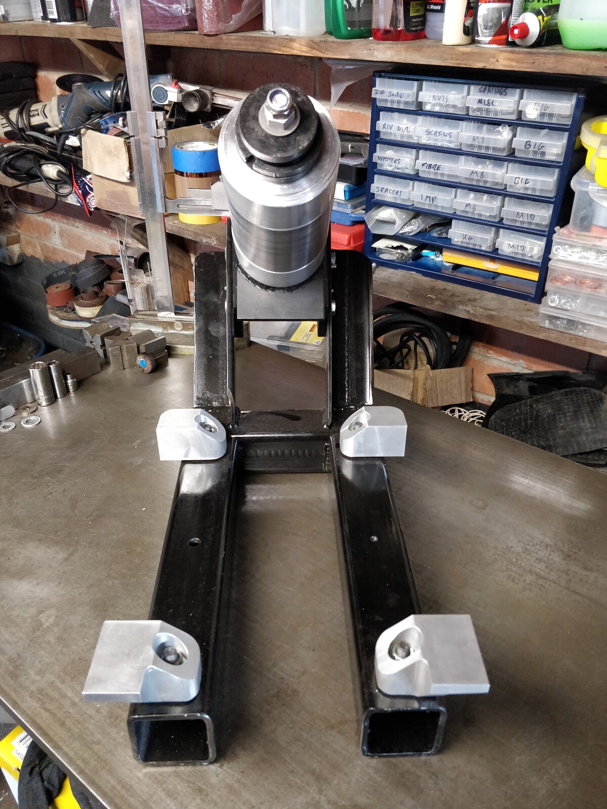

    All ready for some tubing and a really good welding session, should be finished by the end of the week!

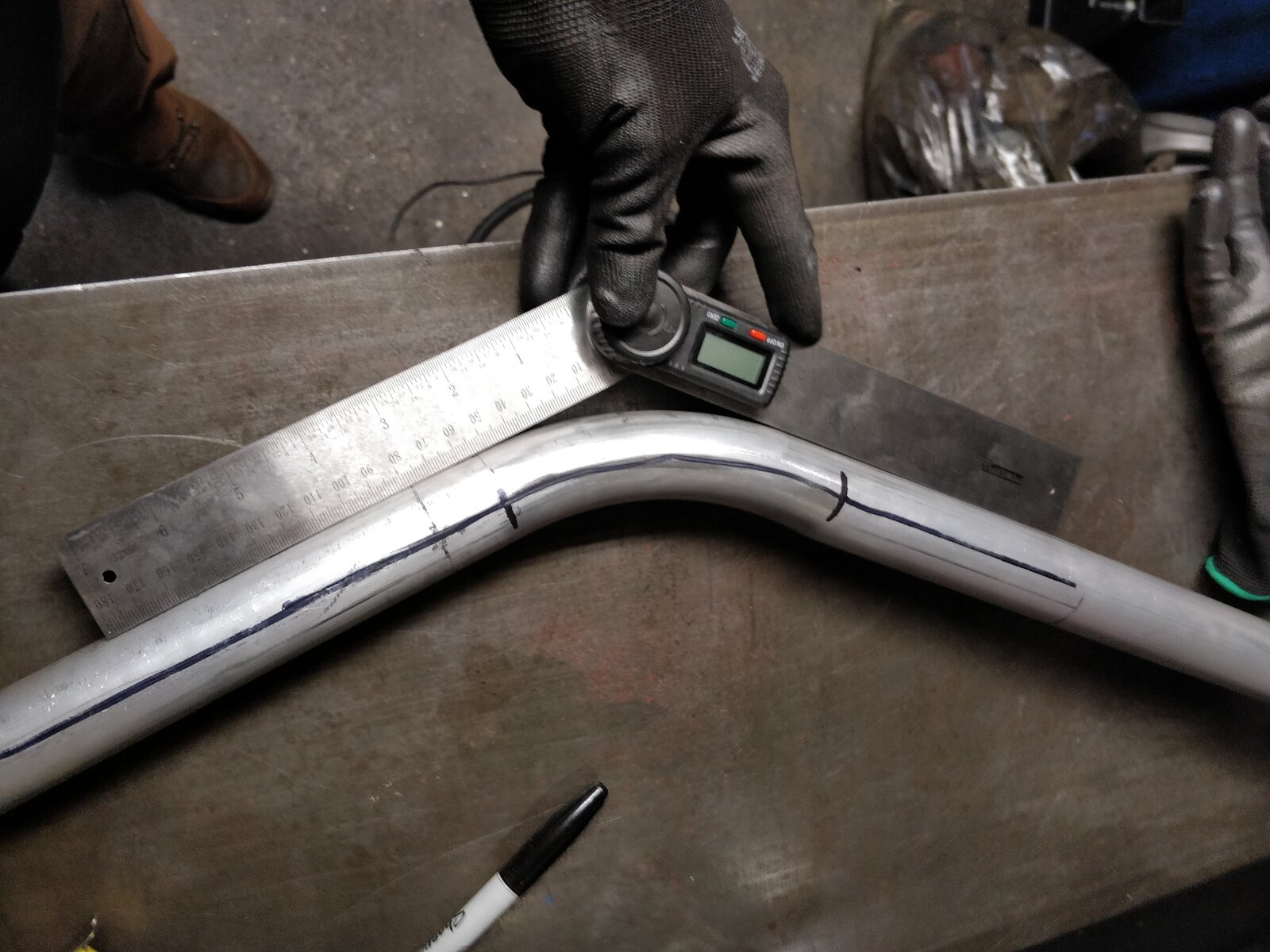

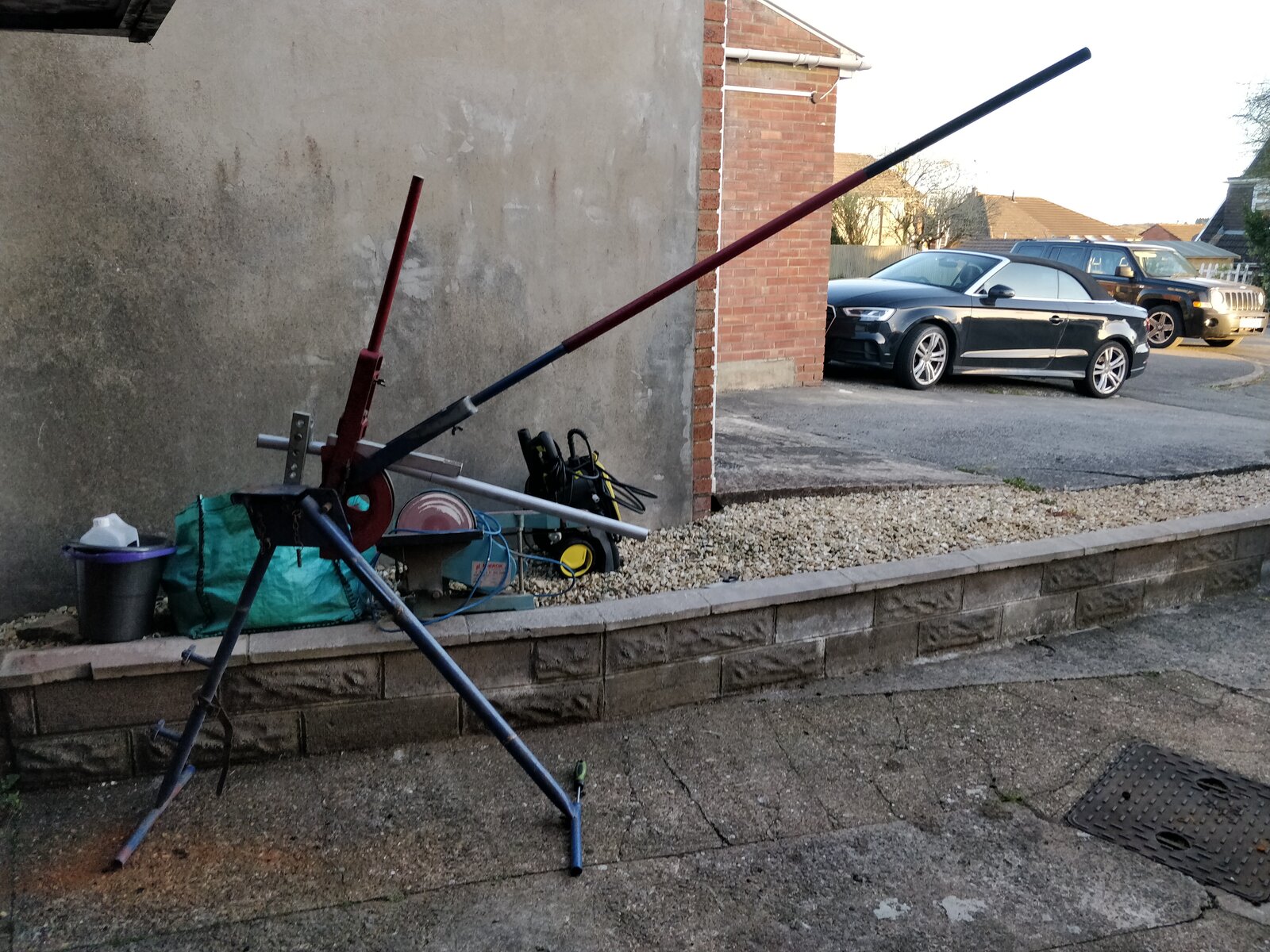

    I had a go at bending some tubing this evening, I must of been delusional thinking it would be easy to bend 35mm 4mm thick aluminium, you just need 'some' leverage.

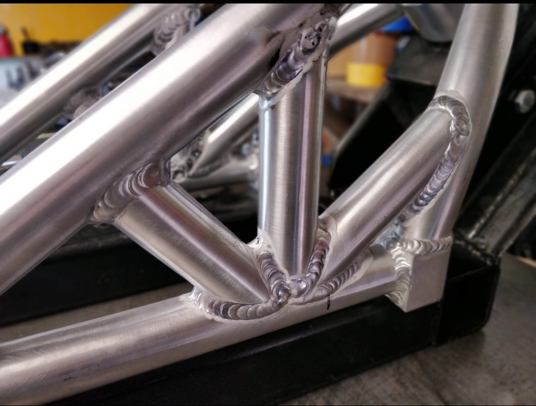

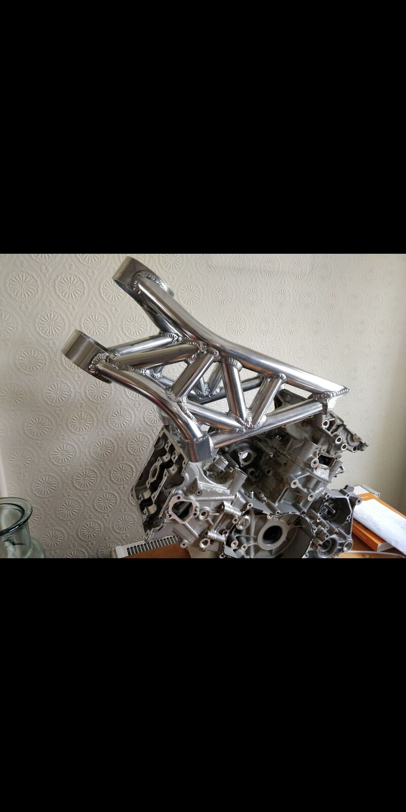

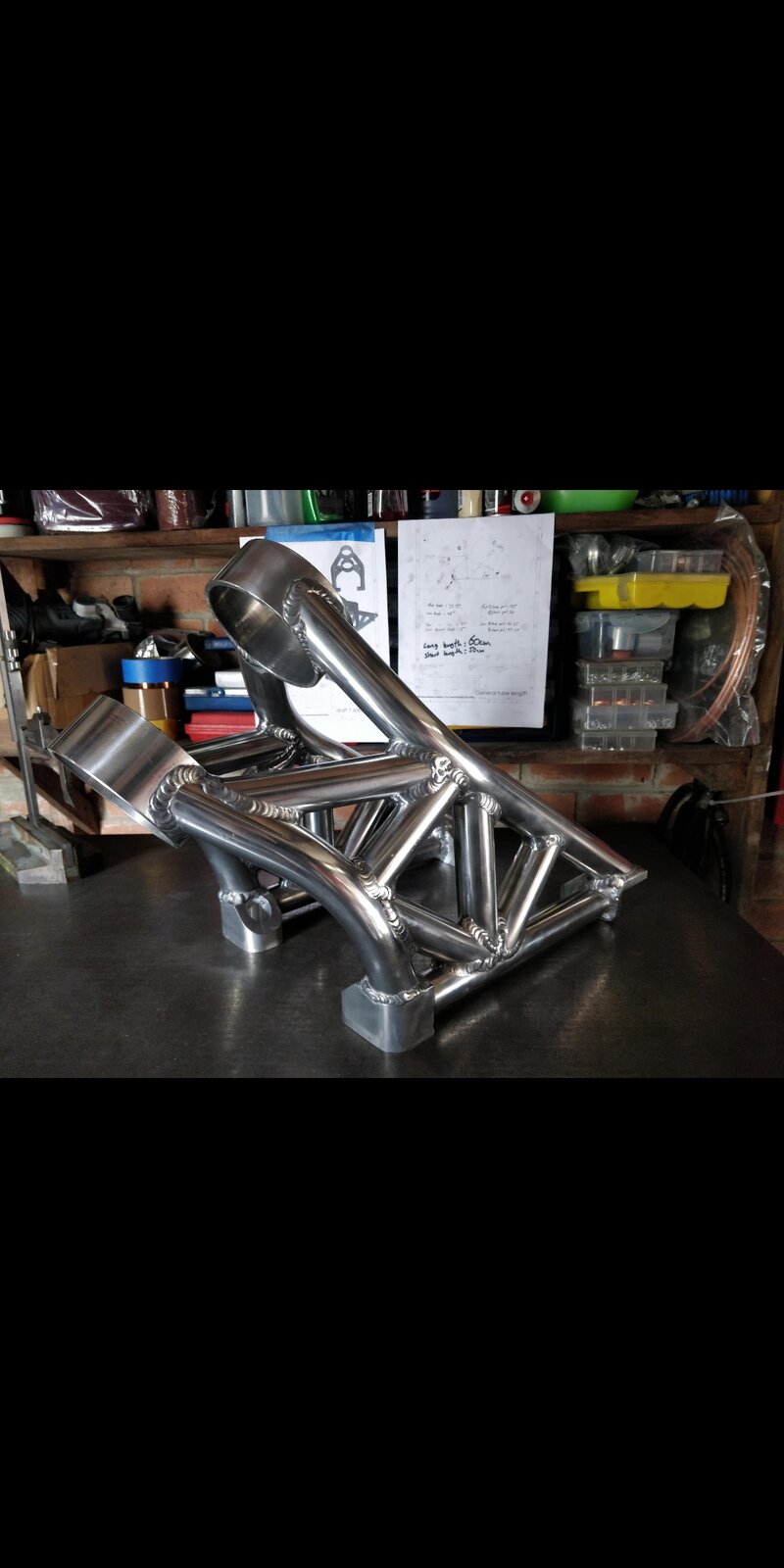

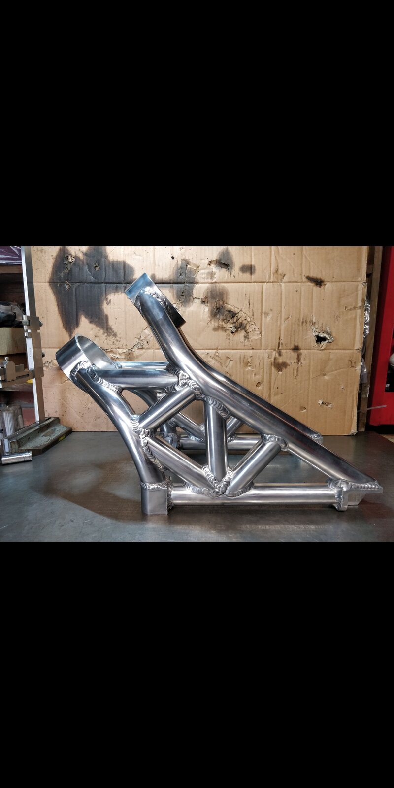

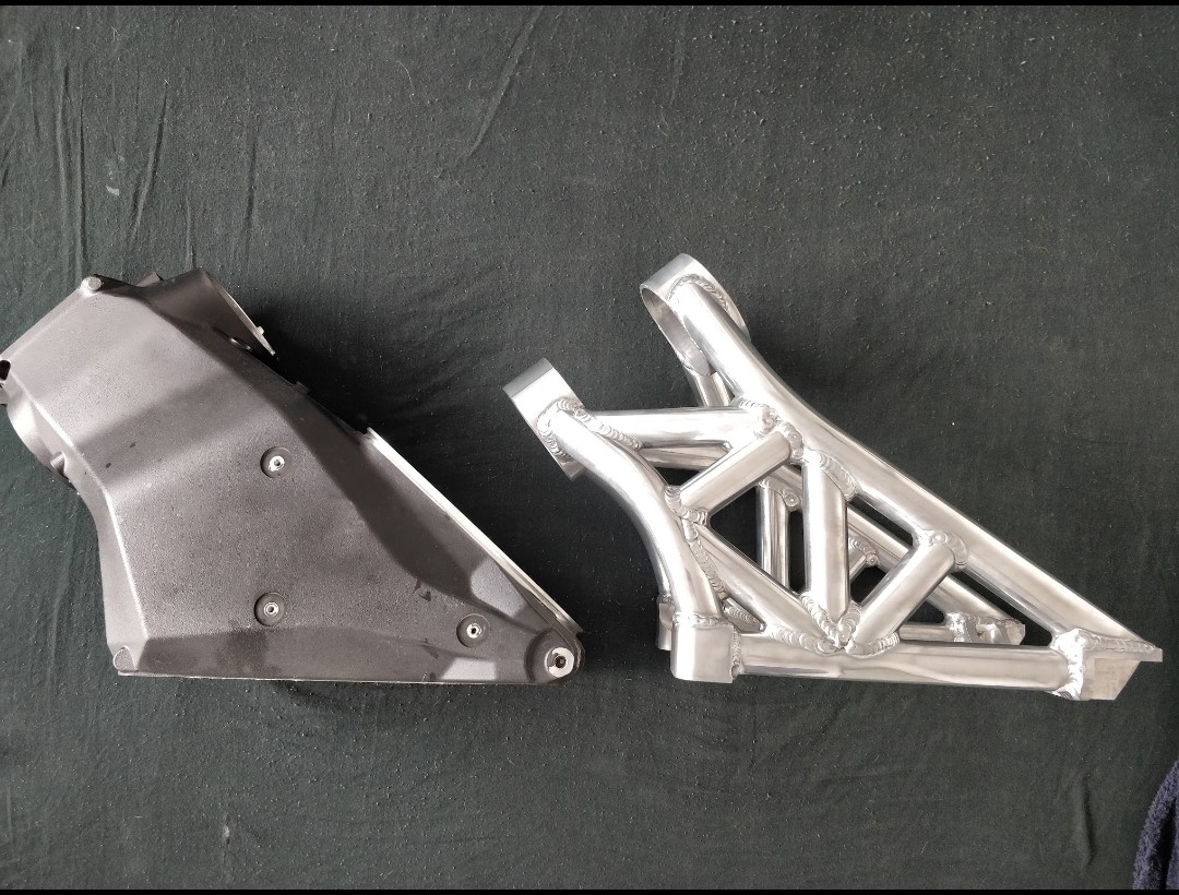

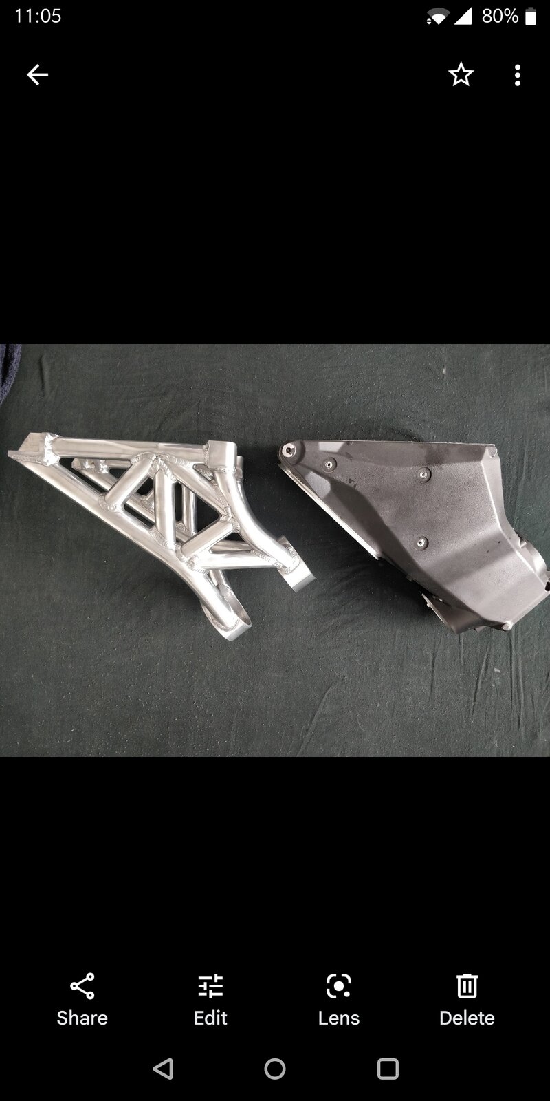

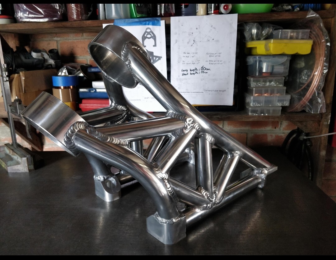

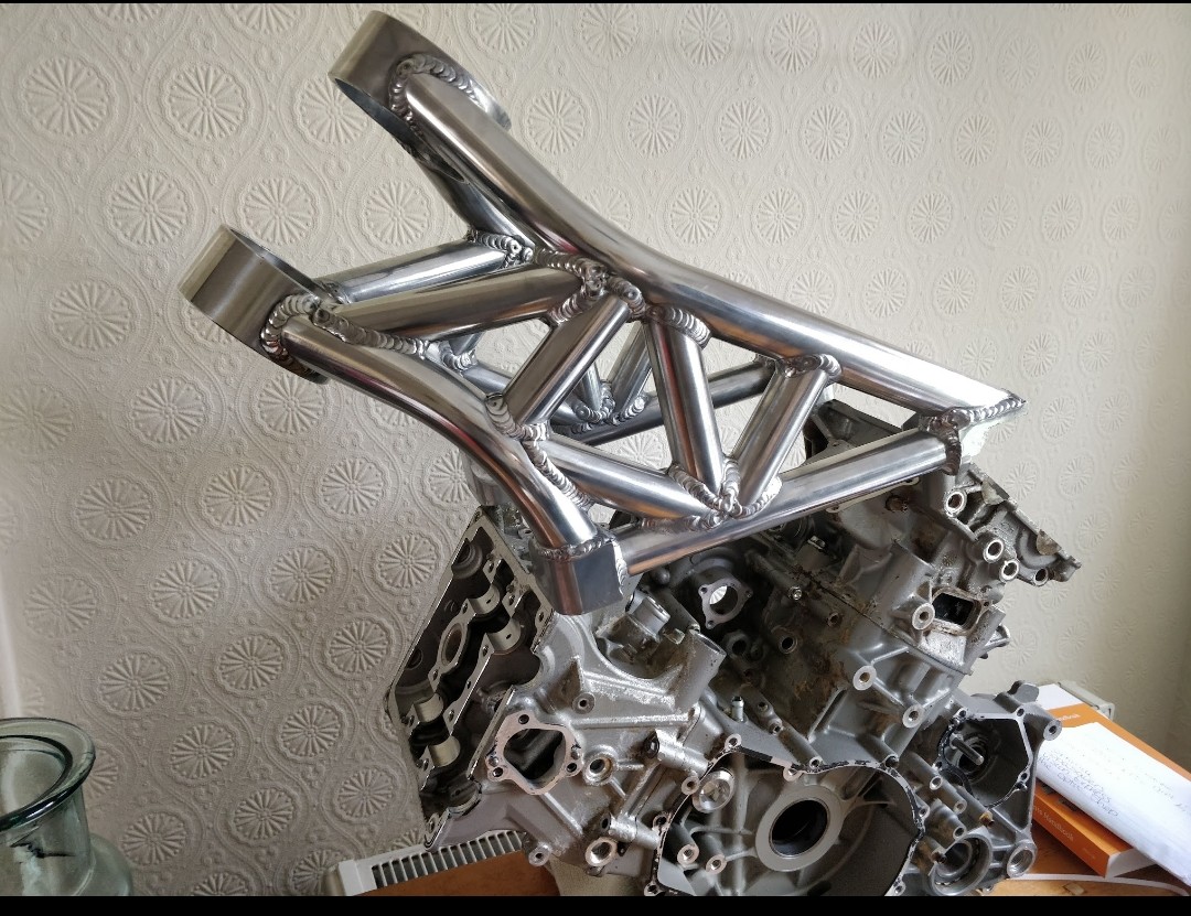

    Sorry folks, I completely forgot to post any photos of the finished frame!
    Here's some more;
    Screenshot_20220910-110536~2.jpg Screenshot_20220910-110514~2.jpg Screenshot_20220910-110501~2.jpg
