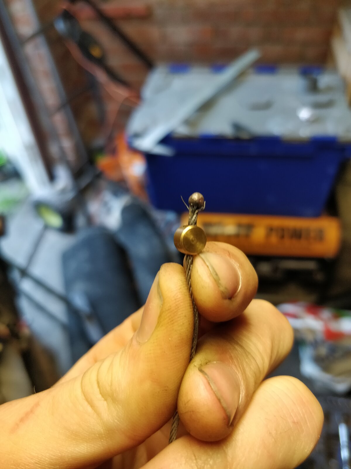

    IMG_20190606_180201.jpg making a custom cable was a bit tricky, after a few attempts I found it easier to tig weld the end and let it ball up then shape it with a file.

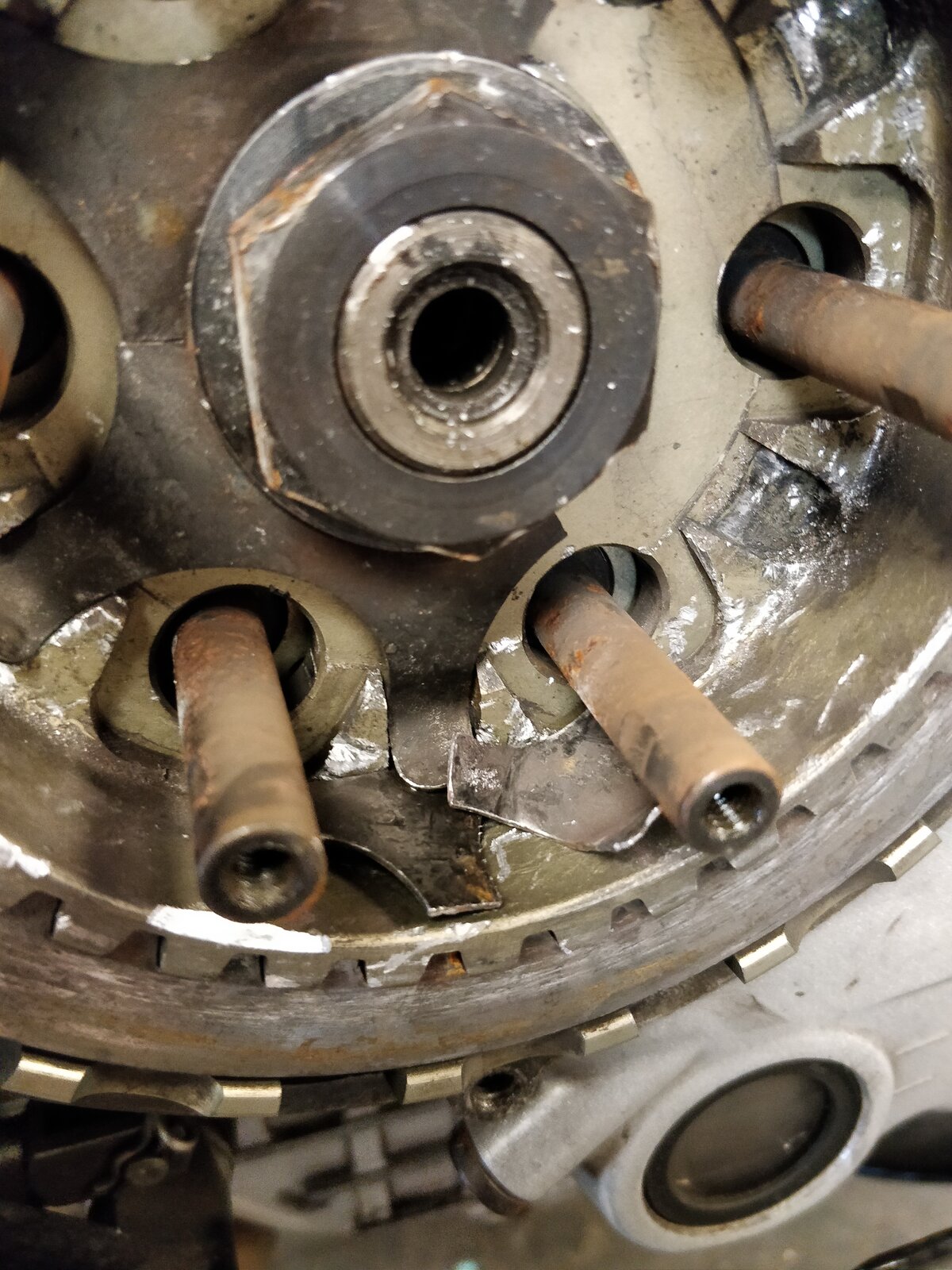

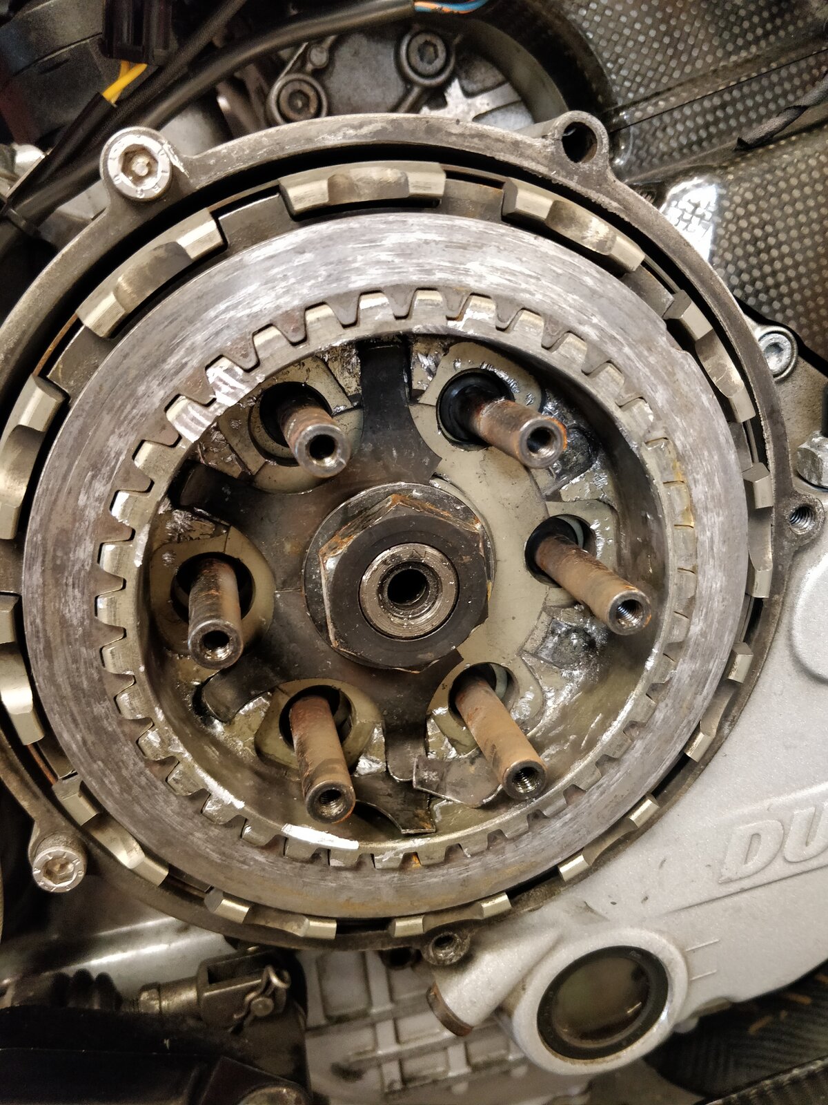

    Broken spider spring, managed to find a fairly cheap corse clutch to put in. So far so good... apart from my wallet!

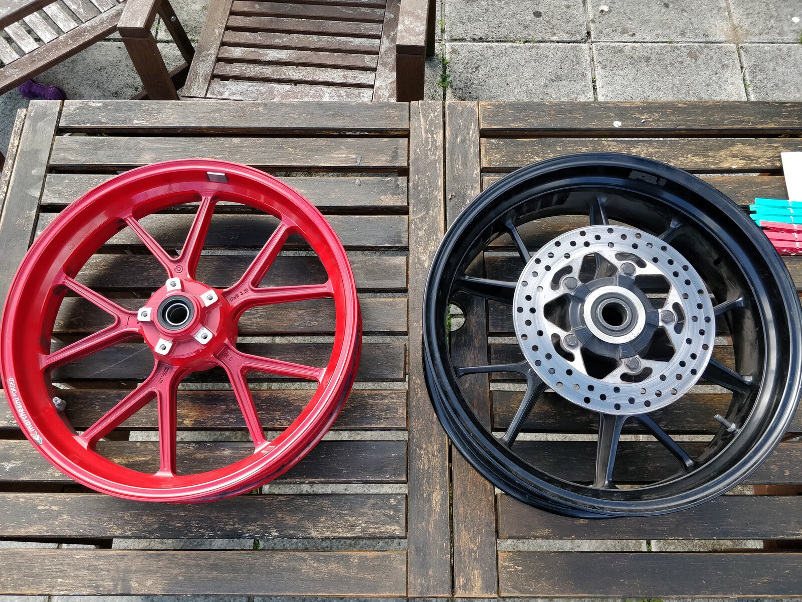

    This bit did make me laugh... Remember back at the start when I sold my spare set of wheels? Loads of people told me not too, and yup.. they were all right. Managed to find another set in Italy at a good price with a fantastic surprise!!! IMG_20190701_180456.jpg
    Very good condition forged front! I was over the moon when it arrived! Quite excited to see if I can feel a difference. A friend of mine did a masters degree project on steering torque and the front wheel gyroscopic force had a large effect so hoping this should help, with Micheal Neeves on the university panigale he was using 160nm of torque through crainers at donnington to pull the bike from right to left bank angle, really really impressive.

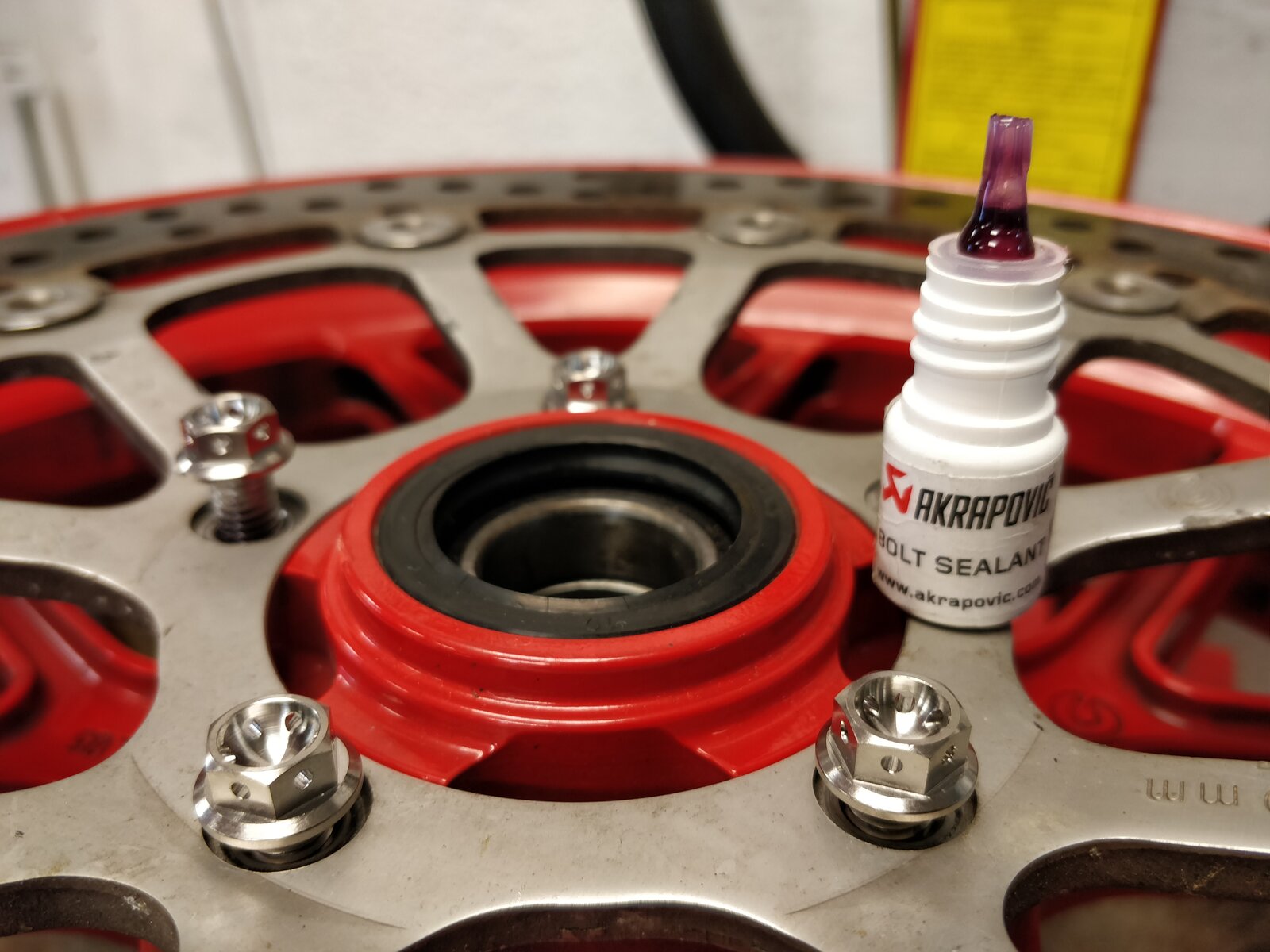

    Titanium drilled bolts with Akrapovic thread lock, is it any good?.....not really, but it's purple and looks good in a picture!

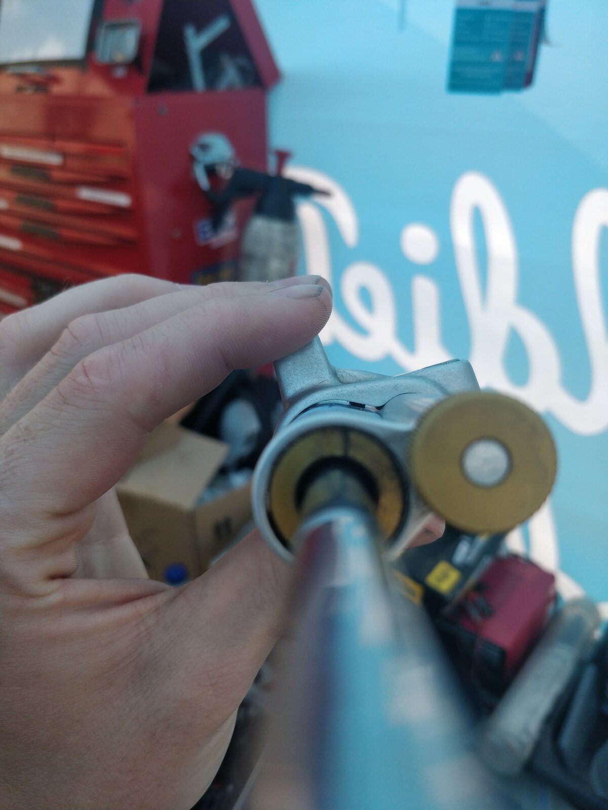

  5. Another issue I'm still battling is the steering damper, has an awful lot of stiction. What's it's moving in the stroke it's fine but it makes the bike horrible to ride, replaced both spherical bearings with the correct SKF units (GE6C) if anyone is interested.
    I'm away to the Manx on Sunday for a week and I'm looking at either getting a rebuild kit for it or just sending it away to get rebuilt. It's getting frustrating now, bike feels amazing without it and is stable enough not to kill me... But I do like having it just incase, it's saved me before.

  9. You ought to learn the art of soldering cables. Those loose strands of wire at the nipple will give you grief sooner or later.
    Nice job your doing otherwise though.
  10. I tried....alot, didn't stick to the stainless wire. Even with blow torches and many a YouTube tutorial!
    Am I missing something?
  11. No, just TIG weld em like you said. That’s what we do at work with the cables we use, (a lot thicker diameter but same principle).
    Cracking project BTW
  12. I didn't realise that you were using stainless wire, although there are specialist solders that will work with stainless. If TIG works that's fine. It's just that loose strands tend to unwind and jam the cable.

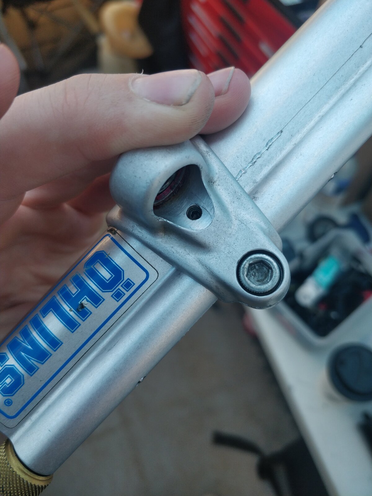

  13. So, I'm at th Manx with the uni team and there's a k-tech guy in the paddock so I thought I'd let him have a look with the steering damper.
    Figured it out really quickly, it's not supposed to have that grubscrew.
    It's clamping on the piston tube and creating a dimple on the inside which is making a tight spot in the stroke. It can be honed back and repaired apparently so it's not a total loss. My bike has always felt really weird midcorner and I've finally found out why!

  15. I have the standard Ducati, non Ohlins damper and I’m amazed at how well it works.
    It seems to work on air pressure, so a small or slow movement results in little or no damping and you can’t feel it.
    It’s only when you assemble the washer and o ring in the wrong order and get no damping at all that you realise how efficient and effective it is and how often the front wheel has little contact with the tarmac.
  16. Yes it is. You're just not supposed to overtighten it.
