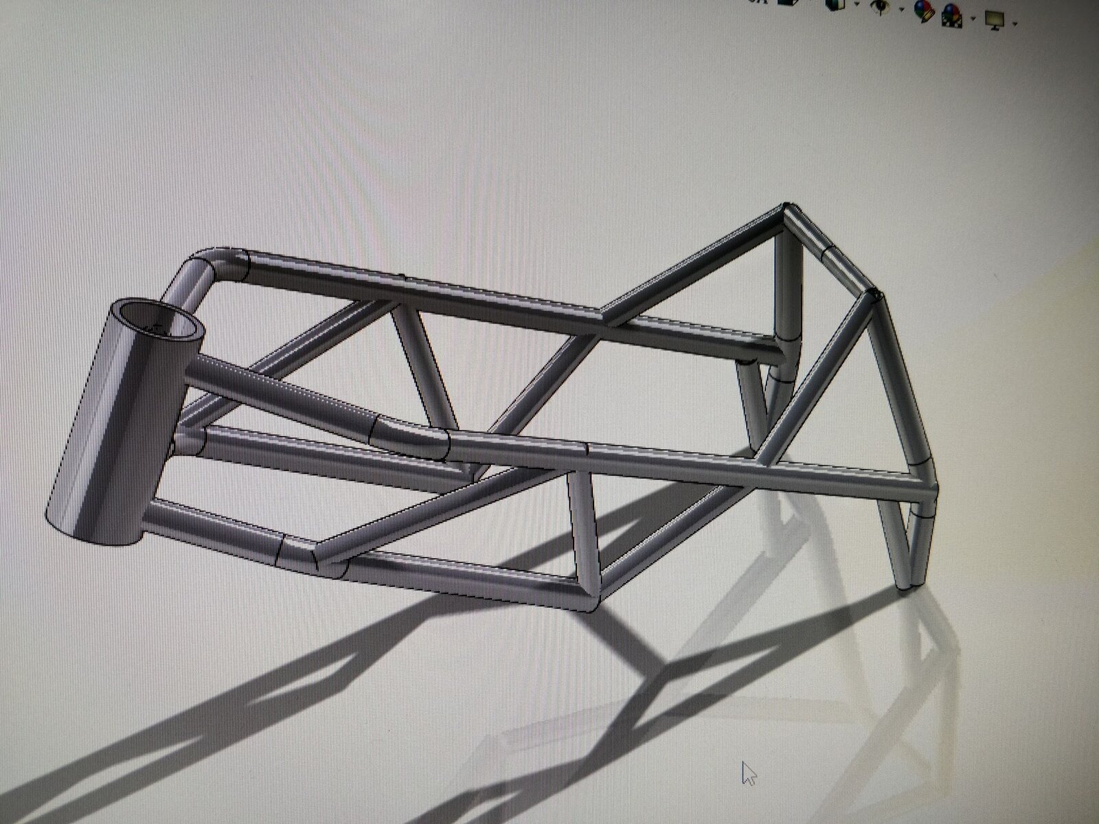

  3. The idea is to reverse engineer why they made it the way they did, once I find out it's stiffness I can design the Pani one out of anything as long as I compensate for thickness. I've also recently learned that it's probably better to make it out of aluminium. As the frame is literally a giant spring, which has natural damping, making it out of aluminium tends to have better damping characteristics for the frequencies that a bike tends to operate in, reducing nasty things like chatter. Which is why most sportsbikes have aluminium beam frames...along with the new V4's!
  4. Although I'd love to do a steel frame with silicon bronze brazing... It's just so sexy IMG_20190819_163027.jpg
  5. So last year though, which is why I mentioned Ti - but large thin wall alloy tubes would look Phattt :thinkingface:
  6. I seem to remember a long time back (70's?) They made frames stiffer and stiffer till the bikes were unrideable until they learnt to build in flex.
  7. You're correct sir! From what I understand it's been up and down. Problem is there isn't a standardized way to measure stiffness, every manafacturer does it in a different so it's a bit of an awkward thing to measure

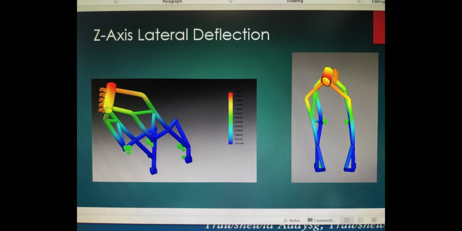

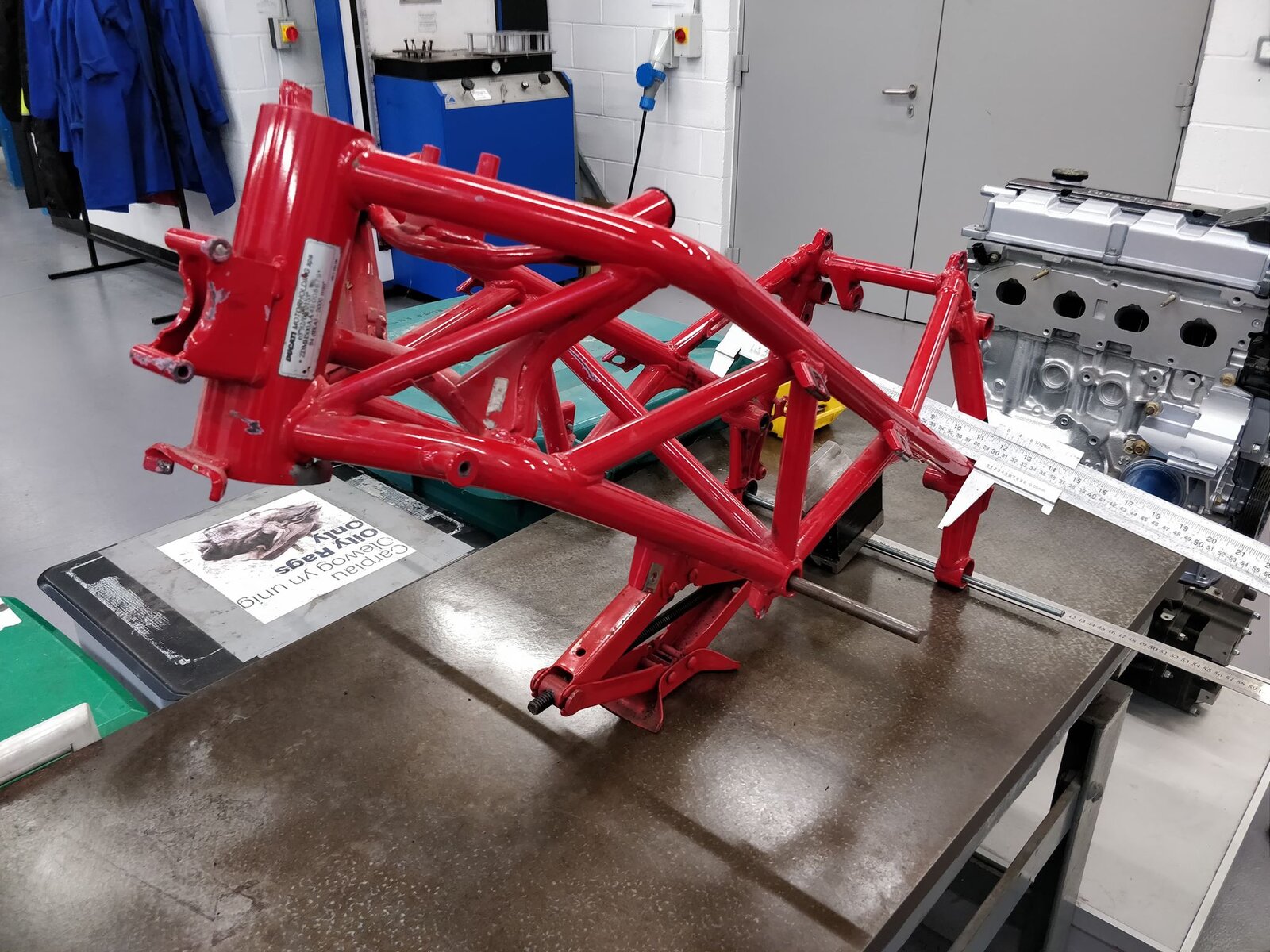

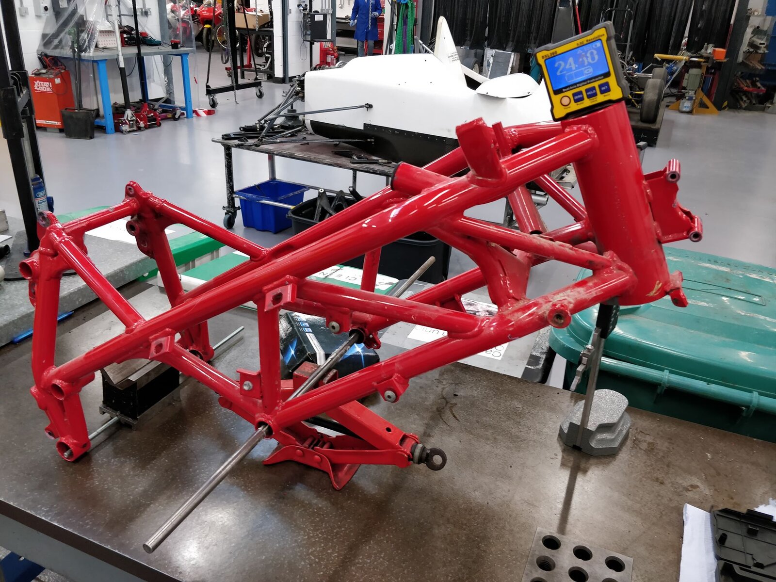

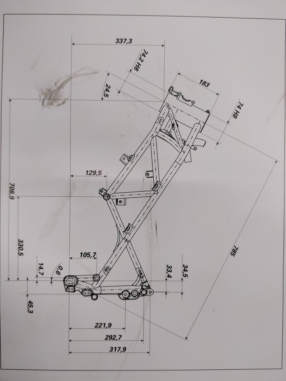

    As I've said before, I'm weary to touch the frame and structural areas of the bike without knowing pretty well what I want to do. I can deal with the fairing flying off, but the frame snapping... Well, I reckon it might ruin my day.

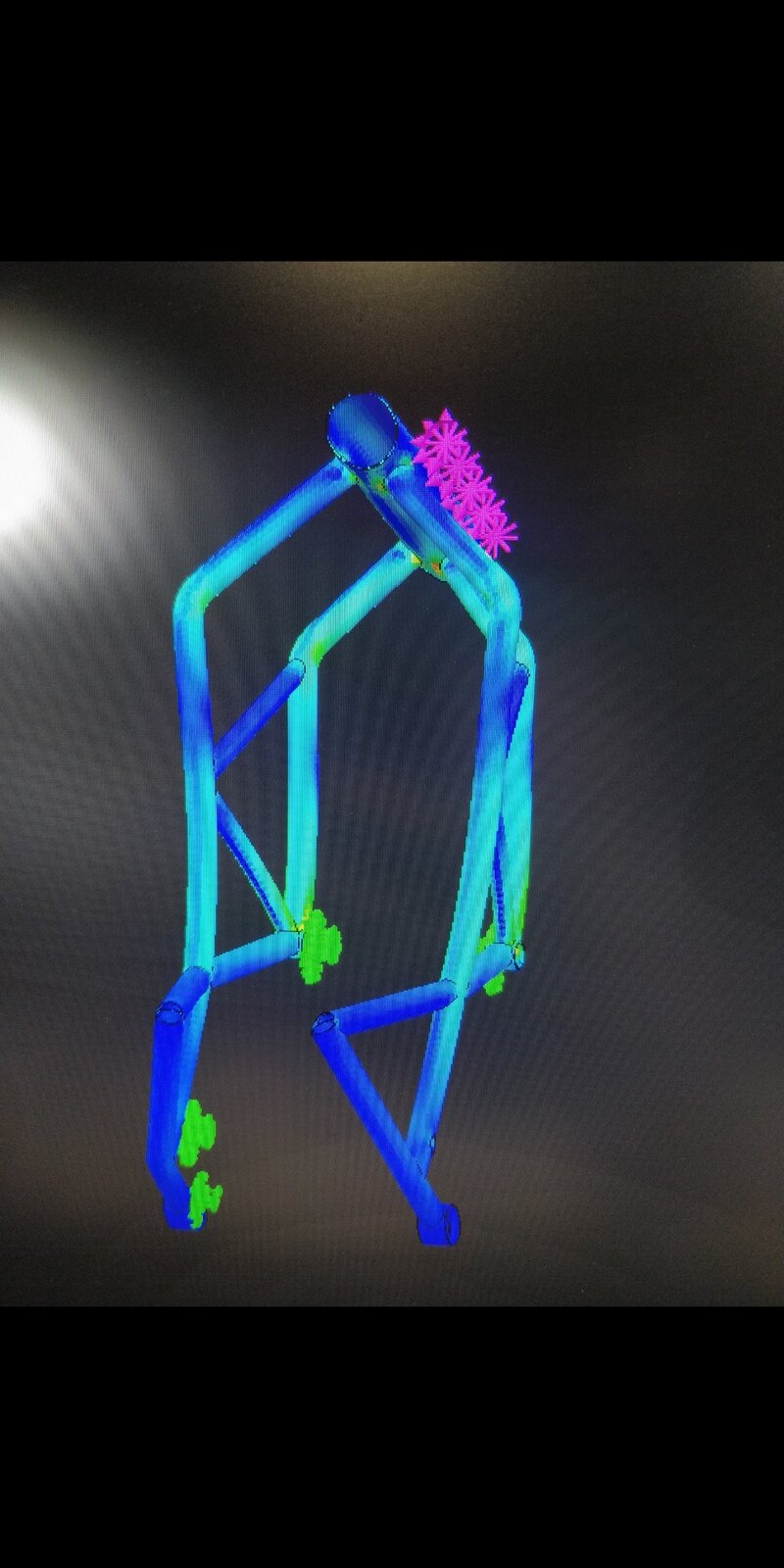

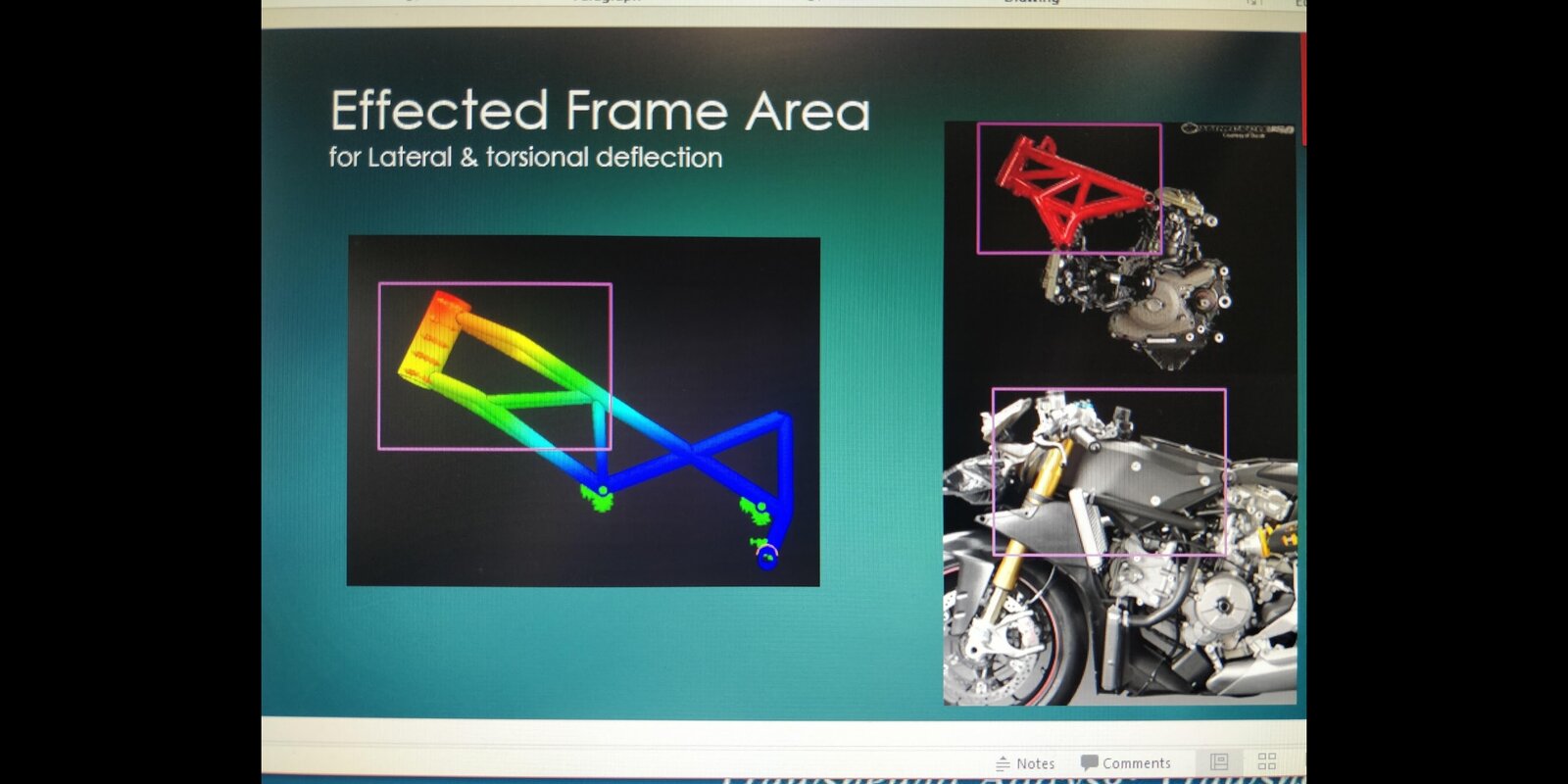

    I've started looking into why the 999 feels the way it does by the way it deflects in the different degrees of freedom, with an end goal of a direct comparison with a 1199s in a jig I hope to make in the coming months.
    Interestingly a lovely gent on the 749/999 Facebook page let me borrow his frame which was heavily damaged after an accident, the FEA actually showed the frame to deform almost exactly the way the real frame did after the collision (not the pictures above, that's a lateral deformation only).
    The image above is quite interesting, the coloured area is all the matierial that actually 'flex's' when load is applied laterally on the tyre for example at high lean angle going over a bump, longitudinal deflection (braking force) shows a larger area of deformation and proves that the 999's did need the reinforcement bar of the corse bikes, and why the 1098's had a thick upper rail. It pretty much shows why Ducati went the way they did with the monocoque design of the pani and reduced frame design of the monsters, no point adding matierial if it's literally doing nothing. Various sources have spoke to me about the design brief for the panigale series, and where the flex characteristics came from, interesting... And helps me design my frame.
  11. I should also add that those pictures above are from an early stage of the model, Not realistic.... Just pretty colours!

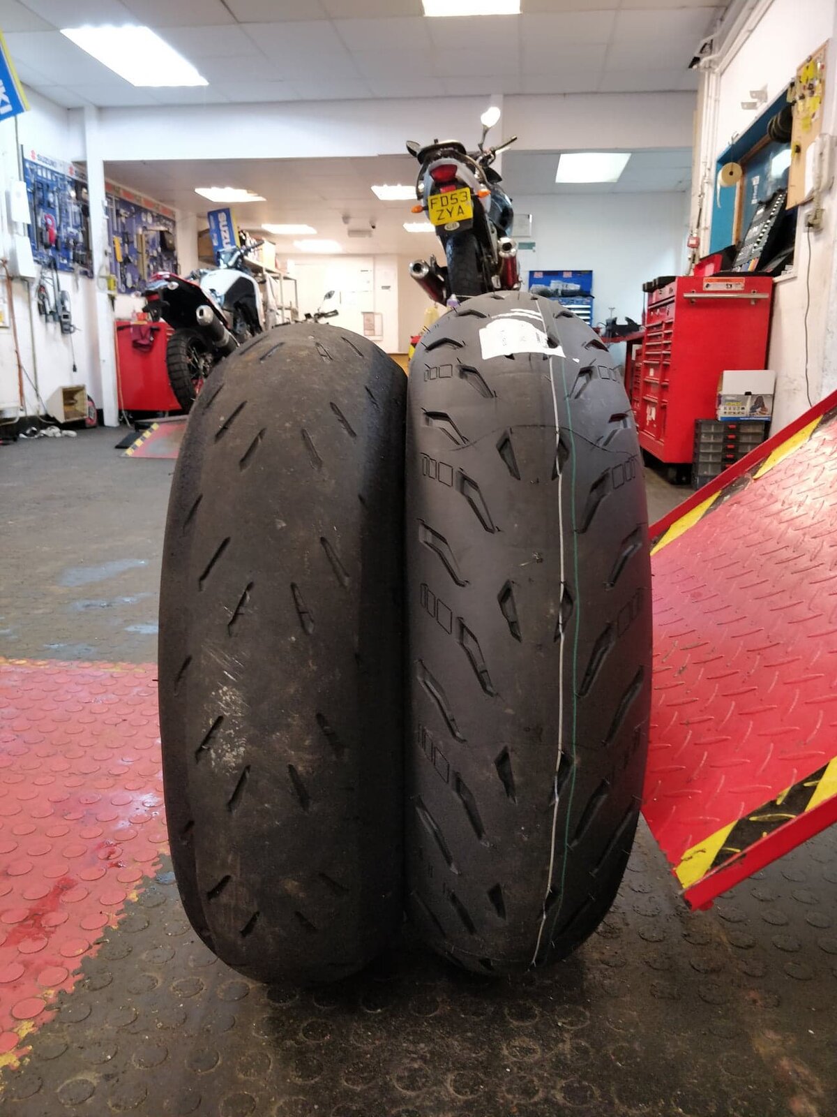

  15. Managed to get out to Oulton park in February, it was soaking for the first three sessions then started to dry. I went out on standard rims and a new Michelin Power 5 tyre, I like the older RS for the road but it was just too soft on the edge for the track. I Really like it! I didn't get a proper hot lap on it, mostly trying to not die in the damp. Had a proper proper moment and lost the front at Druids, the front understeered for about a foot... I calmed down after that.
    Then it started to dry out so I switched to the forged front and Supercorsa's. It's quite a nice subtle difference with turn in with the forged front, I was forcing myself to be honest and see if I could actually feel a difference, I did! Plus... the bike looks pretty cool with her black and red shoes!
    Quite a difference in the attitude of the bike going from part worn RS to Power 5! Noticeably more tippy.
    (only changed as the RS had a puncture)

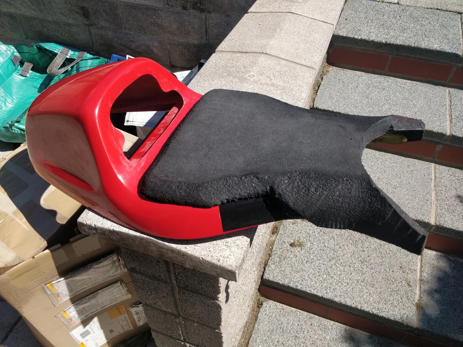

    The seat is starting to become an issue!

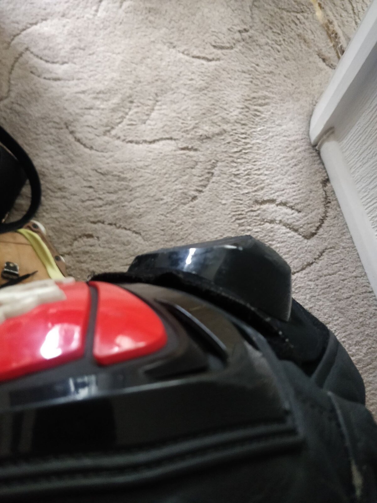

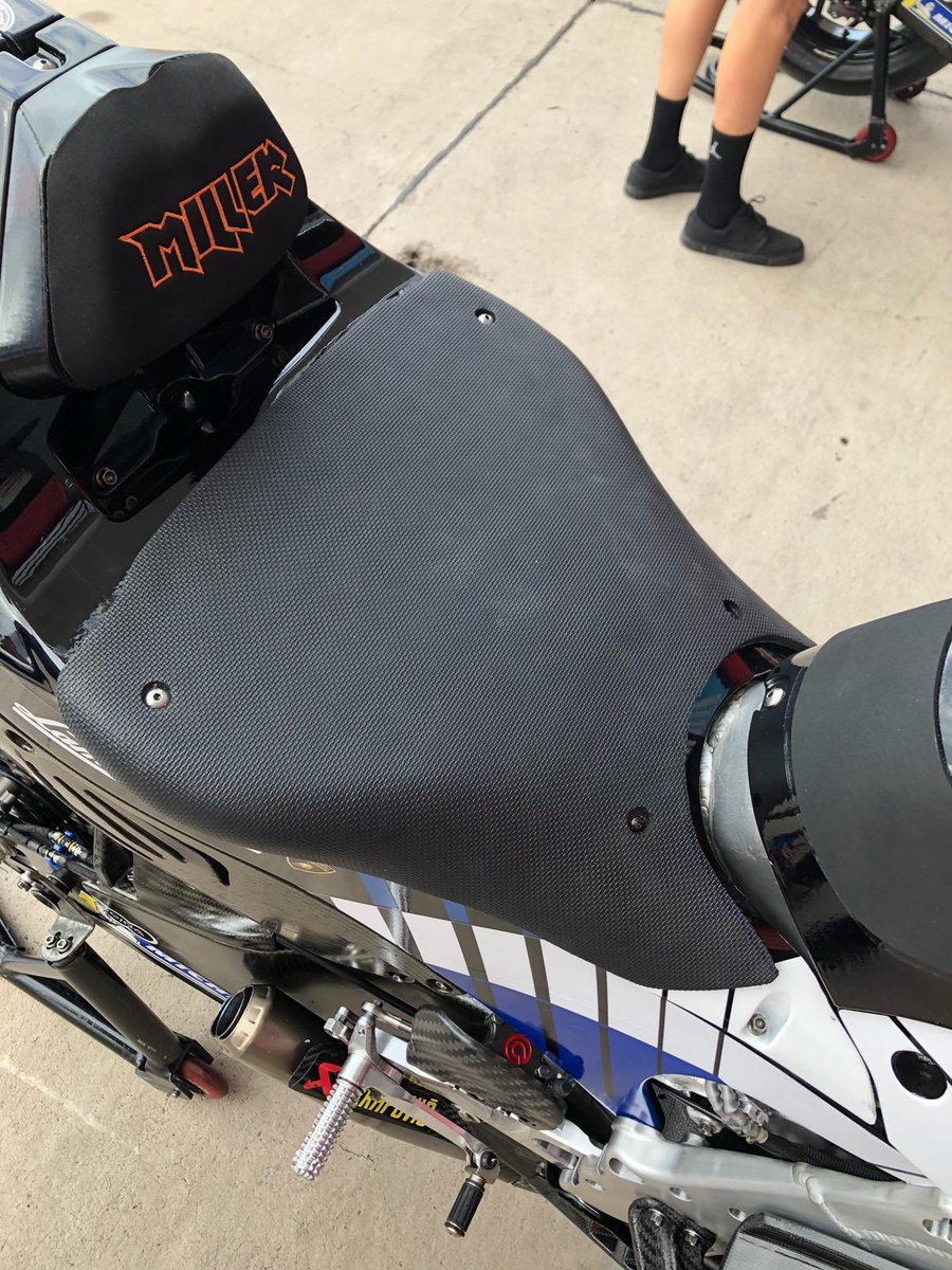

    After a two day trip to Snetterton I noticed I can only get my knee down when the bike is almost on the edge of the tyre, I can't get my arse enough off the seat to hang off properly.
    The imola style seat is probably about half the width of the standard 999 seat, and compared to Jack millers bike... yeah, its tiny. Thankfully I've stayed off the pies so my arse can fit on the thing!

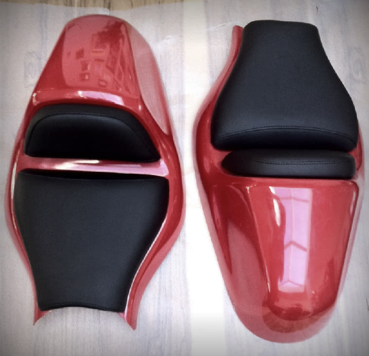

    So I've ordered the 'Diopa B0330', the seat I actually originally wanted for the bike but at near enough €500 it was a bit daft. So i managed to get an unfinished one for less. Ideally I'd like to make my own from a fibreglass, but I'd rather have one I can quickly order again if(when) i crash the bike.
    A nice bit wider but still keeping the bike looking nice, which is obviously the most important thing.. if you can't go fast.. look cool! That rear cushion also comes off so I should have nice access to the battery to charge it
    You can see how funny/awkward my body position is and how funny my knee slider wears! I have Knockhill booked on the 14th of August so it should be sorted by then for a test.

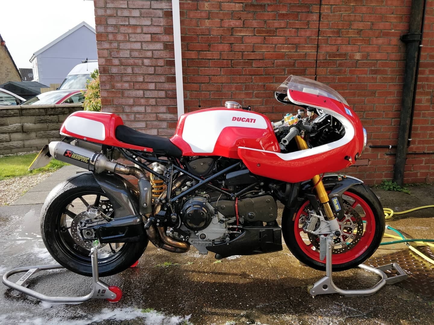

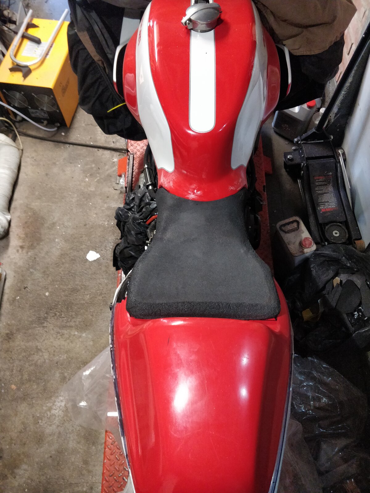

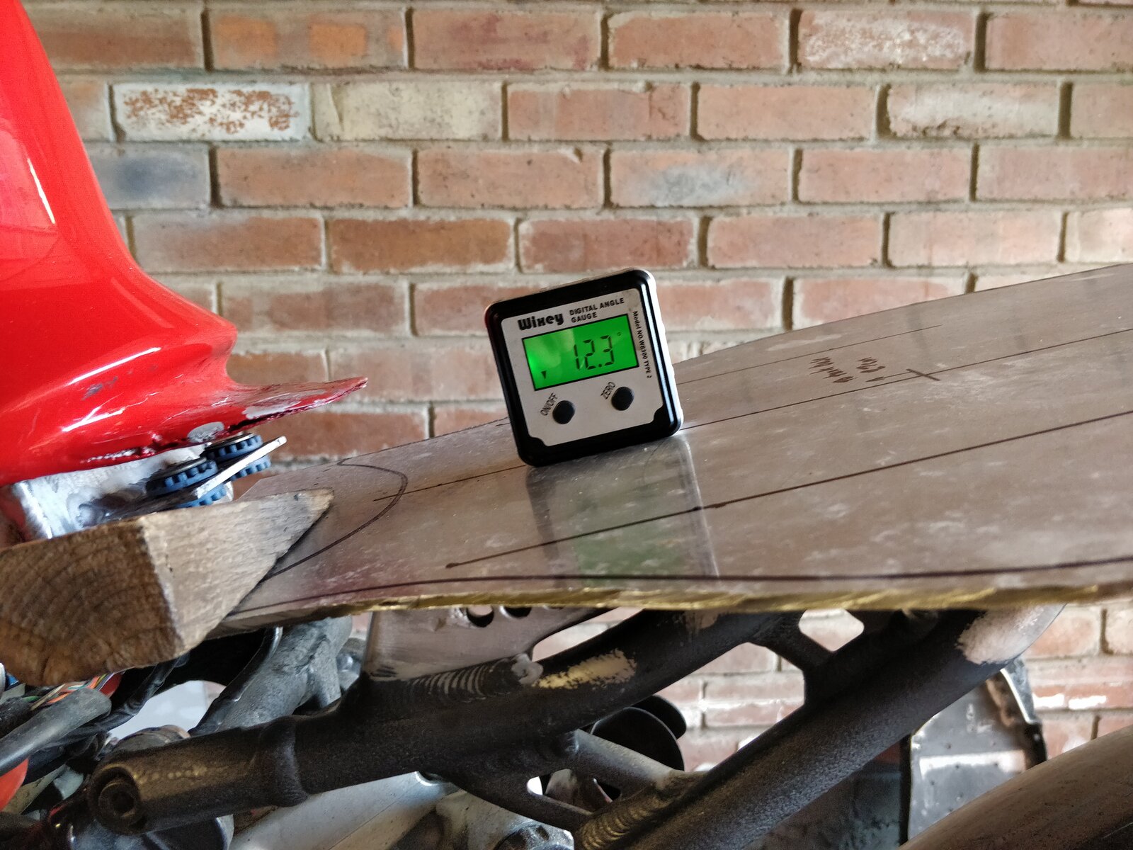

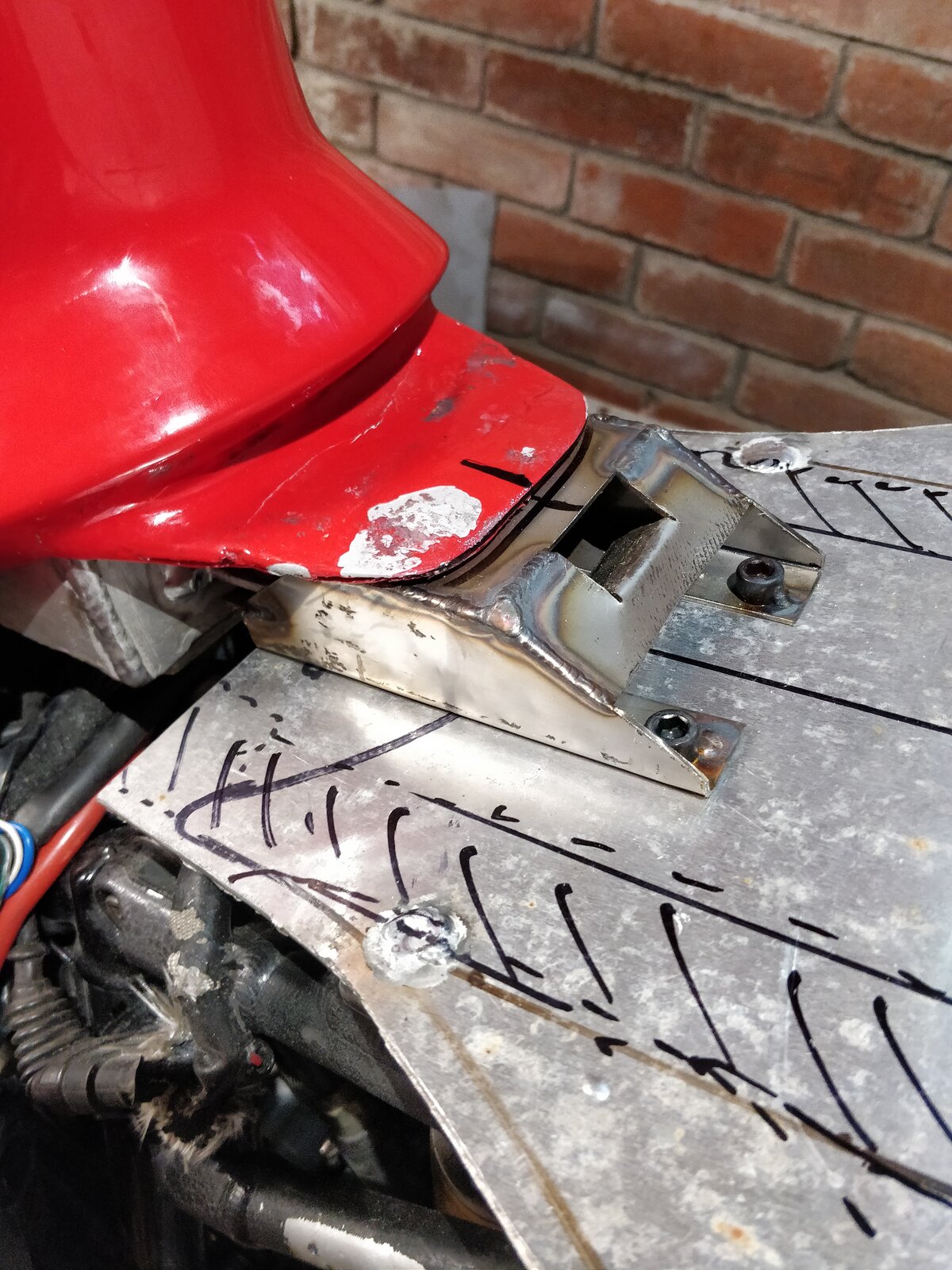

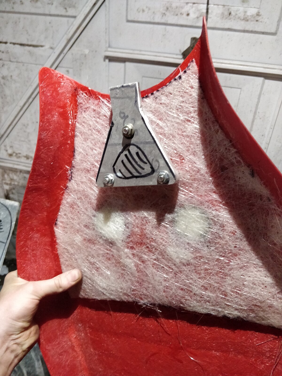

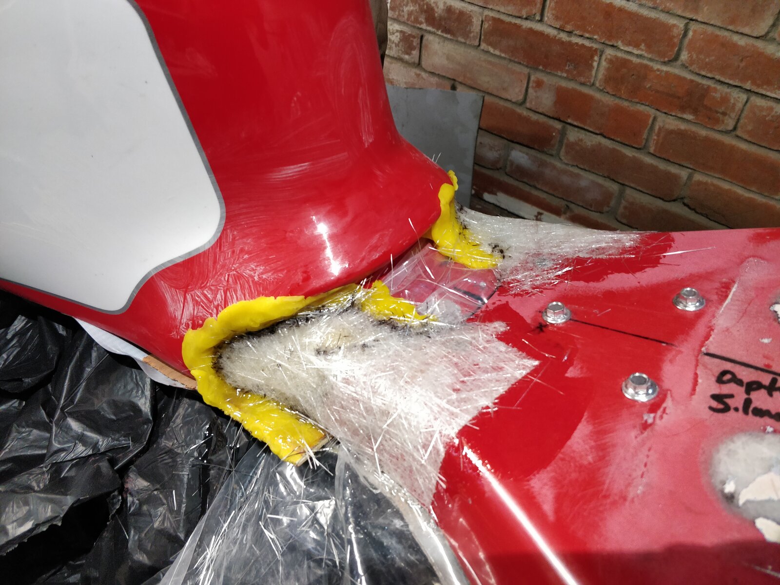

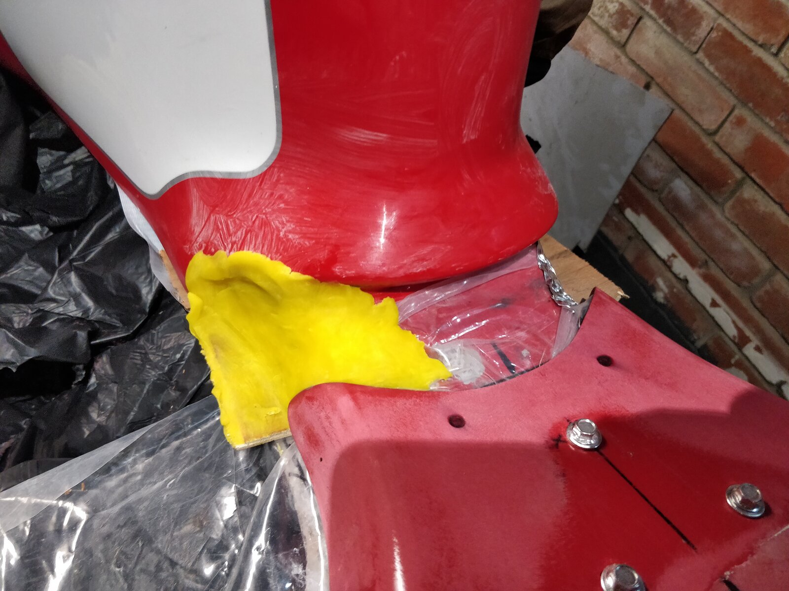

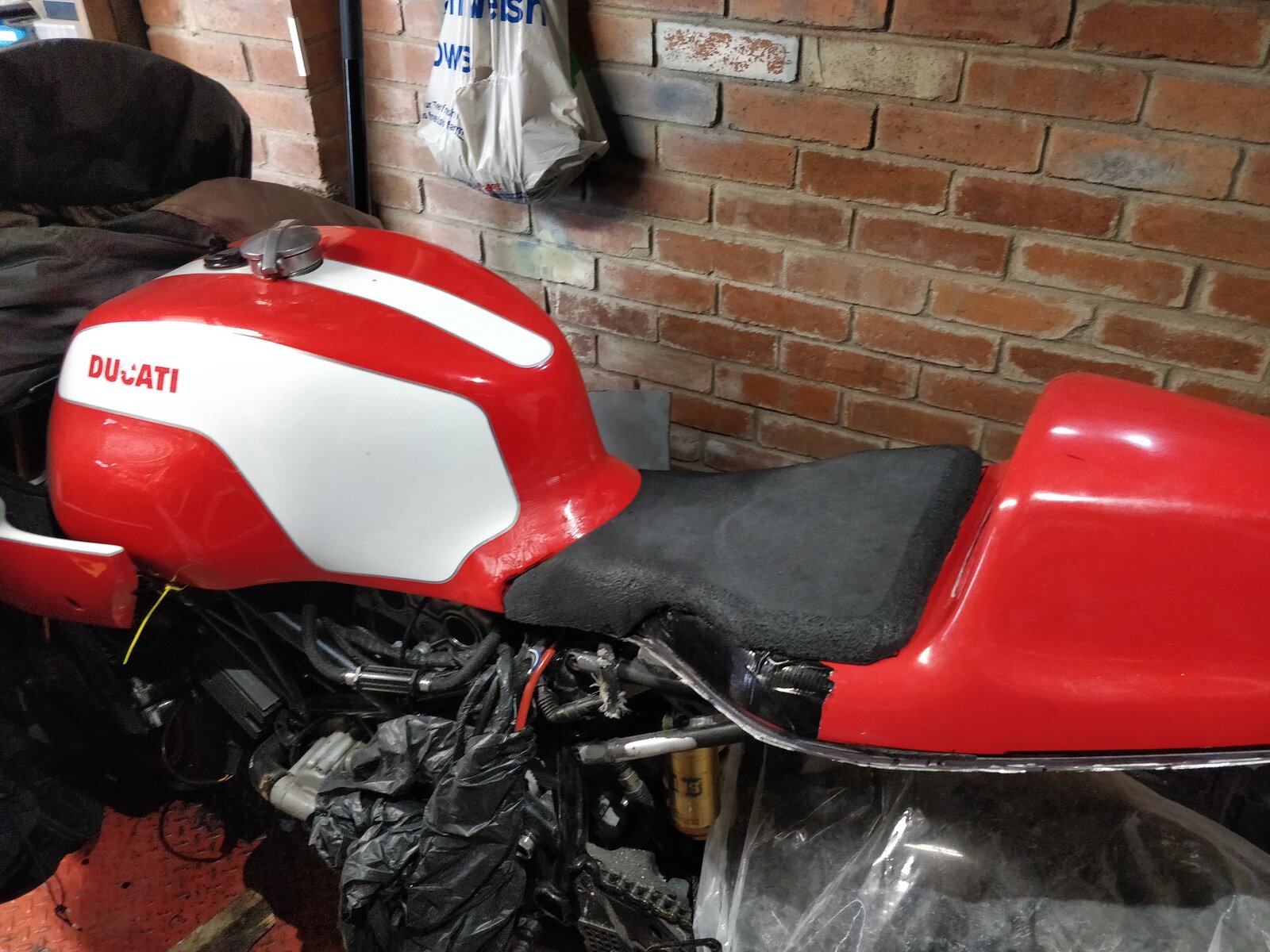

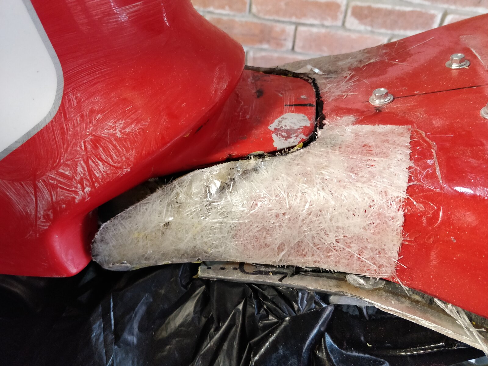

  17. Seats starting to take shape! IMG_20200719_113848.jpg IMG_20200719_113857.jpg
    I based it around the 2020 GSXR1000R height, forward angle, width and length.
    IMG_20200714_201202.jpg IMG_20200714_201210.jpg IMG_20200719_111218.jpg IMG_20200717_191727.jpg IMG_20200717_195157.jpg IMG_20200718_181335.jpg

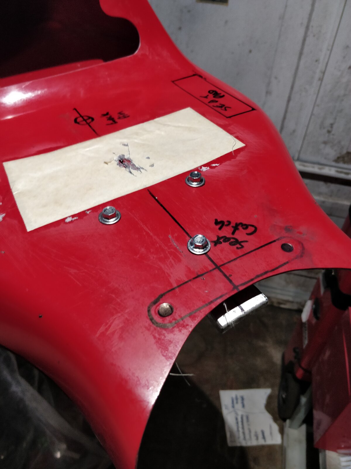

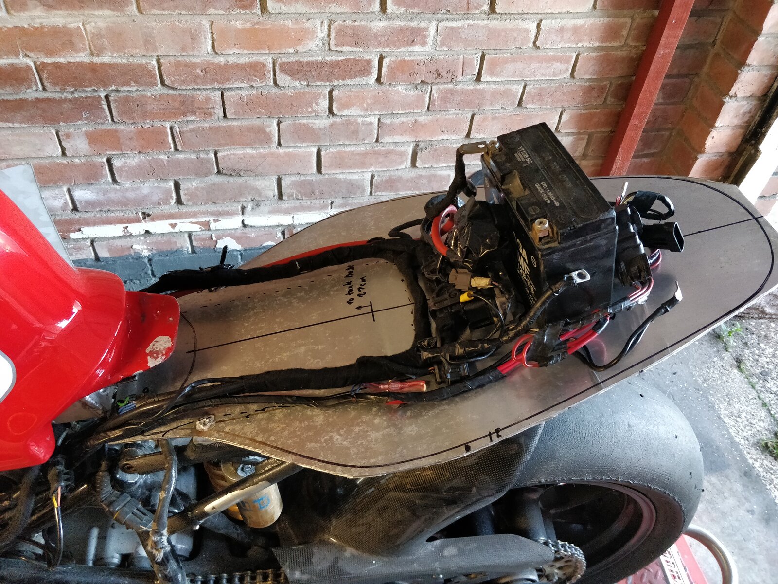

    Plasticine stuff from easy composites makes it super easy to make moulds, wish I knew about it literally years ago. Also the seat now has a latch from a KTM with a pull cord, the old seat started getting a bit worn on the bolt holes where it used to mount. I'll put up some pictures once it's all finished. I'm not getting the foam covered professionally or the seat painted til I've done a few trackdays and road miles, I really need to make sure I'm happy with it.
    Everyone always asks where the ECU and battery goes, really would like a lithium battery that one it's pretty heavy. I can see me cutting out that aluminium plate and replacing it with a sheet of carbon, the bike already has a funny weight distribution so id like to lighten the rear.

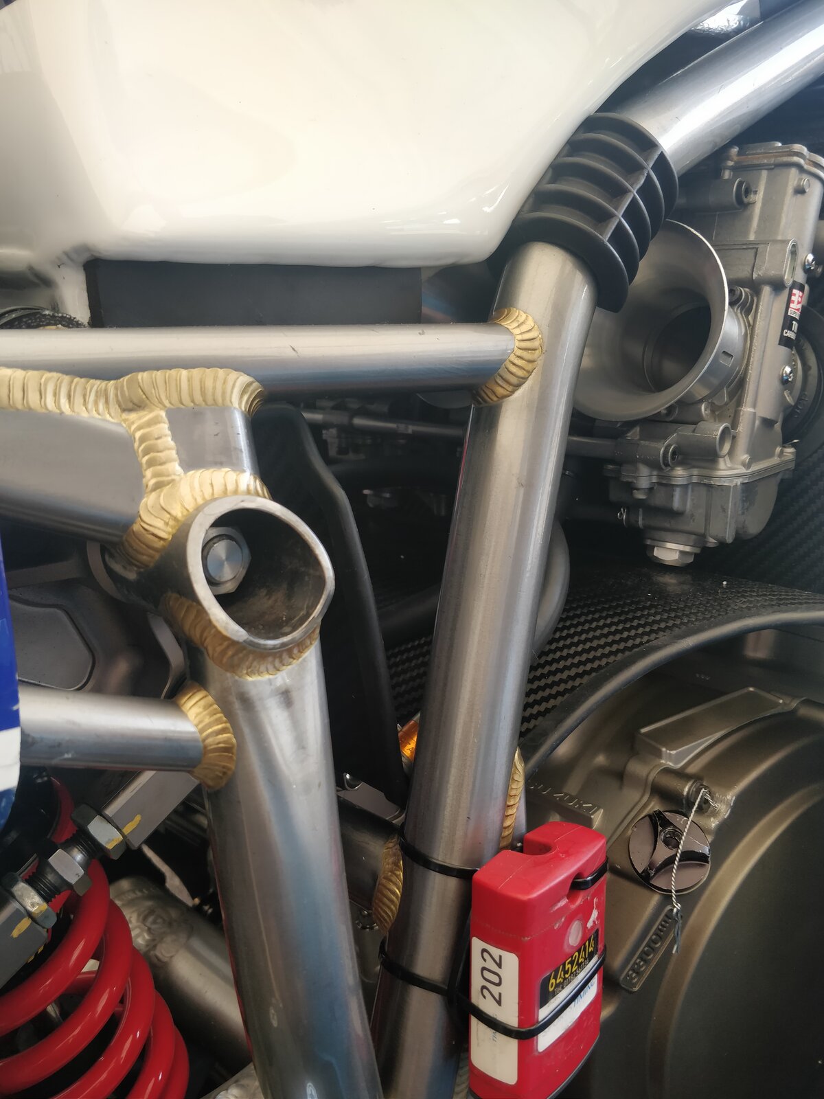

    Another hour went past and we were starting to head back, the dash vibration had come back though despite the softer suspension. When we pulled over for the final fuel stop i noticed the entire front subframe was cracked, mostly likely due to the hard suspension and scottish roads. The rest of the drive back was spent with my right hand on the throttle and the left hand holding up the fairing and supporting the weight so it wouldn't get any worse. Normally I blame myself for poor craftmanship and crap welds.... but I didn't make the front subframe, it came with the bike!
    I managed to nurse it home but it's very wounded, the oil leak from the burst pressure switch was close to going into the open clutch cover, the fairing was cable tied on, subframe snapped, reg/rec still cable tied on, the battery barely connected and the snapped gear lever!

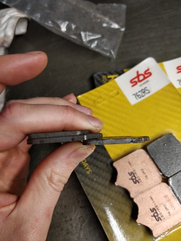

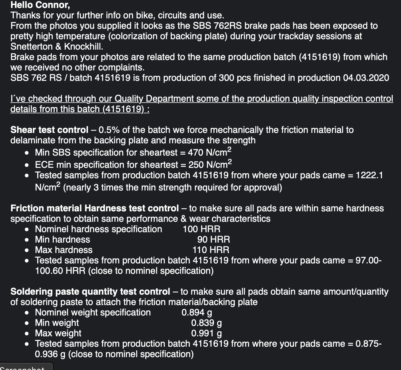

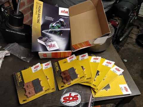

  20. I ended up contacting SBS, not in a 'your product nearly killed me' way but more of a genuine.. some thing went wrong here and I like those pads, and I'd like to know if i've done something wrong?
    You can see the right pad where the braking matierial has decided to jump ship.
    I got back what has to be the best customer service I've ever had.
    As a student engineer I appreciate the technicallity of that, he of course apologised about the failing but also identified what may have gone wrong. I believe I was over heating the pad, which is unusual as i didn't feel any loss in performance. But at least now I know not to use that pad for trackdays, a mate of mine (the one with the Z1000) raced in the scottish championship with those pads and never had any problems, its actually why I got them in the first place. But it was on a pre-injection 600 with standard calipers and master cylinder, so although bizzare.. I under stand how my brakes could generate more heat.
    He also sent me every 'race' pad that they sell so I can try them out and see which works best for me, which is cool.. its not very often you get to do a back to back test which I'm looking forward too. I'd rather not have to spend the extra money on proper race pads, as the jump is quite high, but I imagine the feeling will be worth it. They also sent me stickers, and nothing says 'sorry you almost lost your brakes and died' like free stickers and a free cap right?

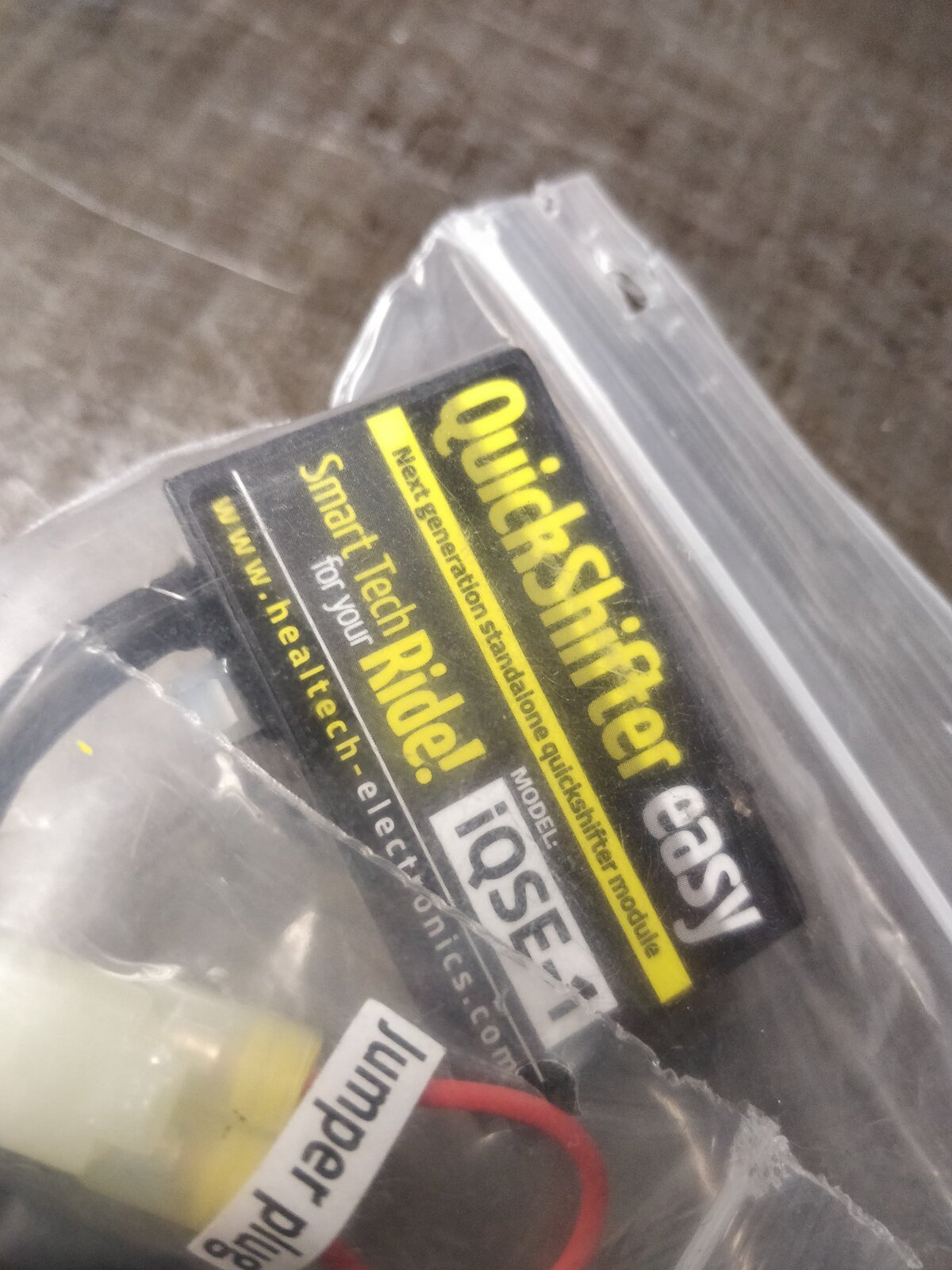

    The 999 is currently under the cover of shame whilst she thinks about how she treated me, rather than actually fix any of the (many) problems I thought i'd buy this:
    It came up for sale really cheap, I was skeptical of these for ages and thought they were a bit crap and gimmicky but I recently set one up on a brand new Suzuki Katana at work, and it worked really really well, I was impressed. You can dial it in well with the app. Plus, im sure a quickshifter will fix all those other problems.. I've ordered a new slightly smoked screen, the one thats on there is so crap and marks easily. Its on back order just now from zero gravity, once it arrives I'll take the whole bike apart and fix it all. I have no drive to fix anything with covid just now, I don't even want to go out and ride tbh.
