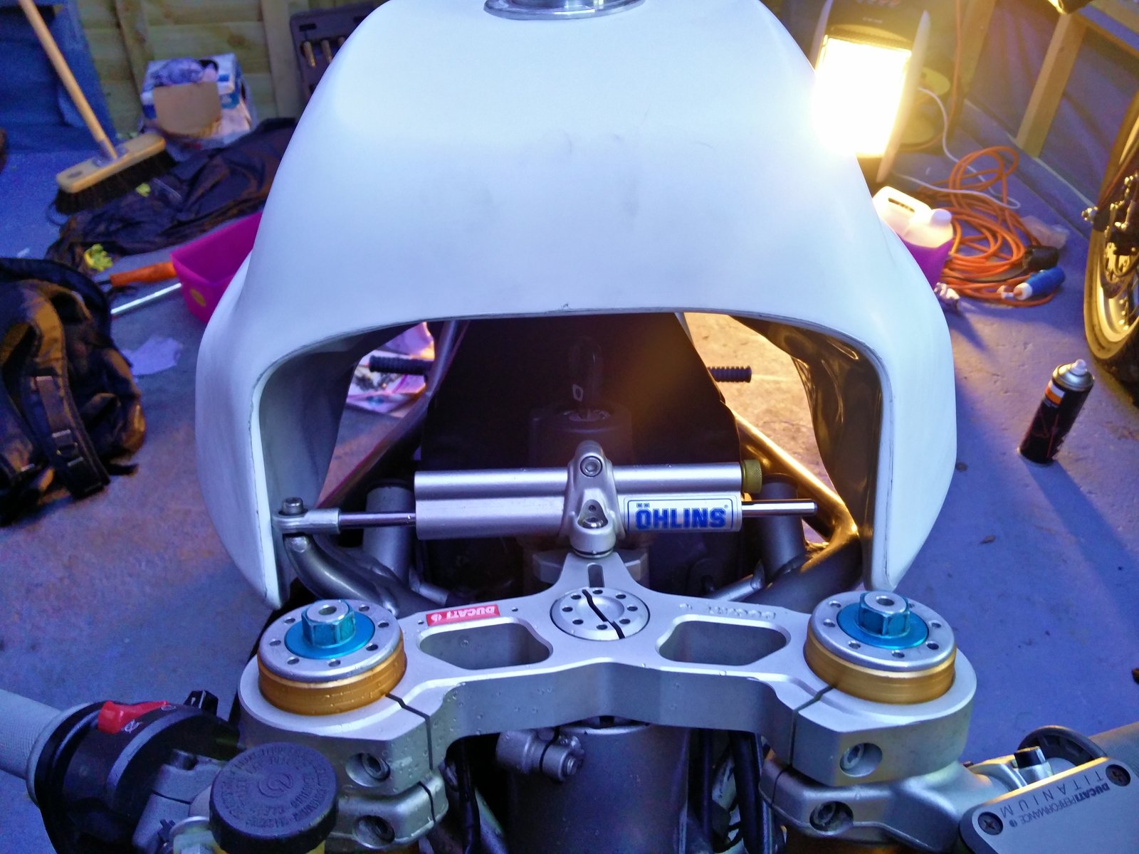

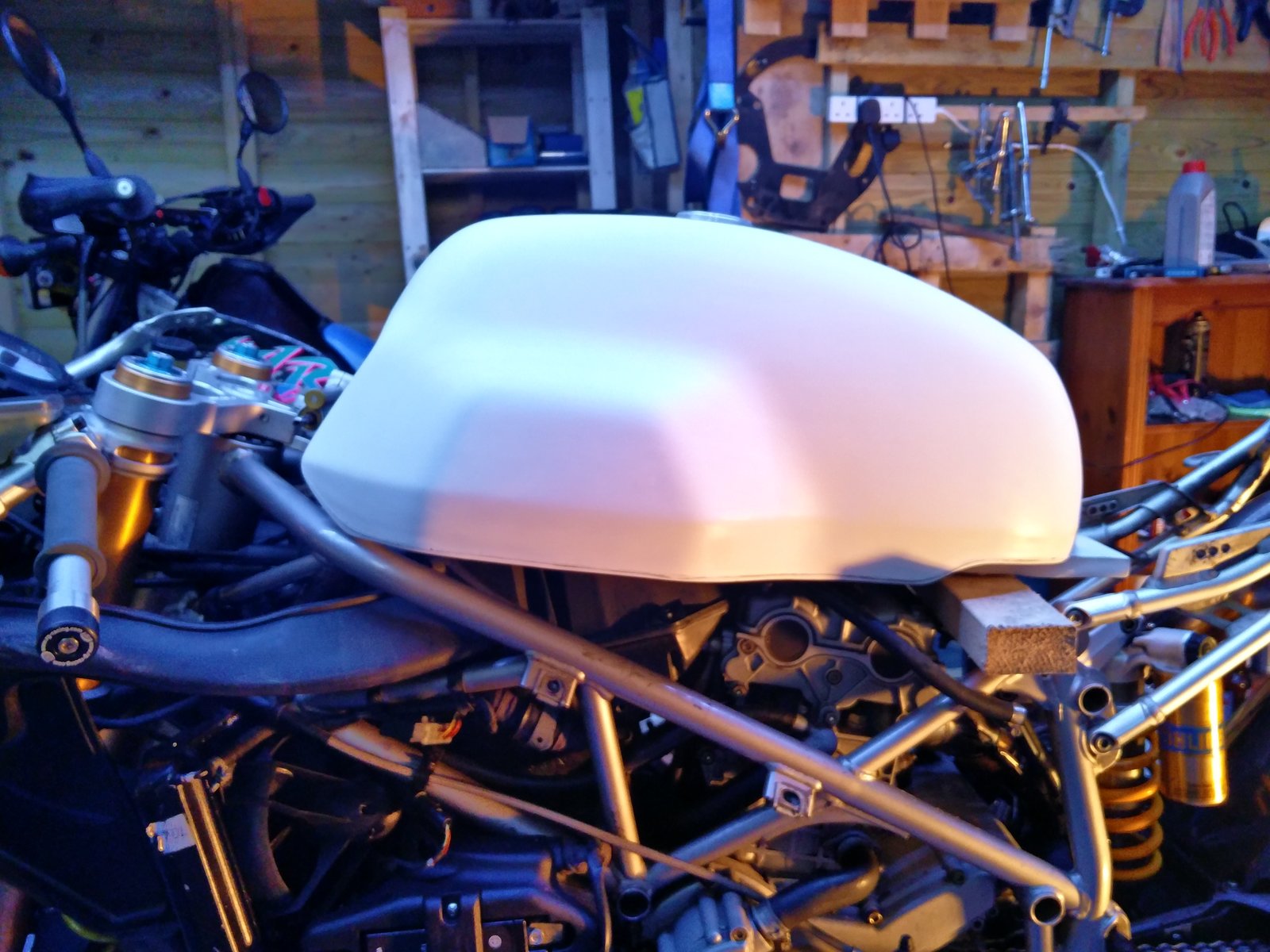

    I'll start off with the tank from Redmax ;
    I basically based the entire build of this tank fitting. Son of a diddly.

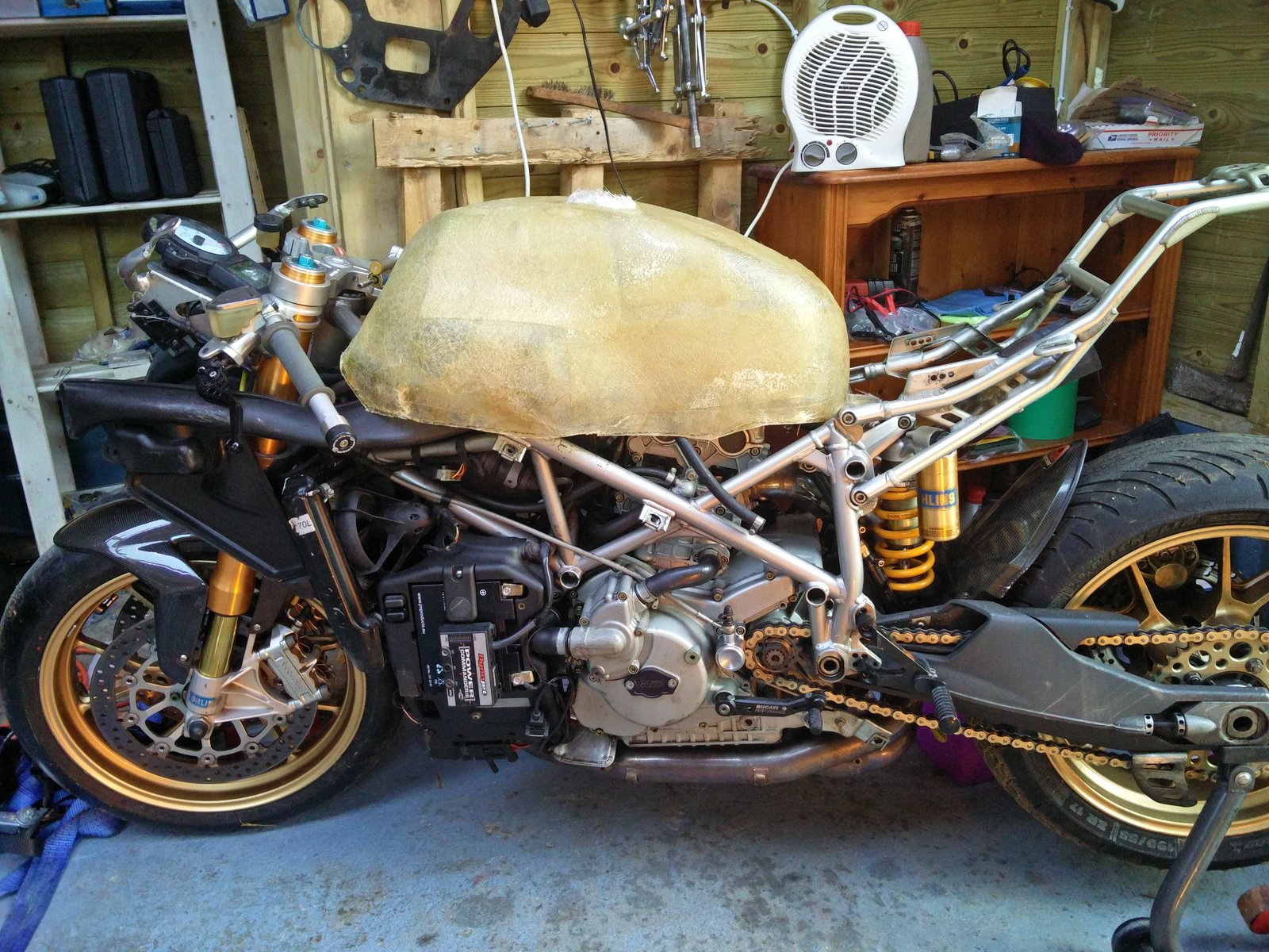

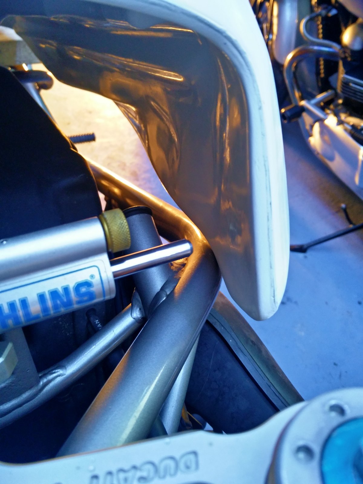

    I looked at alot of sport classic chassis but could never find measurements on a 999 upper rail on the trellis frame, It was painfully close to fitting..

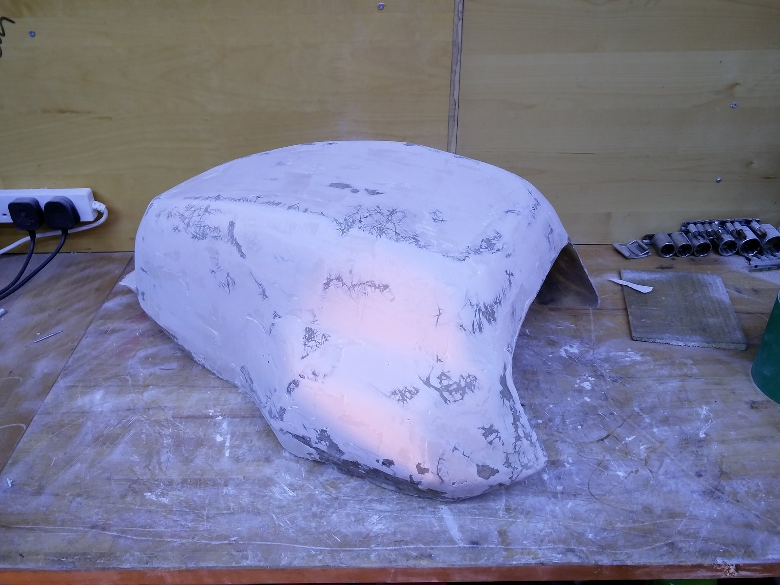

    It was either take chunks out of the Redmax tank or.............make my own from foam.

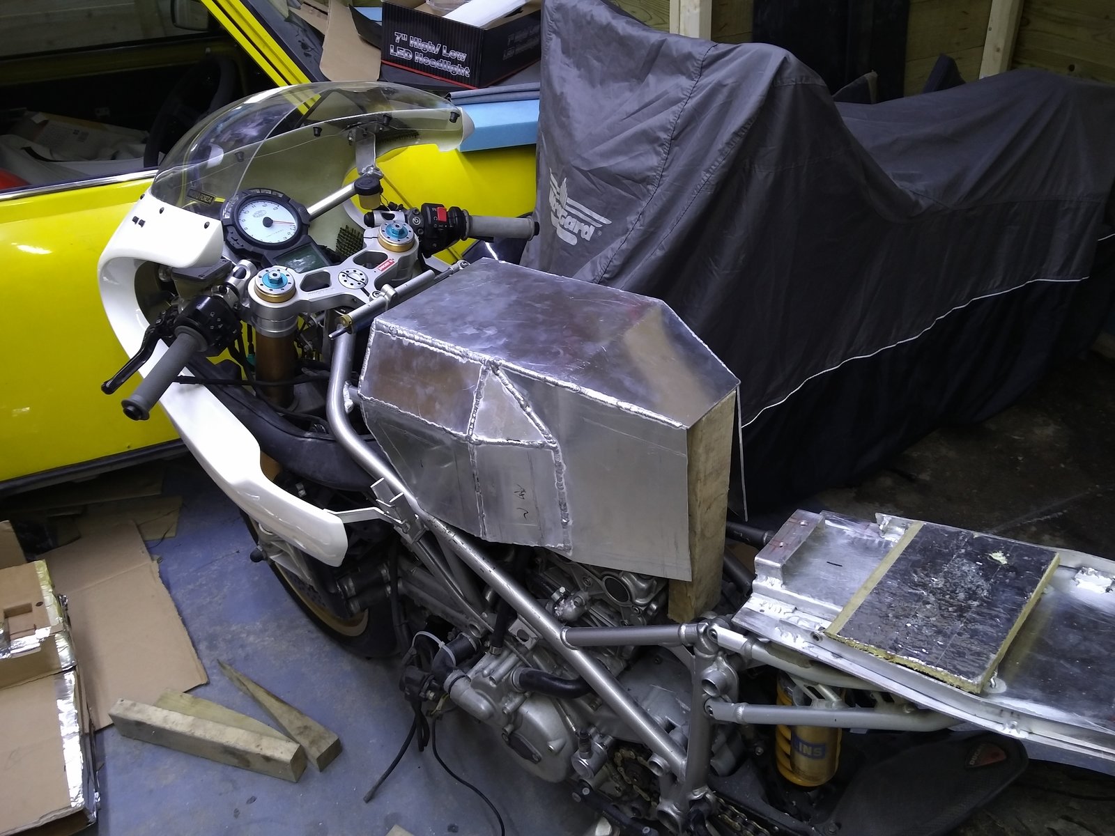

    After lots of expanding foam and alot of measurements from the real tank, I think 3 failed attempts, this happened.

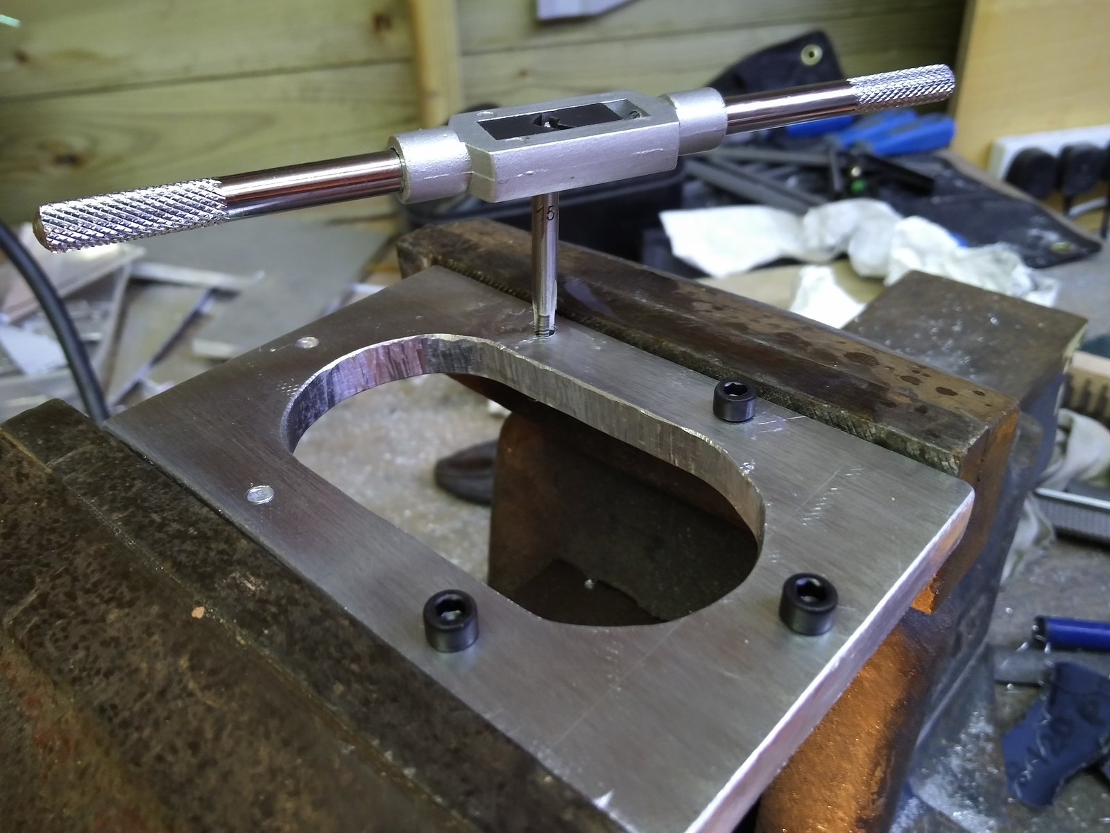

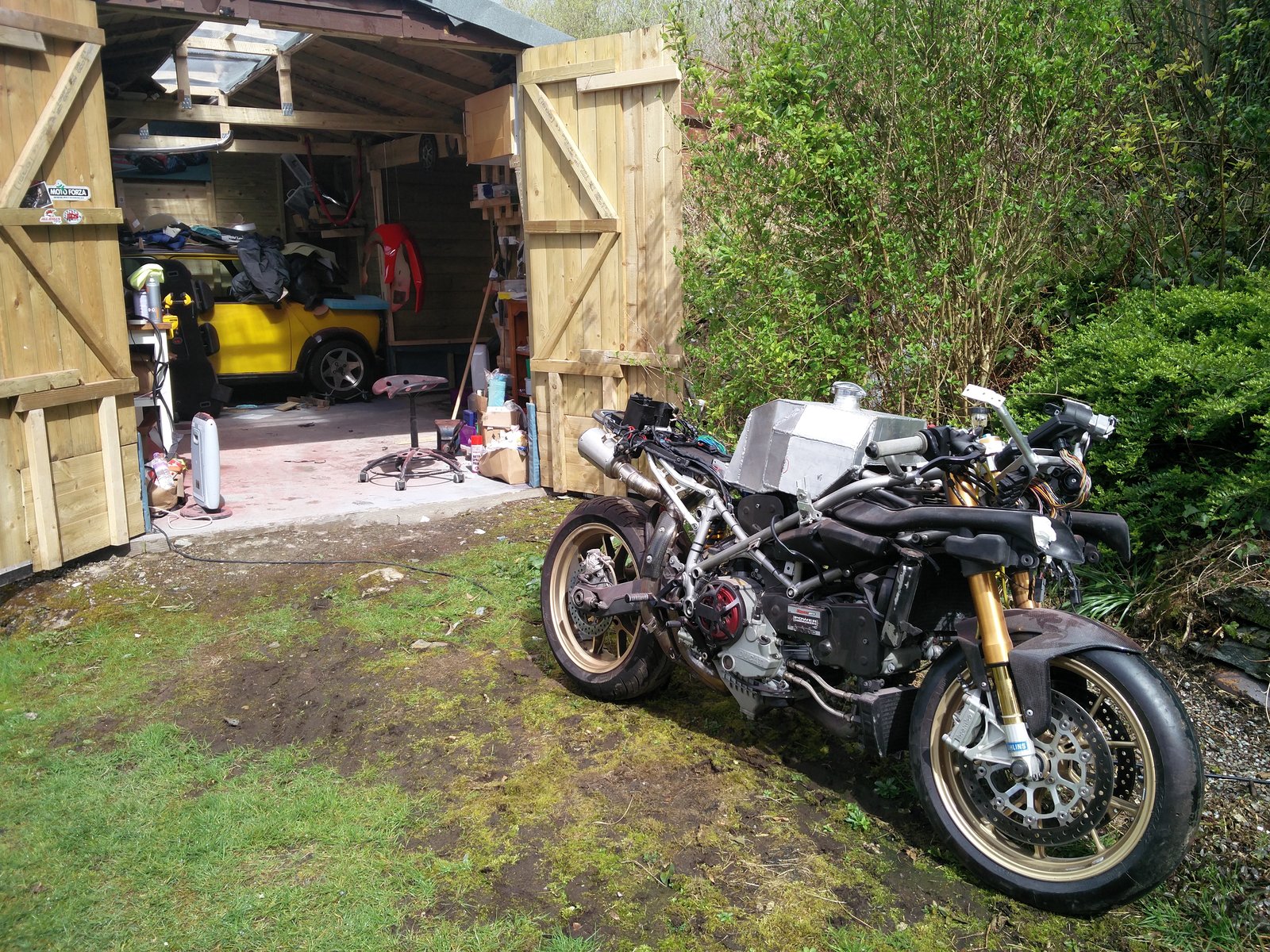

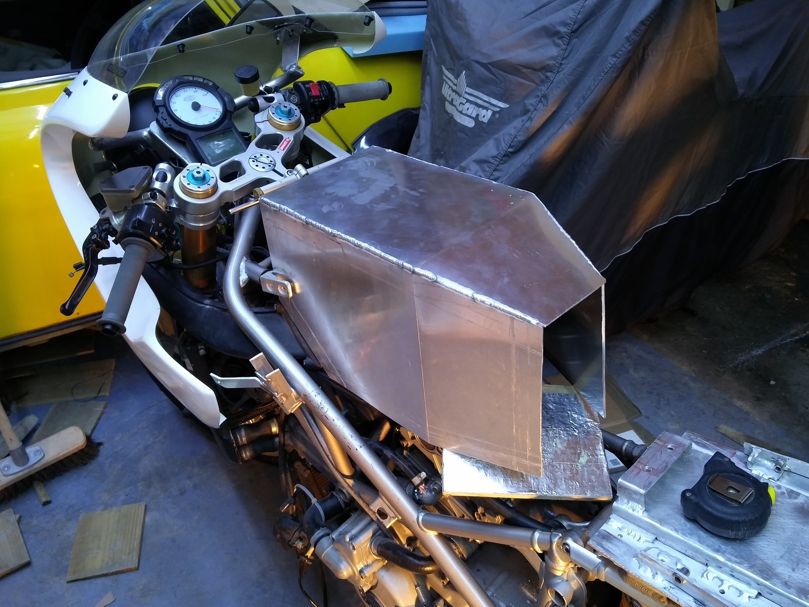

    I had planned to tip to make this a full fibreglass tank but after a quick google, Ethanol and Fibreglass aren't best buddies. It also gave me a chance to learn how to tig weld alloy which I've always wanted to do.

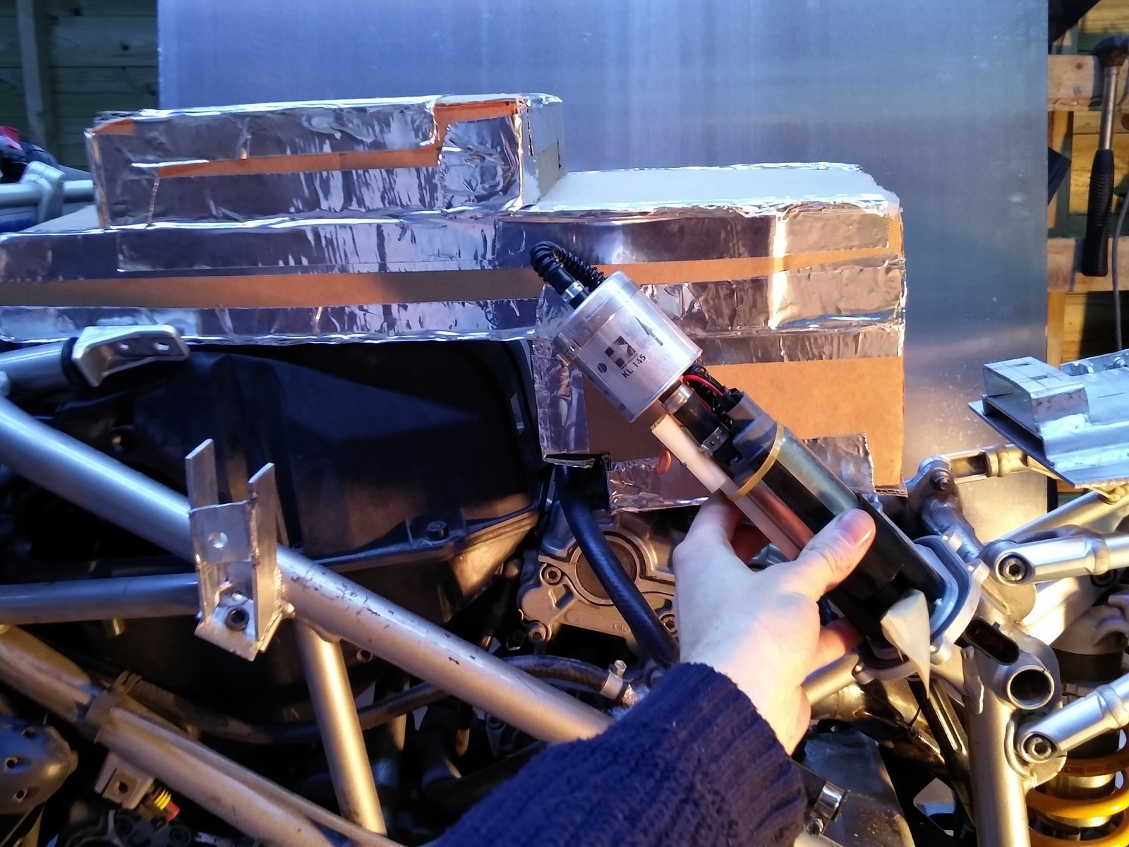

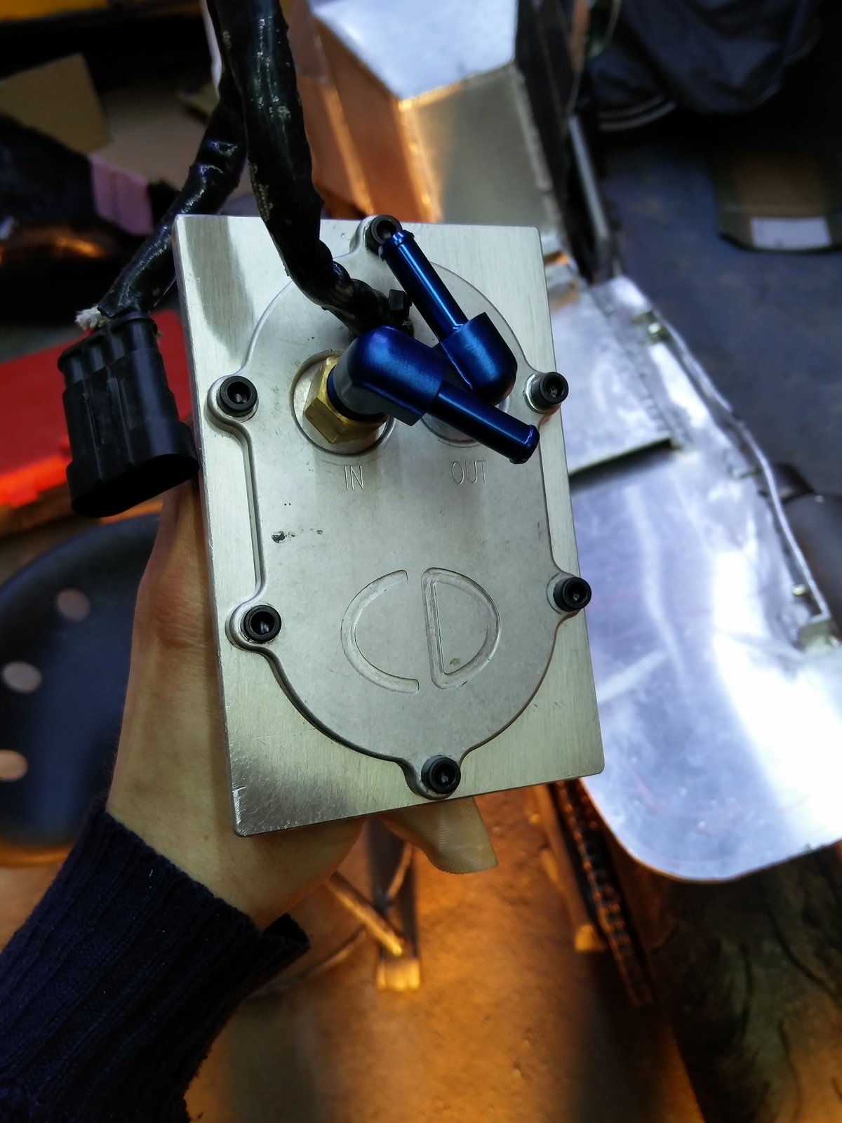

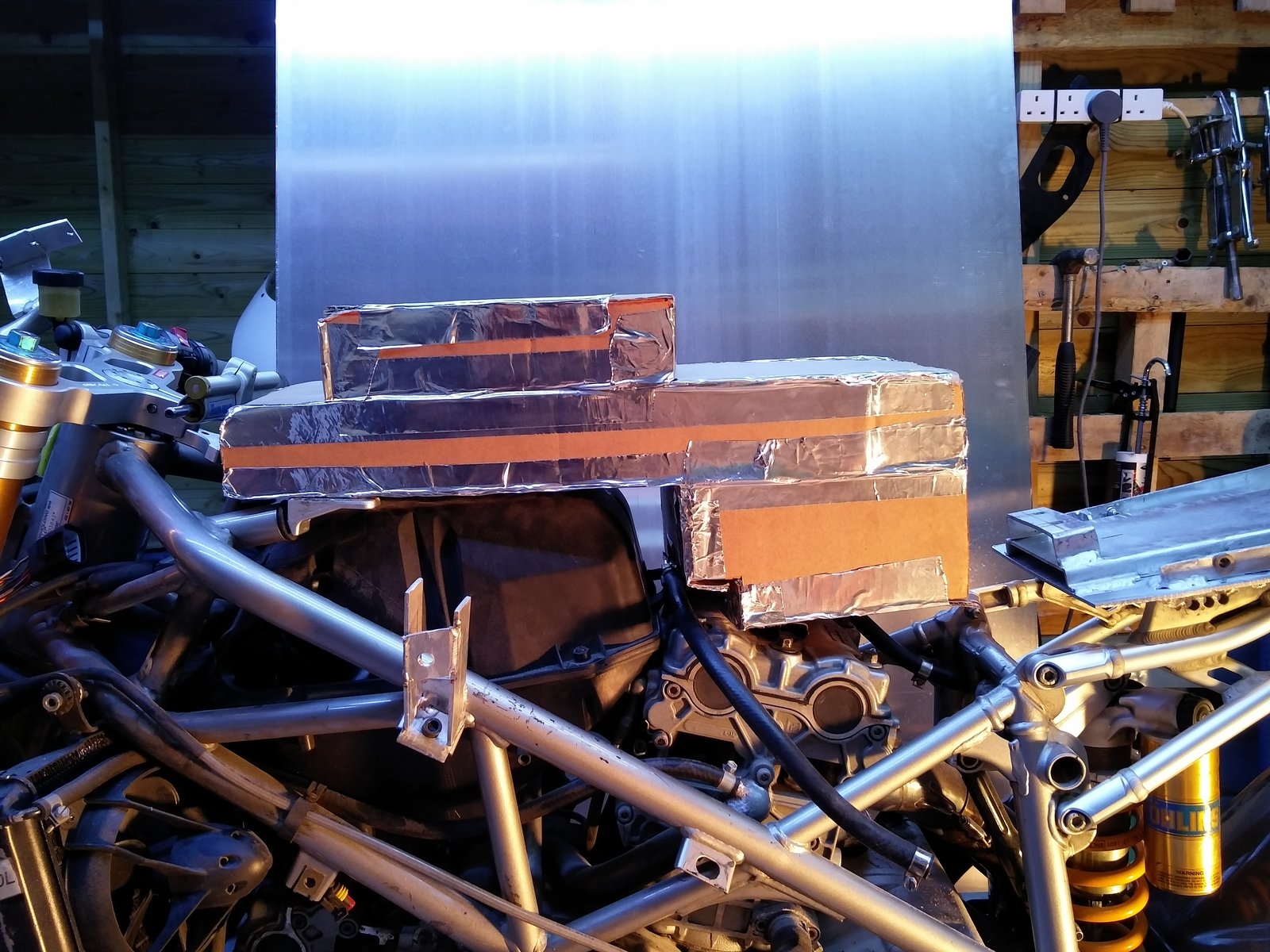

    I mocked up CAD (cardboard added design) and bought a used 1098 fuel pump base, Much easier to fit than the 999/7490 one. Amazingly what actually came was a Corse Dynamics $300 one, This was a good day, I'm sure the thing cost me like £60.

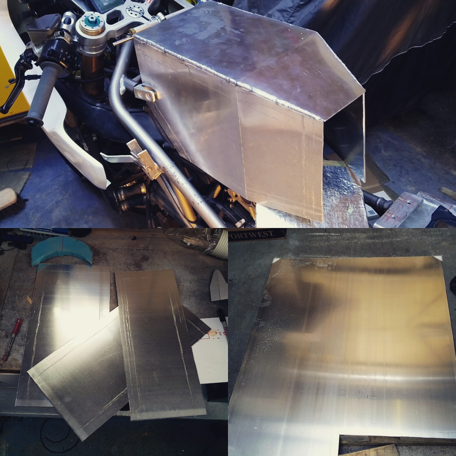

    Side pods add about 3 litres but look hideous on the welds..
    I settled on 17 litres like the R model tanks after taking approximate mpg calculations and the range I wanted. Quite interesting that the number varies so much online, I later figured out trackday guys posted the numbers too, Handy!
    done. With a very sexy filler cap from Merlin Motorsports.
    As you'll tend to see for the fuel tank to be fitted the subframe had to get made and the fibreglass cover so you know how big or smaller the tank has to be, Basically everything had to get done at once..
