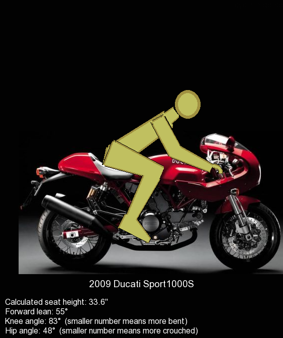

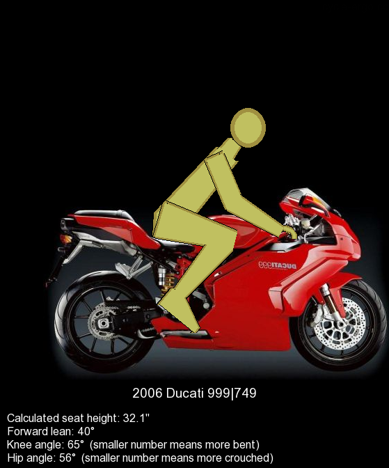

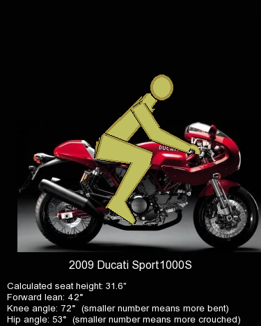

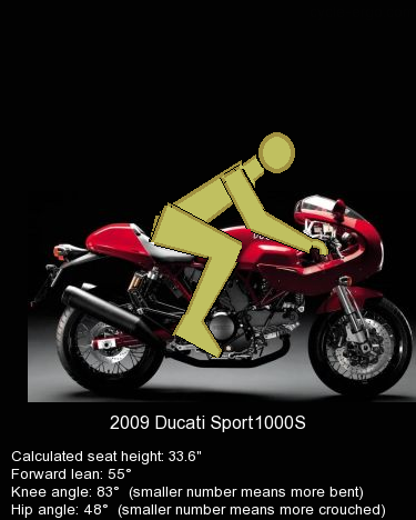

    Hopefully pretty pictures is a bit more interesting than numbers!
    If you go on the website you can directly compare them and overlay the images which is a great visual, unfortunately it doesn't let you download overlaid images!!!
    Below is the hybrid 999/SC and the model I based my modifications towards. 04wi0152IaRtJVAVAUmUsV10n.png
    -This was done by raising the bars 2"
    -Bringing the rider 2" forward (its actually done by pulling the bars back in the software..same thing)
    -Raising the pegs by 0.5" and back 1"
    Another nice little detail is it lets you pick between sitting forward, back or center in the seat which also changes all of these angles so you can suit it to your riding style.

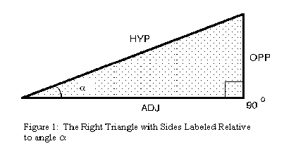

    The other detail which is quite important, especially because 999's have very flat seats is the angle of the seat. That's particularly tricky because what's comfortable whilst sitting on the bike definitely won't be at 100+ mph (not like I'd do such a thing officer). For the life of me I can't remember what I based my numbers off, I believe I took measurements from the front of the seat subtracted them to give me the difference in height between the front and rear and...... rightsides.gif
    With a bit of high school maths you can calculate angle a knowing height 'opp' and length of the seat 'adj'.
    I think I was somewhere in the range of 10-15 degrees, I'll need to check.

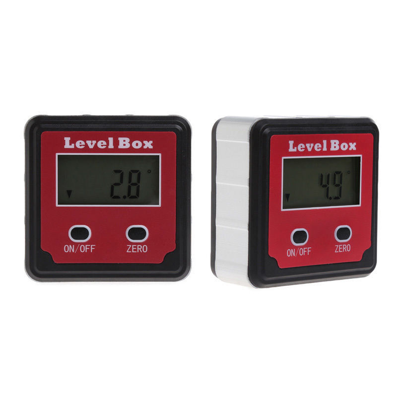

    If your not a complete nob then you'll just buy one of these of ebay for £5.. s-l1600.jpg
    Also handy for knowing which steering head angle you bike has without taking it to bits!​

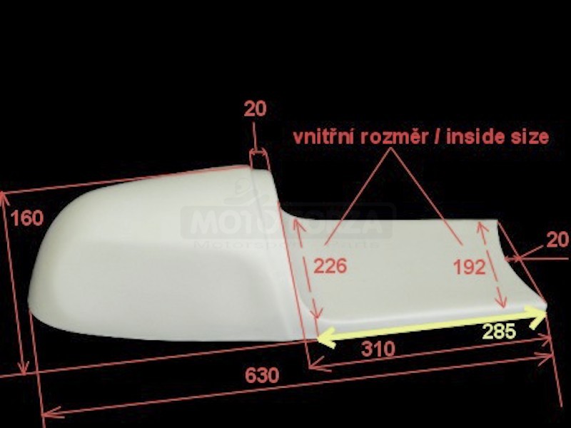

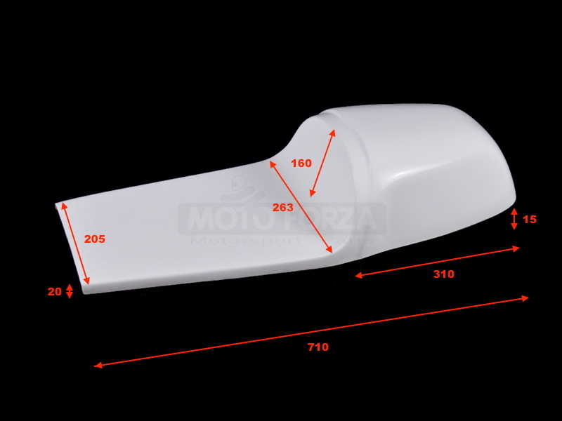

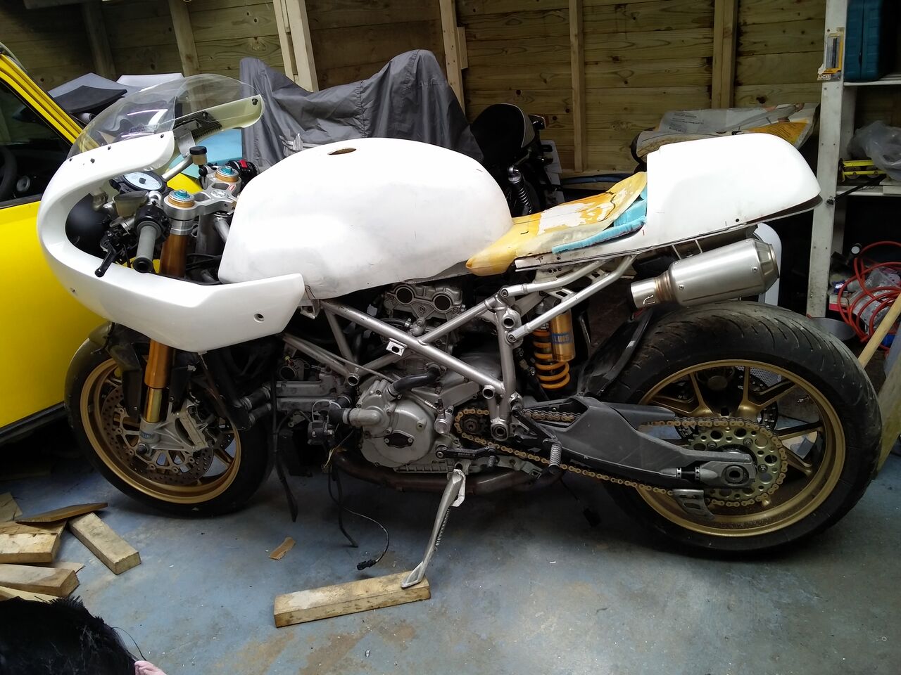

  2. Also handy to note that I got my tail section from a company called MotoForza.
    www.motoforzafairings.com
    The tail unit comes in two sizes;
    version 1 which is smaller- 52 euros
    version 2 which is the larger - 74 euros
    These also come in carbon, I didn't get one because I wasn't sure when I ordered it if I would actually use it. When I bin it at Donnington in March I'll get one :bucktooth:
    I cut up some of the original seat section, ended up not using it (Yup it was the fancy expensive suede one!! Bugger!!) I did how ever make a mold from it and the bonded GRP bit is below; IMG_20170209_233001_preview.jpg
    By some weird miracle the radius on the seat is the same?! This mean't I could use some of the original foam rather than completely reshaping it.

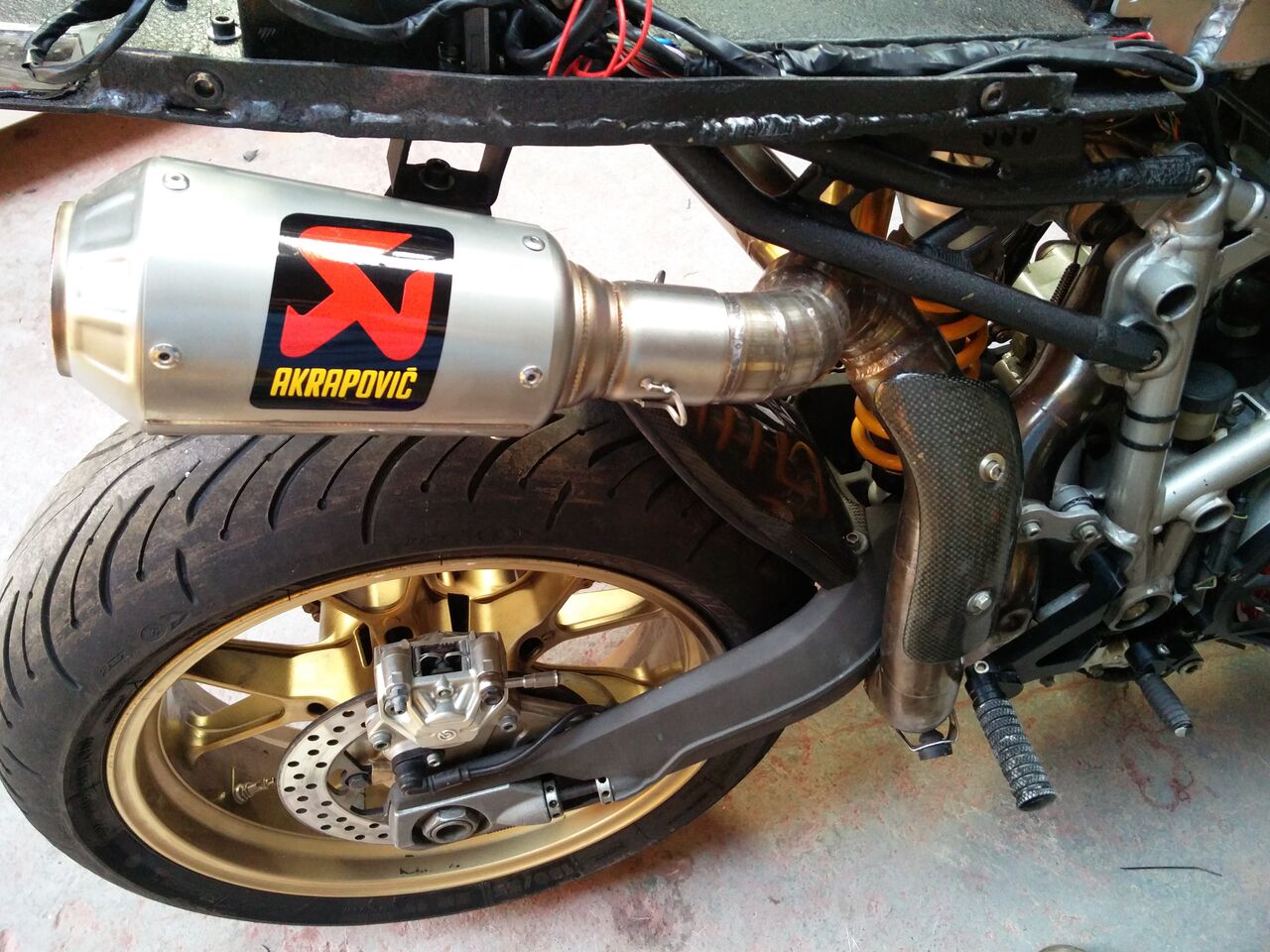

    This was also the trial fit for the exhaust.
    No-one is ever going to believe me, I've learned to accept it. BUT, I had this style exhaust on the bike before I ever seen the 1299 superleggera exhaust or knew about the WSBK system.
    .....Basically, they all copied me.
    I have always liked the Zard system for the SC but F*ck trying to make that work on this, Also Termi probably spent alot of hours making their 57mm system and I don't think some young thundercat in a leaky shed is going to compete with it. Needless to say its termi up to the Y branch under the seat, Then I f*cked it.
    This was another idea but.....Numberplate. You can see in this picture how I chopped the original subframe.

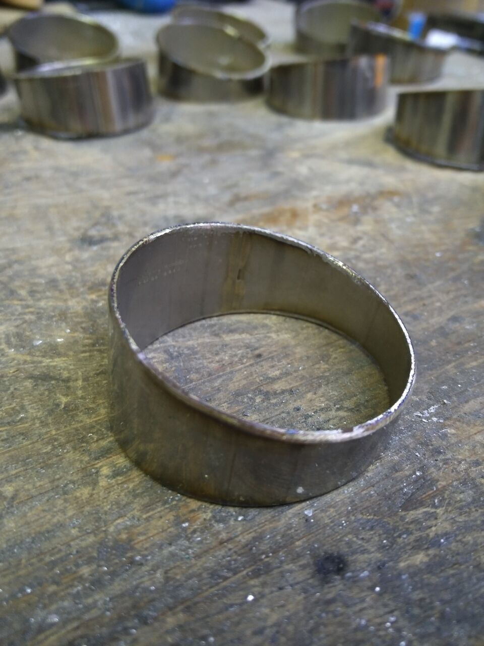

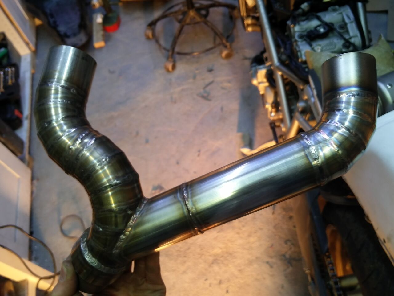

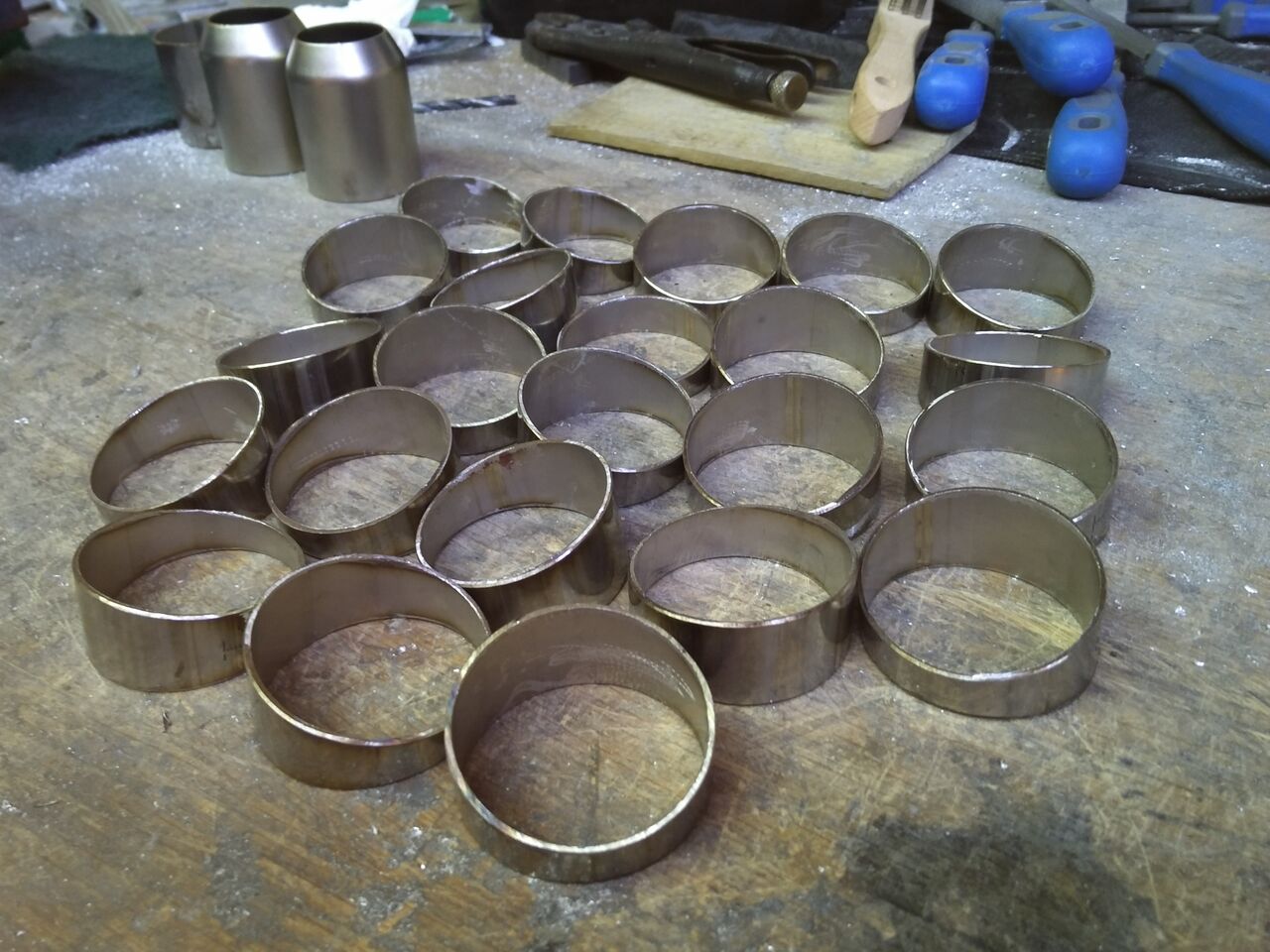

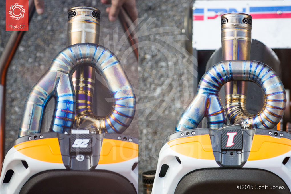

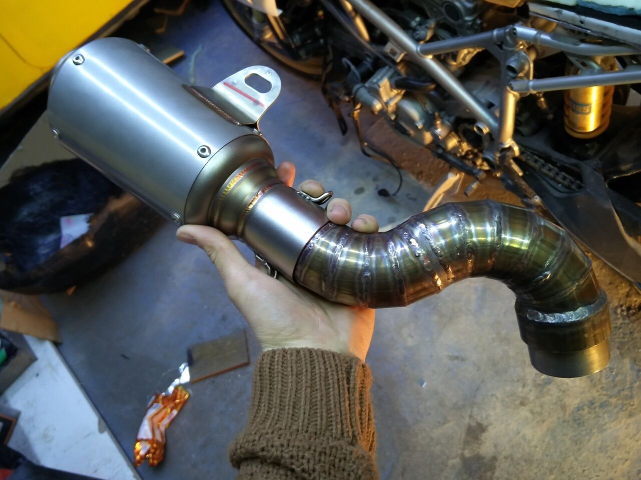

    I always loved 'pie cut' or lobster tail exhaust systems, Everyone told me that they don't flow aswell because its obviously not a smooth radius... Apparently it works for a certain Marc Marquez;

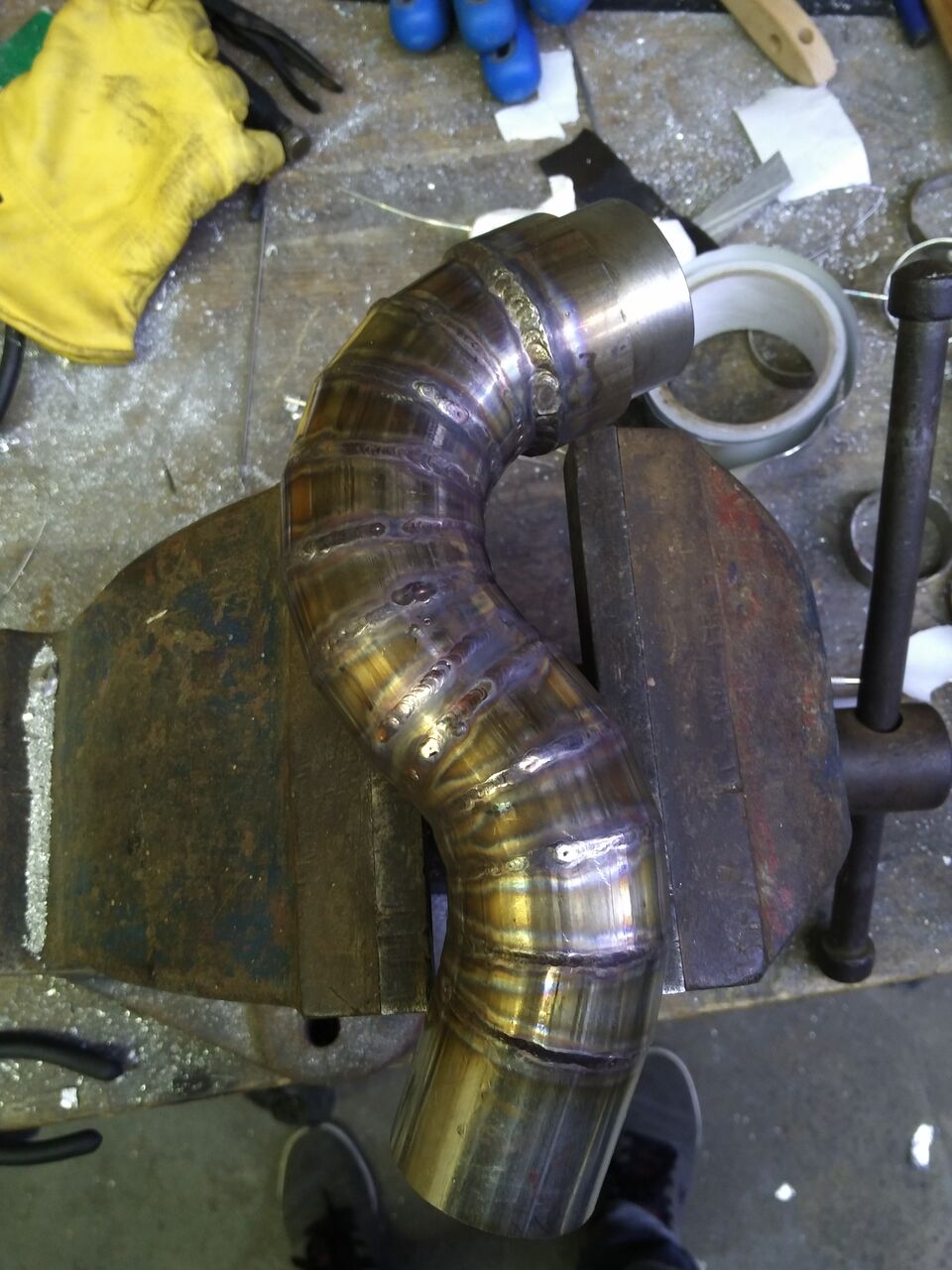

    So my bodge attempt went ahead, My little disclaimer is that I have never tig welded stainless before and not anything this thin..
    Here goes..

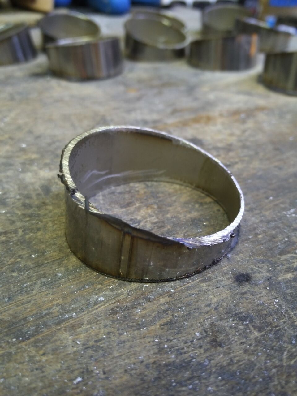

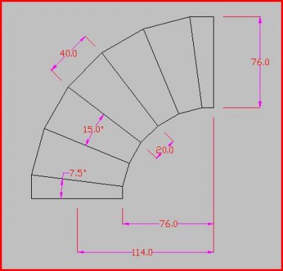

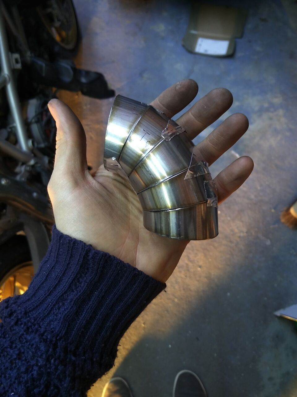

    58mm tubing cut at an angle which defers depending on how many 'slices of pie' you want, Stop thinking about steak pie. Stay with me..
    Then clean the section and deburr making sure its as flat as can be to avoid gaps for welding;
    Tape together to mock up ;
    Tack to make sure your happy then weld 'er up!
    note the 'sealing flange' on the intake side.

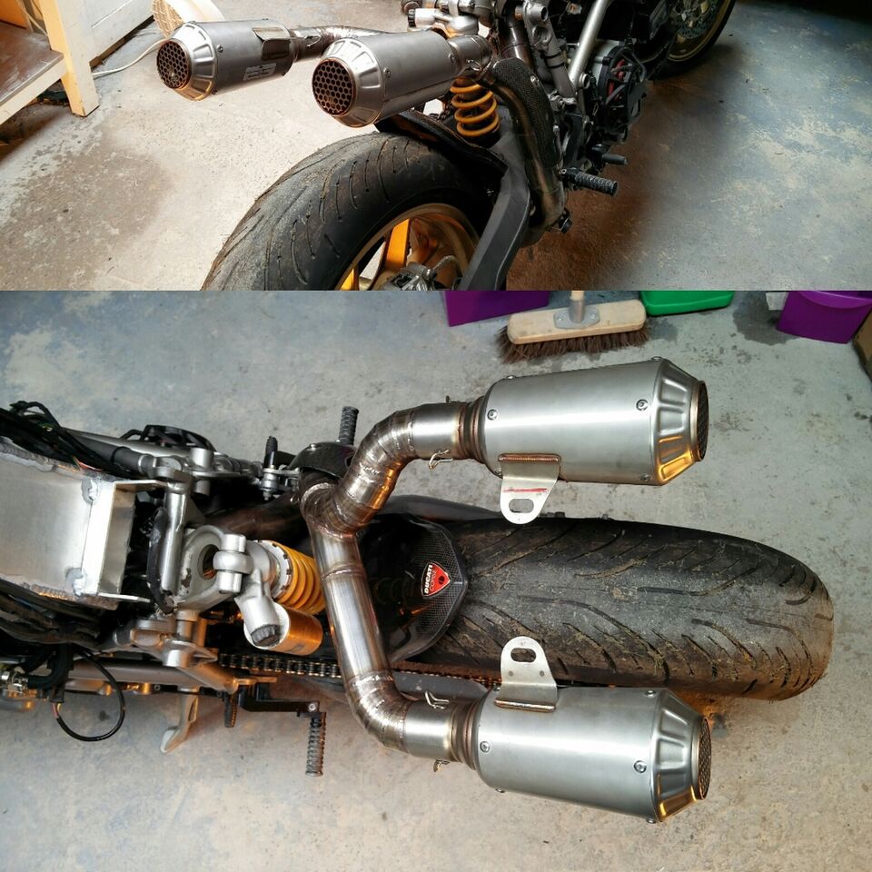

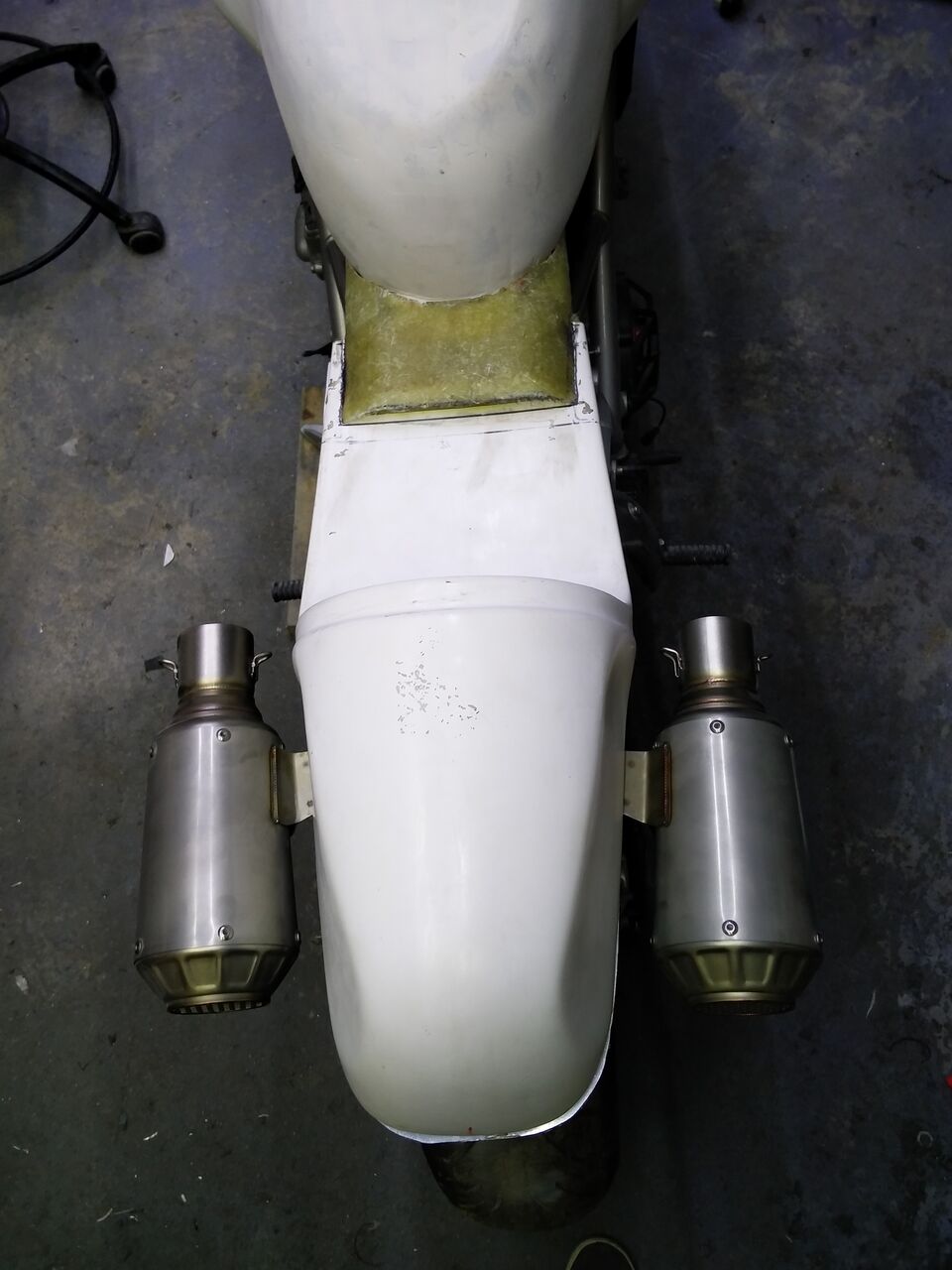

    I knew this system would be horrendously noisey so I wanted to try with just one pipe first then add the other; IMG_20170312_190000_preview - Copy.jpg
    I have a video of this;

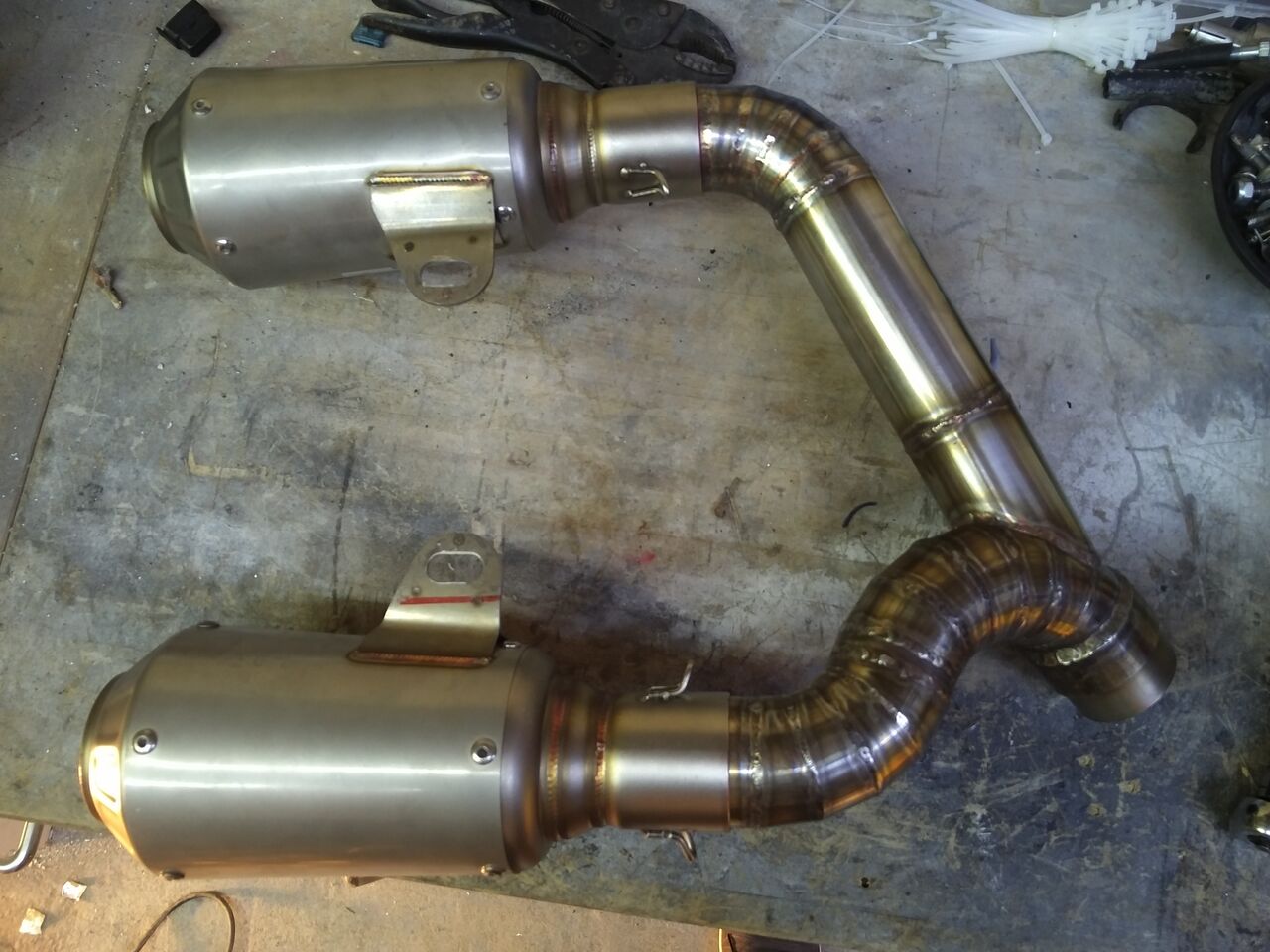

    Sounds like a f*cking tractor, dredful. Two exhausts it is.

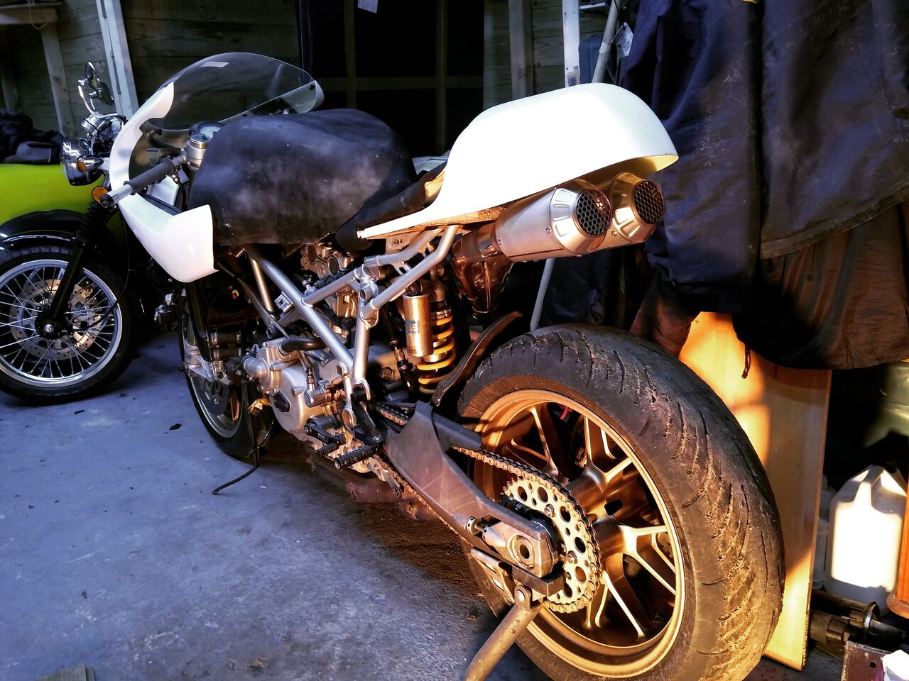

    IMG_20170326_222253_preview.jpg IMG_20170326_222430_preview.jpg IMG_20170414_224501_310_preview.jpg
    Notice the £3 ebay sticker that says its road legal aha
    Horrendously cringy sticker and its complete.
    This exhaust system is partly the reason I didn't do any trackdays on 2017, It. is. loud.
    Far too loud, it passed an MOT..somehow but its getting changed over the winter to something much uglier but quieter!​
