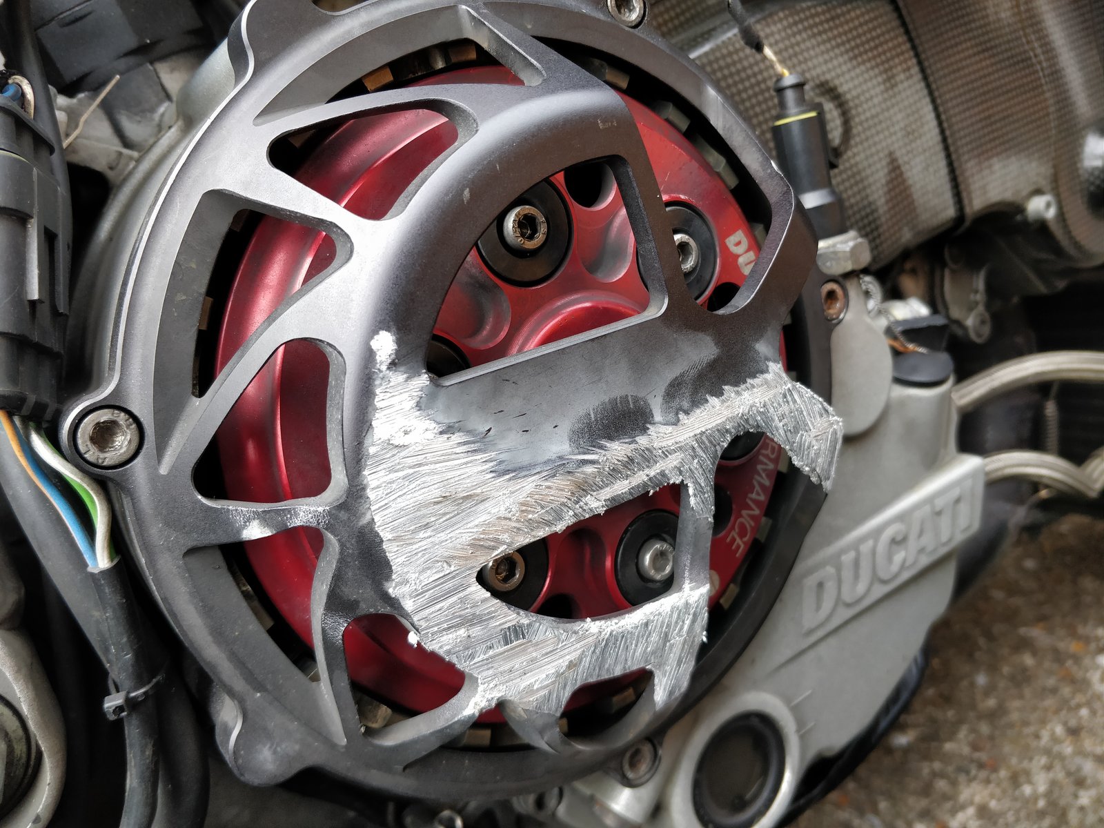

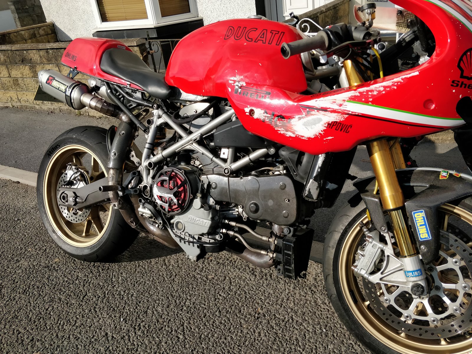

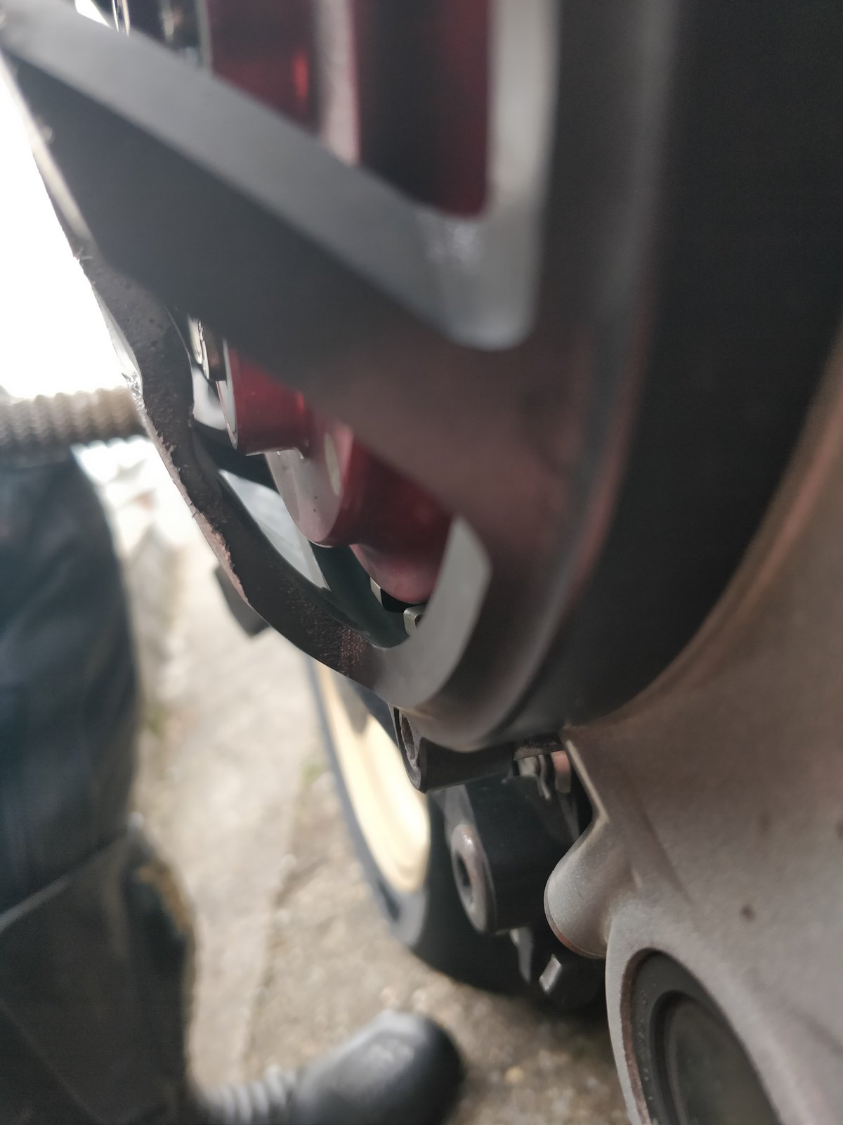

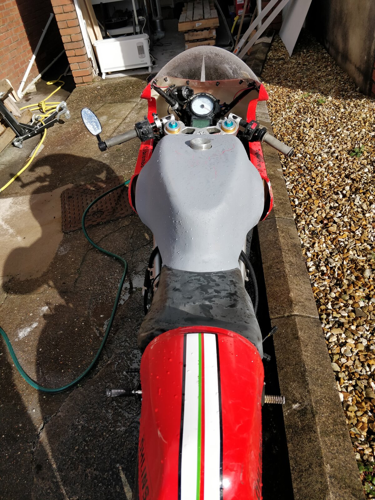

  7. Winter tear down has begun, didn't expect the road to help but ah well, onwards and upwards.
    • Dislike Dislike x 1
  8. Oh dear!
    Lucky with the clutch though - you could have ended up with a wrecked on if it weren’t for that sturdy cover.
  9. Yeah, go narrower :upyeah:
  10. Ugh that sucks! Glad it's all fairly easily repairable however.

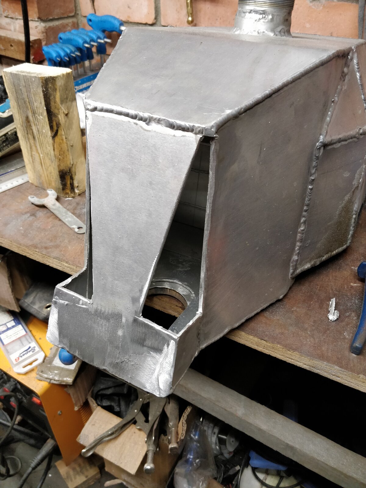

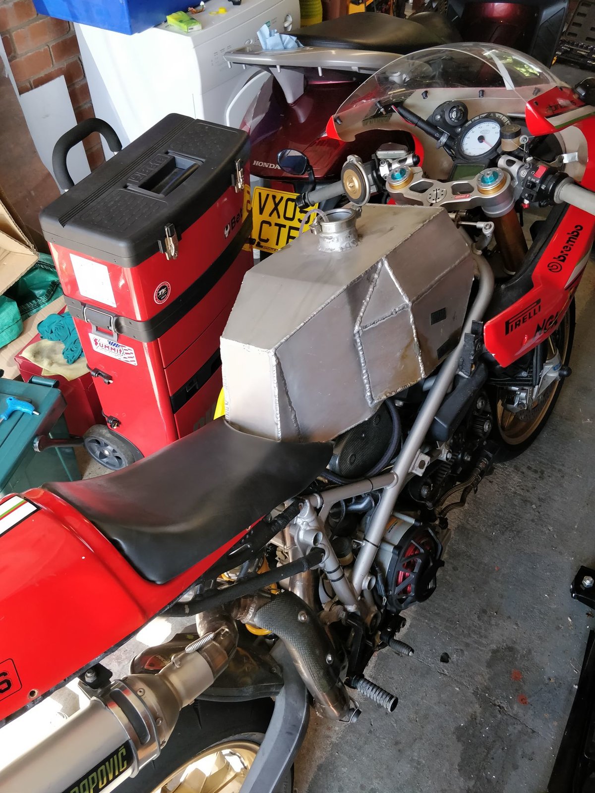

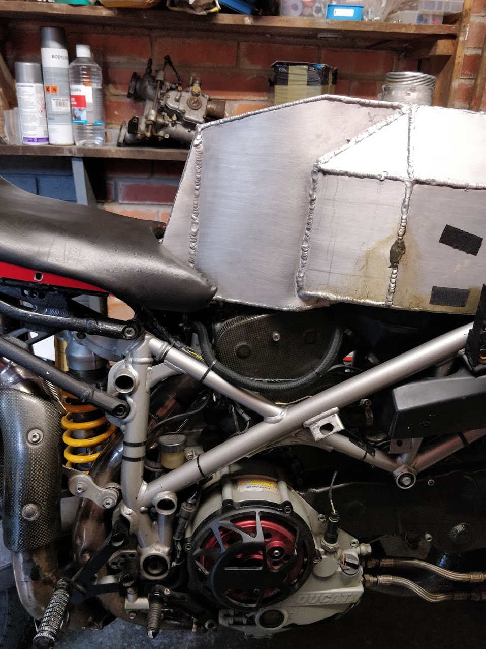

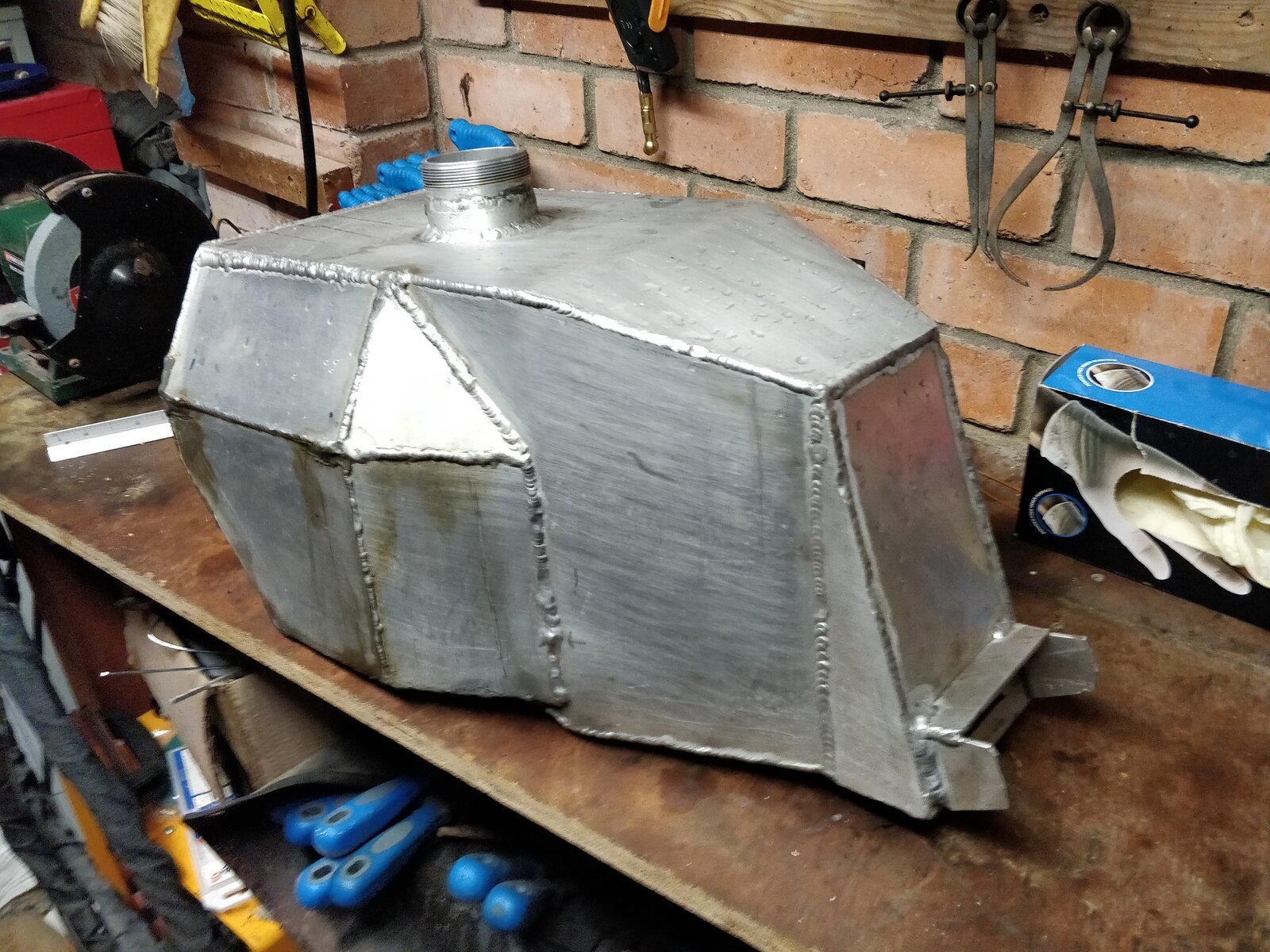

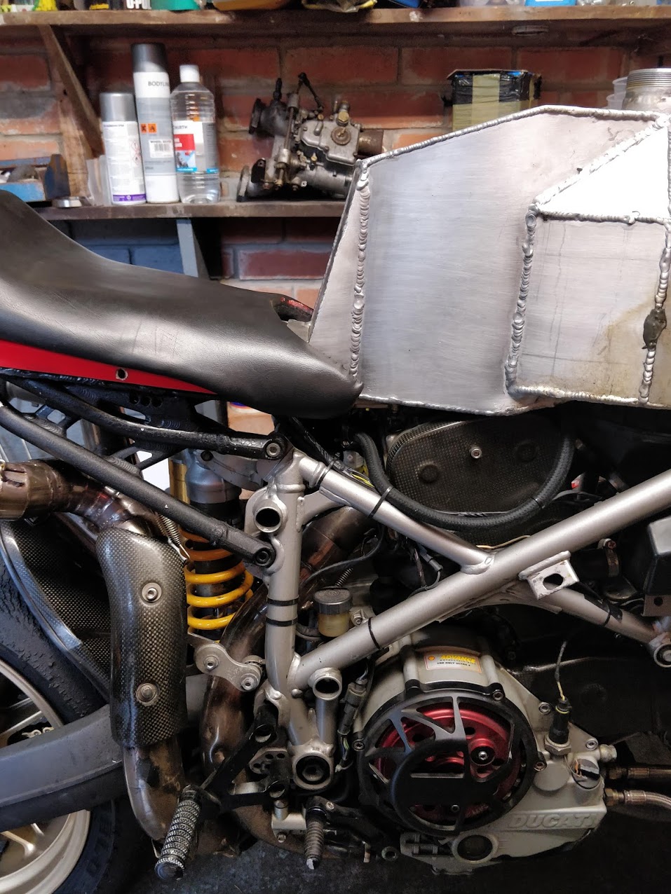

  11. Bit more work being done!
    Tank has had sections removed and the cover is about to get remade to make it nice and narrow.
    Jobs list isn't too bad;
    -Frame and new later model swingarm to be powdercoat
    - replace broken brake lever and mechanism
    - redo tank
    - fit new rearsets and quickshifter
    - fit fancy new carbon belly pan IMG_20190104_174804_Bokeh.jpg - fix crash damage
    - fit front indicators
    - service and valve check
    - replace some bolts with stainless and tart up/paint some bits
    ...then oulton park and maybe Spa in August!

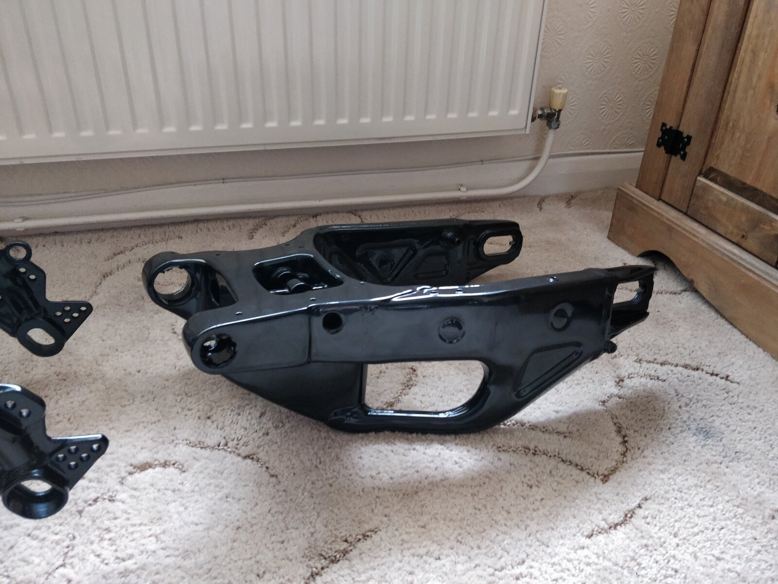

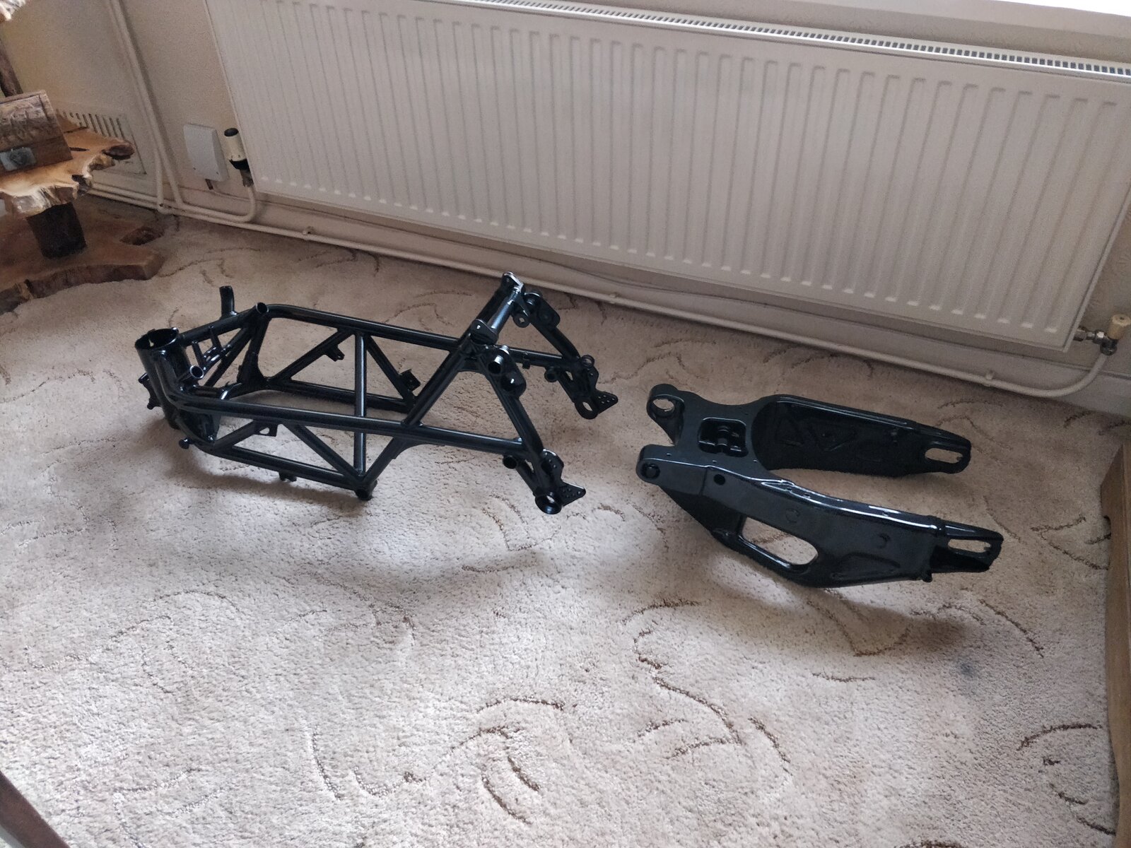

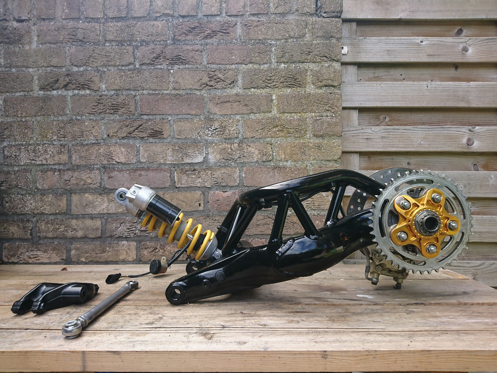

  12. Bit more done recently, plan to have it done by the end of next month.
    Seat has been redesigned slightly with a much narrower leg indentation, which should help when hanging off the thing!
    And the frame and new swingarm are back from the powdercoaters; IMG_20190224_164148.jpg
    Which has revealed a new problem! I assumed that the older style swingarm chain adjusters would have the same width has the later model 'square type' adjusters, so a simple machining in the mill would make them fit the new swingarm. Ruh-oh.

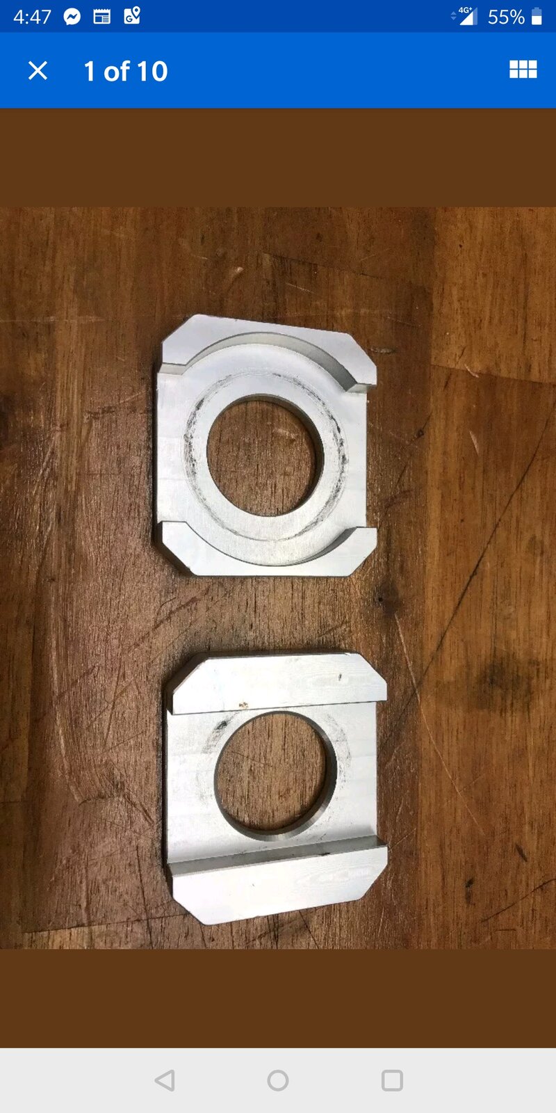

    So does anyone have or know of a set of this puppies for sale? Screenshot_20190224-164718.jpg
    Only place I can find them is Australia and America
    Next up is to out it all back together, Damper Dyno the öhlins to shock to see how it's performing. Should be interesting as it's been a while since I've used it. Then setup a new pc3 fuel map and see how the new quickshifter is working and have a play with the kill time.
  13. Once it's all up and running, I plan to weight it and calculate where COG is. I think the weight bias was 45%f/55%r which isn't too far away although it feels quite top heavy. Over next winter I might move the fuel tank lower and under the seat, and relocate the electronics under the tank, which should help with mass centralisation. I have a fair bit of data on a 1199s which I'll try and base mine on.
  14. I needed a set of those. I the end I manually machined up a pair.
  15. You will probably find that the exhaust will need modding to fit the newer swingarm.
  16. Yeah I thought so, going to fit it all up first and see the best way forward :)
  17. You don't have any dimensions do you?
  18. Not anymore, sorry.
    If you are not in a hurry, I could remove my ones and measure them. It won't be for a couple of weeks tho.
  19. I'd like to get it all together by the end of the week, thanks though!
  20. You can kinda work the sizes out.
    Hole is spindle dia.
    Slot width is dimension of flat on spindle.
    Full thickness is enough so that adjuster screw is in full contact.
    Clamping thickness is enough to sit flat part of spindle in at one side and enough threads sticking out of other.
    I am sure they are square when looking face on. Those sizes will be the height of the swingarm slots.
