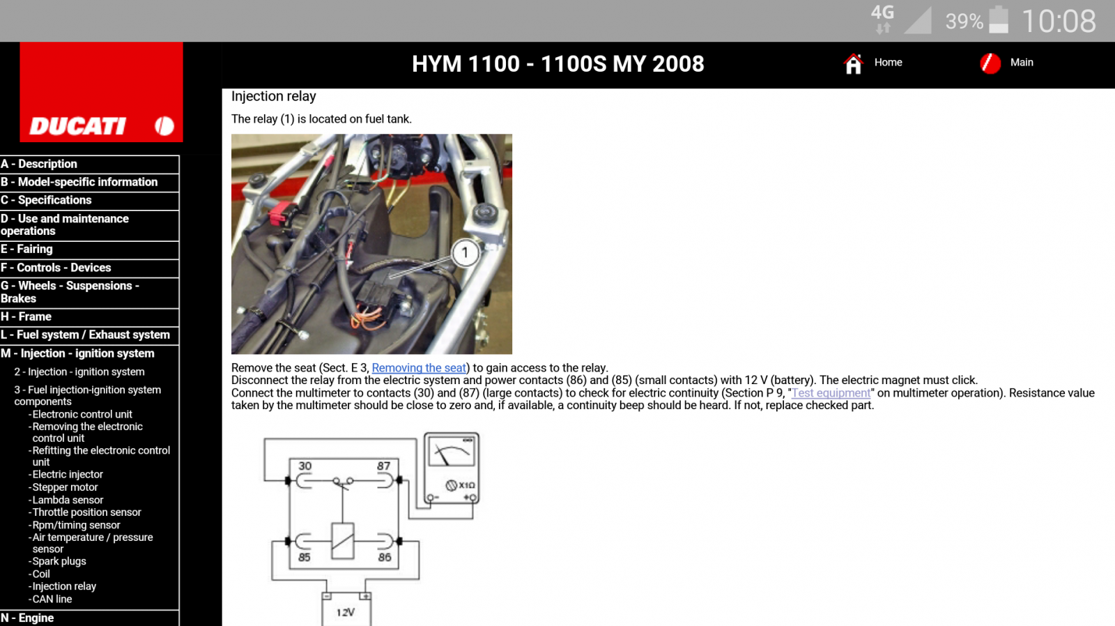

  17. Wiring diagram shows 17 as Injection relay....
    My workshop manual shows this as injection relay....
  18. That's different from mine....there, ive got the fuel pump plug and the o2 sensor....so, for mine relay 17 is somewhere else on the bike....
  19. 1100 or 1100 Evo?
  20. I'm guessing this style of manual (ie - runs on a pc/phone/tablet) is what I'm looking for.....
