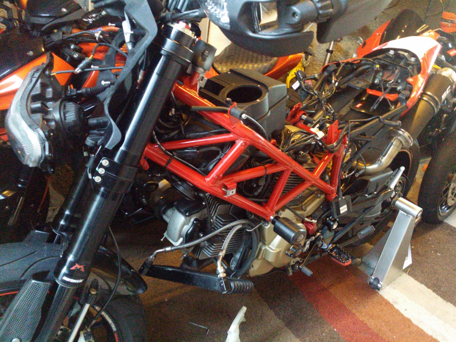

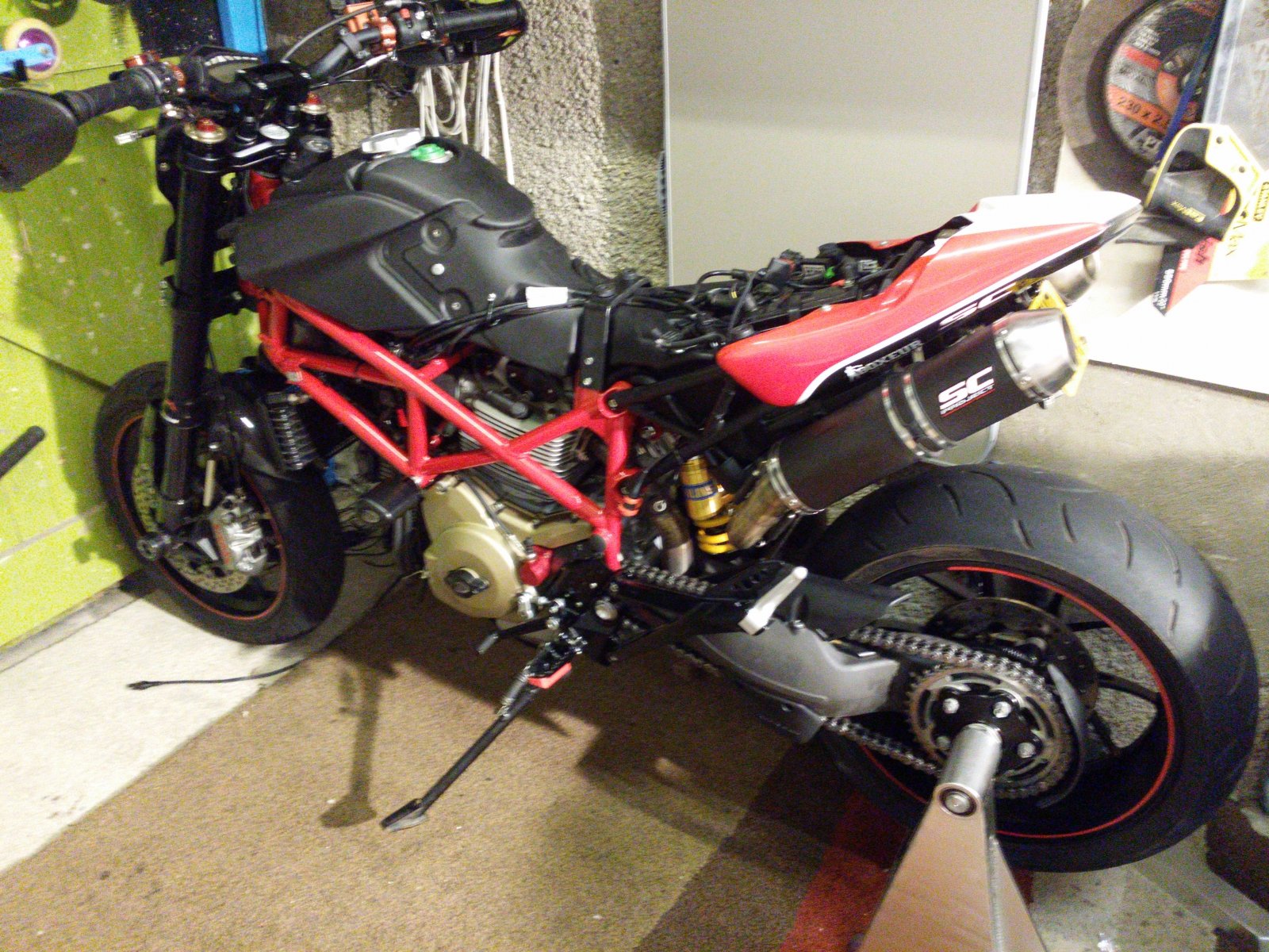

  4. More top level nerdery in the garage this afternoon - removed the front headlight mask, light and gotten to the guide that holds the brake lines, also taken the front rocker cover heads off to be coated. Have to pay the stainless steel fittings bloke a visit this week as ive ran out of most of what I have in the garage...
    Refitted the rear pegs as on the way home Tuesday I managed to pretty well melt through the heel of my right boot....
  5. Ordered front hel lines (one down and over)... Nothings turned up yet but hopefully stuff will start to appear tomorrow.. Oven is broken at the plastic coaters so will have to wait til the end of the week for the coating to be ready...

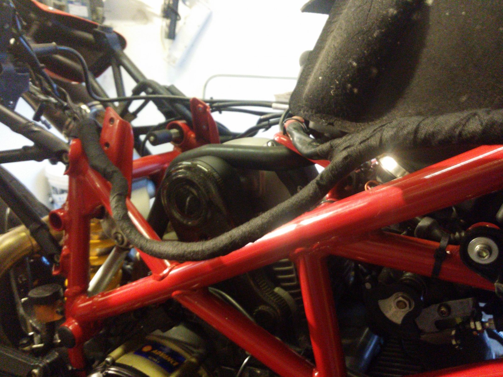

  10. Two hours fettling tonight.... Starting to look better.... Taken all the pvc electrical tape off the loom and used the correct canvas stuff...
    Studs are now in....

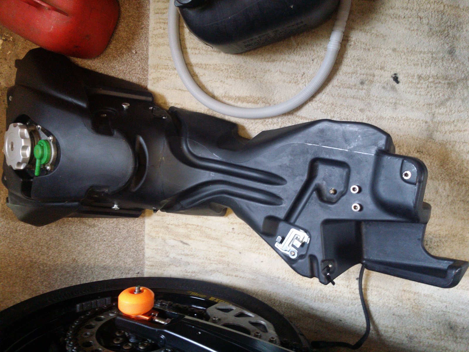

    Cleaned up the tank and taken all the plated fittings off and replaced with stainless..

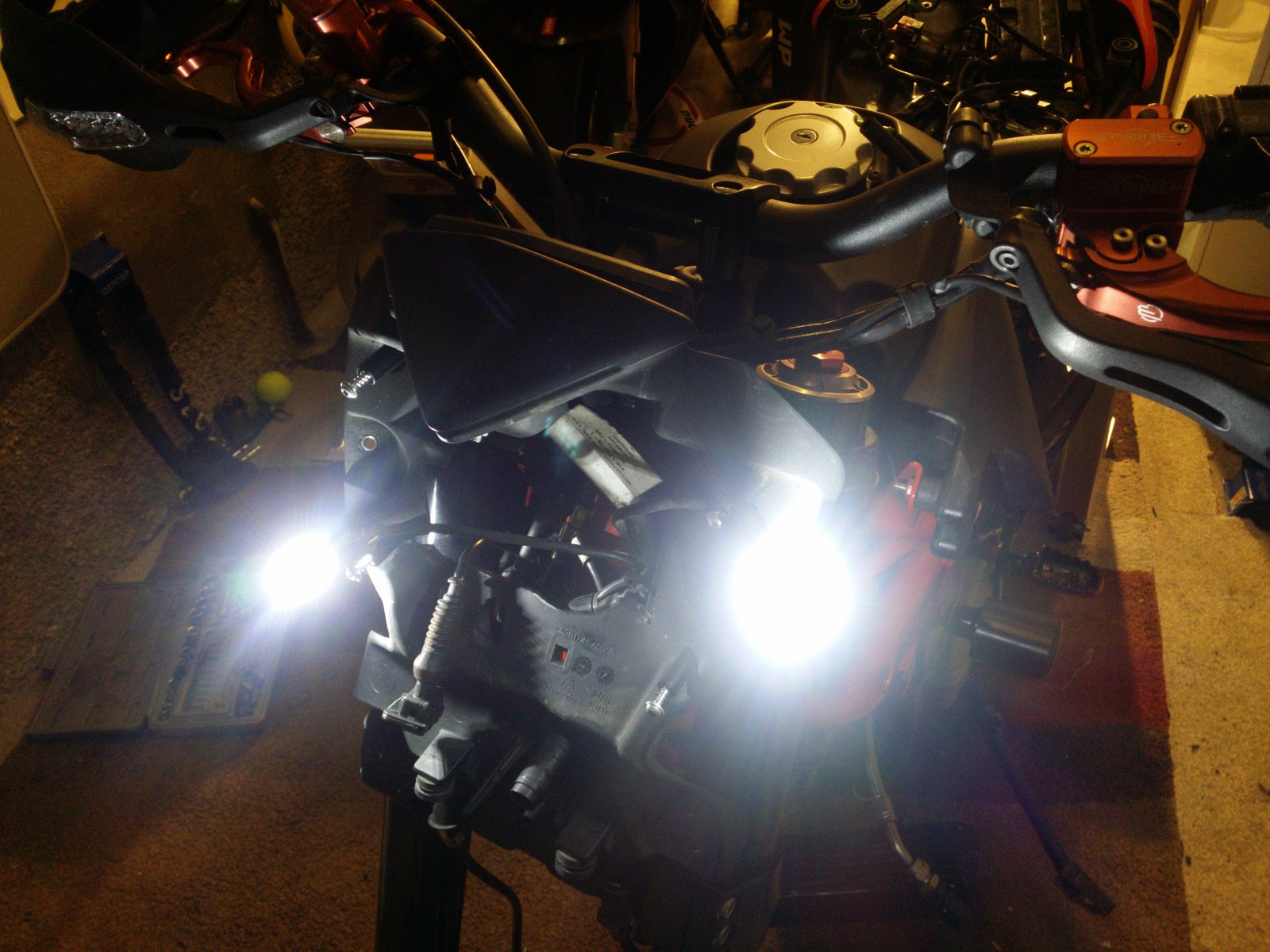

    Cleaned the oil lines on the rad and replaced the running light with some led modules...
    Still waiting for the main bulb to appear... Otherwise starting to look as i would expect...

  14. Therapy Lee that's what it is... Therapy... Makes a nice change from messing around with servers and software day in day out.... I've got a ballast here and a hid light which I'm toying with fitting although if i did I'd have to cut the back of the headlight bulb cover out... Not sure yet... Have to think about it...

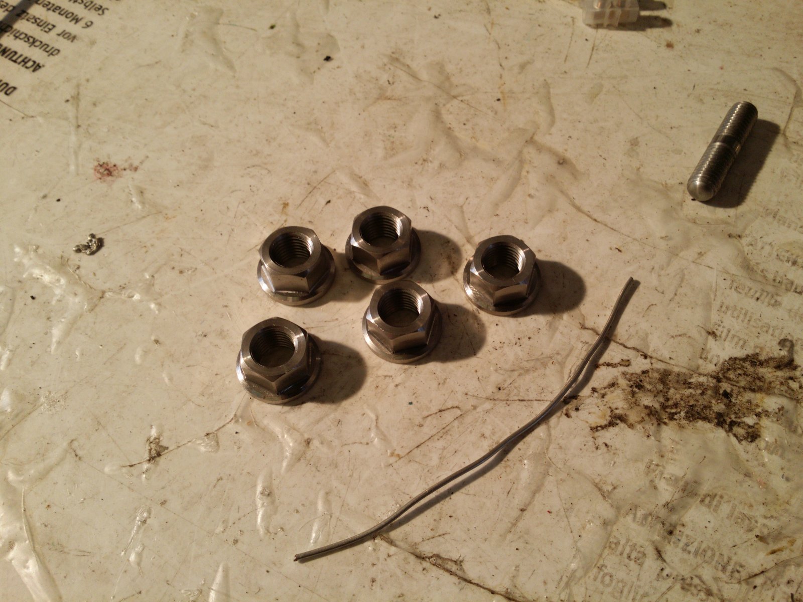

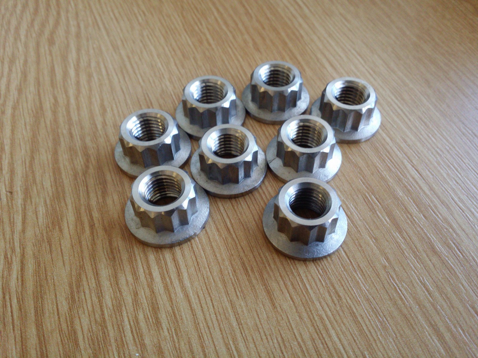

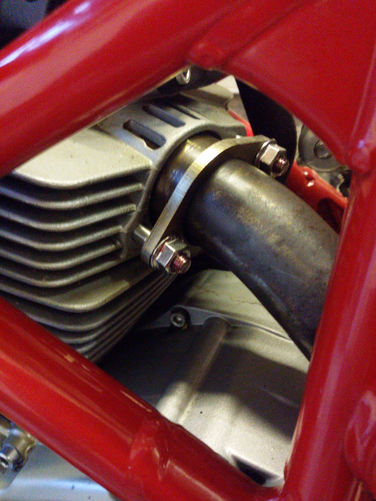

  15. More goodies arrived today.....cylinder head nuts (titanium) - there wasn't much difference between that and stainless....

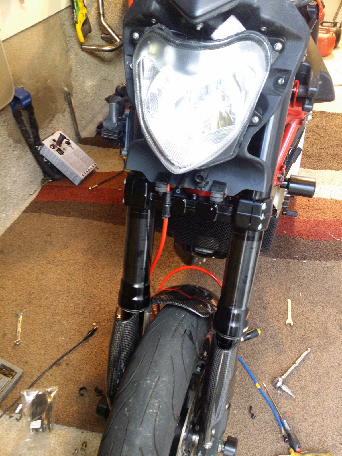

    Front Hel line with a loop over (trying to keep the clutter down behind the headlight, plus I wont need the brake line guide that bolts to the yoke.

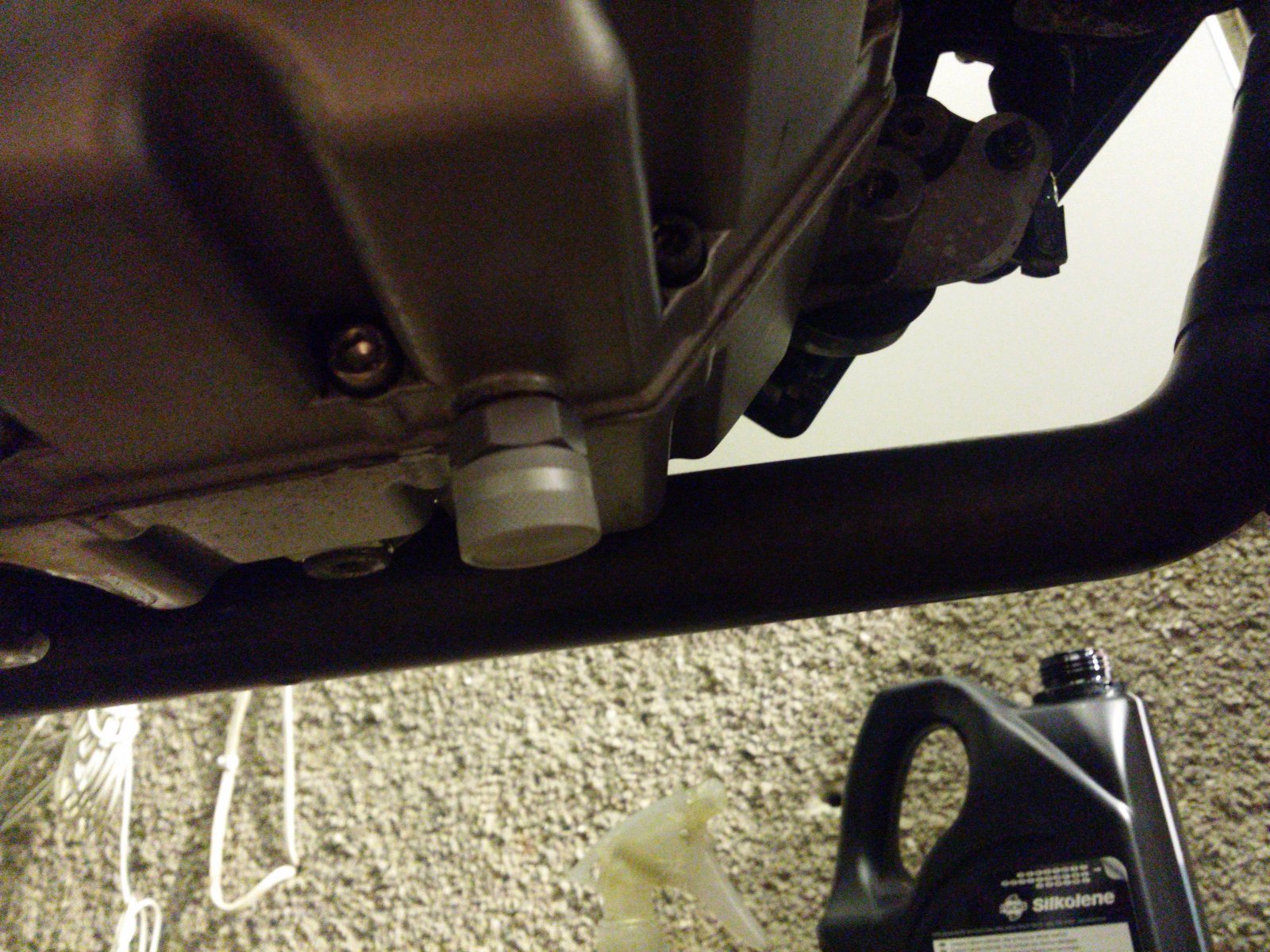

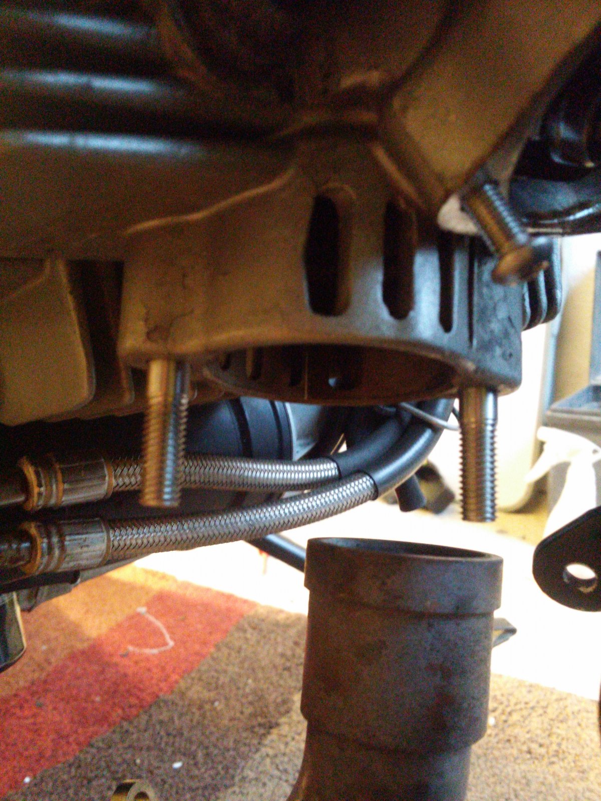

  16. Bit more completed tonight.... Stahlbus sump bolt fitted, oil and filter changed.
    Nuts didn't fit the head wrong thread... Bummer. Have to return.
    Front Brake lines and heated grips tomorrow.
  17. What's the sump plug about , looks a bit stuck out
  18. The stickyoutness is a small price to pay for trouble free oil changes...

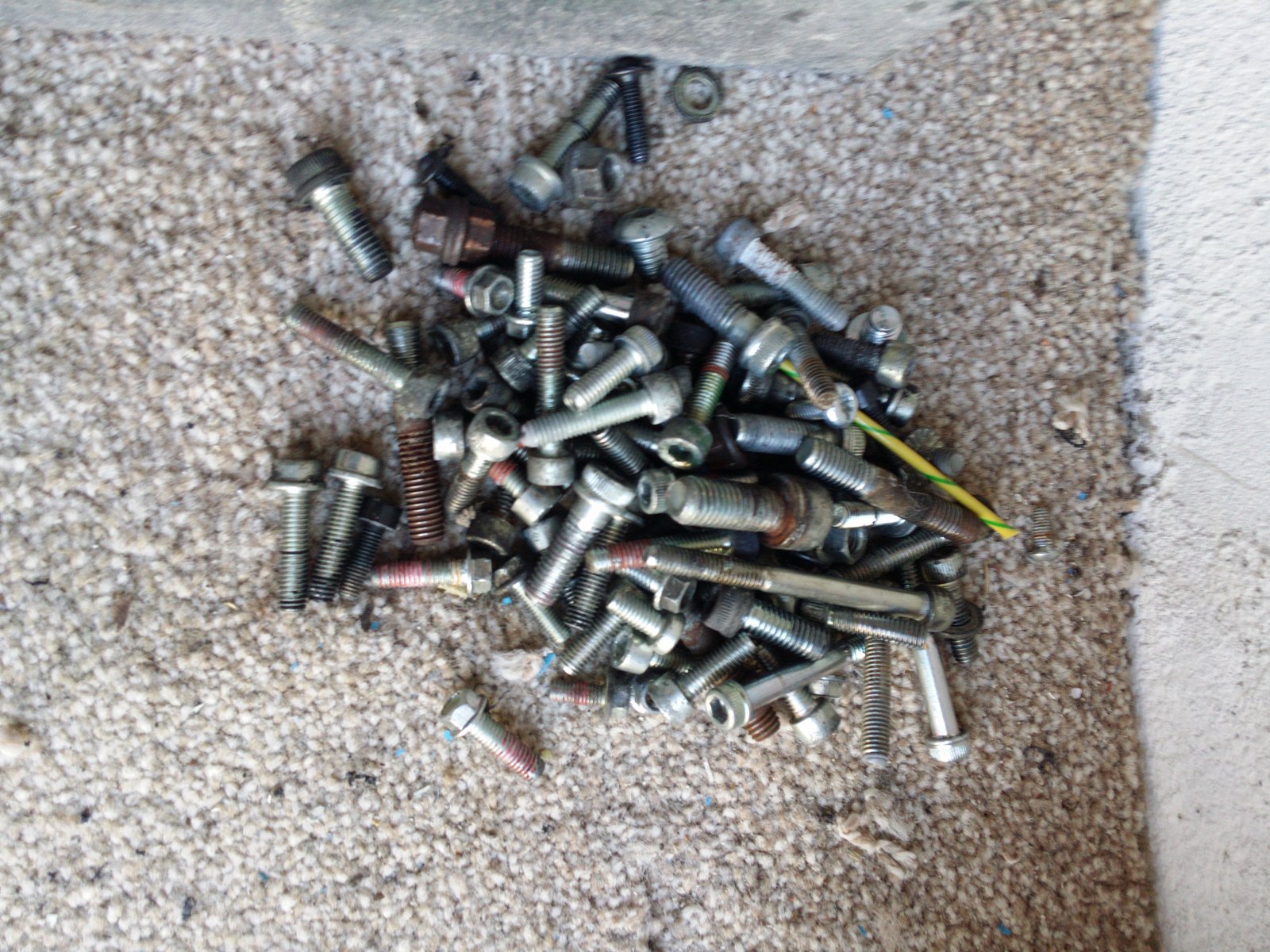

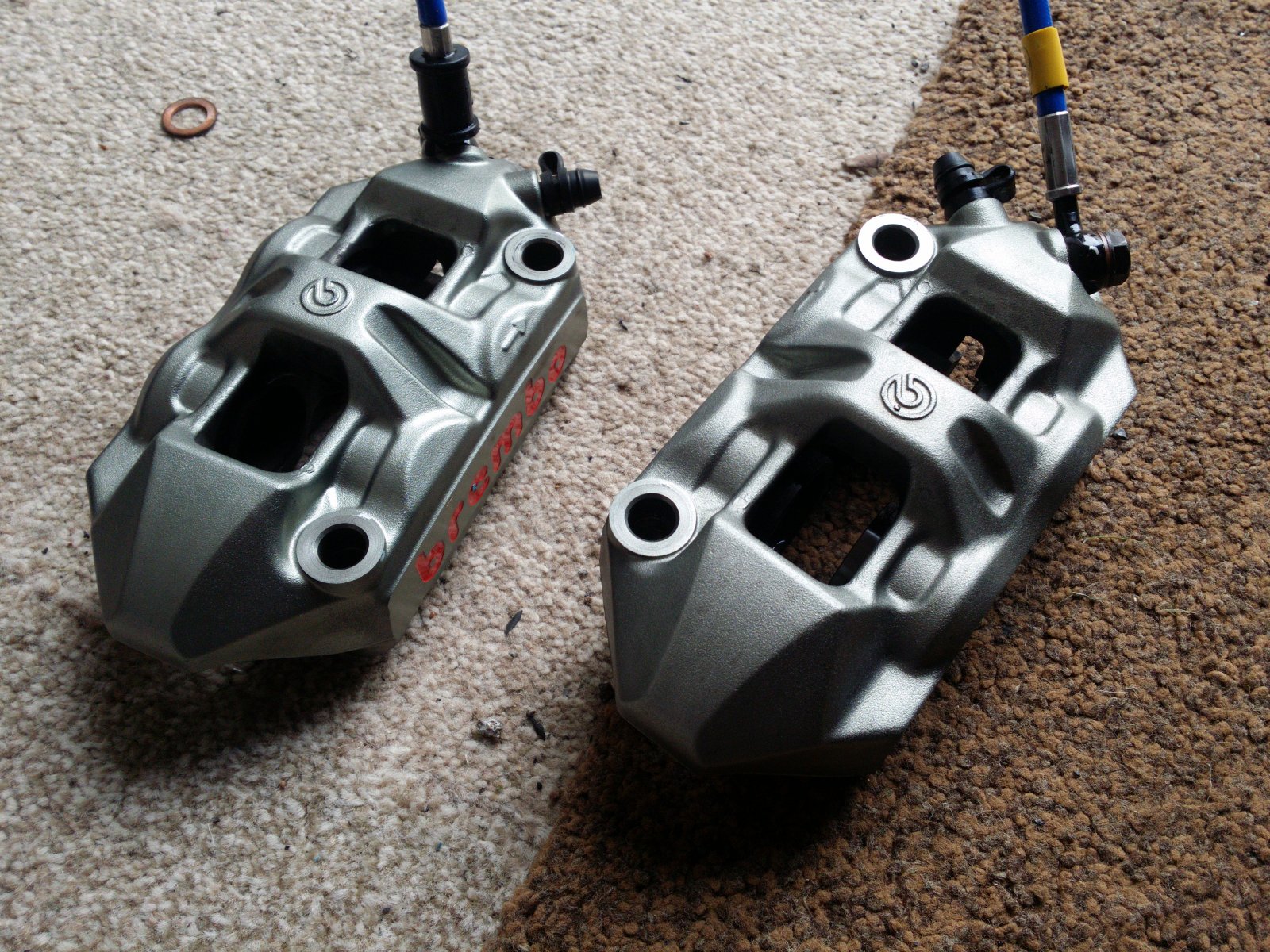

  19. It's Saturday.... More shitty fixings come off... Heres the pile so far...
    Hel front line fitted....
    Calipers stripped and cleaned....
    Stainless rear sprocket bolts fitted too...
    See IMG_20160416_104245.jpg Hopefully more stuff getting fitted next week...
