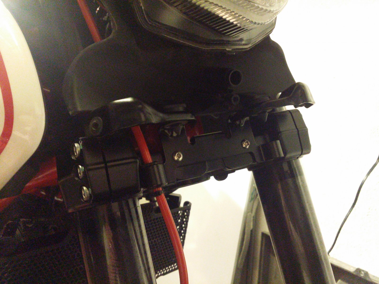

  1. The hel line on the front is in all fairness a bit short...ill contact them on Monday about this....apparently they migrated their site and not everything got carried over correctly so I had to give them the loop over length as theirs was about a metre or so....it could really do with being a few inches longer....

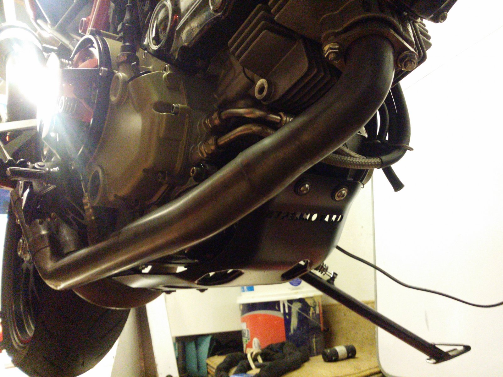

  2. More fettling this evening... Starting to come together... Coaters fixed the oven...

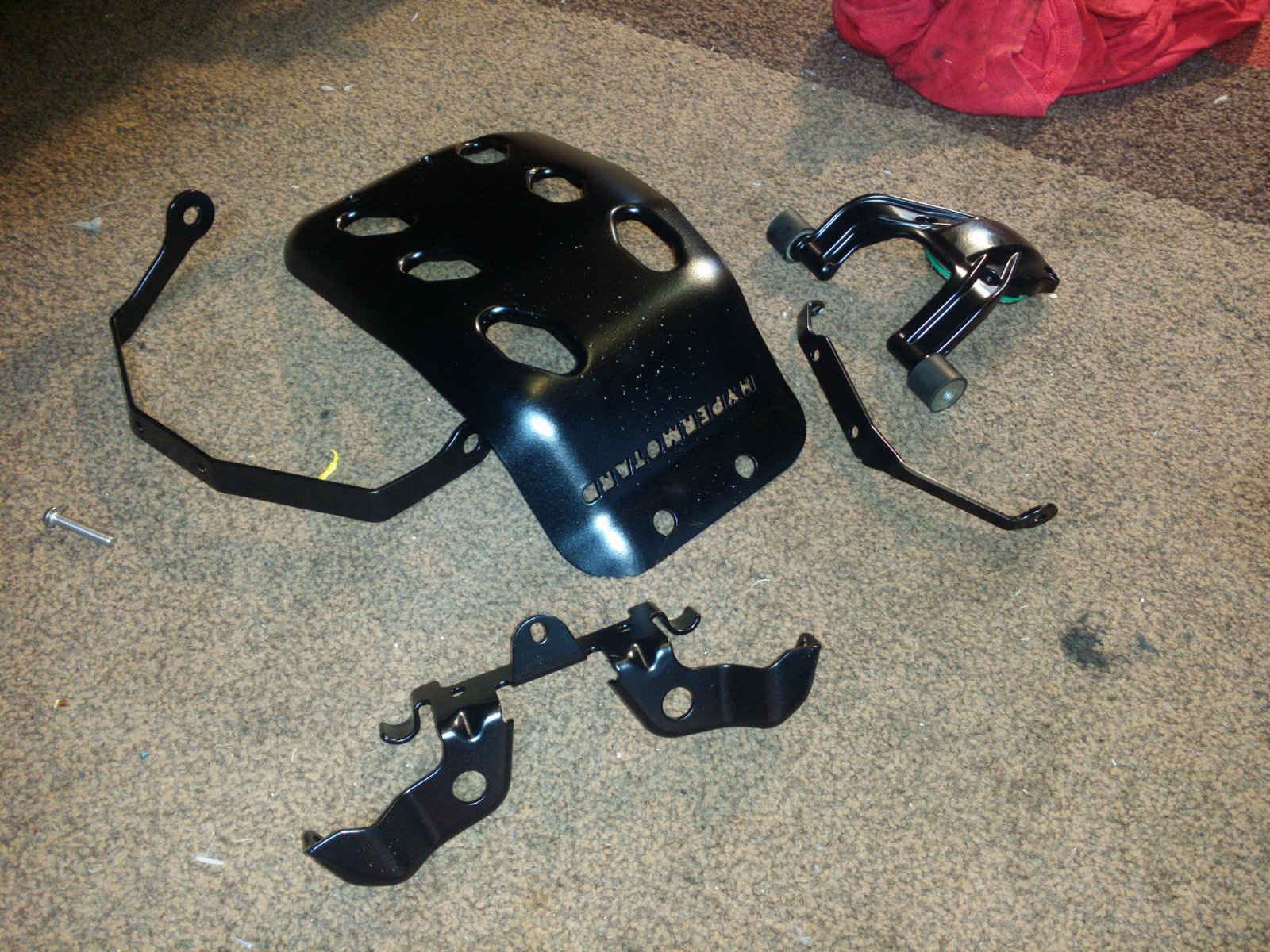

    Brake line guide in...
    Bash plate fitted....

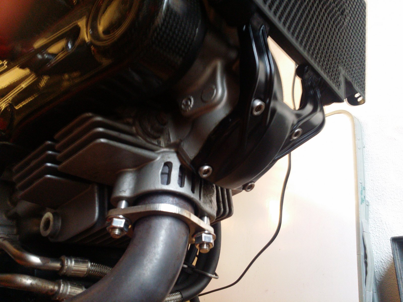

    Valve cover fitted.... Should have taken a before photo it was awful...

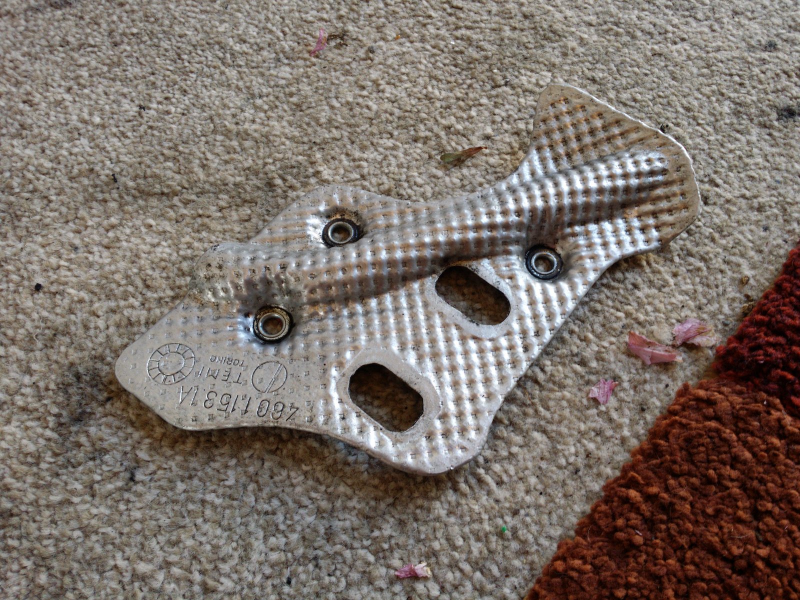

    Not a brilliant pic and pretty well all of it you'll never see but... When it gets caked in shite it'll be easier to clean and it won't corrode...

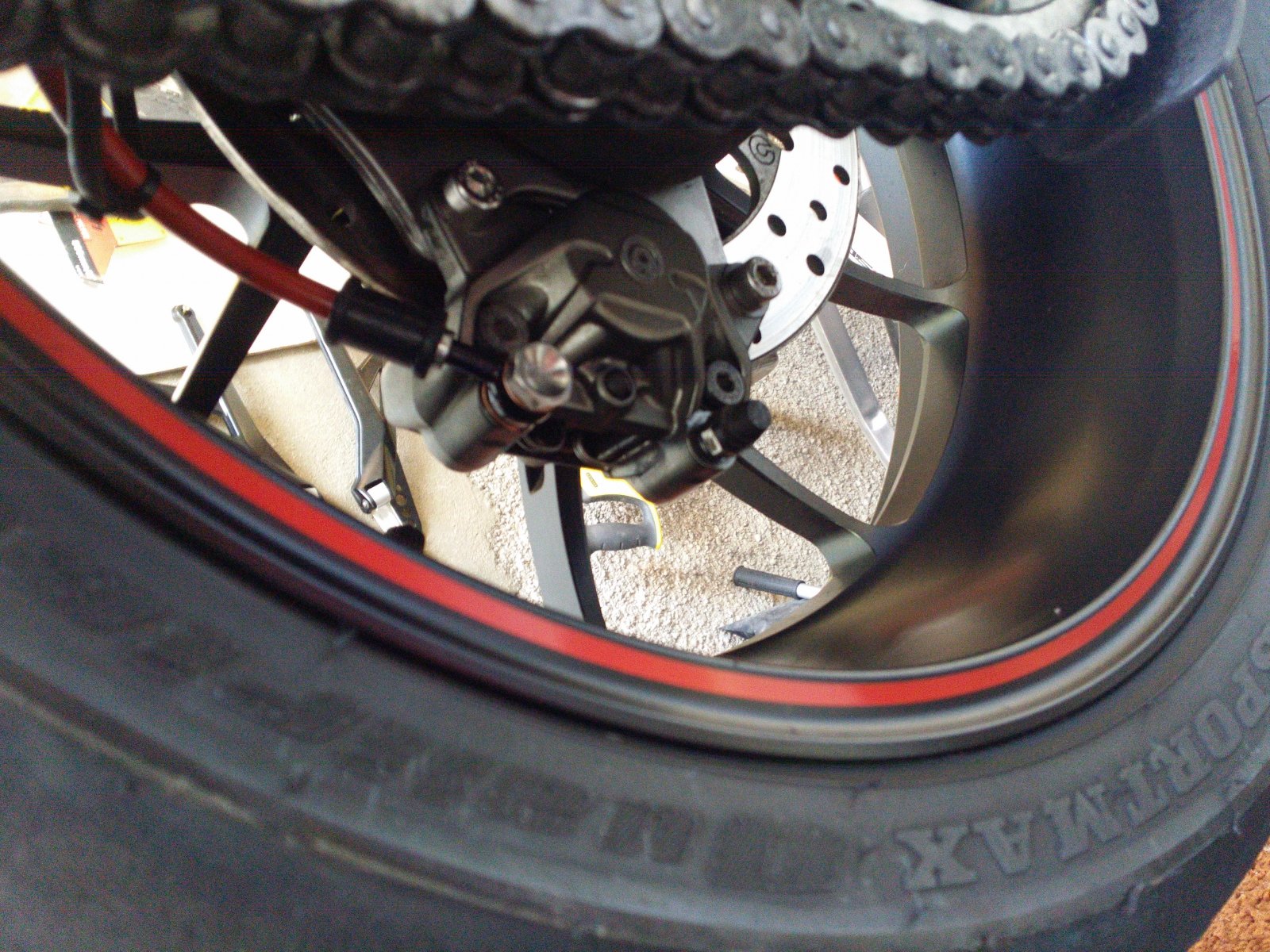

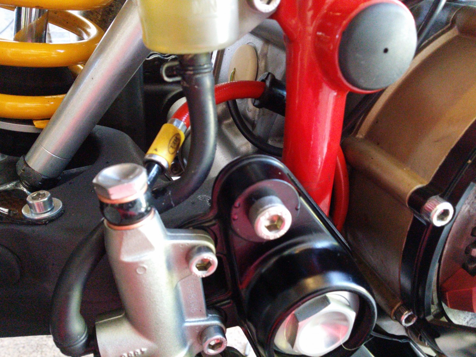

  12. Fettling continues. Just about to measure the rear brake line (may have a spare hel line). Been out on it this morning post dyno work....still died once so still something to look for....
  13. Well...that was a stroke of luck...the line they made too small for the front fitted the rear perfectly...

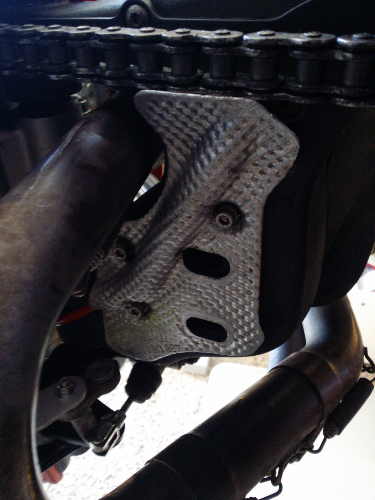

    Cleaned up the rear caliper and gave the heat shield under the swingarm a scrub also...
    All in all a productive afternoon...sort out the indicator speed tomorrow with some resistors...
