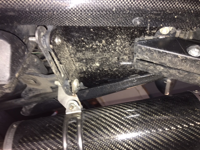

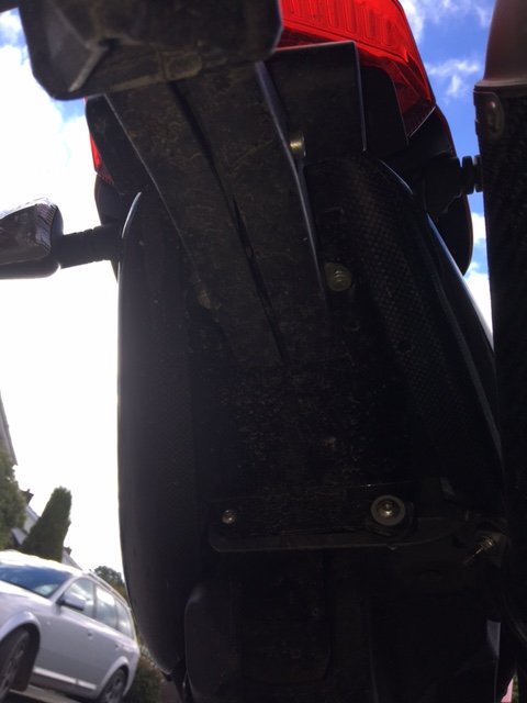

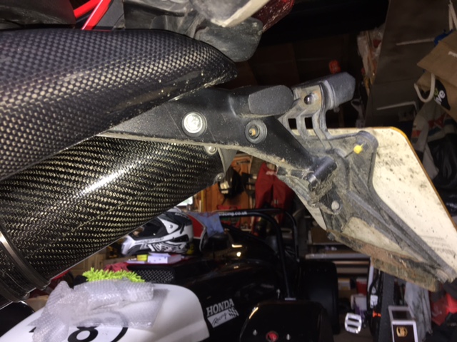

  1. Not sure - difficult to see....is that the stock tail tidy that youre using at the moment...?
  2. Yes, I'm at home with bike now if you want some better - ill go and see what i can do!
  3. If anyone out there has a spare stock on i could borrow then that would be a lot easier!
    Yes - if the flash could be on then i can see more...
    Any better?
    Nice new carbon blingingness!!
  6. Ok - a bit better....so the 2 bolts on the right hand side of the pic are the actual mount points - the 2 bolts on the left are the mount points for the pipe itself? am i seeing that right??
  7. Yes i think you are correct - without stripping it, i think the right bolts are tail tidy, left is exhaust hanger.
  8. Just seeing the nose of the hyper there i still had it in my head it was an 821 for some reason....ive got a stock tail tidy at home....ill go and dig mine out tonight...the left hand bolts are the mount point for my pipes too....
    Not 821, its one of these!!
    thanks @comfysofa
  10. Same as mine....ill have to piece mine together to see how it all fits....just to make it really easy its all packed away in boxes....
    Edit - just while im seeing this and casting my mind back to the last time i had it all unpacked i think....theres a small mount which sits inbetween the the tail tidy and the sub frame....before i even go looking i think thats the bit i, a. need to see and b. dont have...! although i cant be sure....

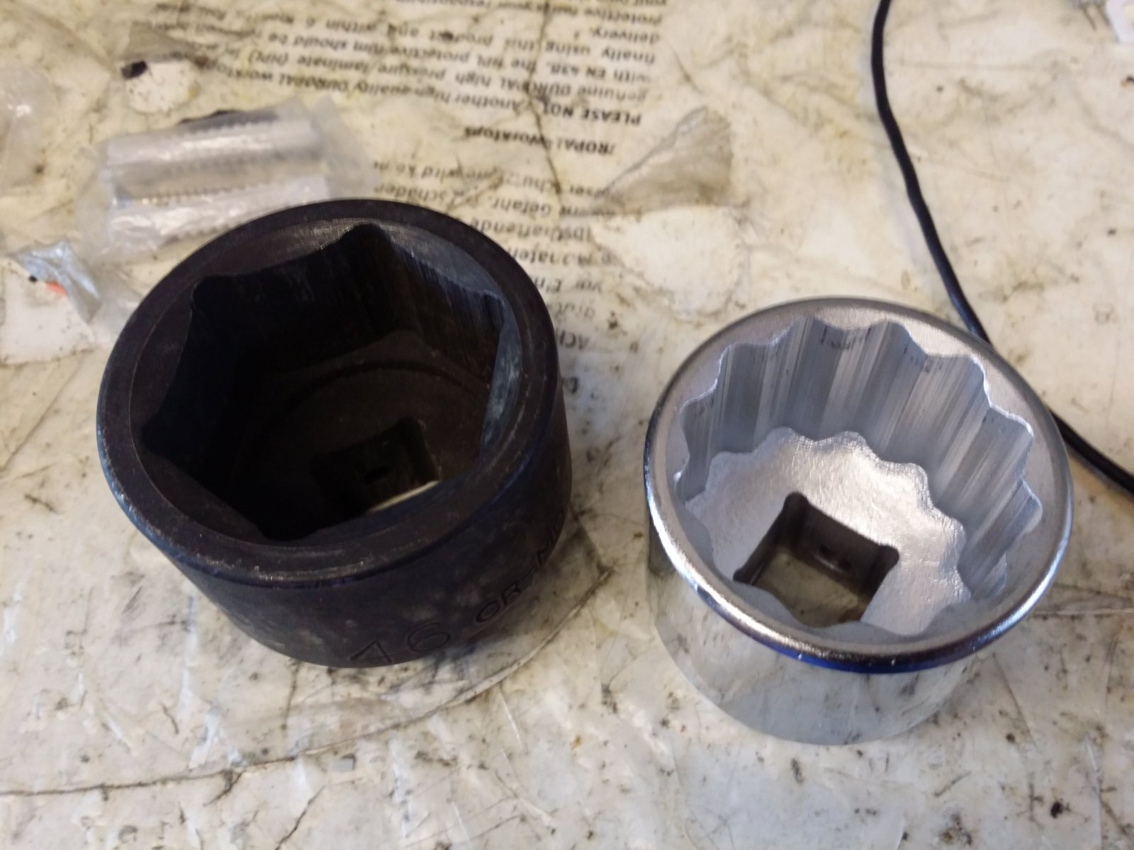

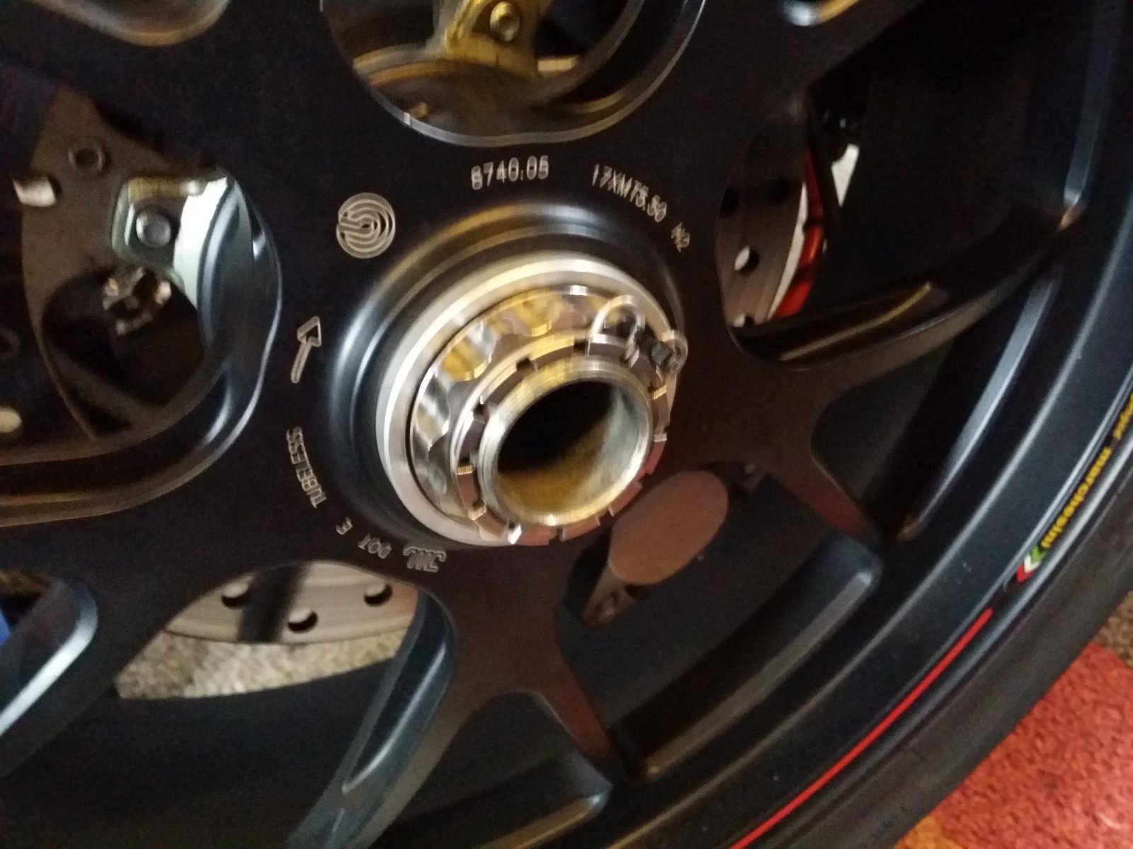

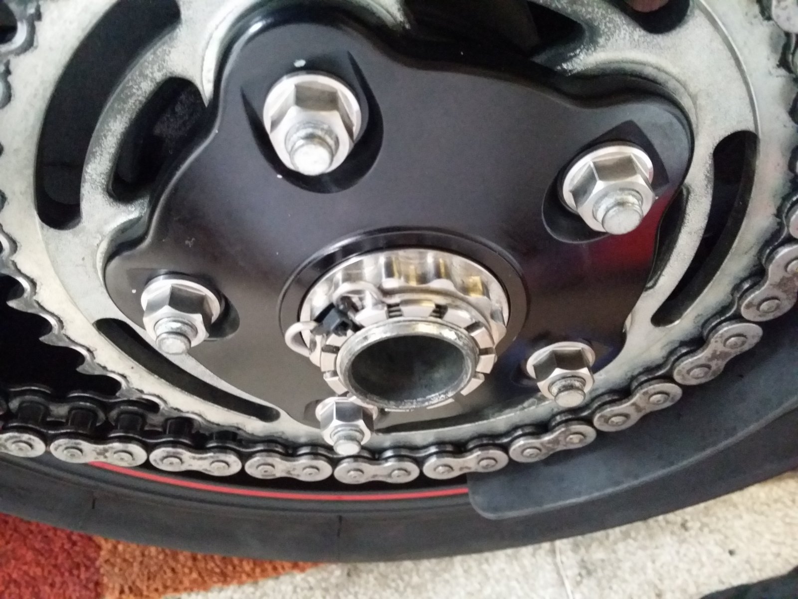

  13. So, bought the 2 titanium rear wheel nuts and then had no sockets to fit. . . The 46mm socket, the black one didn't fit so had to order a 46mm with the other shape which did fit. They're you have it. . . . 1. 46mm ain't 46mm and more to re point putting a vernier on the nut a can't get a measurement of 46mm from anywhere. . . Go figure. . .
  14. Or maybe a Single Hex socket won't fit on a Double Hex Nut.
  15. Yeah.... But the point I was making was 46mm ain't 46mm on the multi point.... The black socket from flat surface to flat surface is, 46mm...
    Sent from my SM-P900 using Tapatalk
  16. If you draw an imaginary line between the socket "cut outs" that would fit on a Single Hex Nut and then measure it would be 46mm.
  17. Not my vernier... While I'm not in the garage from recollection it was something like 48mm...maybe a bit more...

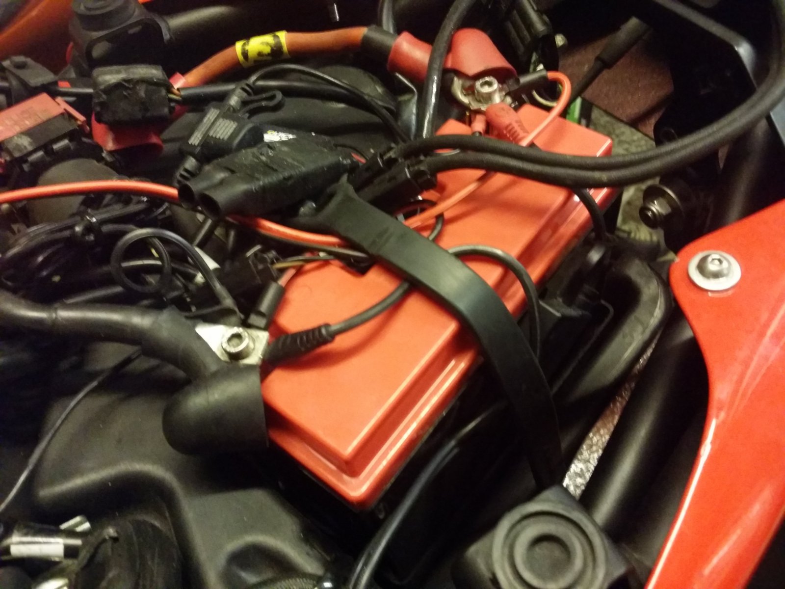

  18. It's been a while since I've confessed...
    Lithium battery fitted...

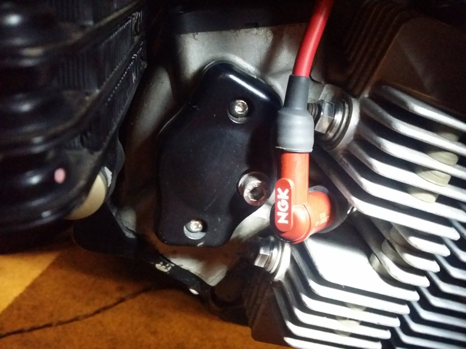

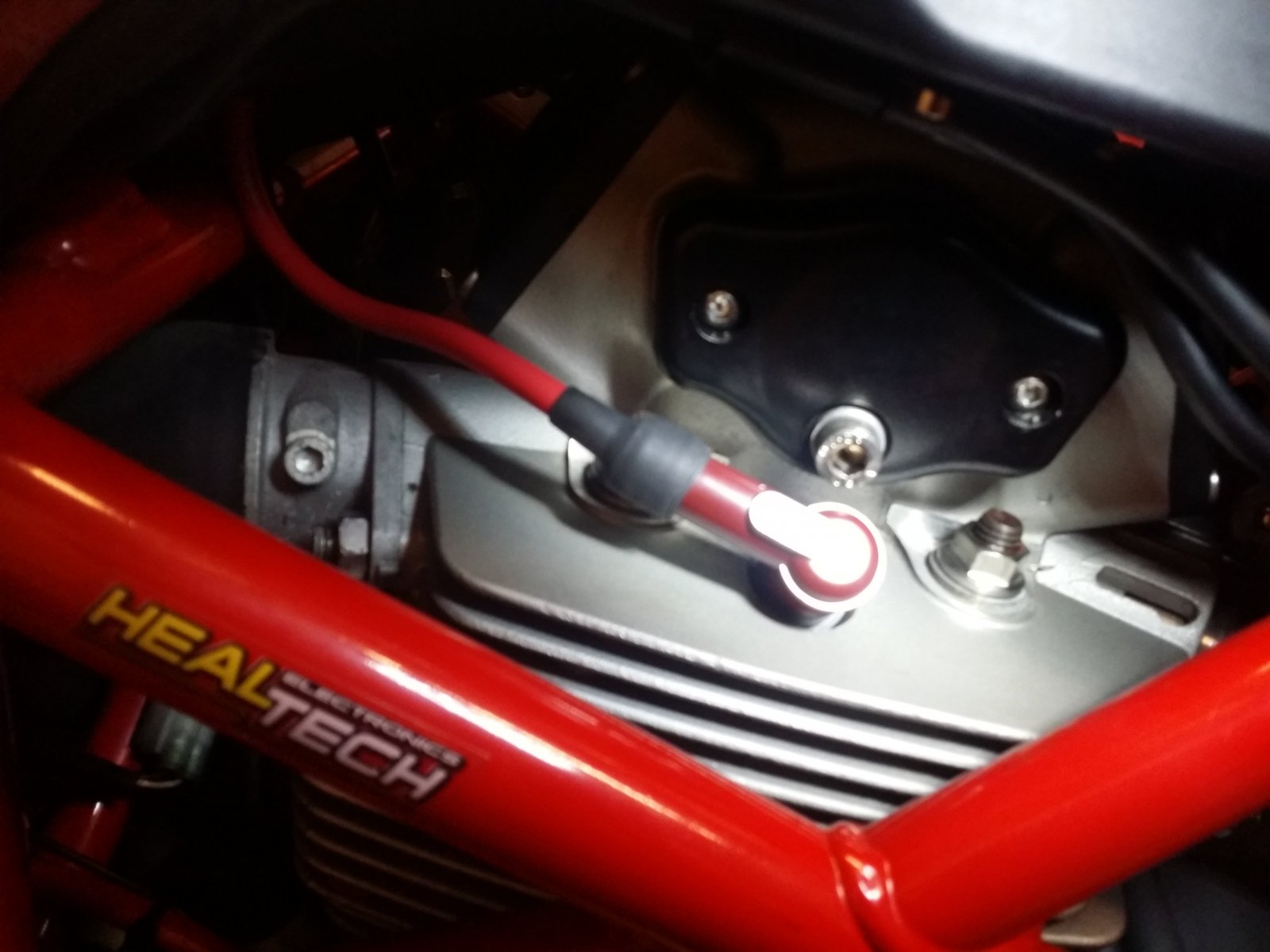

    New plugs, caps and ht leads...
