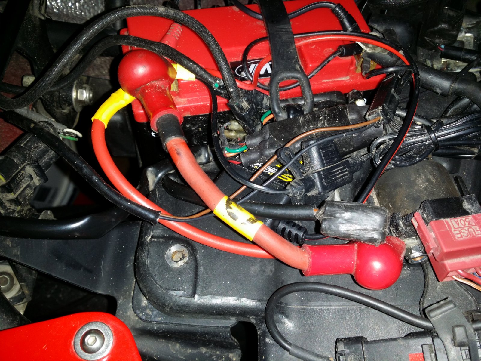

  1. It's the little things.... I was on the af1 forum the other day and one of the admin kicked a thread off to do with sluggish starting... Now, ironically I don't get that problem on my v4 factory but it do get it on the hyper... Not got to the bottom of it as I've got exiges heavy cables, new plugs, caps, ht leads and a lithium battery... So... I thought what the fuck and tried it... Doubled up the solenoid to battery cable, went out, got it warmed up, shut it off twice and restarted perfectly.... I'm not saying it's the definitive as I've only been out on it once but I'll report back after a month or so of usage... If anyone else has this problem, give it a go... Nice to see if it works (or not) for anyone else...

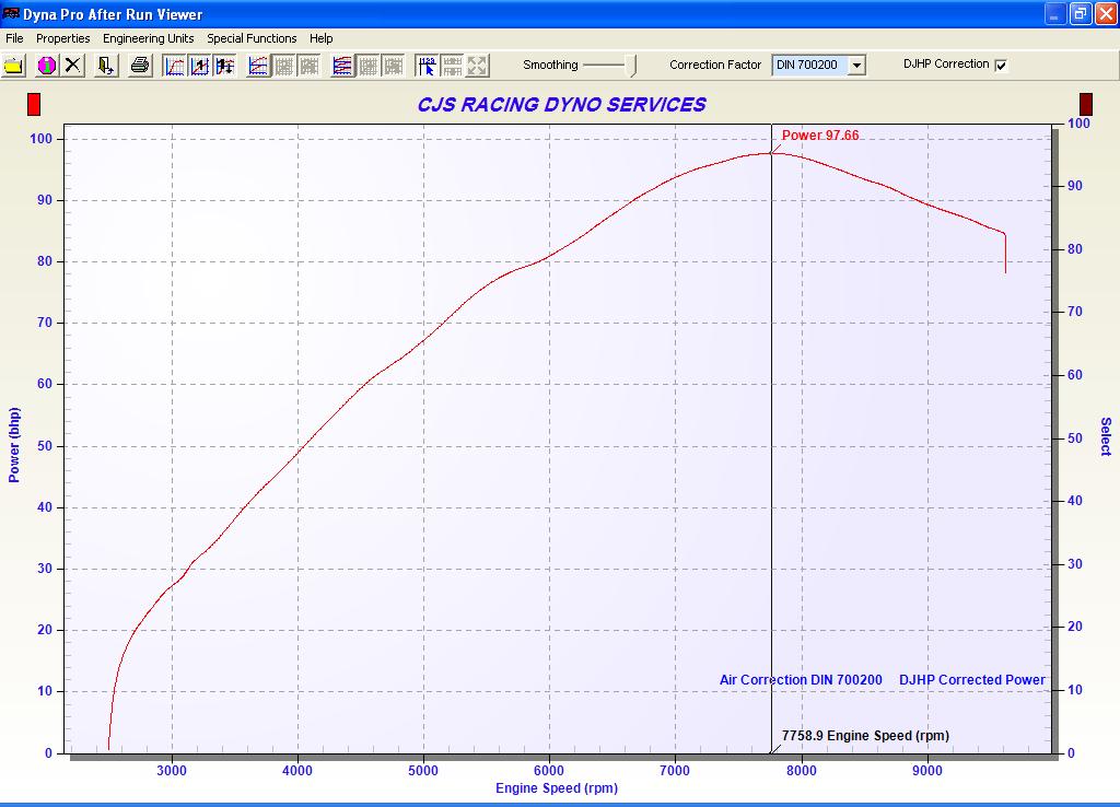

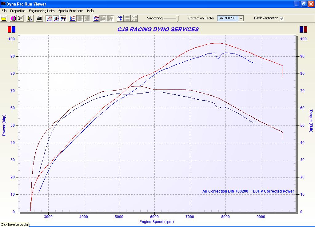

  2. Well, its taken this long....after fitting the air pods/filters god knows how many months ago, ive finally, financially (hopefully the financial news wont be too bad) got round to getting it back on the dyno to sort out the fueling. Its currently having the tank emptied at the moment at CJS. Chris has just texted me back to say that the addition of the pods "put the mapping right out" so i was running apparently pretty wonky at 92bhp but is now making 98. Ive not seen a graph yet but hopefully ill have one later on...gonna be a fun ride home....
  3. Yeah... It was a fun ride home... Unbelievably easy to spin up the rear now.... Tickover feels a lot stronger now... Brilliant work again from Chris.

  6. Post up the dyno print if you could comfy ...lets have a look at how it looks
  7. Just mailed in from Chris....

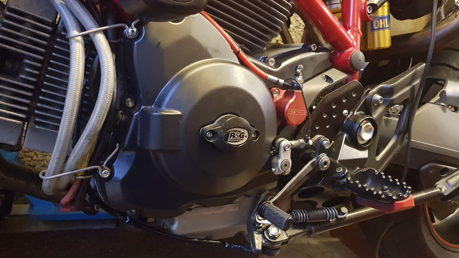

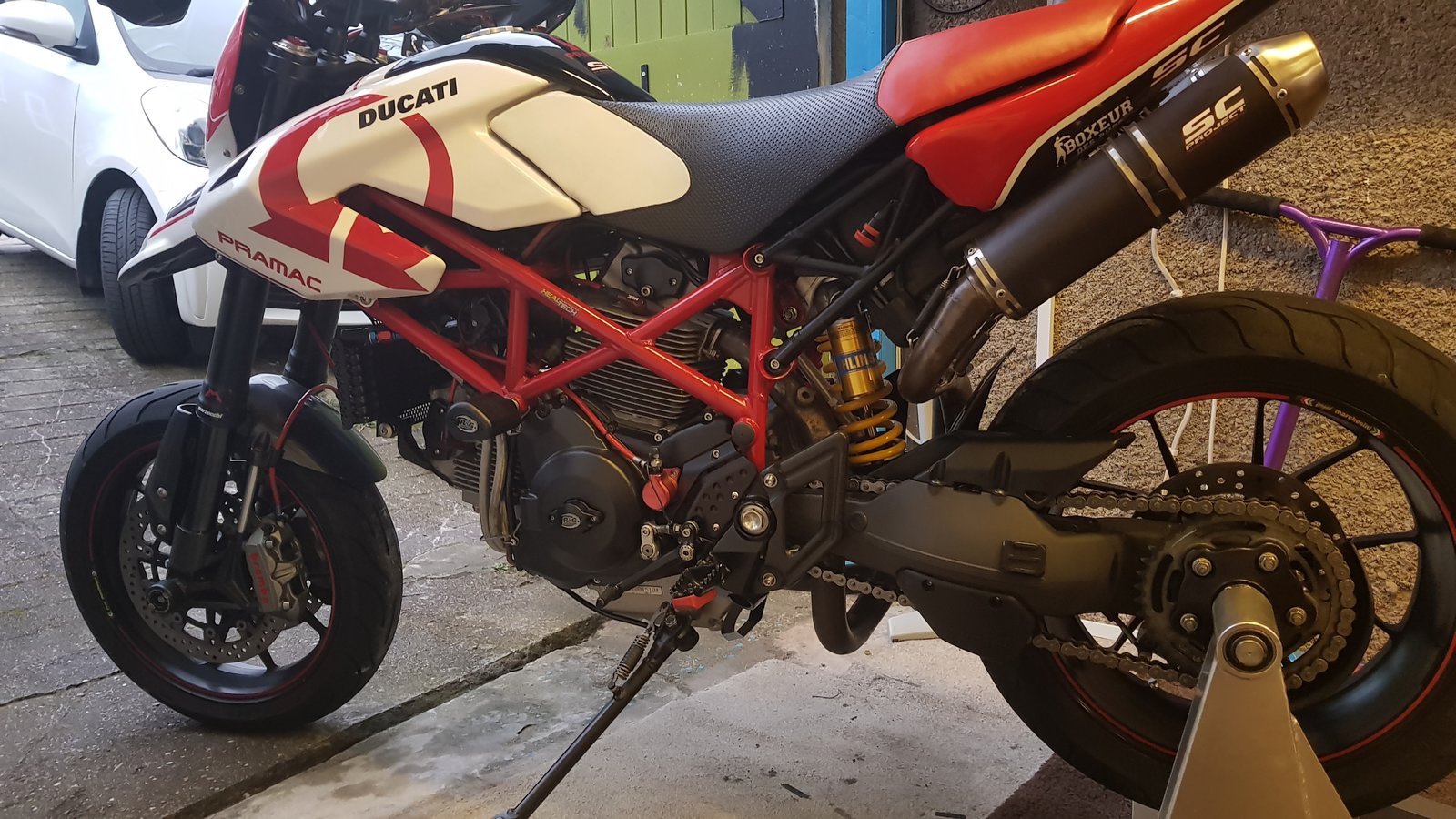

  11. Just to liven up my thread again....more fettling and tidying complete. As in another thread I've had the engine covers coated in cerakote. I've gotta say...I'm very pleased. Due to the colour scheme I think the old gold covers look pretty trick now in black...
    20180324_181825.jpg 20180324_181840.jpg 20180324_182016.jpg 20180324_182241.jpg
  12. Heh...well, it all went south.....
    Another thread being opened in a min....
  13. Crank seized. No idea why yet. I was totally methodical in the dismantling and reassembly. Fettling is gonig to a whole new level. The engine is coming out and has to be split so ill be at least recoating the barrell's, maybe the crank cases....depends how much im looking at...
