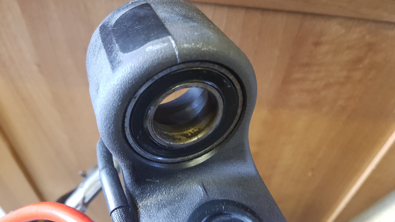

  5. As long as the sleeve rotates freely & they are well greased dhould be good, btw. When it's worn feels like a big end on the way out...

  7. Cool. Definately smooth so that's OK then....cheers.

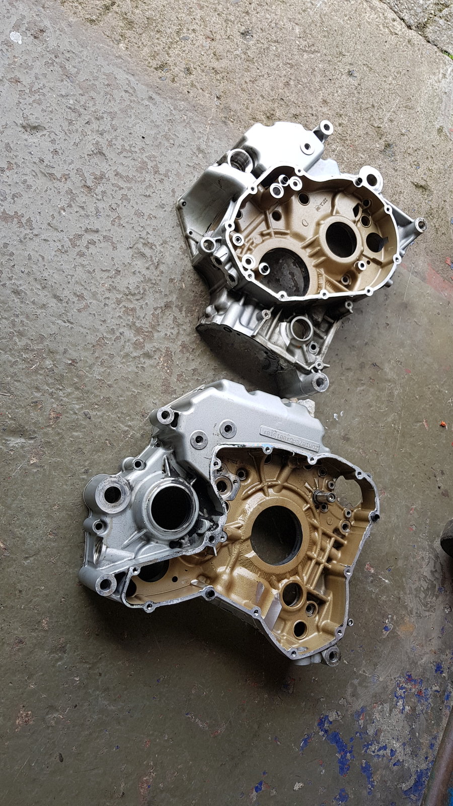

  8. Well, I'm planning on getting the motor up to ducati john sometime next week....he's bound to know....spoke to the xylan coating guy...reckons the whole motor will cost about 5-600 to do (he's done a few ducati motors before so knows how to do them and what's involved). About a month to turn around. Guessing its going to be off the road for a couple of months....should get a good chunk of the summer on it though...

  10. Yes....I was going to pay a visit to riders tomorrow....I'm guessing no more than a fiver per bearing....

  12. Try a local bearing supplier (if you have one). I was quoted about £20 each for front wheel bearings for an MV Agusta F4 a few years back. A trip to the local supplier got me a pair for £10.

  14. Yeah I believe you can literally take measuremeants and get as bearing to match...

  17. Crank shot. Engine stripped...
  18. He bloody works fast....
    Heads next...
