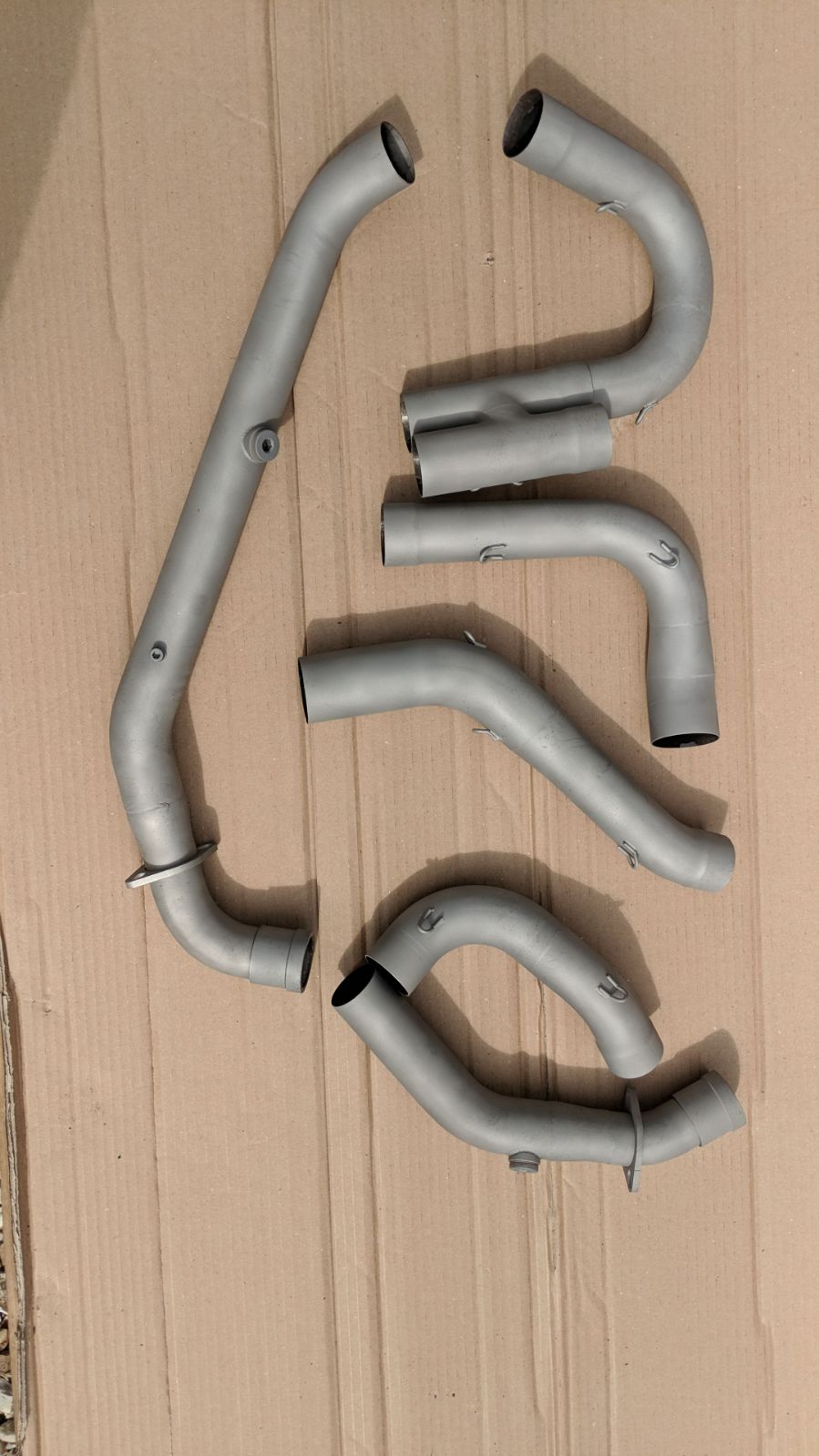

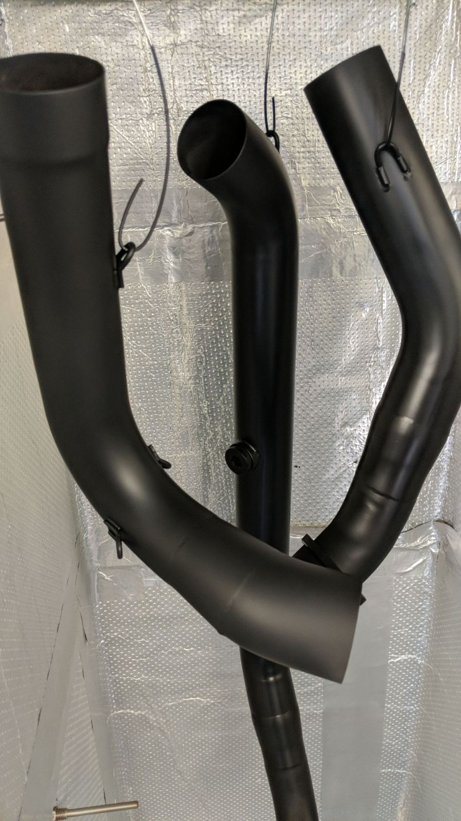

  13. First few pics from Mr Cerakote....pipes have their first coat. Currently masking up the engine...
  14. Love those black exhaust pipes. Hmm, might need to look into that :upyeah:

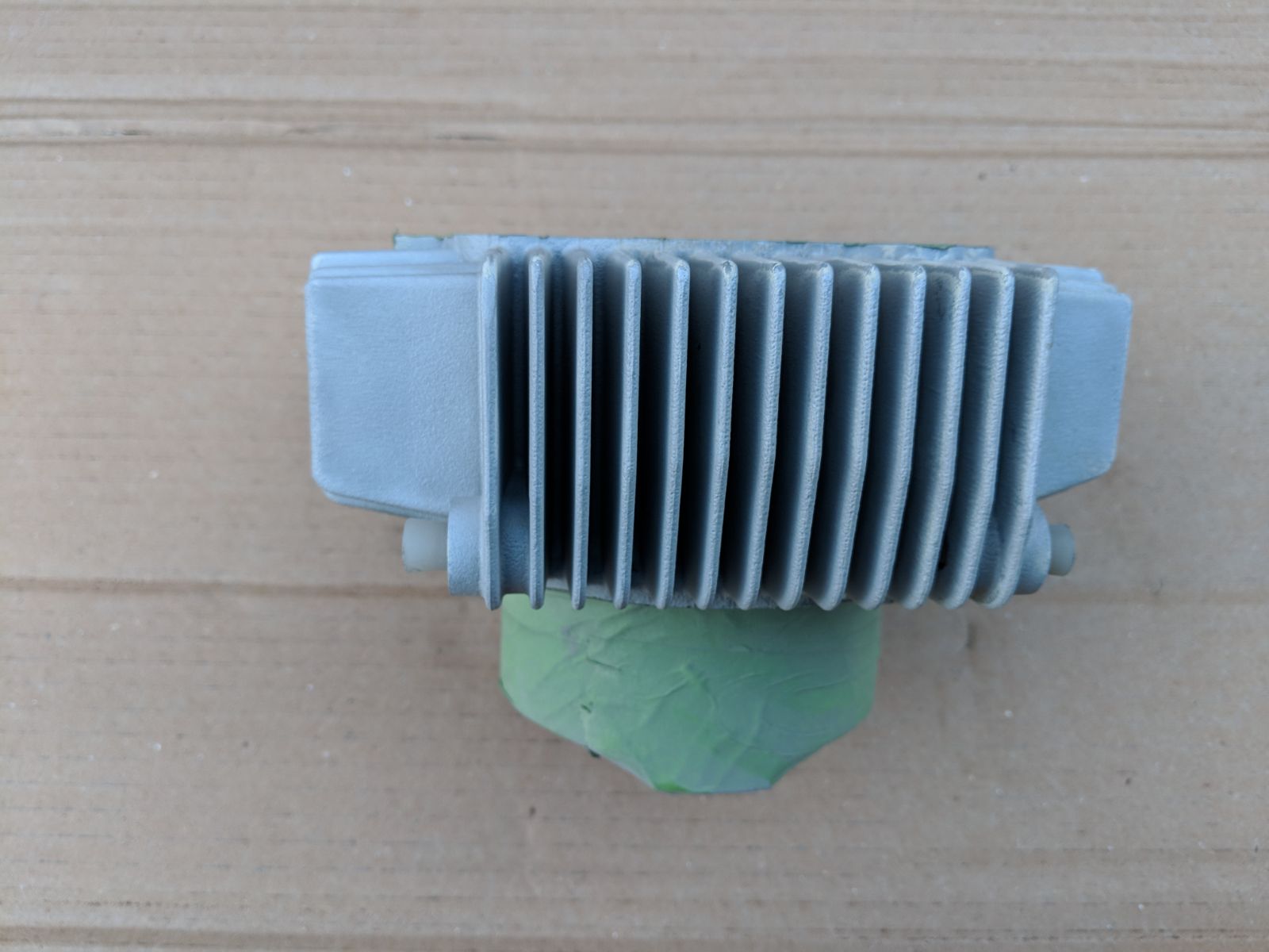

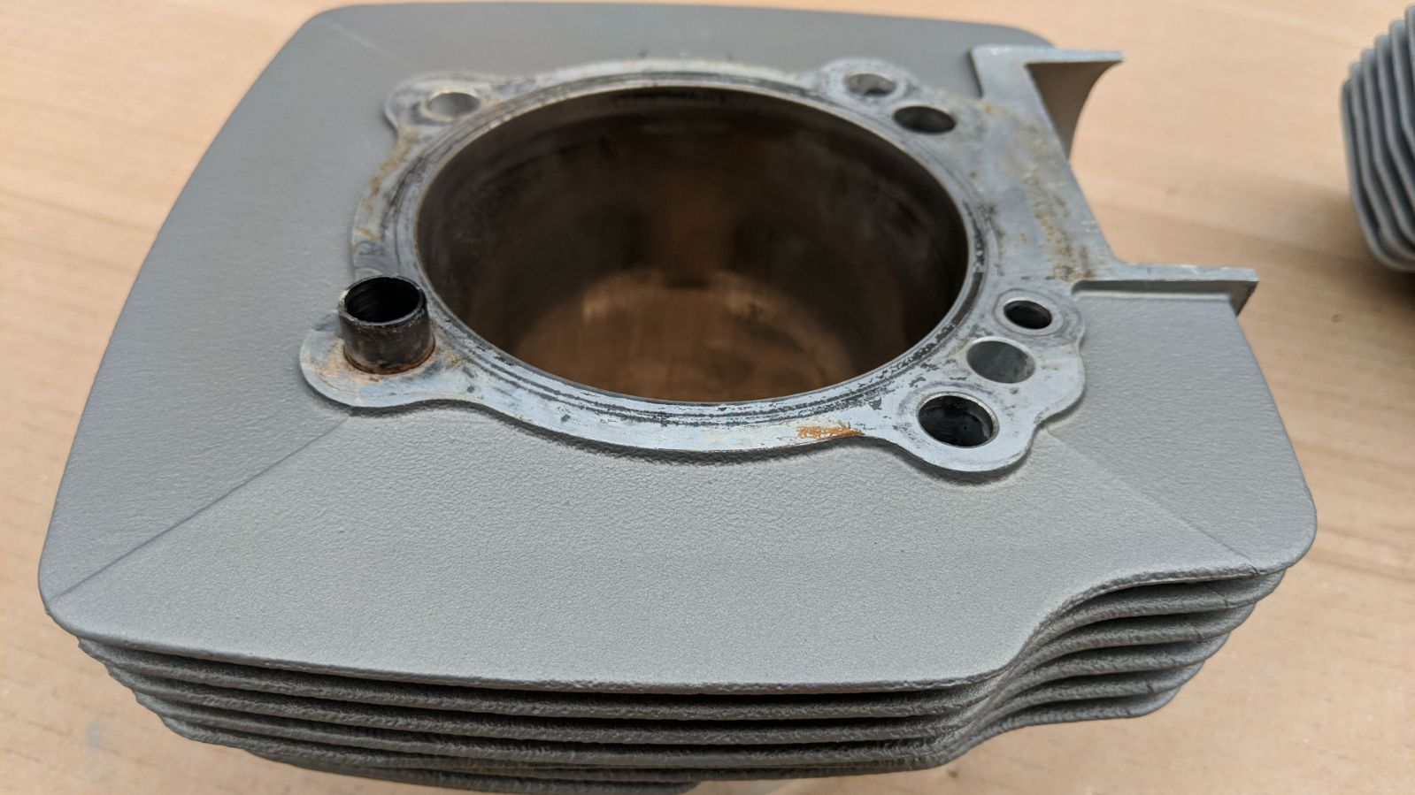

  15. Cylinder stripped...

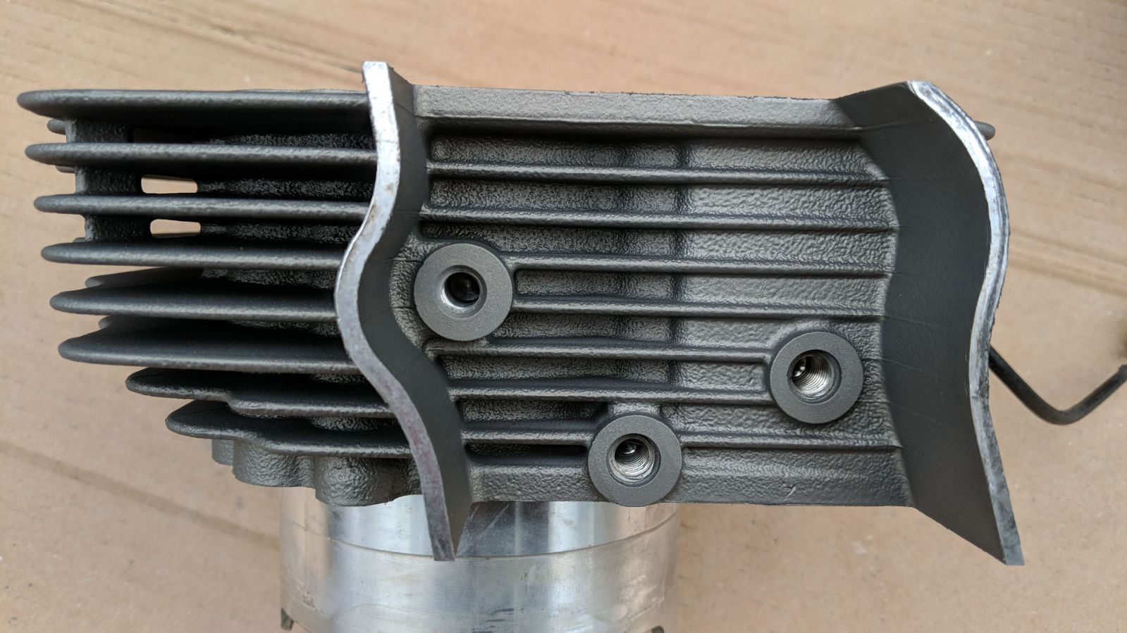

  16. More pics incoming...

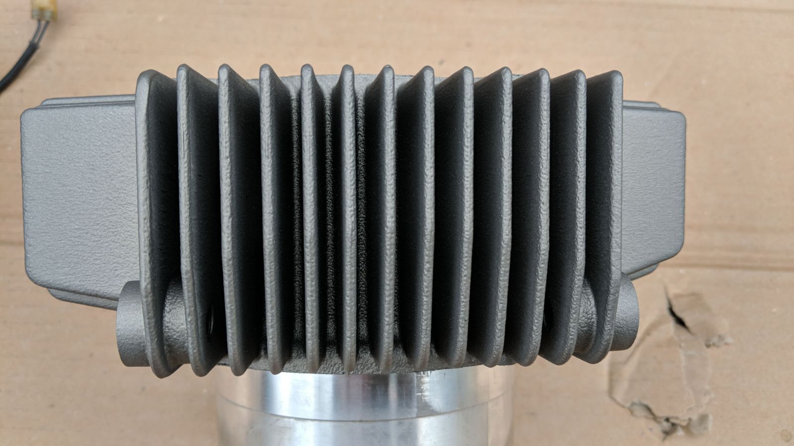

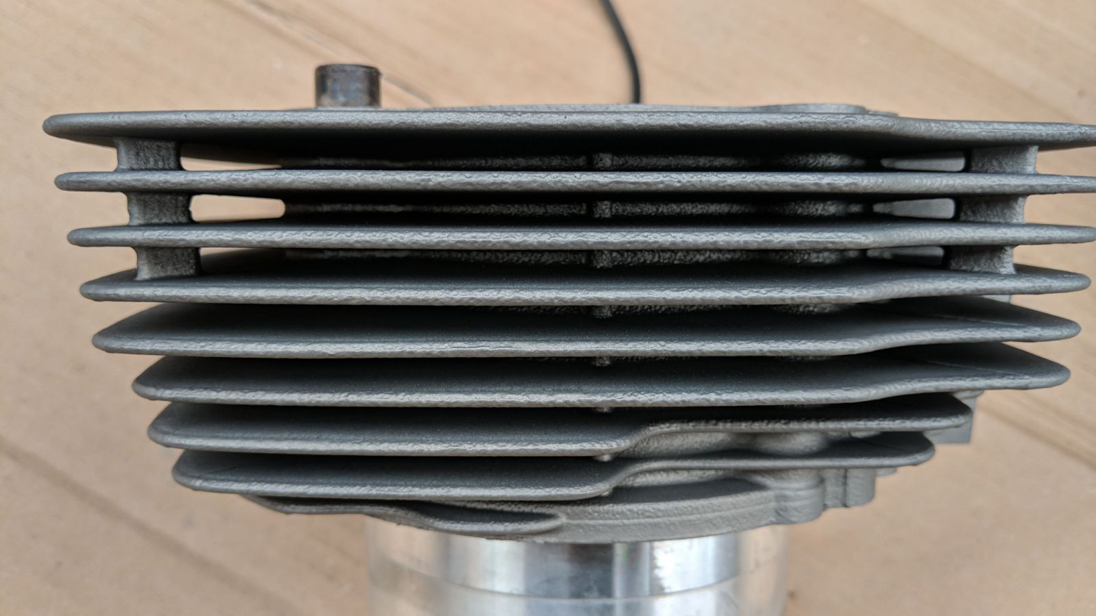

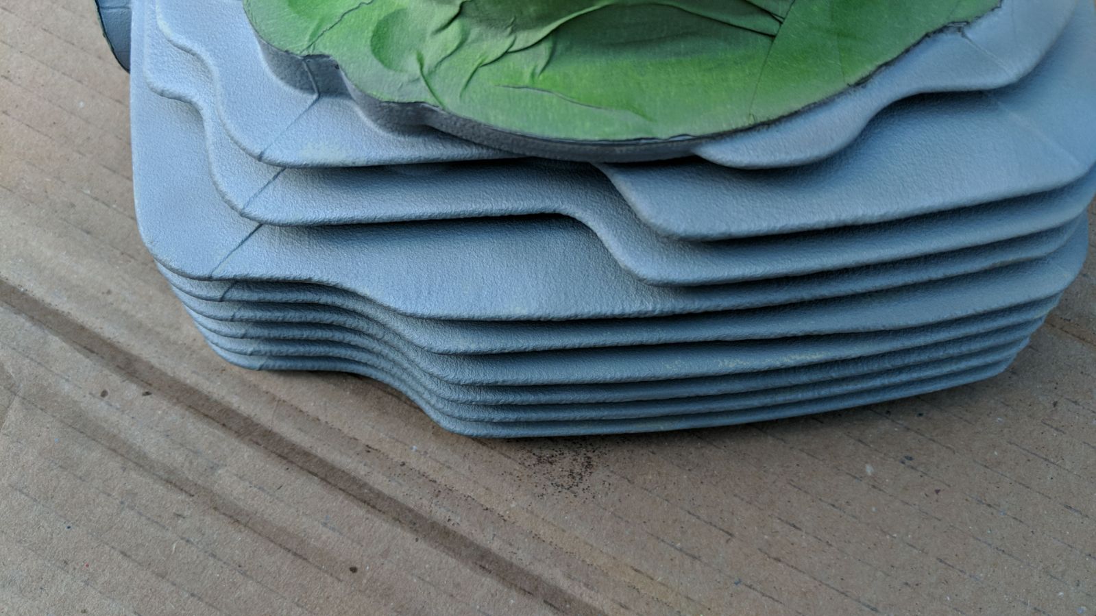

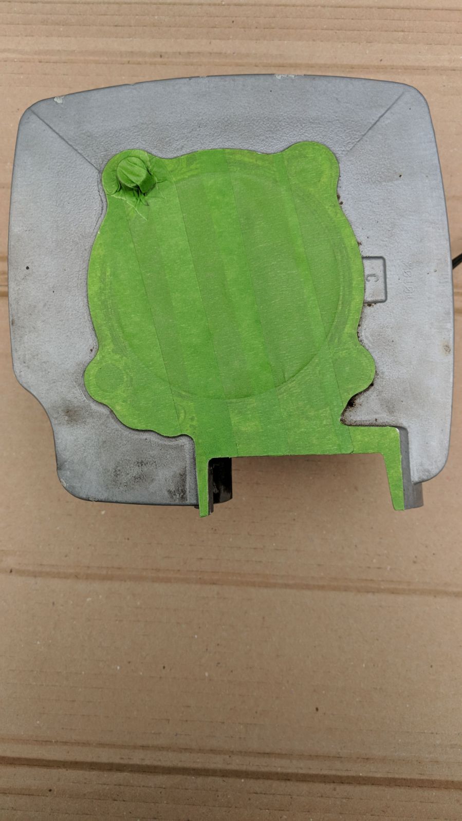

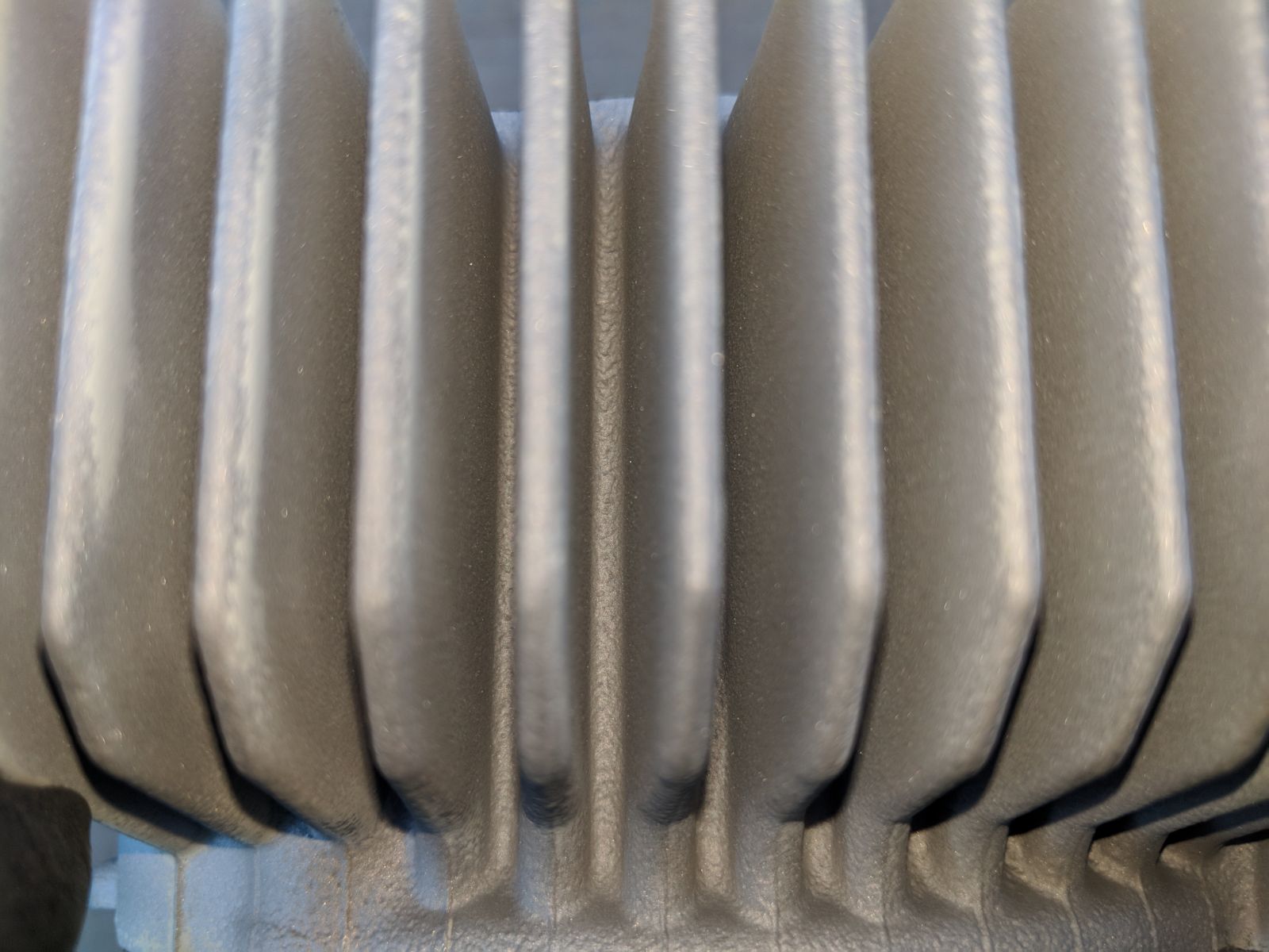

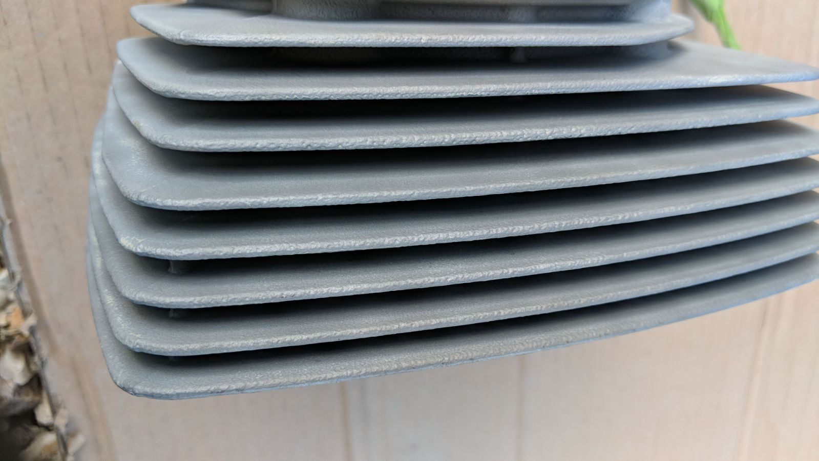

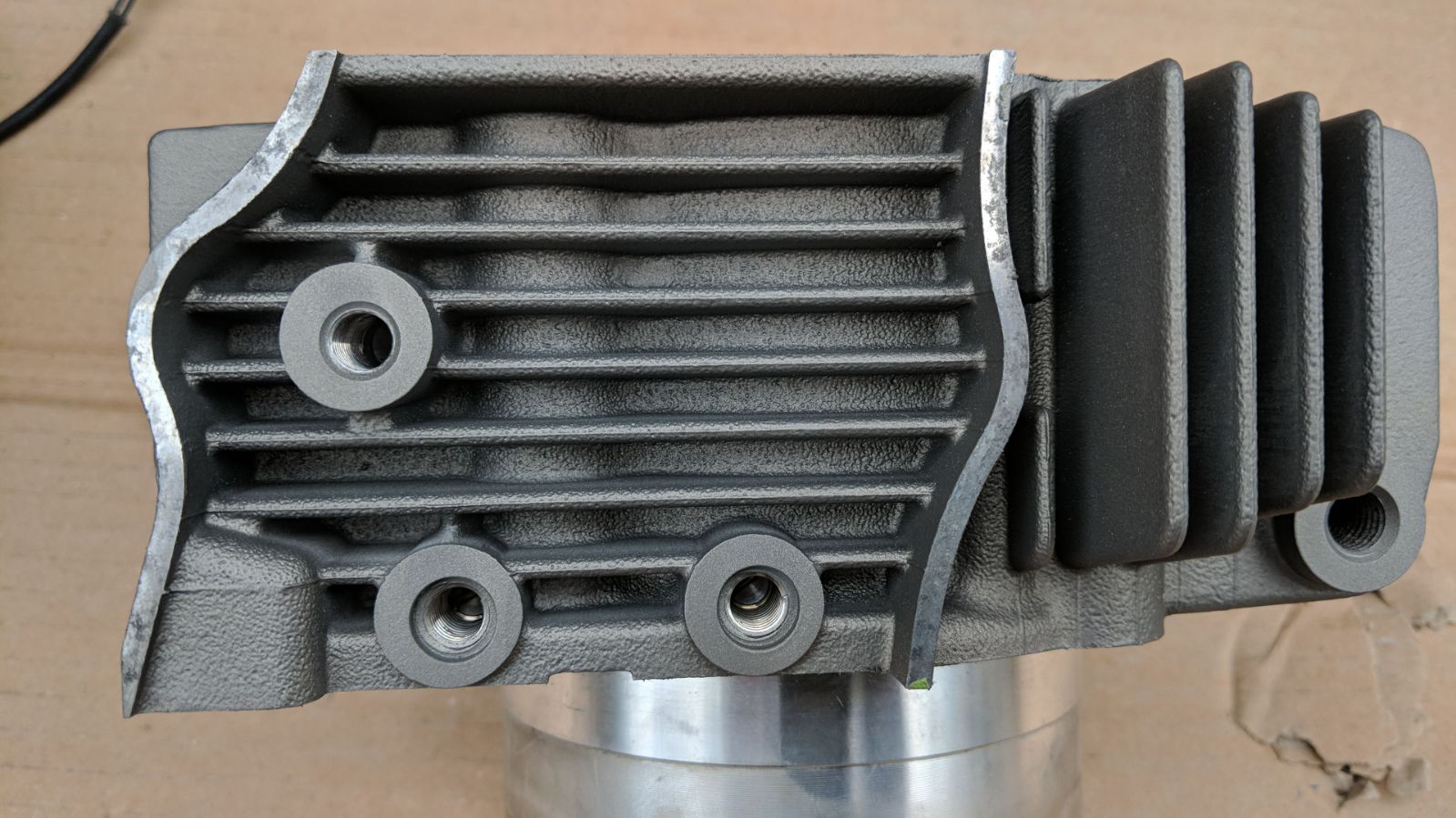

  17. It's nerdy I know but I gotta put them up...
    IMG-20180423-WA0002.jpg IMG-20180423-WA0001.jpg IMG-20180423-WA0000.jpg IMG-20180423-WA0004.jpg IMG-20180423-WA0003.jpg
    These are now coated - just to clarify...
