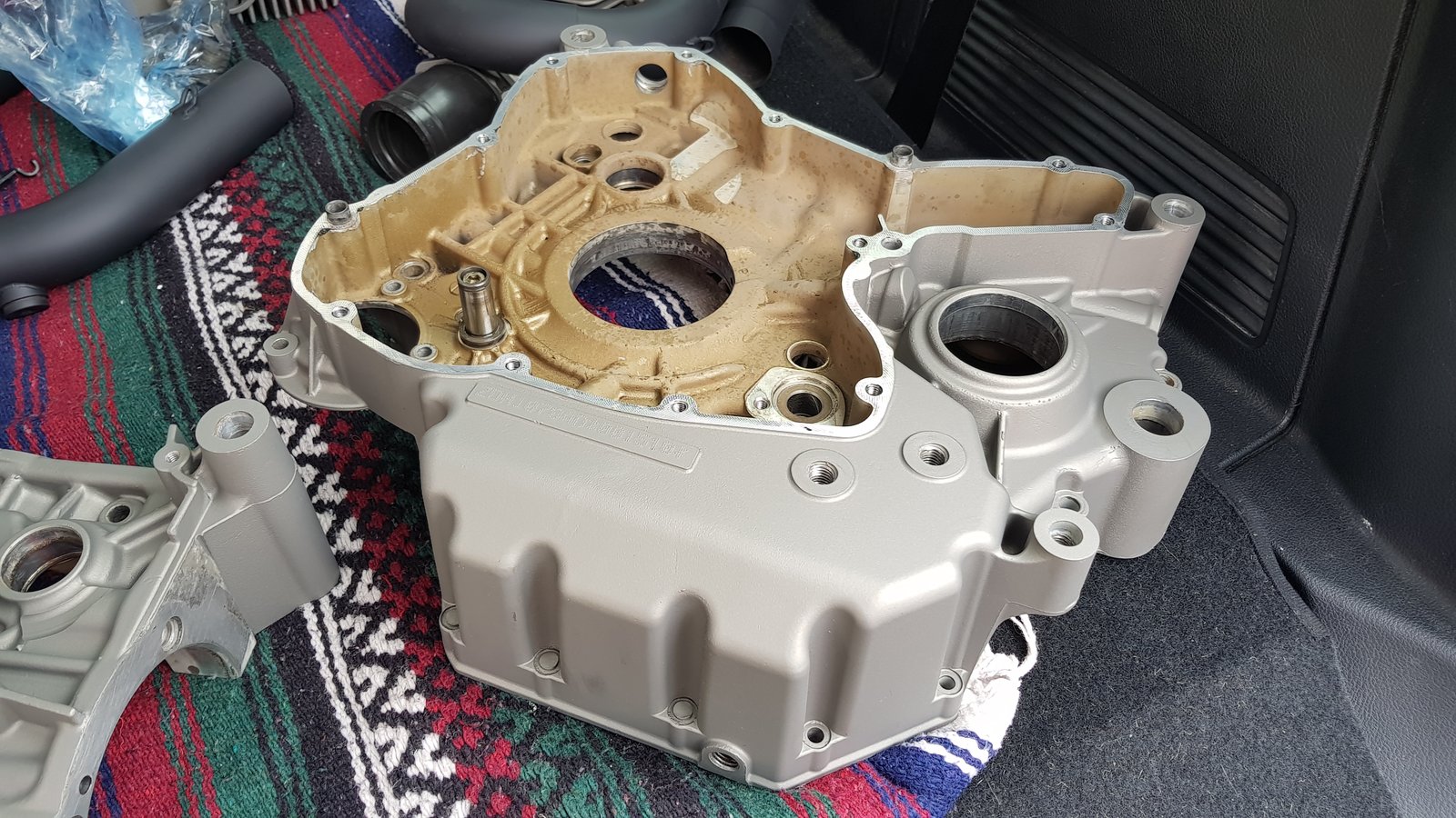

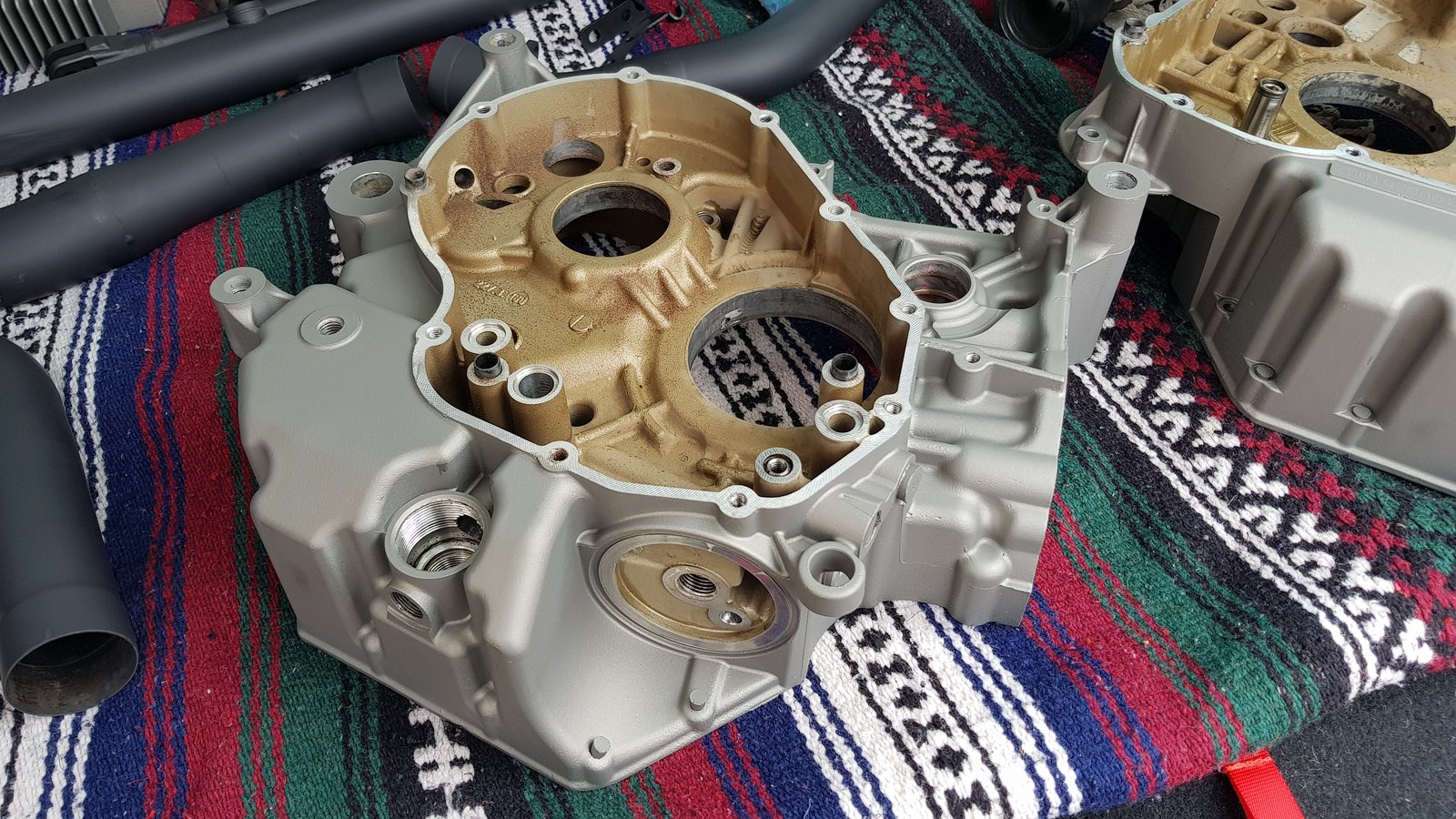

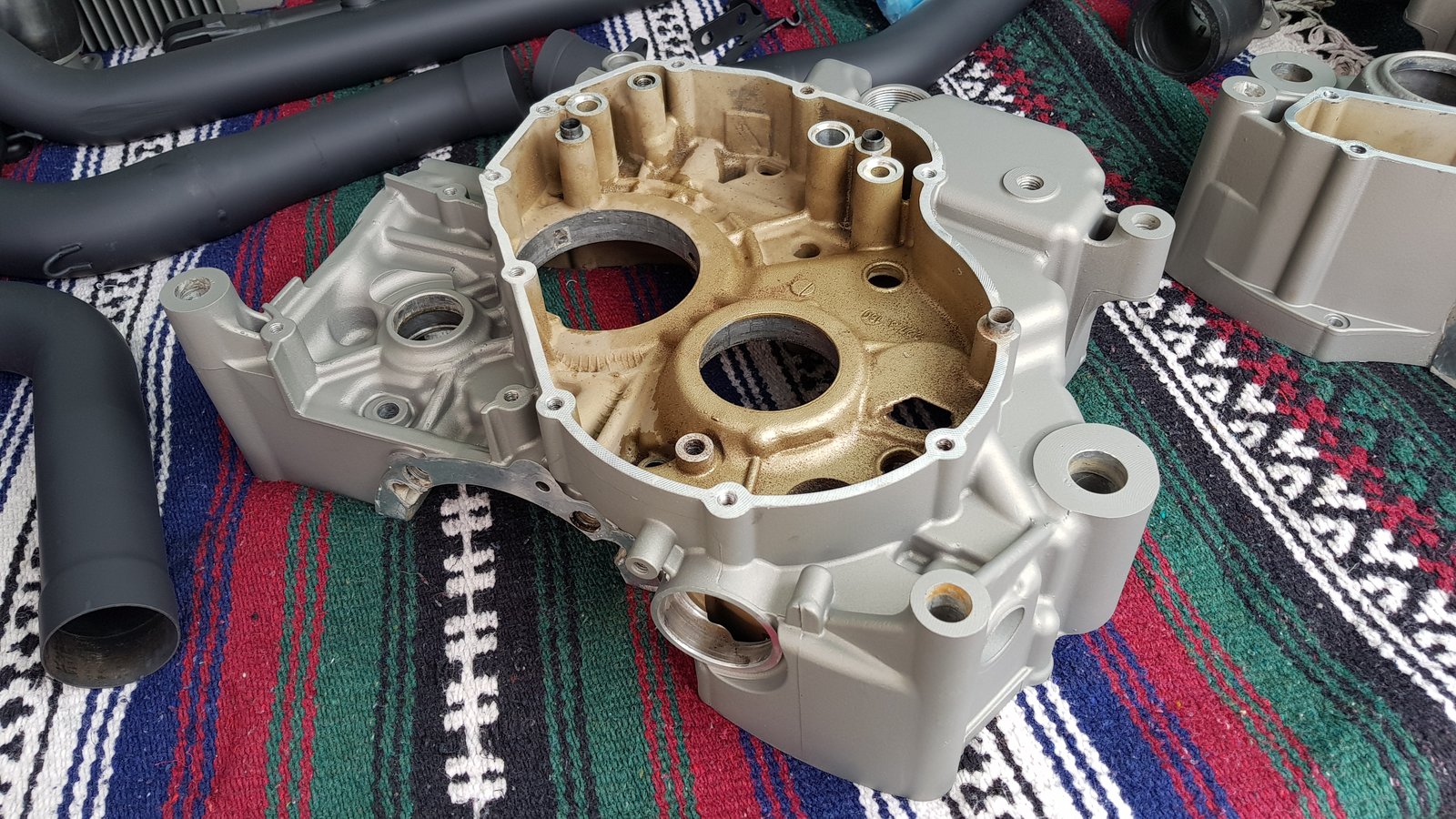

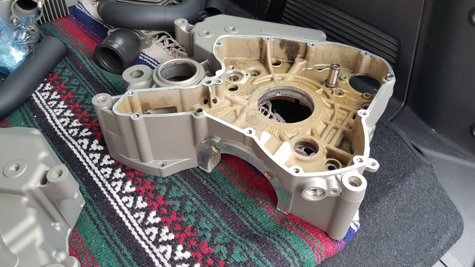

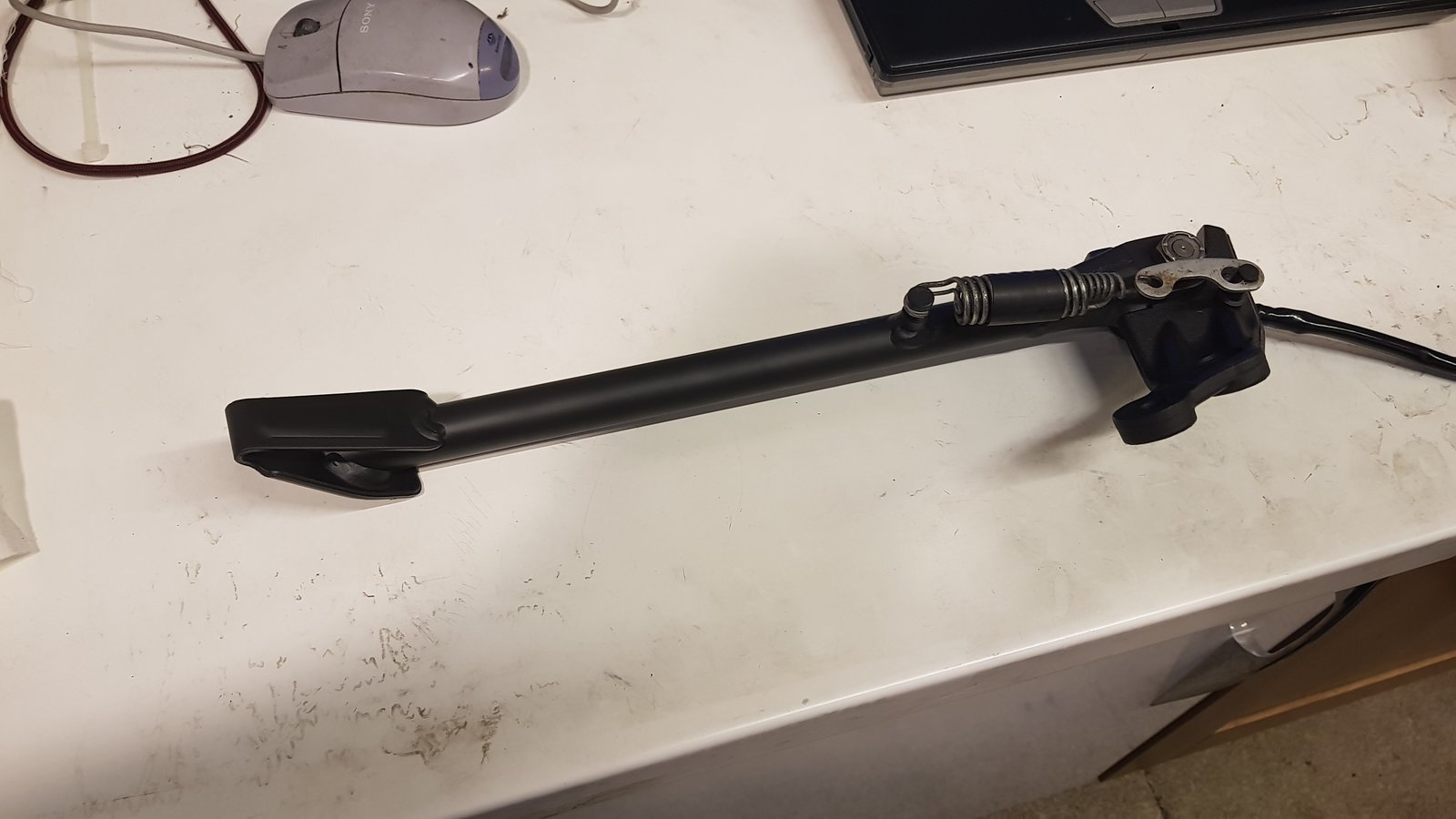

    Stand unit rebuilt...all cerakoted...

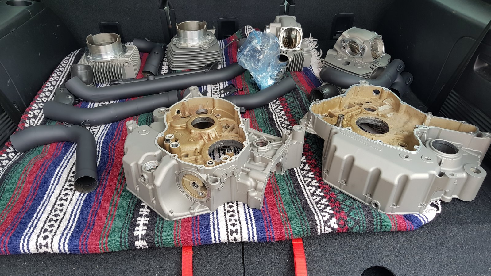

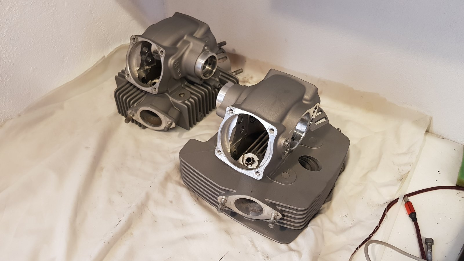

  4. Spoke to him today to let him know the coated stuff will be up this week...crank going off for balancing this week...he'll get my care package also...then it just a case of ordering a full spread of bearings, parts etc etc and then rebuild...
  5. What is the cost of coating heads and barrels?
  6. Well, everything you see in the pic in the boot of my car was 700 quid. i think the exhausts and all the extra stuff would account for about 150 of that (or thereabouts).

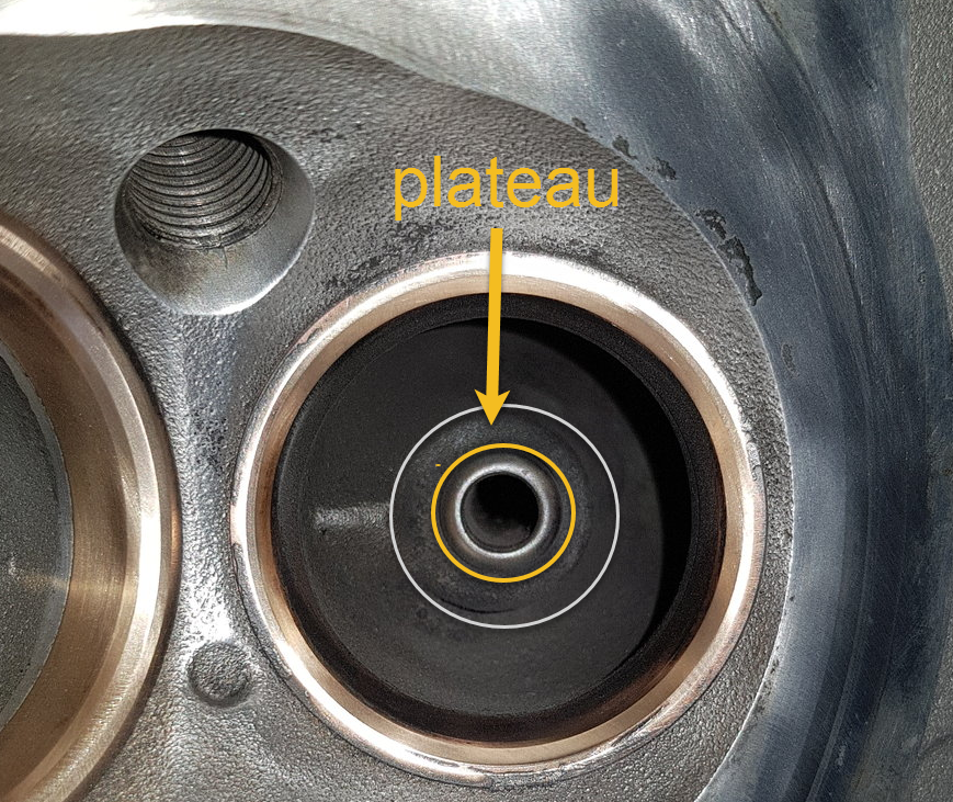

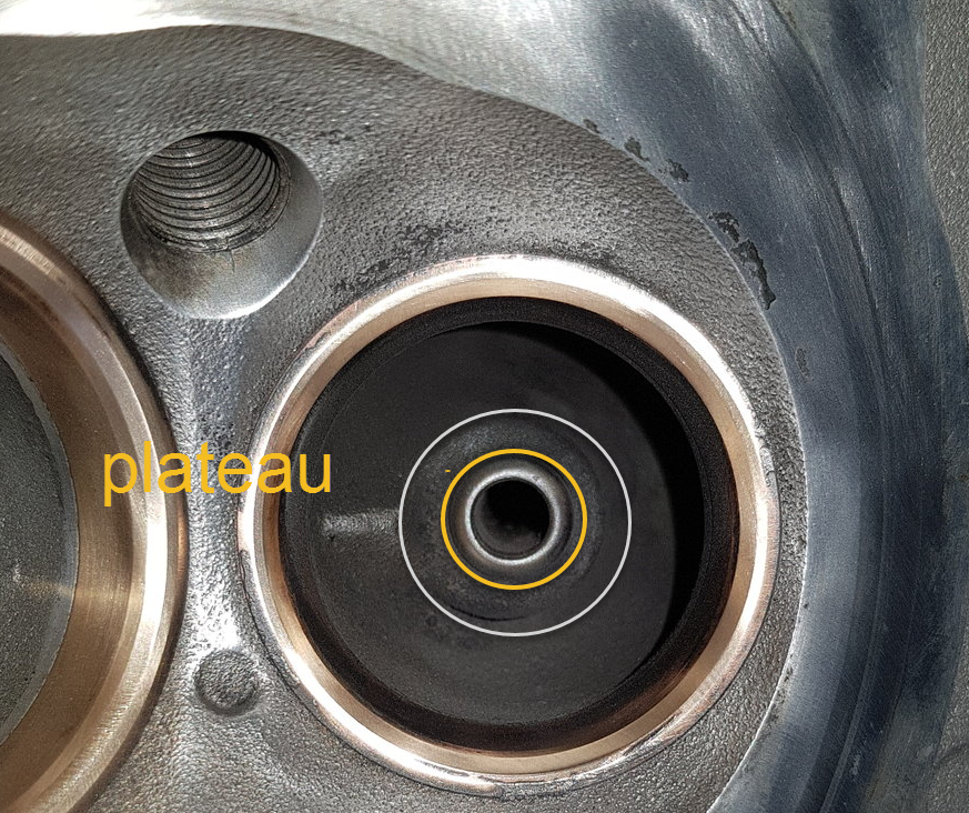

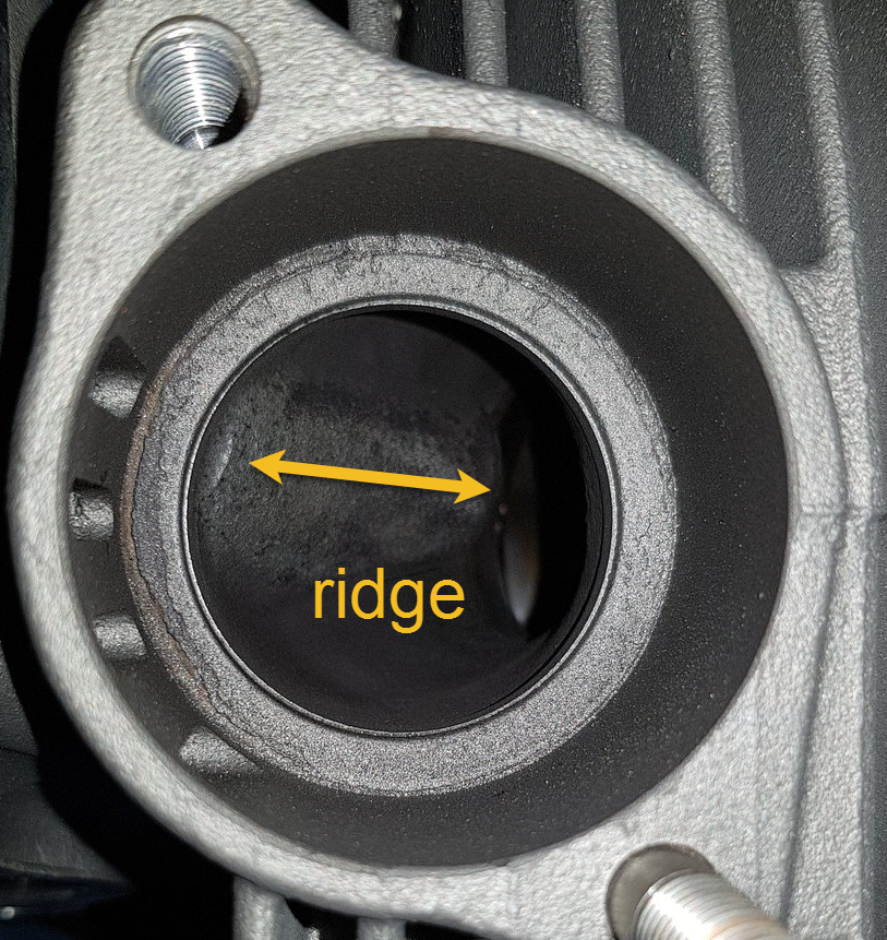

    Using decent carbide burrs about 1hr each, I found the tappered xmas tre profile easiest to control, needs 2 hands on extension, i to guide & the other to stop it climbing around in the port.
    see piccies below.
    Flat plateau around guide, mine looked worse than yours, but still room for improvement, taper this out all around
    Ridge from valve guide boss plateau, reduce this to blend with port diameter & reduced guide plateau

  16. Yep, you got it with the conical bit, use carbide burrs, I used these https://www.ebay.co.uk/itm/10Pcs-6m...407976?hash=item2814c8fc68:g:2ssAAOSwBnVW9lA2
    Dont mirror polish the port, google rough vs smoothe porting...
    If you polish the combustion chamber you will reduce volume & compression slightly, best left alone for a stage 1.
    Performance gains, felt stronger all over but kept on pulling higher up, 8000-9000 whereas it would tail off at 8000, (I'm running std cans on a decat headers no flapper either)
