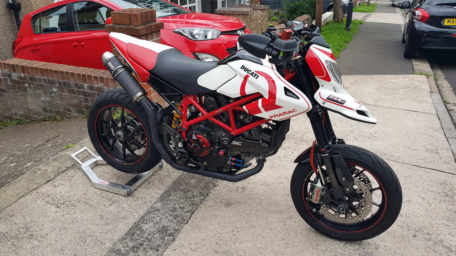

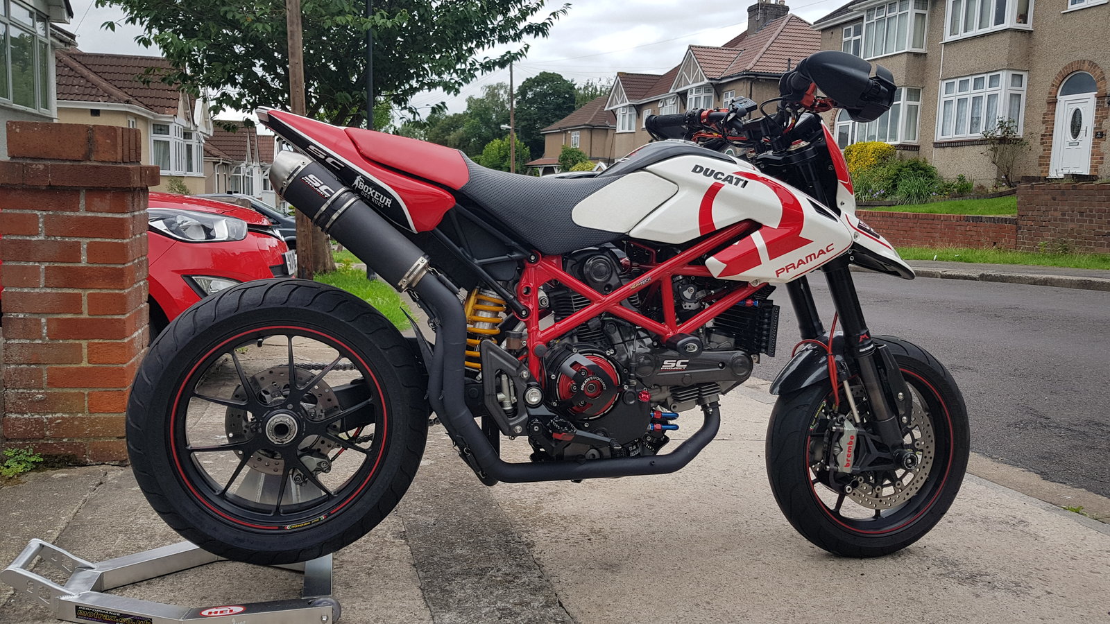

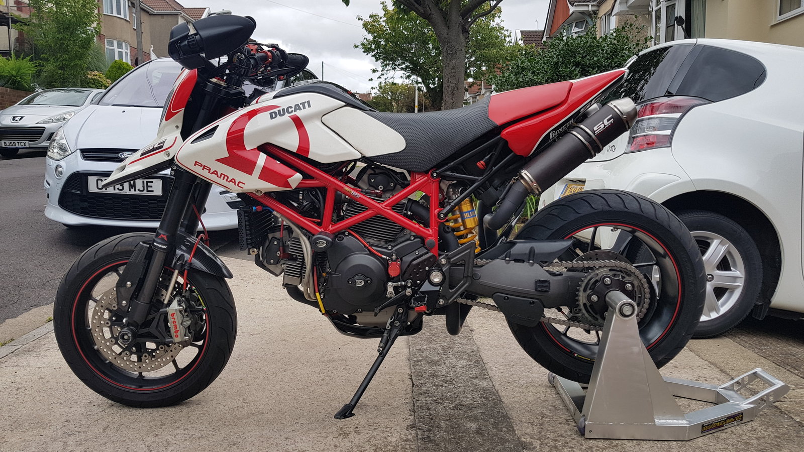

  4. Thanks. Most of it is down to my Cerakoting guy Dave Rowe (im sure he'll be happy of the plug) He runs his own company Tech Coat. Specializes mainly in firearms. He's down my neck of the woods in a small village called Rooksbridge just outside of Bristol. My bike is the first bike he's done as it were. He's a one man band and, to that end makes him very accountable for his work (ie if he gets it wrong he doesnt eat at its most basic i suppose). Plus, i think his lock up is just across from his house which has been invaluable for me, as i can drop off parts at pretty well any time of the day, or the weekend as im not far away. Once the hyper is taxed and mot'd (and i recover from it financially ill be resting up the zed for some coating work to be done) the exhaust being the first off the bat...
    His number is 07900 314833 - cheers Dave, top job.
  5. Ok, bit of a report on my first full day out on it. Started to wind on the throttle a fair bit now....
    1. Definately more shove. Pins you to the back of the seat....mind you ive not given it " full beans " yet as it were...
    2. Smoother to ride...not just the motor but suspension travel...i suspect thats where the rear swing arm was out. All the bushes were degreased, clean and regreased...all the sleeves were too.
    3. This is the most surprising....fuel. I left my house yesterday, full tank brimming. Went down to my mates place in Staverton, Somerset, half of the way i wasnt hanging around. From there, up to Castle Coombe. End of the day, back directly into Bristol, again, really not hanging around. Back to the filling station i filled up at. Prices are quite high at the moment. £8.36. On past journeys, id have expected to burn through half the tank at least....amazing.
  6. That looks phenomenal, what was the damage for the ceramic coating :)
  7. Not ceramic. Cerakote. I had the headers done on my rsv4 a few years back ( ceramic ). They lasted about 2 weeks before they got dirty and then that dirt literally baked itself on...so far ive almost made point of getting the hyper motor dirty....getting it heated up, letting it cool down and then giving it a wipe...comes up clean.
  8. Ah ok, my mistake. I thought it was a ceramic coating.
    Is it a costly process
  9. Thats ok...( they sound the same but are quite different )....for the engine, pipe and a few other bits about 700. Most of the cost is in the masking off and blasting...
