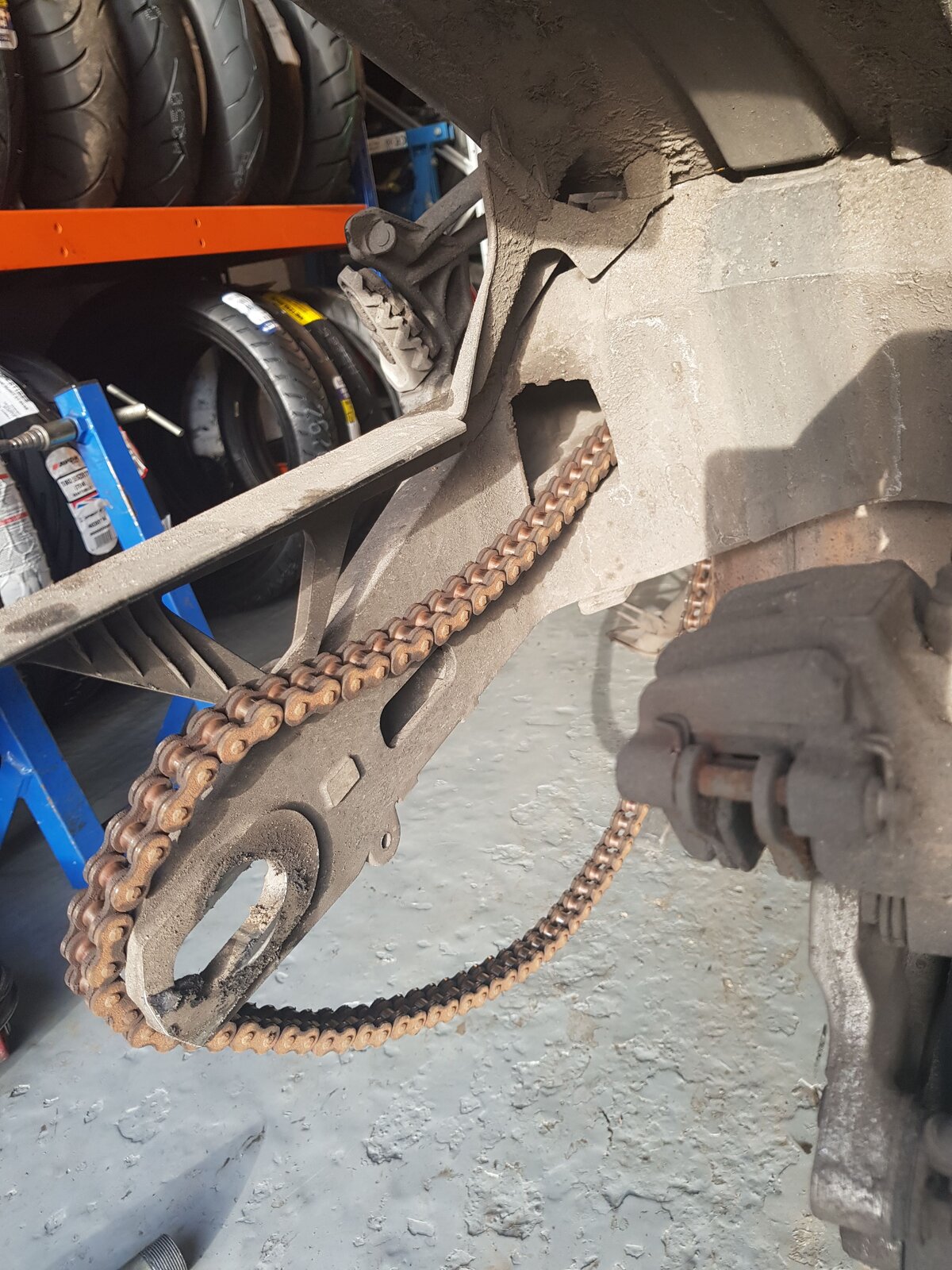

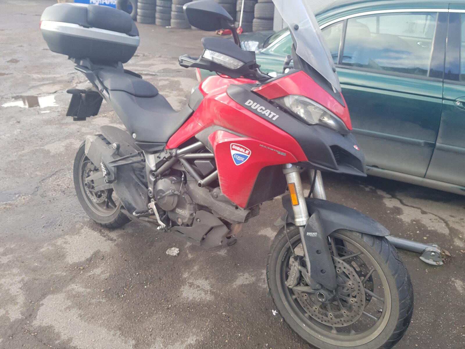

  15. My old Multi when in for a tyre !!! Thats your target .... hope the new owner ain't on here lol !!!
