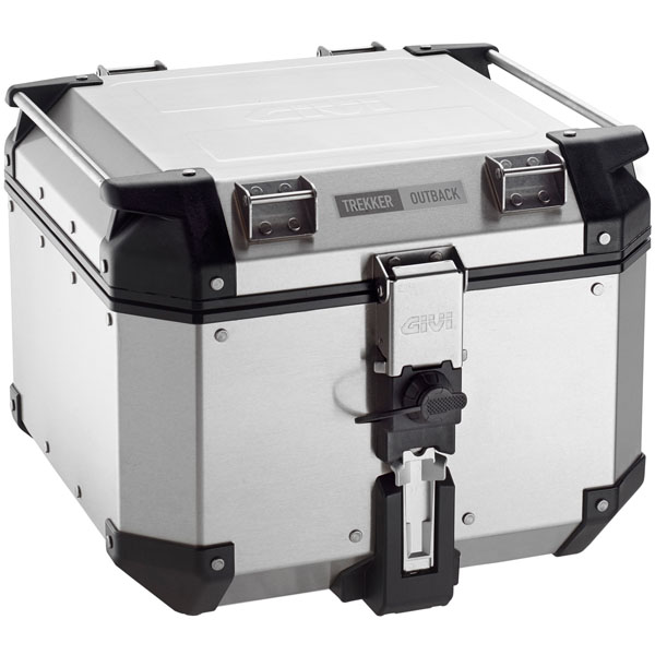

    I will soon be the proud owner of an 821 and I need (more than want) to add a top box. I'm sensitive to the aesthetics and I think that the Givi Trekker Outback will be a sympathetic fit. (Do you agree?)
    It has a Givi monokey fitting but I can't find a rack mounting kit on any websites (including Givi's). Has anyone fitted this and if so how?
    Cheers!
  5. The Hepco and Becker should work with the Givi universal plate. That is what worked for me and then I mounted be Givi box on top.

    OK, so this is what has happened so far...
    I ordered a Givi mounting kit (SRA7403) which was supposed to be suitable for the Hypermotard 821. When it arrived the mounting arms didn't fit the bike (the supplied bolts were way too long) and on further investigation it seems that Givi don't do a mounting kit for the Hypermotard and the kit which I received in intended only for the Hyperstrada. This is all a bit odd, due to the similarities between the bikes, plus some websites state that the SRA7403 is suitable for the Hypermotard 821. Actually, the SRA7403 requires the presence of the grab rail (standard on the H-strada but not on H-motard) which should mean that it should never be sold for the Hypermotard!
    I looked into Hepco and Becker mounting kit but their UK distributor doesn't supply one. I contacted H&B in Germany who told me that they do manufacture one and they sent me details, but it's obviously not yet available through their UK distributor. In any case, the way that it is mounted means that you're not supposed to mount a top box on the plate (too heavy) but should only use a soft bag.
    So I went back to the Givi mounting kit and had another look. As it happens, my Hyper has a grab rail so after a bit of a fiddling around with some nuts and washers I had lying around I have managed to mount it securely to the bike. In summary:
    Hypermotard 821 + GIVI SRA7403 + some random nuts and washers = :upyeah:
    I need to change over some of the washers for a more elegant solution, but once I've done so I'll post some pics.
    Let's just hope it all holds together!!!
