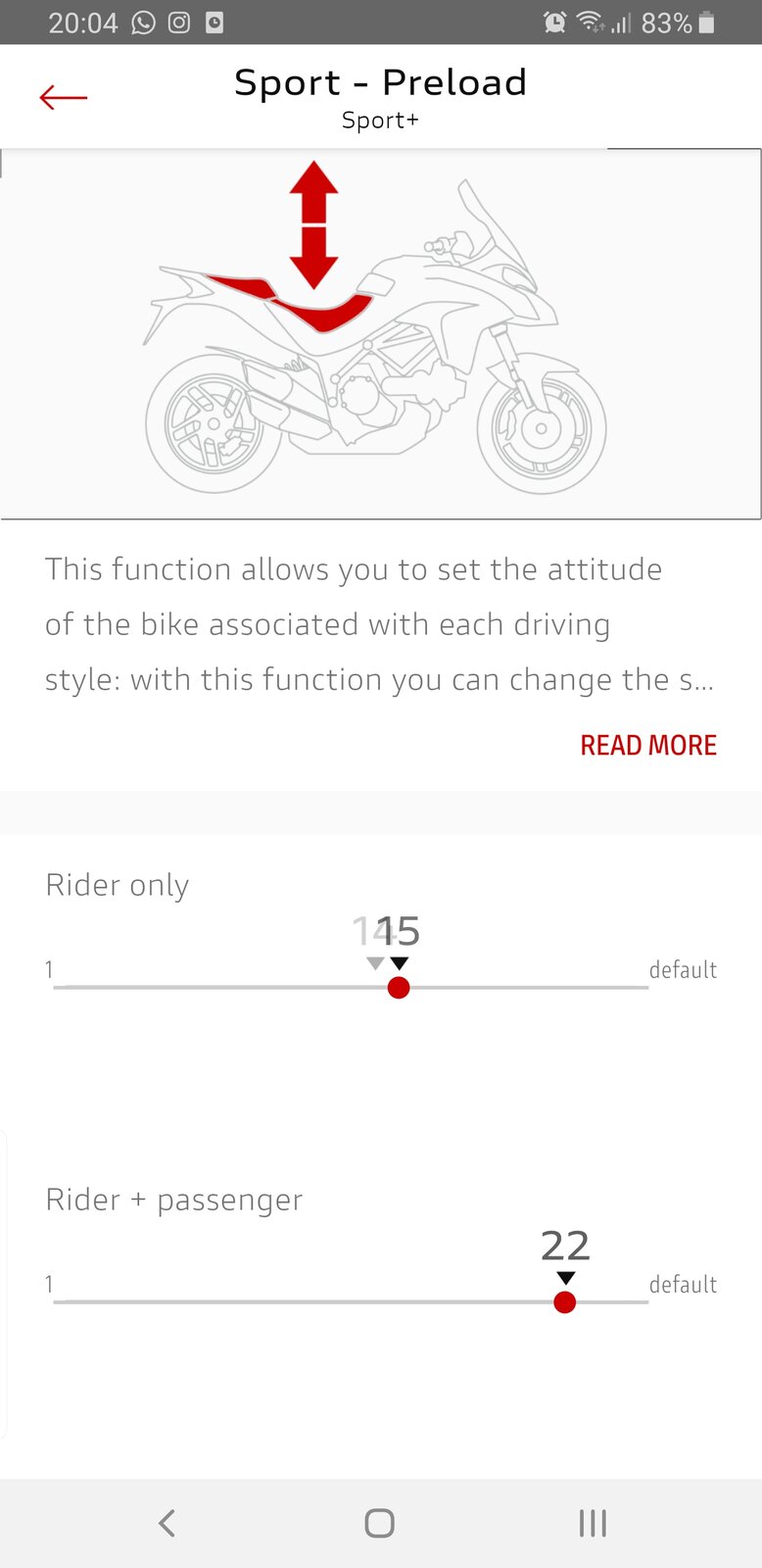

  1. Yes you are right just googled it. It's only cause I only have the 1200s. But I complained about this in 2017 shortly after buying the bike & posted on here about fitting a damper & was called a wuz.
  2. Y
    You can do it via the dash or the app :)
