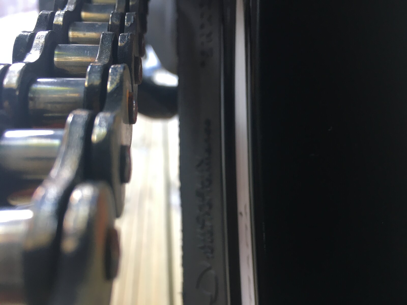

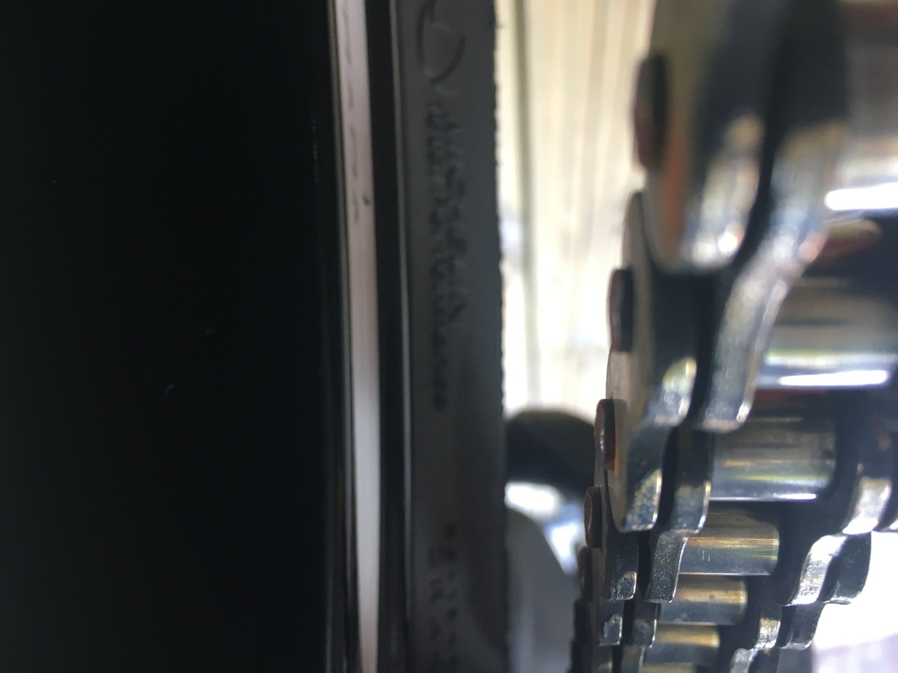

  9. Do you suffer from a bit of 'chain rub' on the very edge of the sidewall?
    Road5s have always done this on my 1260s, nothing drastic, just a light touch of it. Third set waiting to go on, used the same tyre on my MV and the VFR before that.
  10. No chain rub whatsoever.
    Later, I’ll take a pic of chain-tyre gap so you can see what’s what.
  11. Chain to tyre gap pic. This is about 10-8mm
