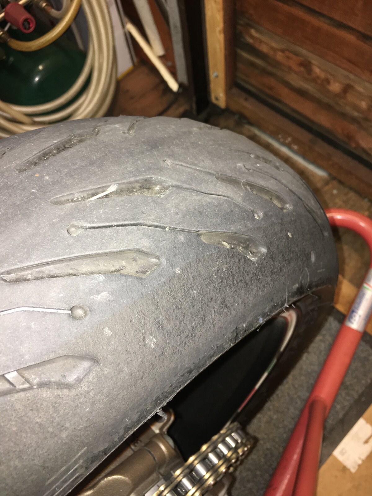

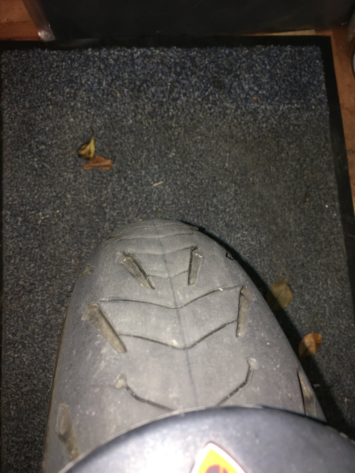

  1. No front tyre cupping? That’s my only complaint about these tyres.
  2. Nothing really. Wear has been very even front and rear. No siding either, if that’s the correct term. I ride the front a fair bit not sure if that helps the wear rate but haven’t had any cupping on any of the previous sets either.
  3. That’s the current pair at 5k miles.
  4. Same I tend to push the front when confidence is up and I found they wore unevenly but yours aren’t showing any signs of that :upyeah:
  5. They could be very sensitive to pressure/set-up/weight etc
  6. @bradders what pressures do you run ?
    I usually run 38/42 and do a lot of 2 up riding. I also push the front and get both shouldering and scalloping.
    I also find the rear wears extensively.
    I'm stunned you guys are getting 5k+ miles, I can't even get 3k miles out of a rear, and if touring in France/Germany where the surface seems to be more agressive I struggle to get much beyond 2k miles.
    I'm wondering if I might get more mileage if I ran lower pressures...
