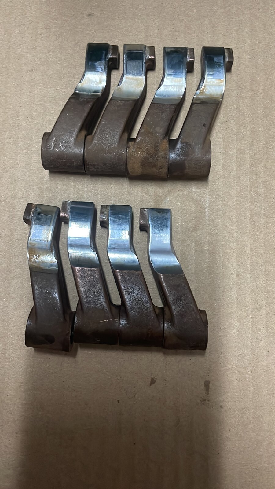

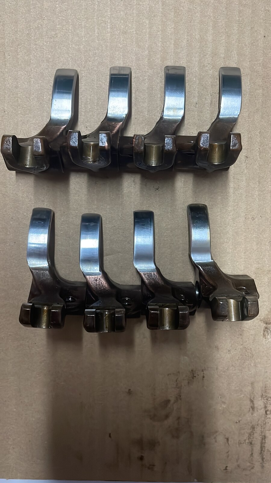

  2. You never know what you will find when you open up the the engine at old bike, I was making valve service at the ST when and found the rocker arms is worn out :scream:, This will definitely not be cheap!
    After a short research I have found two options Kämna in Germany and Newman in UK, I chose have choose Newman because of two reasons, they weld in a new stronger surface at at the rockers and they’re cheaper (45£ unit).
    The German option Kämna have good reputation, but cost near the doble and they just make a new surface treatment at the rockers, I may be wrong, but in my opinion this option looks mechanically less reliable..
    So of they goes today by post to UK.. 85DB52C9-4EFC-4244-A2C6-26BCF99061EE.jpeg 3DB8BC3F-0130-4BF9-9BA7-596E945CAE95.jpeg

  3. Oof, £45 per arm, so 45 x 16 :eek:. Costly.

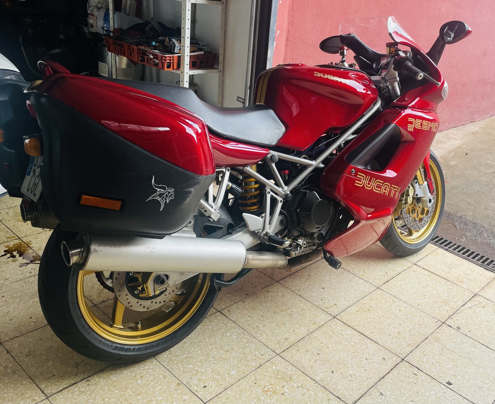

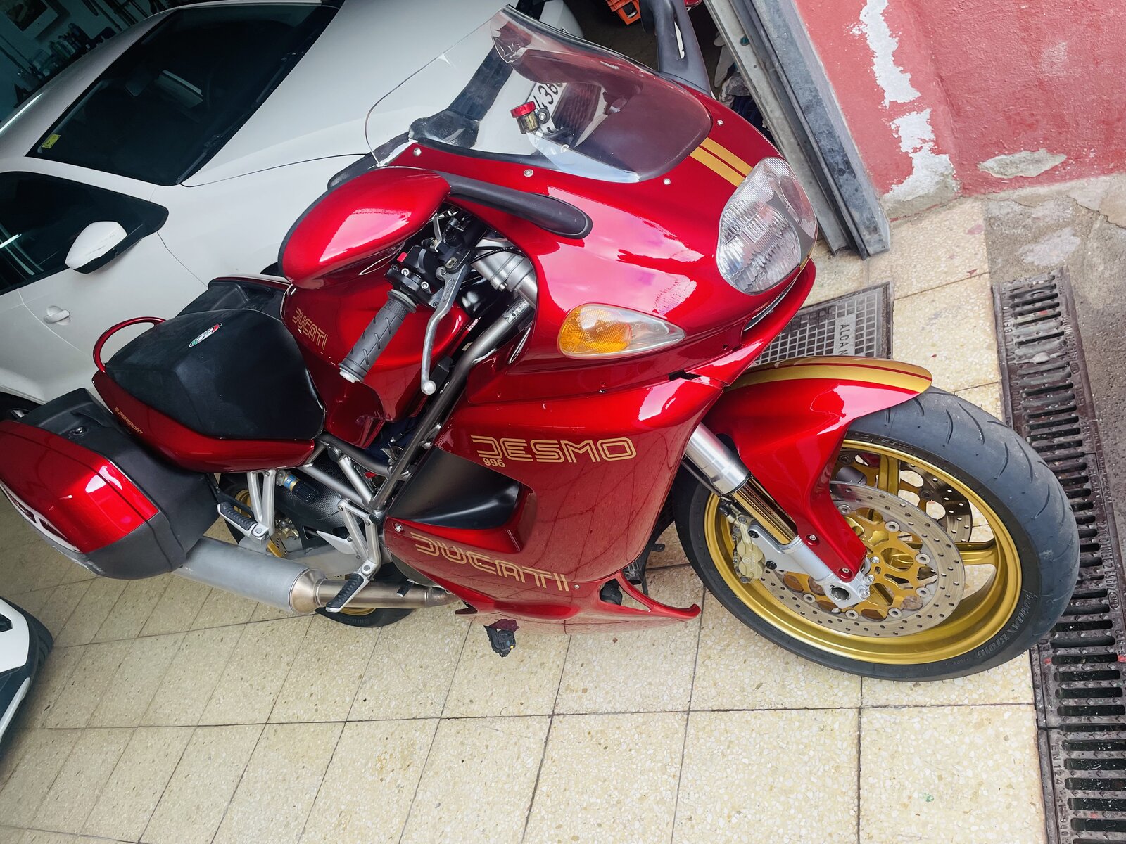

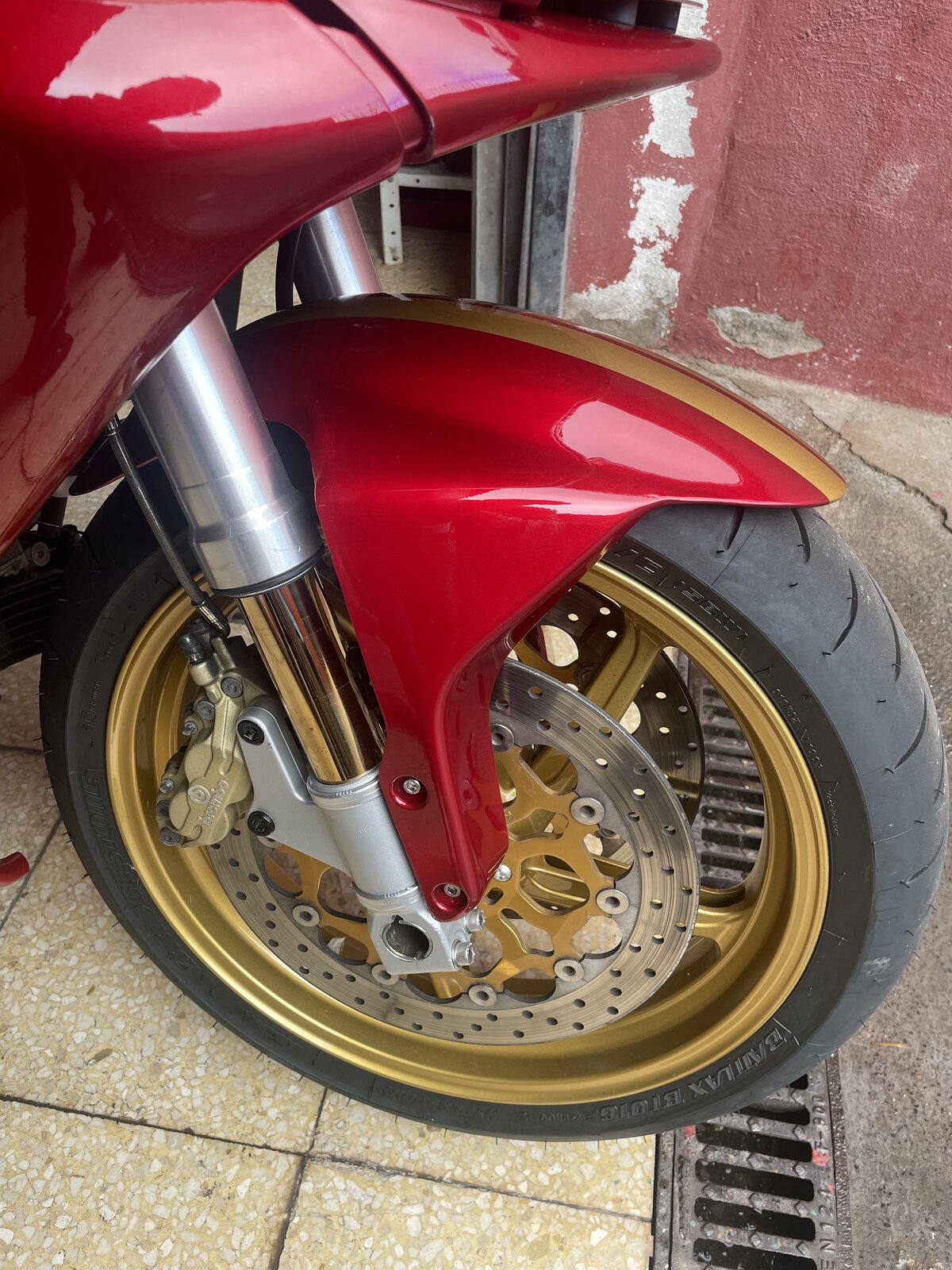

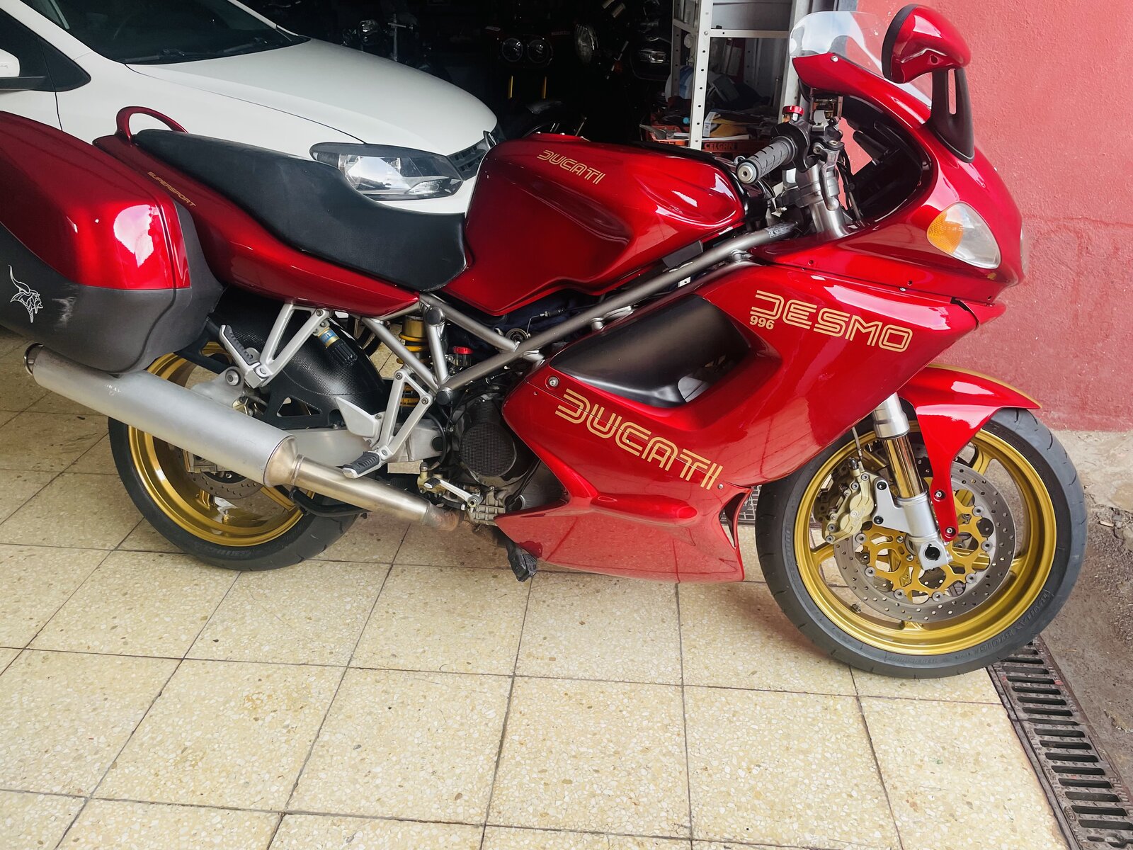

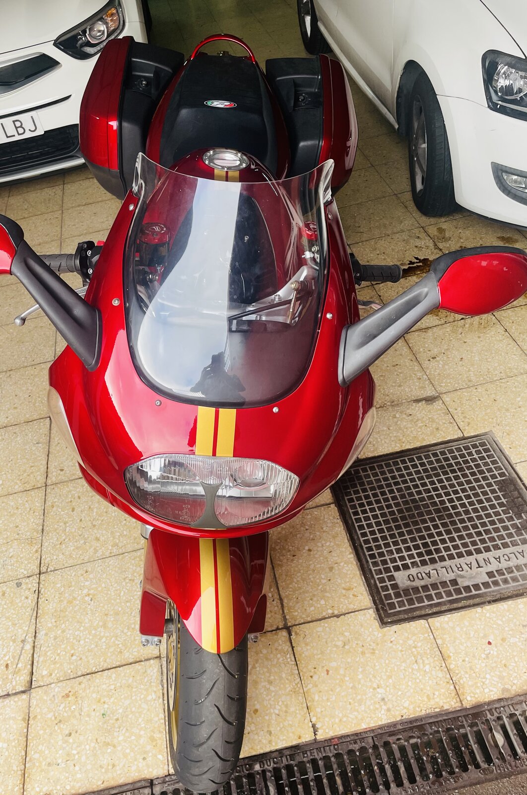

  14. 419DDE6F-CD3F-49DA-A826-0EEE478EEB95.jpeg 436C5587-B6E6-4D76-AD61-7136D828E602.jpeg 7354CB29-B32C-478A-B8C3-E160A43BC12D.jpeg DF2B1753-C1C7-41C4-8B52-AD669E84E709.jpeg 9A7E36E0-B77B-4689-8F27-2C7A4591DCD5.jpeg C1E7F3BC-2BBA-4732-81FE-6C8CE0C3BB76.jpeg Finally i sent the valve rocker to Newman last Wednesday, hopefully I have them back soon, at time I have more or less finished the paint job at the bike by now, just have some minor touch up to do and final fitting once the engine comes together, I opted to paint the straps as The stickers didn’t look good, the bike is now everything less discreet:joy::joy::joy:

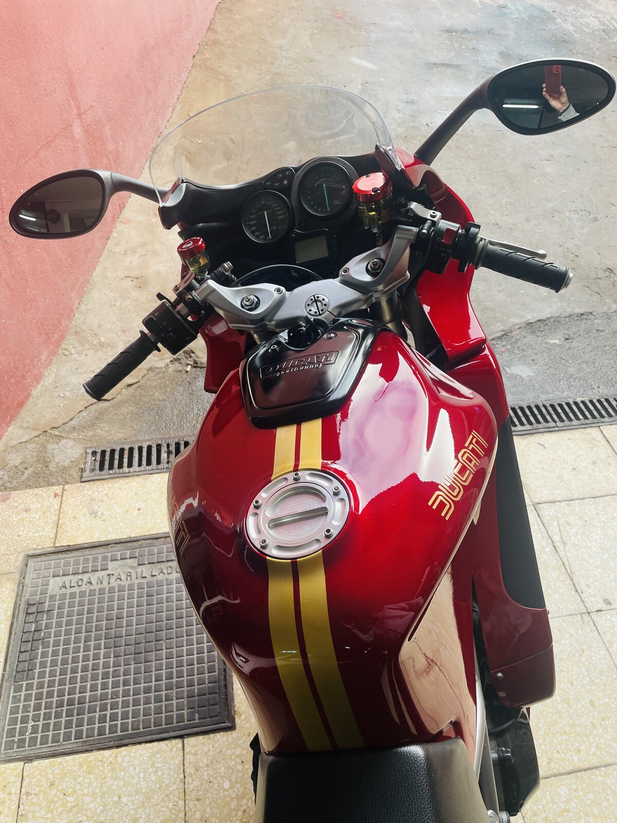

  15. BB728932-E01D-4EAC-8158-8DBBA83B45A8.jpeg I used same golden colour at the wheel at the car and the bike..
  16. Very nice paint work :upyeah:
