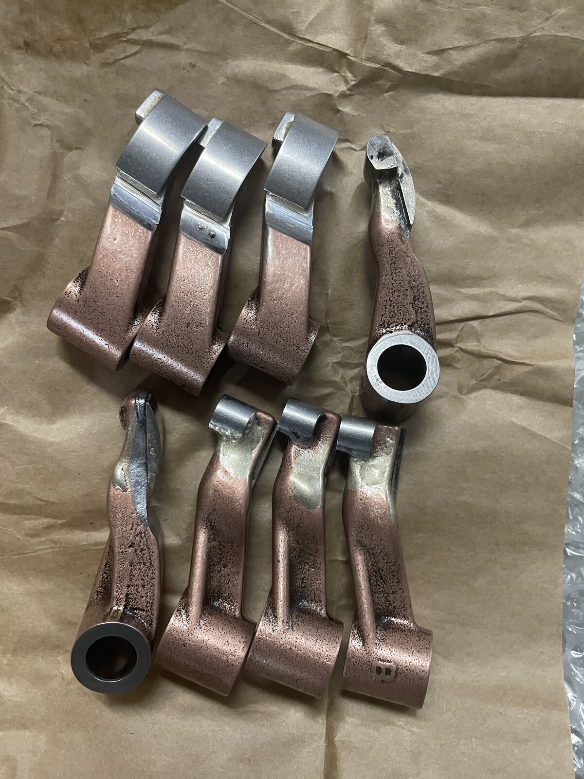

    Regarding rockers I it’s not cheap, but I think the best option was sending them having them rebuilt.
  2. I just had news from Newman this morning telling they received my rockers!

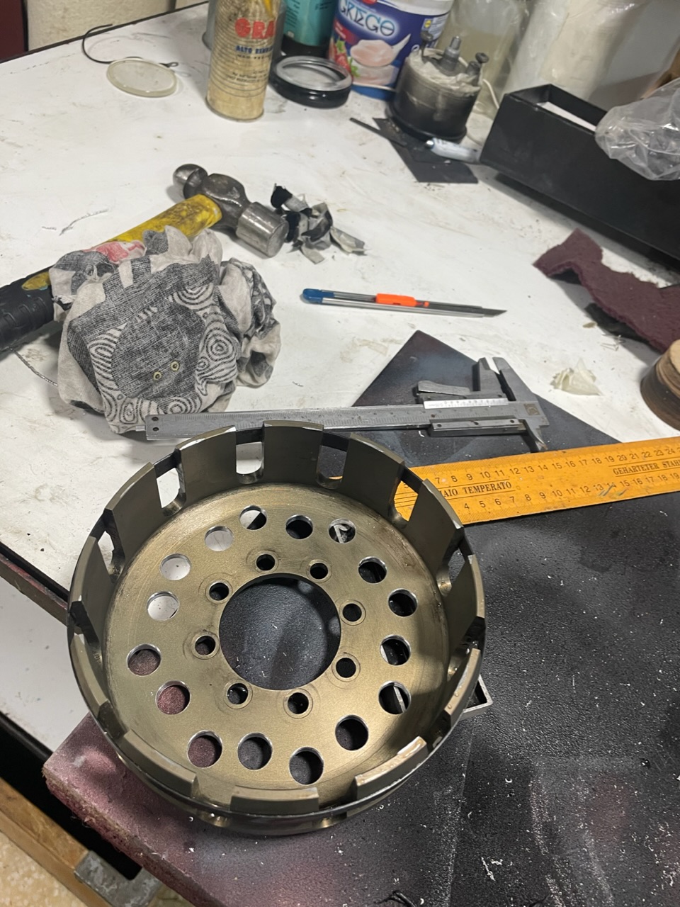

  3. As I have time before the parts get back from UK, I making other chore’s,
    Like lighten parts, painting details, etc.. F4314895-6B4C-4080-B7AD-9795F01AC0F8.jpeg B94B9B28-BA40-4E3F-9EB0-B36687708A27.jpeg

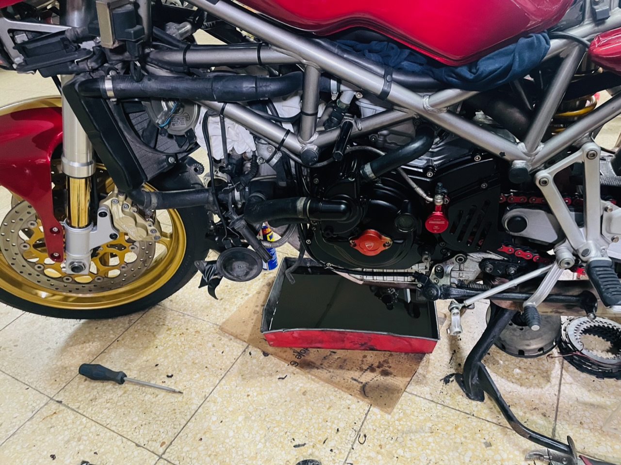

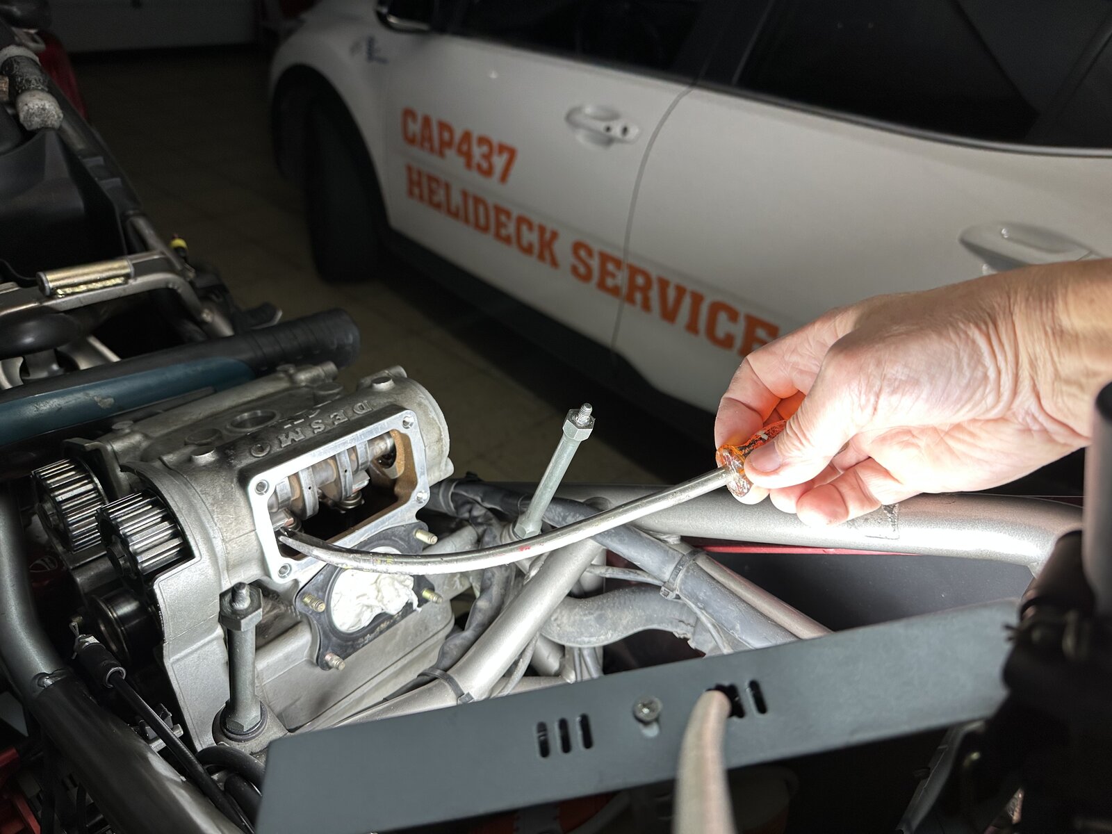

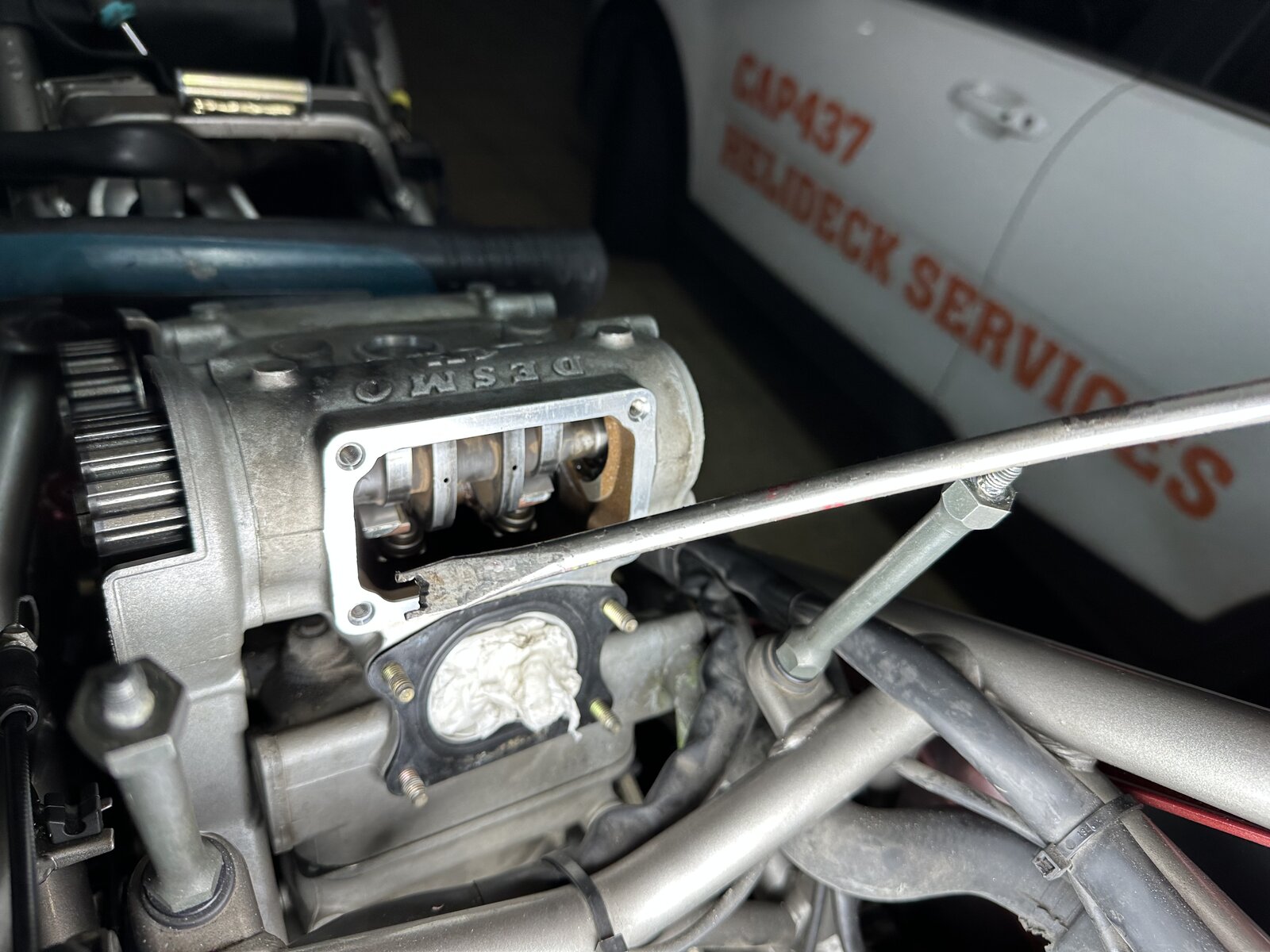

  4. Well rockersarms back from Newman, so time to put them back at the bike, more easy to say than to install….
    I had help from a local friend who have more knowledge the me regarding Ducati 4V heads.
    Install the valve rockers with the engine in the bike has been very tricky, it took us 3h just to find out how to do the first one.
    After a lot of swearing and brain storming I made tool bending and long/big old screwdriver and zaz suddenly the popped in easy.. EA918860-C648-4C9C-A720-8E56DCB3B4AE.jpeg 42656AD6-3700-4BB1-B444-836F8D69317F.jpeg B41A83B9-0BEB-4E34-A5F1-54A7D89B610E.jpeg
