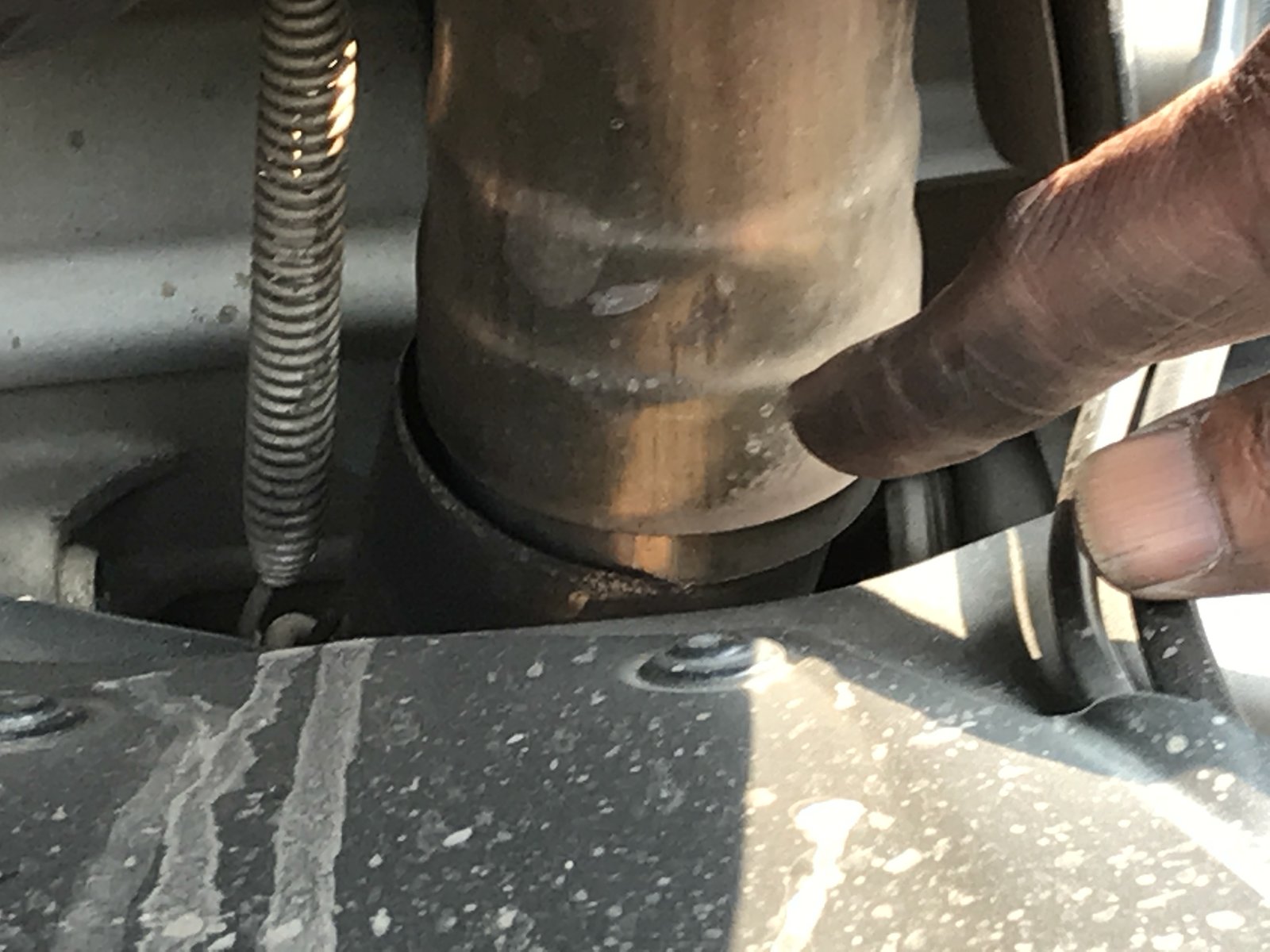

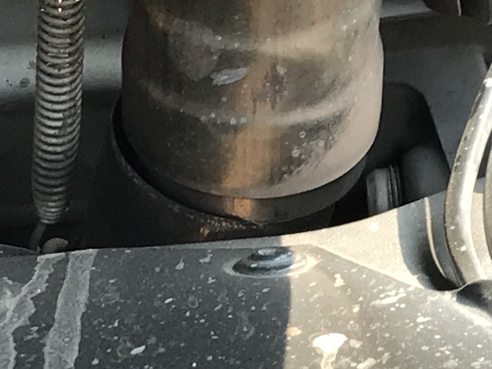

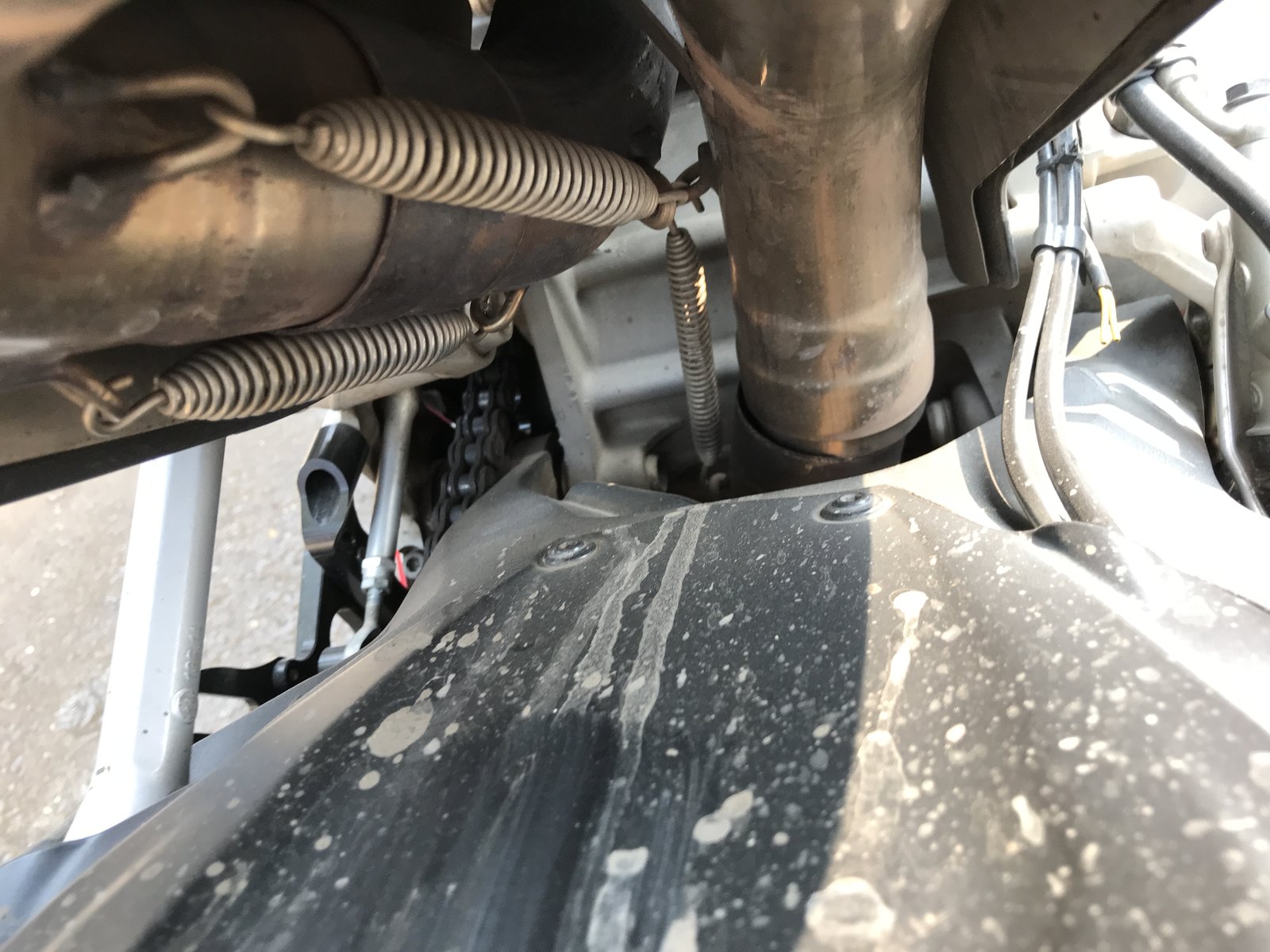

  1. The top (header) pipe looks intact. The bottom (y-connector) bit could possibly have.... I assume it would still be sandwiched in the slot of the header pipe though...
  2. I went with snapped because I couldn’t see how it would have popped out myself.. and I know they’re known for cracking

  4. The quality of images on here is not often good for me but I’m wondering about other peoples at the moment - If you look carefully you can see that the whole upper section has become separated, I’m not talking about the swaged ‘header’ above it.

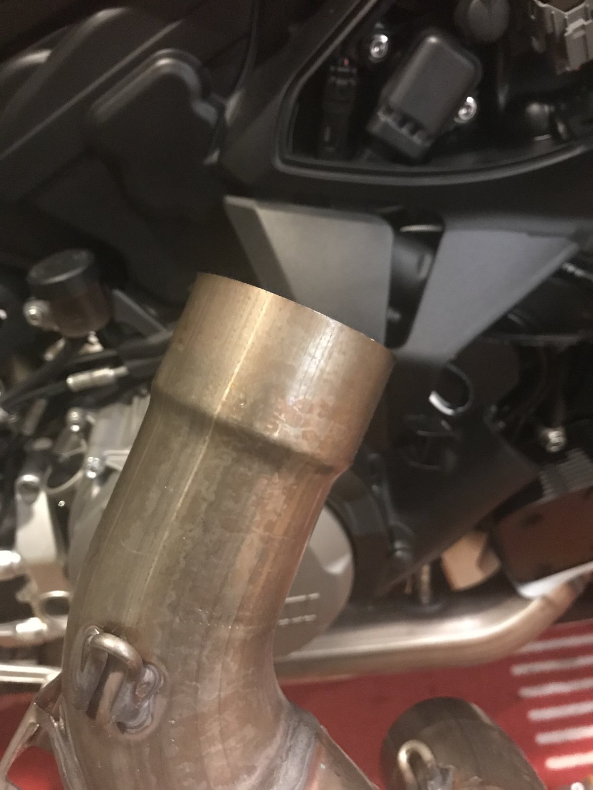

  6. This is my 1299 connector piece, but I imagine very similar. I think what you’re saying @Chris is the bit where mine flares doesn’t seem to be there... like it has sheared at that point. I cannot See a narrowing of the pipe further down. I just would have expected that bit to get stuck in the header pipe ( they would have to pull apart significantly For is to fall out).

  9. i didn't say it was the same mate! - fatigue is fatigue no matter what bike.

  11. Hi guys, the culprit is definitely a lose exhaust. I visited the mech today and the exhaust shield was practically rattling and the exhaust wasn’t firmly mounted. He’s going to give it a thorough inspection today.
