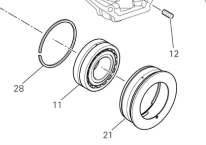

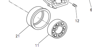

  1. Well, it has gone off to be stripped for investigation. Interestingly enough, I have found they changed main bearing design in later models. Newer models have different bearings with extra retaining clips.
    I'll be down there next week to see the bastard bearings and meet up with the investigator and chat with the workshop.
  2. Hey mate, You say newer models have been changed, Any more info on when??
  3. 2013 models onwards. Basically Twin-Spark onwards. Can't see any reason the Twin-Spark would require different bearing design as the bearing is working with the same shaft. Twin-Spark seems to have the same bottom end apart from this bearing change.
  4. There you go... 2 types of bearing.

  5. So, could this mod be applied to older bikes with the previous bearing or does the case not allow it?

    Next to my Pani I have two KTM's as well. These machines are so well build and reliable..

  11. From the 2010 workshop manual:
    The main bearings are of the angular contact type with offset inner races so that the balls transmit loads from one groove to the other along straight lines at an angle to the axis of the bearing. The angle contact ball bearings are designed for bearing combined loading (radial-axial loads).
    Bearings of this type can bear thrust loads in one direction only. In fact, under the action of a radial load inside the bearing, an axial force is created that must be counterbalanced by an axial force acting in the opposite direction; that is why these bearings are generally fitted back to back in pairs.
    Note
    The main bearings supplied can be bearings with bushing (A) or flanged bearings (B) with the bushing integrated in the external ring of the bearing.

  13. Also, in my industry, I can't think of a bearing that is not held in by a retaining clip yet in the early multis there is nothing but the crank case itself and a flanged end to hold it. Could twist motion not be slowly applied causing the bearings to not run true to each other. This would then be a quick spiral into failure (you would see rotational marks on the outer bearing surface from it not being held tight enough). We have seen this in the past on machines that use bushings rather than bearings, you end up with a bearing with an elliptical hole being worn and a terrible racket.

  15. @JH1986 If your first blow up was a snapped cam it probably just had a "top end" rebuild and they quite likely didn't dismantle the crankcases to save a few bob. You are right it would have been good practice to have done it though.
    The crankcase and crankshaft are more than adequate to hold the main bearings in place without circlips or retaining rings. In fact they wouldn't do much because shims have to be fitted to achieve 0.3mm pre-load on the bearings.
    In your industy (photocopiers I believe) bearings are often fitted into plastic mouldings or light aluminium die-castings and use plain shafts that require clips for axial location, so not nearly the same application.
    We can analyse and speculate about the basic design all we want but I don't doubt Ducati's ability to design major engine components such as these, they use tried and tested methods that have been in use probably since the 30's. As Bradders says there will always be small incremental changes.
    In my view the basic design is not fundamentally flawed and you are an unfortunate victim of bad luck and circumstance most likely as a result of contamination from the first blow up.
    Having said all that let's hope the right thing is done by you and it gets sorted.
