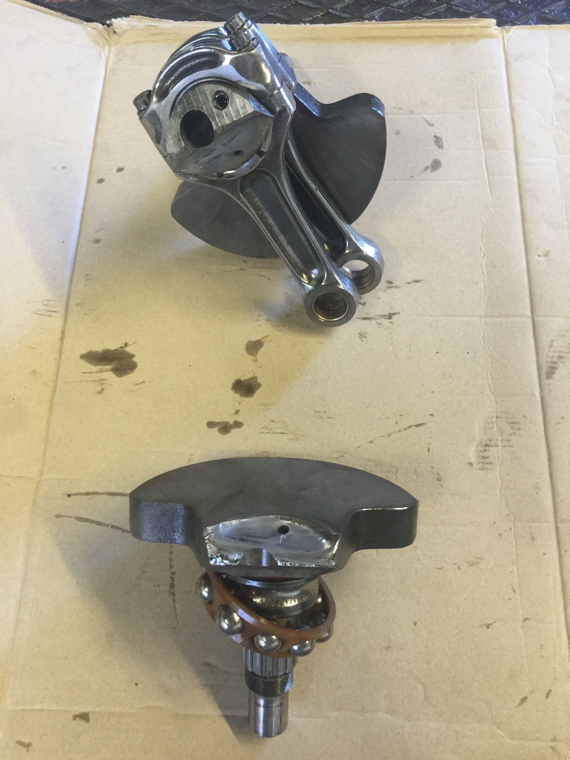

  4. So, anyway... It's a long list of parts gone. The crank snapped in two in the middle.
    The pistons are scored along with plenty of other bits. Probably cost what the bike is worth to fix. I'm feeling quite positive that the guy will claim manufacturing fault (although he couldn't explicitly tell me).
    I think they'll cancel the agreement and call it quits.

  5. Wow. I have never seen a crank just snap like that! I can't think of anything else that would cause it except a casting/machining fault in the manufacture of the crank.
  6. Basically what the guy said. He did say you could have had some play in the bearings causing it stress but he said that even that would have to be quite extreme and I'd have stopped riding as it would have been shaking so much
  7. The bearings in the photo are shot...
    Look at all the brinelling (indentations) on the race
    Could be they got so worn that there was un due side loading put on the crank
    But as soon as loose bits of metal start flying around - who knows what went first.
  8. I mentioned that but, like you say, he couldn't tell which went first but basically said even with knackered bearings the crank should not snap.
  9. Bl&*dy heck me neither!
    Only ones I have seen snap were on old Brit stuff that could break where the crank-pin joined the web if the fillet radius was too small and created a stress raiser.
    I agree with the assessor, couldn't tell if the crank failed and took out the bearing or vice - versa.
  10. Actually, looking at the picture of the part with the rods still attached again the break starts exactly where I just mentioned, at the fillet radius between the crank-pin and web.
    My money is on incorrect blend radius.
    Oh and I'm surprised it ran at all let alone ran noisily!
  11. Got to very carefully point out that the assessor gave away nothing definitive. BlackHorse are the customer and his report goes to them. Don't want to fall foul should the wrong people read this. The Ducati engine specialist who stripped it gave his opinions and the assessor neither agreed nor disagreed but nodded his head with what was being said. He did say he had never seen a crank snap like this, especially not at 21k miles.

  16. Depends which way around it happened. If the bearings did go and cause this, the bearings are a known issue based on the amount of people that have had failures. The engine guy said as much and said the early ones had the bearing issues. If the crank went and the odd motion caused the bearing to fail then yes, you are right it is a one off.
