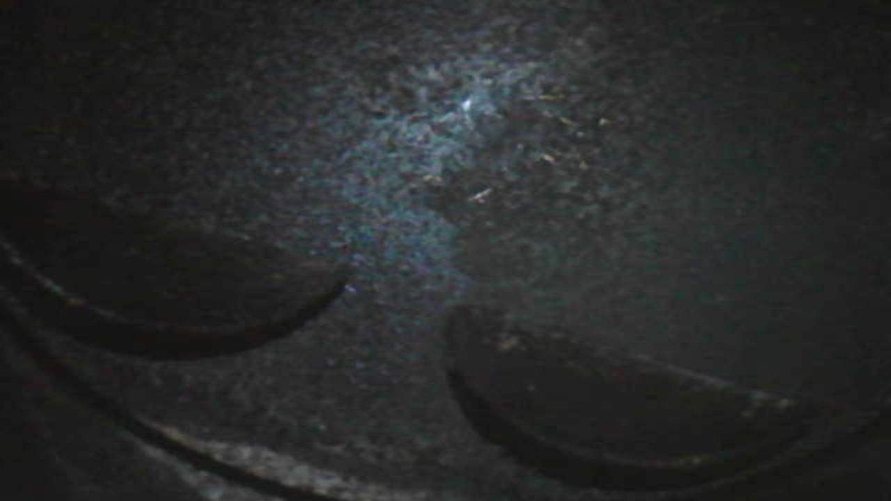

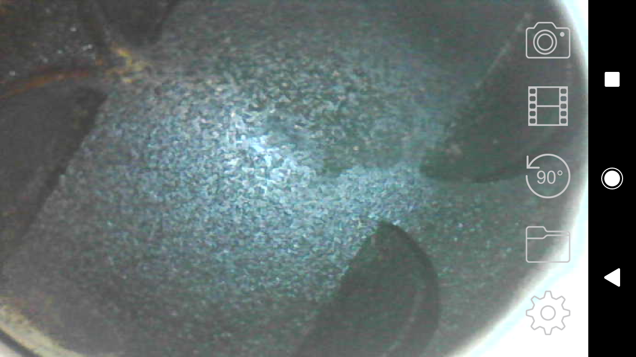

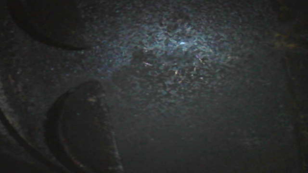

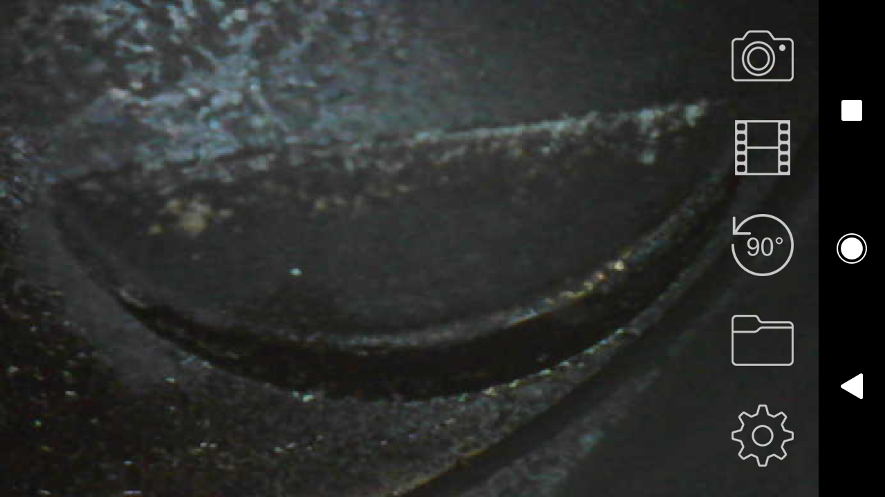

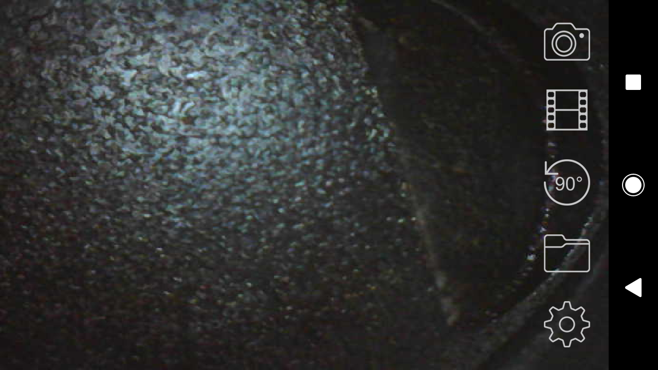

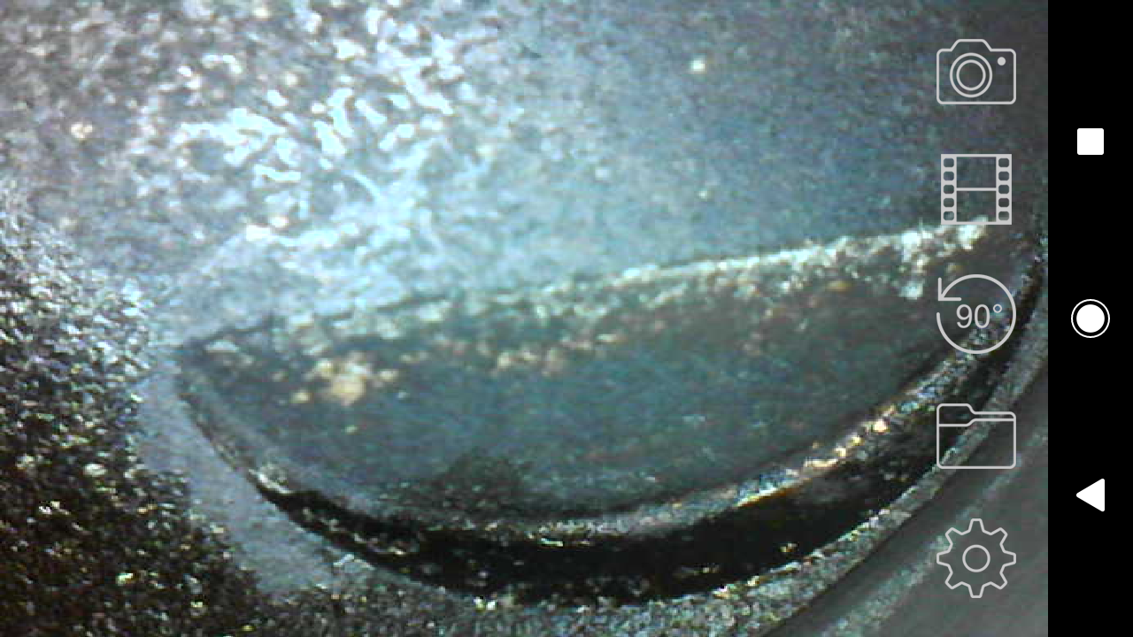

    Well I've had a better look and found the cam bearings belt side are binding. Both inlet and exhaust with the inlet faring worse. Both feel pretty much ok when rocking back and forth lifting the valves, but feel awfull for the rest of the revolution with no load on them. Take the cams out and turn the carrier however and I can't feel any side play just rolling so very slightly rough. It looks to me like the bearings have failed and or the cams bent perhaps?
    On the pluss side Newman rocker faces are in great order, I just hope none prove to be bent. All valves open smoothly and appear to close, I'll keep my fingers crossed on that one. All pulleys, idlers and tensioners feel good with no sharp areas. I took a deep breath and popped the endoscope in the plug hole, not the best quality pics but it did show I may have a fighting chance. Screenshot_20200523-122127.png Screenshot_20200523-122508.png 20200523123507.jpg 20200523123515.jpg Screenshot_20200523-122653.png Right then, Beer o'clock I reckon.:)

  16. If the cams are stiff to turn when on the base circle I reckon you have bent valves.
    The closing rockers are trying to pull the valves further against the seat when part of the valve is already touching
  17. Thank you for that and it explains what I feel perfectly. It's also much more likely why both cams would be affected. Hopefully I'll get to look later.
  18. For the valve seat to be bent it must have come into contact with the piston and whilst it’s difficult to tell conclusively from the endoscope photos it doesn’t look like there was any contact (which is a good thing). For a definitive answer the head will have to be removed so the valves & piston head can be inspected.
