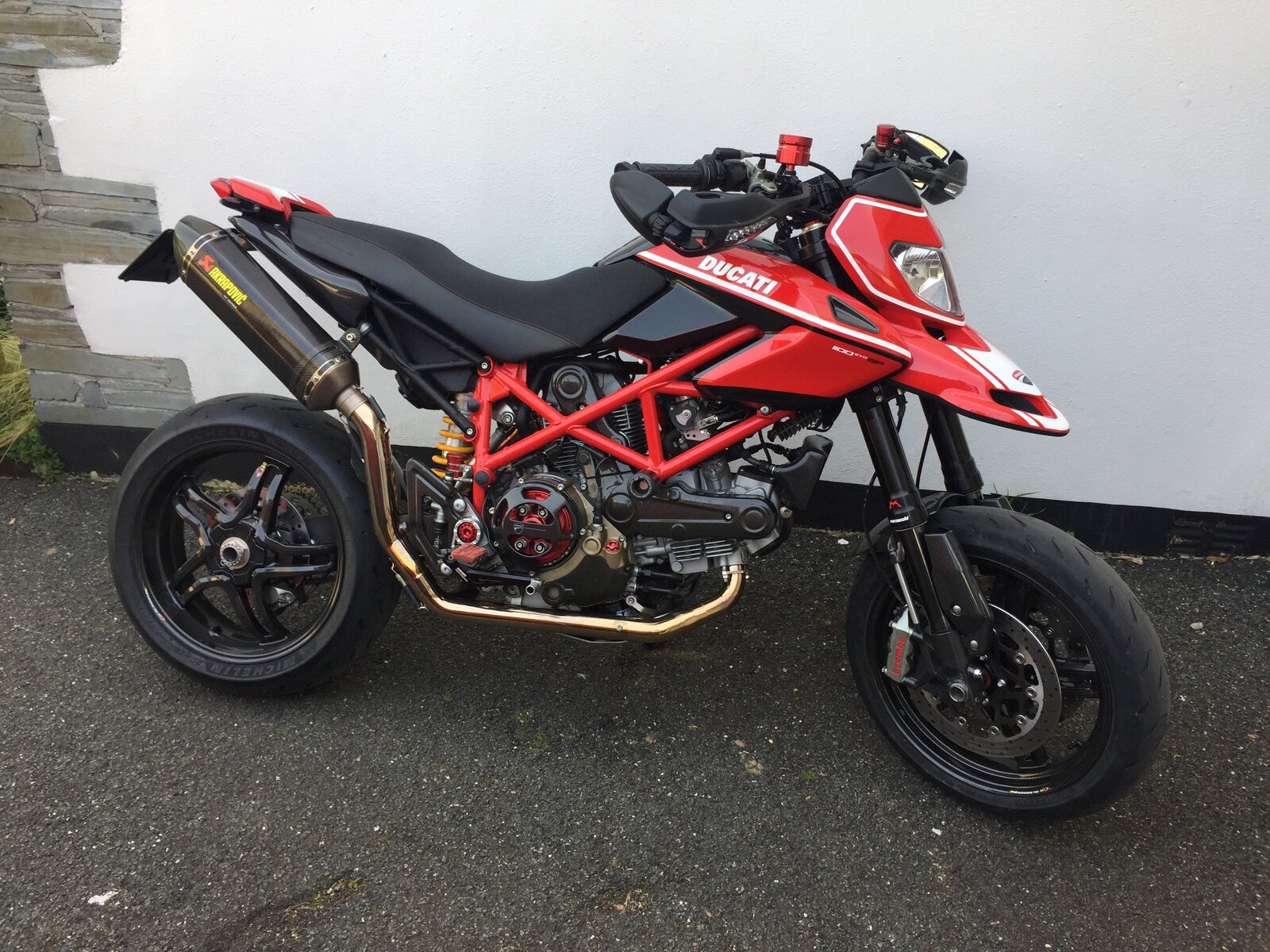

  14. IMG_0047.JPG I've now fitted the lithium battery and the BST wheels. The full tank, wet weight has dropped to just under 167 kg. Getting nimbler by the day ;)
    Edit: also fitted the titanium front axle and the titanium rear axle nuts, too :)

  15. Good effort. Bet she feels nimble!
  16. Indeed. Especially on the new Michelin Power RS's. Super nice tyre and very confidence inspiring.
  17. Hand guards must be another kilo. Off the top too.
  18. Envious of the carbon wheels, hoonage!
  19. I’m jealous! How noticeable is the impact on handling on the hyper Turbo?
  20. Quite a noticeable difference, although the SP wheels are very light in themselves. I'm not sure of the weight of Super Corsa SP's versus Michelin Power RS's, but the wheel and tyre combo only saved a kilo per wheel. I was kinda expecting a bigger difference, but then it could be in the tyre, also. Maybe someone can chime in on tyre weights? (I did trawl in internet in the hope of finding a light tyre, but no luck).
    However, the bike is so flickable now. It just loves corners and the feel from the tyres is anazing. My confidence in leaning through corners has increased, braking is even better and my fave - wheelies are so ridiculously easy now, so it's a winner.
    I've got an aluminium subframe coming from the States soon (don't get me started on the Italians...), which will shed another 3-4 kg's of high up weight.
