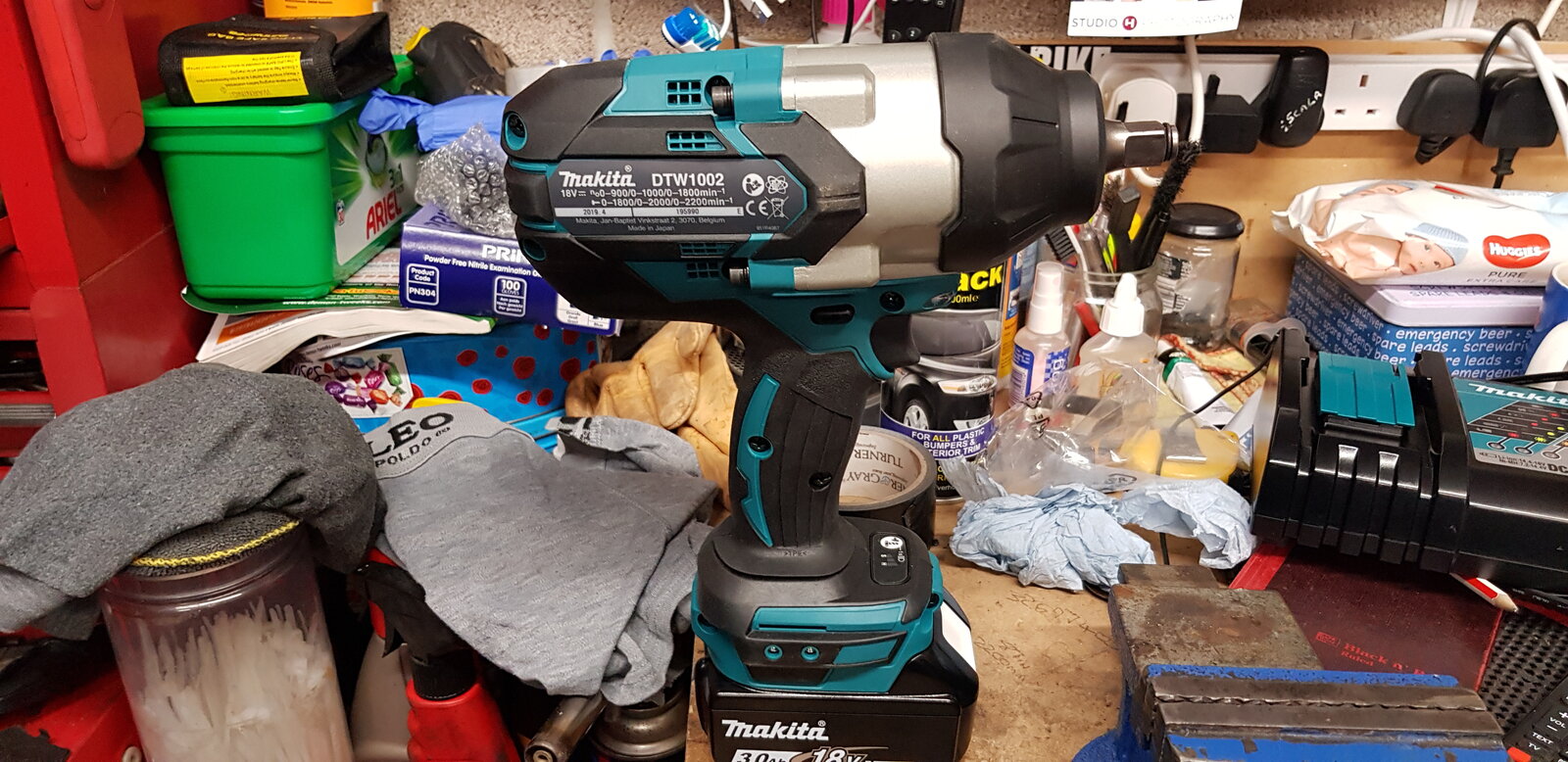

  2. Bought this bad boy after too many beers but no regrets as it's spun off every thing so far

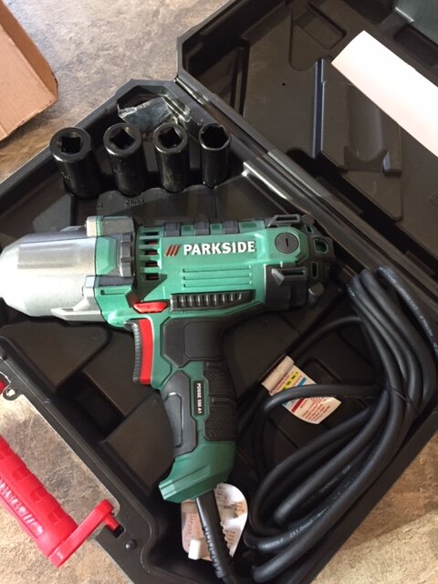

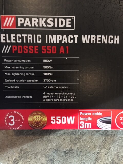

  8. Got this from Lidl last weekend :)
    £40
  9. Can it undo a rear wheel nut?
  10. The Moss one can, easy peasey. :D
  11. Its 550w compared to the other impacts of 1000w, but don't use these tools for work, but think it will do.
  12. If the specification is correct then yes. The tool is 500 Nm, typically a multi Strada rear wheel nut is around 230 Nm.
