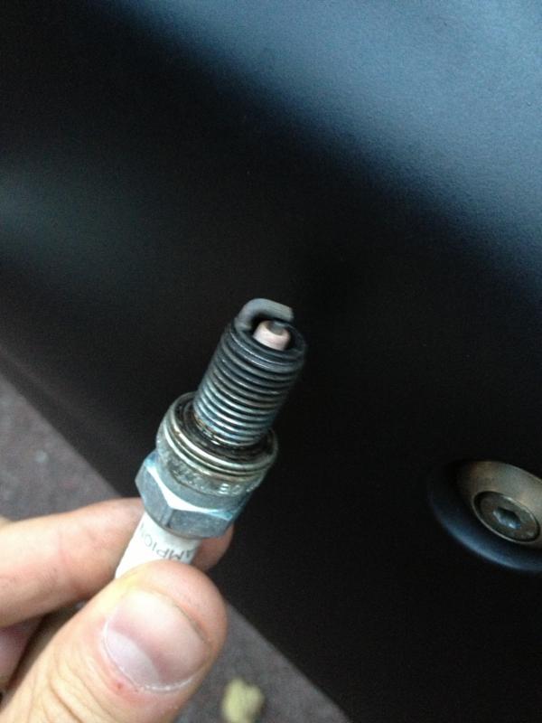

    Anyways I did the run without the rubber trumpets, it was a 3 hour ride about 120 miles, let the bike cool down for a few hours, the heat level was only about 1/4 way up, so quite normal. I'm attaching a picture of what the spark plug looked like, I'm assuming this means the mixture is too weak, too much air? I'm really enjoying how the bike sounds with no trumpets and my friends are noticing it too while riding, but I don't wanna 'hurt' the bike in any way.
    I'ma put the trumpets back, unless you guys think this is fine for what the spark plug looks like.
    (don't know if the picture is very clear, the plug was completely dry, the part surrounding the little middle bit was light orange, but as it was dry I assumed it was too dry)
    Also I have only checked one of the spark plugs (assuming there are 2 as there are 2 cylinders?) as only one was readily accessible without taking the fairings off.

  4. Looks slightly lean ok. A well ridden R6 would leave your well ridden Ducati for dead in all situations I'm afraid to say.

  7. I think that plug shows a bit too weak....

    Your plugs need to look roughly the same....they need to look a bit rust colour on that central porcelain insulator.....I think your plugs are fairly new or they are indicating the mixture has got a bit too weak......by taking those trumpets out you have significantly increased the amount of air entering.....you only have to do simple maths to see by how much.

    And if I were you I would chuck those Champion plugs and fit NGK.....I have four new Champions here and the spark they produce is nowhere near a big a spark as four year old NGK ones.

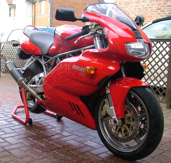

  12. His wheels are the early SSIE type (and Monster).....three spoke with a slightly raised rib along the sides of the spoke...and the spoke widens at opposite ends to the carb SS wheels.

  18. Hope this shows the wheels and swingarm for you
  19. Ps this was a 2003 bike

    btw that is a really nice looking bike!
