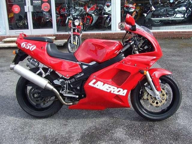

  2. Still, even though I had problems I did get hooked on laverda and sold the 650 to buy one if these ( not my actual bike)

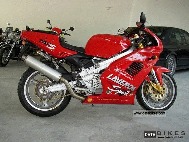

  3. Then bought this one [​IMG]

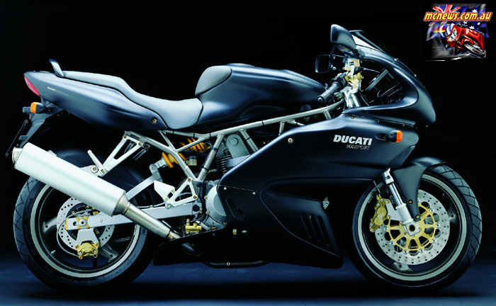

  11. Here's the spec for the Ducati Supersport 900S from Ducati's website. Unfortunately there's no picture but it should look like this;
