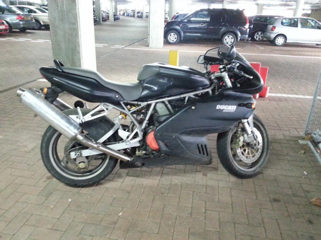

  7. Hi all. Nice to come back here and see what changes have happened since when I got the bike. I have since
    Opened up the airbox abd put a new k&n air filter
    New k&n oil filter and oil change
    Remus straight through perfurated exhausts
    Power commander usb 3
    I now just need to custom map the pc.
    The pipes look good but are longer than originals as the link pipes are longer. But I can feel the bike "feeling" a lot better without that backpressure and it sounds amazing.
    Let me know what you think.
    Sorry about how dirty it is.. weather is bad and hard to keep it clean as I commute with it daily.

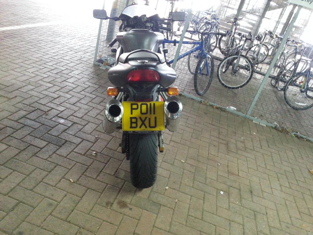

  8. Back. I think I might have to turn the link pipe on the left exhaust as I think its slightly lower than the right.

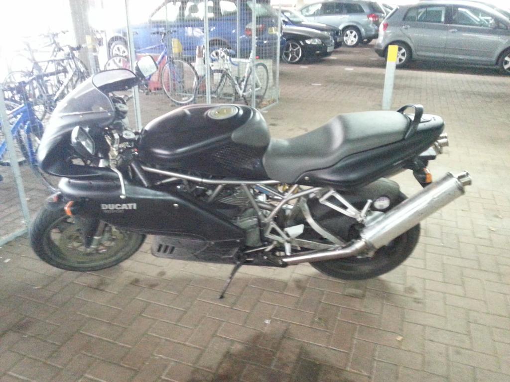

  9. Other side.
    Now I just have to replace the brake pads. Custom map the pc. And I want to open up the clutch with just a leg protector.
    Comments? Suggestions?
  10. You could of course shorten the cans fairly easily..........
    .........but if you like leaving the ends in garage when you are five miles down the road, don't bother......:wink:
    AL
  11. Thanks Al
    I thought of that, but I dont mind how they look :) I can keep the garage warm with the exhaust so when I get home ill be nice and warm haha...
    To shorten them I would been to shorten the link pipes, I have no equipment for this :S and no cash to buy new link pipes. Quite happy these fit actually haha. I paid £100 for both pipes and links theyre remus, not bad?
  12. Leave the link pipes alone........Look inside the outlet end cap with a torch.....if you can see a perforated pipe coming straight into the cap, you should be able drill out the rivets of outlet end cap, pull the cap out, cut down the can with a hacksaw (if you can cut straight, but mark it with tape first.....apart from gving you a line to cut to, it saves the good part of the can from a slipping hacksaw) then cut an equal appropriate amount off the perforated pipe, put the end caps back in, drill and re-rivet.
    You may have to trim off a bit of packing before you put the caps back on, but personally I would just stuff it in further......the more dense the packing, the louder the exhaust note.
    AL
  13. I picked up a set of remus / ducati performance £140 and they fitted straight on and look almost standard
    your bike should be quiet with exhaust outlets 2 time zones behind you though
