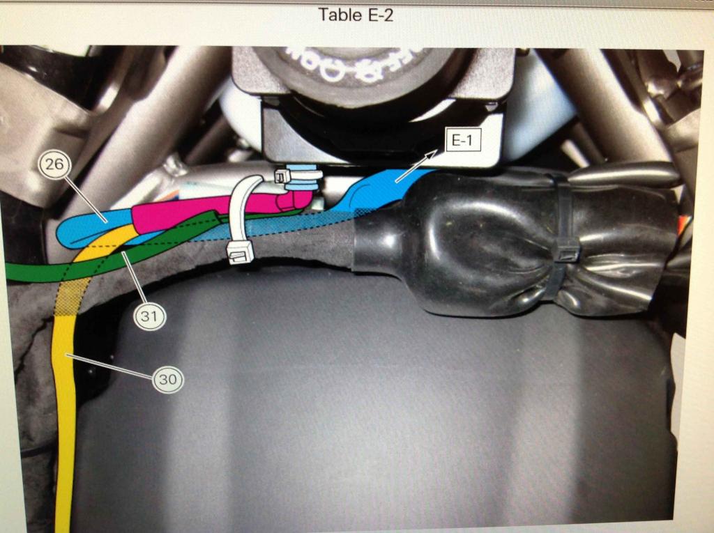

  13. Hi can anyone tell me where to plug the ducati heated grips into is it under the tank I can't see it very well in the service book or any pics

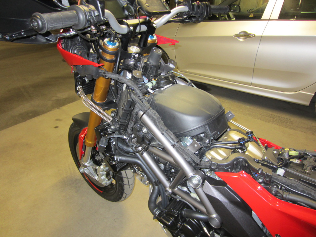

  14. I didn't do my own, but most people are saying you have to remove the tank, a few are saying you can do it without removing the tank. You definitely have to go to the dealer to enable them, unfortunately. Go to Motorcycle Info Pages - Home Andy probably has pics there.
  15. You have to remove the tank. On the previous side, you can just see them on my picture there of my bike without the tank on. The connectors are inside the big rubber sleeve you see just under/behind the steeringlock:smile: The connectors have a little white label on them that says " heat grips" or similar.
  16. Andreas, does the ecu need to be reprogrammed to say they are fitted as we seem to have a difference in opinions from members on here and it seems dealers too.
    £190 seems an acceptable price to me and I have now found the cash so have asked the dealer to fit them, may have left it too late now though :(
    #37 Ape2Duc, Dec 22, 2012
  17. Hi is this where they plug into?anyone know for definite.
  18. Yes, the heated grip circuit in the dashboard ECU need to be activated. The only way to do this is with the Ducati Diagnostic System:smile:
  19. Yes, that`s the spot you are looking for Sir:upyeah:
