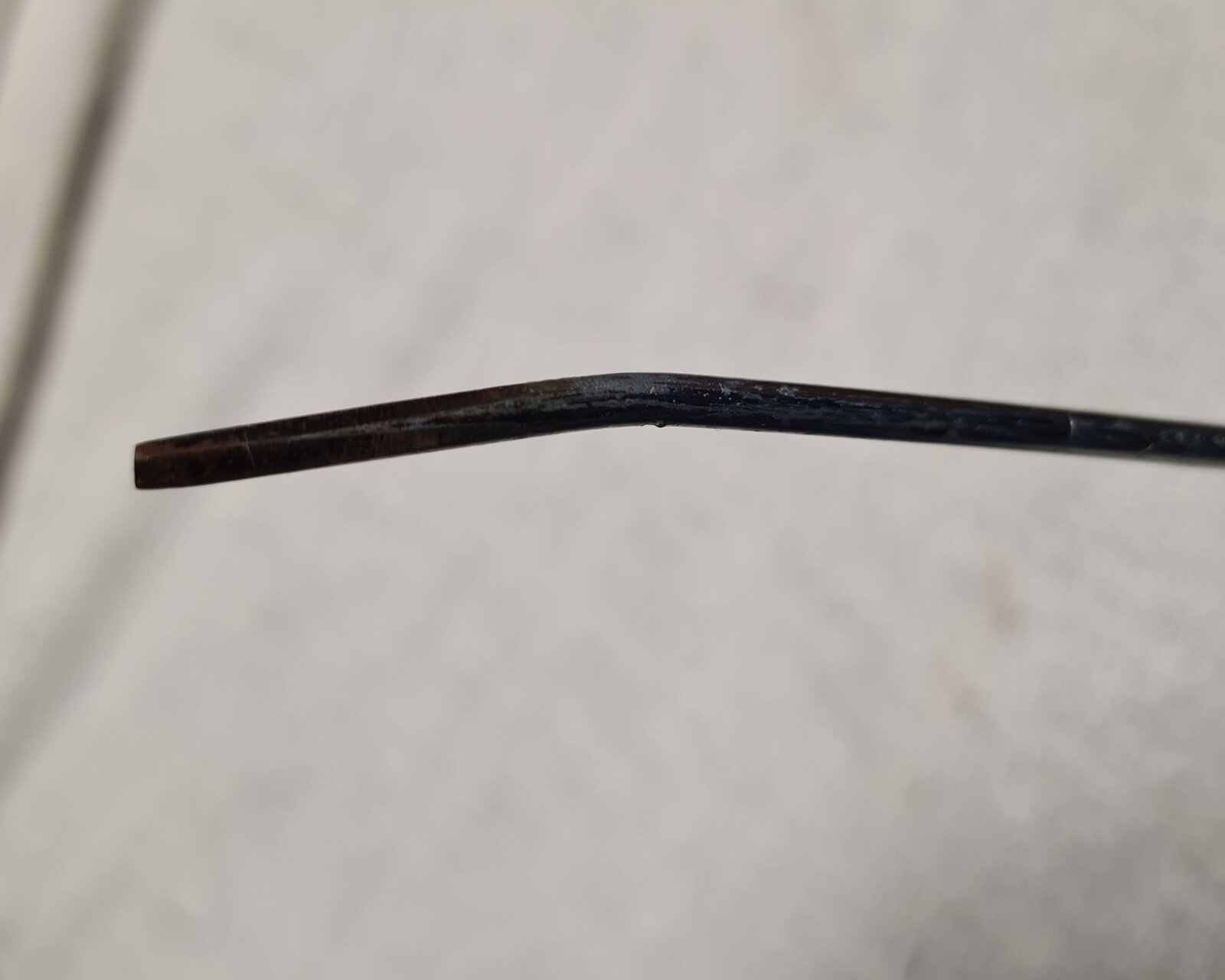

  1. you can make your own tool to remove the switch gear from the handle bars
    I just used a piece of wire about 2mm in diameter and filed the end in to a squarish shape to release the catch

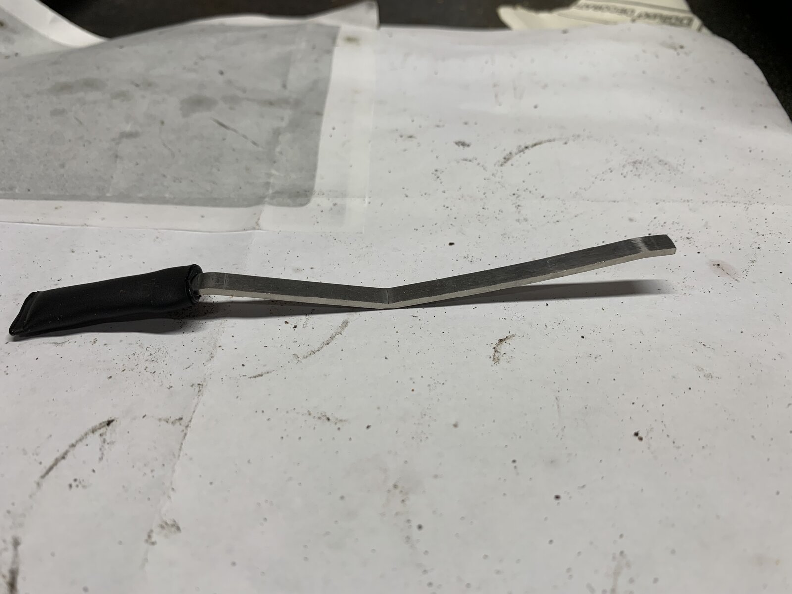

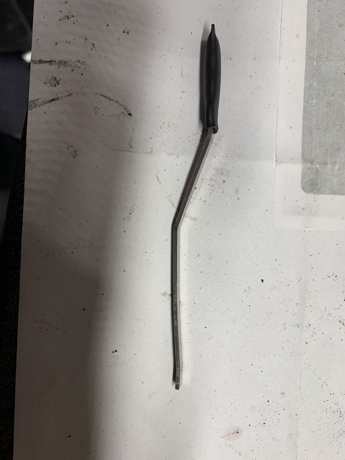

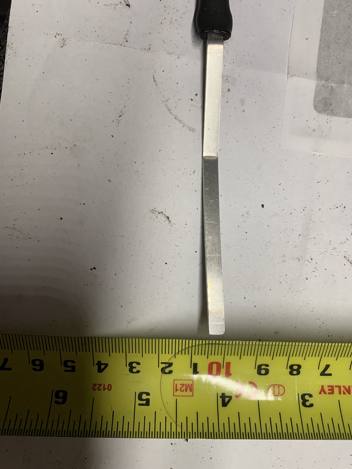

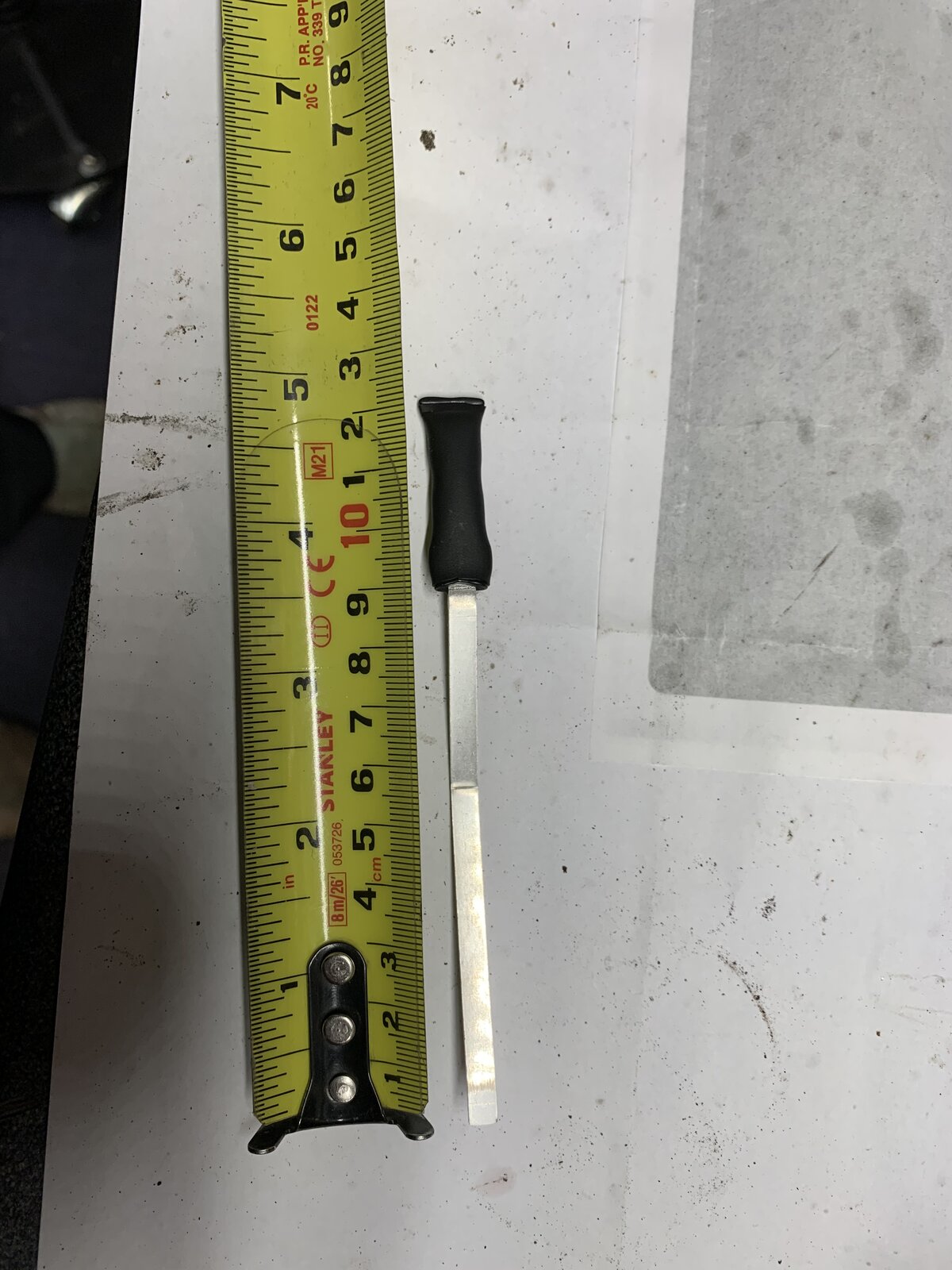

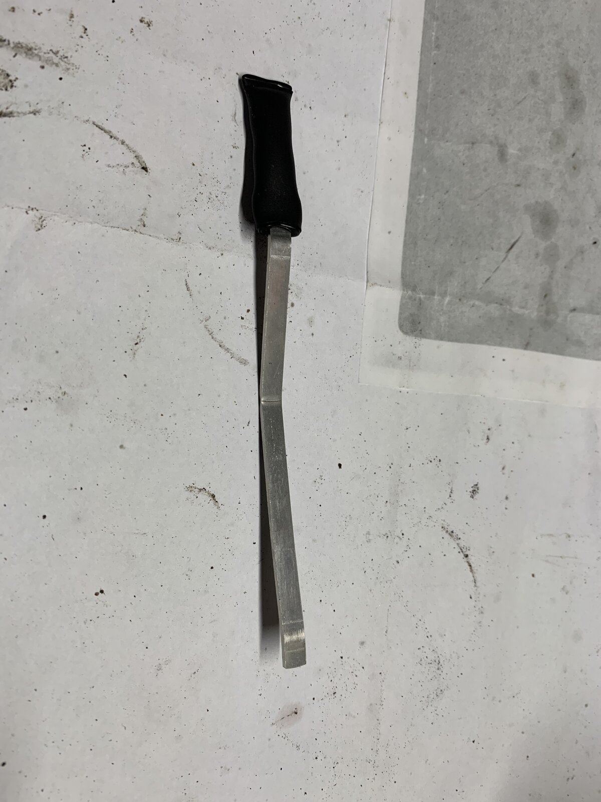

  2. Nope it’s a weird prong thing to remove the switch from the bars
  3. So some pictures for you
    It should in theory be simple to make a prong to do the job, it’s
    Not complex
