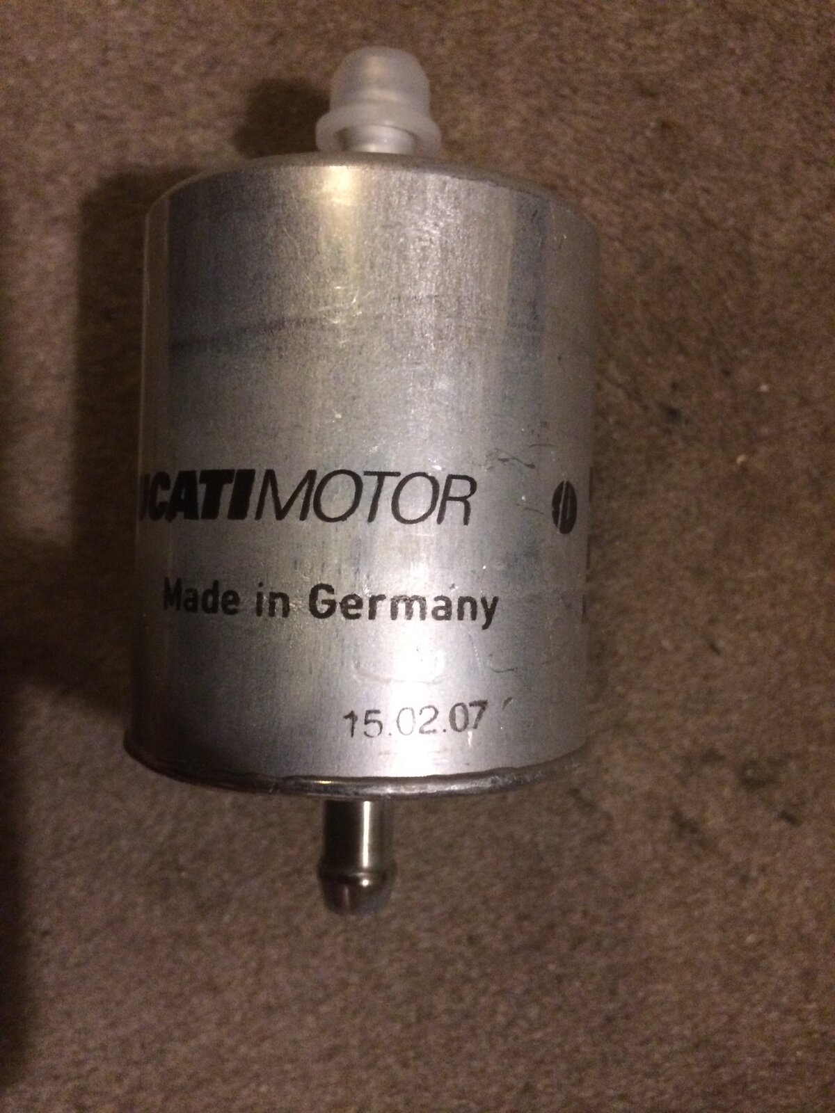

  1. I thought I would try for the hat-trick, but no such luck. Going by yous two there's another 4 years life in mine!!

  3. Looks like i've been over thinking mine at every two years change over period,i must fall into line with you lot & dig the old used ones out of the garage.;)
  4. You could sell them to us! We could halve the average age of filters in use....:eek:

  5. I think i've at least 3/4 in stock,flush them out & recycle is the environmental friendly way forward;)
  6. I have two new filters on the shelf both have 6/8/13 date on them, if i fit one tomorrow and someone buys the bike next week, then decides to fit new filters, he might be surprised to see the date and think I was telling porkies when I say the filters have just been done, so in some cases things might not be what they seem.

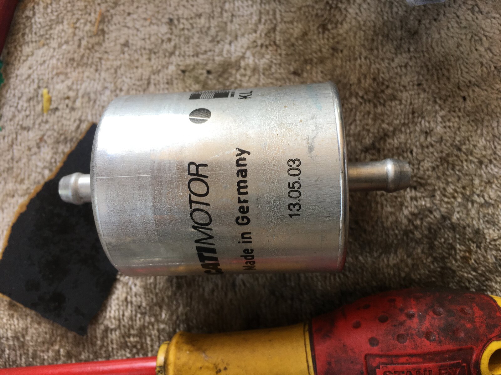

  9. Changed mine in 2017 because of a split hose as shown in the photo,
    03 again a good year for replacement
