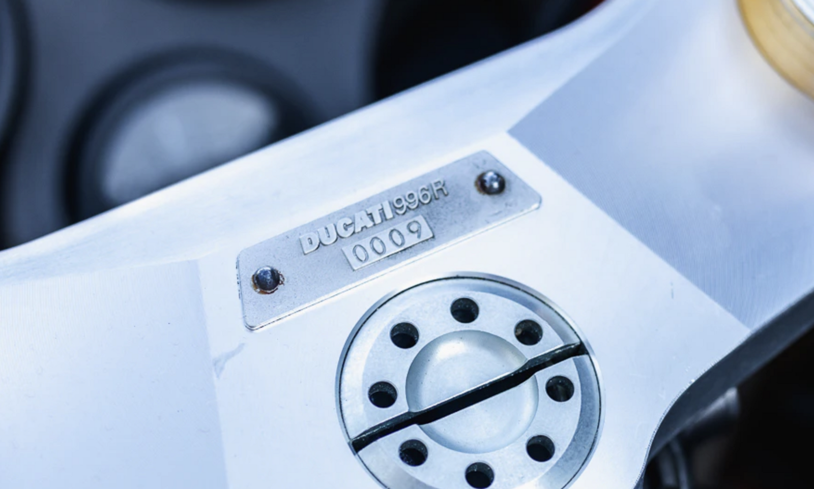

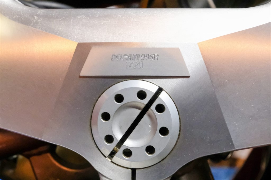

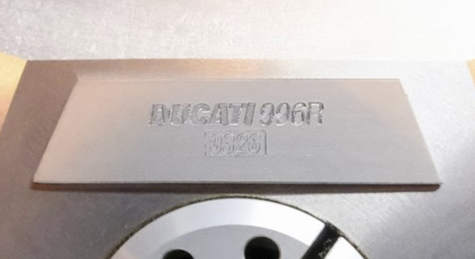

    Take this example
    And this is the numbered plate …..
    Now compare this to a real plate.
    Plates can be removed, plates can be faked (sometimes with rather more effort than the Sheffield example) so ultimately unless everything is spot on and Ducati can confirm identity - buyer beware!

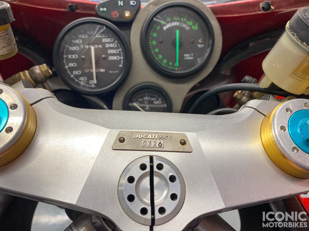

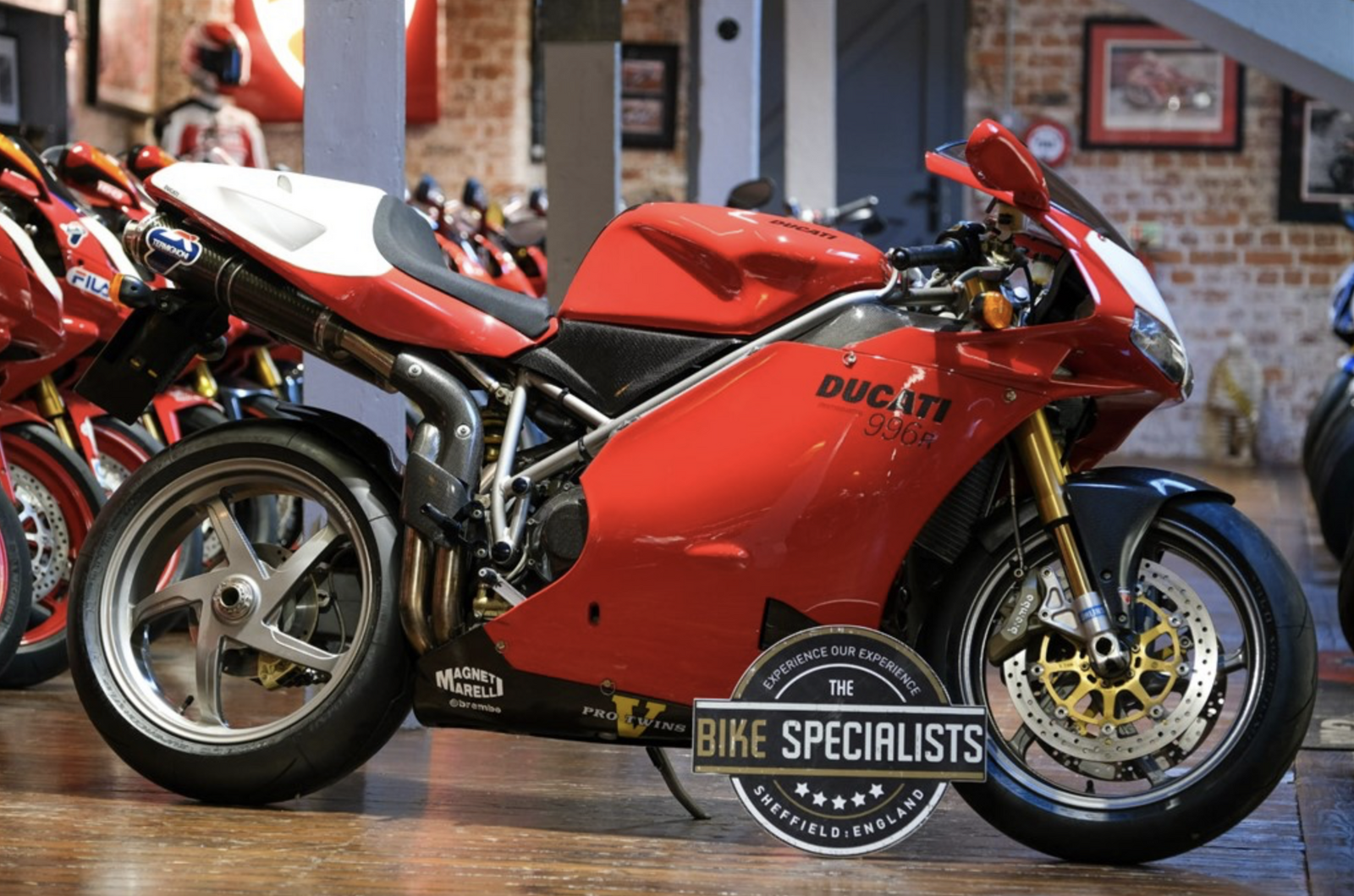

  6. I can do you one better, not only was the bike above sold with a FAKE plate, it was a duplicate, of course, of another bike's plate and I have pics of both the real and fake for comparison:
    The REAL 0326 is a JPN market bike and the fake one was represented as a UK market.
    • WTF WTF x 1
  7. Oh wow - how the hell did I miss that! :joy:
    So we can assume someone found the picture on the internet and just copied the number and put it on one of the unnumbered bikes!
    I would love to hear what the Bike Specialists Owner James Holland has to say about that!
  8. They obviously don't have the basic expertise for such things as I doubt they would intentionally bare themselves open to litigation for malicious fraud.
    But hey, it's like the big auction houses always say; they don't verify authenticity, they only represent on behalf of the seller - so buyer beware.
    Even the person who made that fake plate couldn't be bothered with even the most basic details in his copy.
    So the person who made the plate knew it was fake/fraud, the seller probably knew it was fake, the dealer should have known it was fake, and the buyer didn't do even a Google image search of due diligence. Absolute fu*king excellence right there.

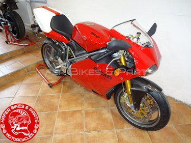

  11. On the subject of some of the final bits of unconfirmed information - I found this old advert - tiny cached image as the original ad had been removed.
    It was in German so I had to use Google translate - some of the translation isn’t quite right! It’s a shame the original ad has gone because the text says there was a copy of the email from Ducati confirming what it is, and the production numbers.
    Obviously this is a dealer so there’s the sales pitch to take into account - but it’s the first source to have confidently said that there were 500 numbered bikes and 200 not .
    We know that a large proportion of the 200 actually did get sold through the dealer network and put on the road so there’s some overstatement of the rarity. Proper race teams with the cash would have had the RS so I don’t think Ducati did sell a whole bunch of the unnumbered R’s to them.
    The other interesting statement is: The special thing about the 200 produced copies is that the engine was modified. The pistons were weighed prior to installation. The crankshaft/pistons/connecting rods finely balanced to create a perfect base. I have seen other descriptions mention blueprinting but this is a more detailed claim.
    What do you reckon @92GTA ? More sales BS or does it have some truth to it?
    Ducati 996R 700/ 700, the last example of this series produced. Hafer Bikes & Parts
    In an absolute lover's condition. Only 700 copies of this limited special model of the Ducati Tamburini generation were made worldwide.
    There were 500 pcs. with fork bridges - plaque produced for the road
    and 200pcs. for racing teams without triple clamps - badge but with the same street equipment. Of these 200 copies only a few found the normal way to Ducati dealers and were then sold to normal private customers. Ours is such a specimen. This can be understood very well on the Ducati computer excerpt as the first delivery.
    This generation is even rarer, since almost all of them have been destroyed on racetracks over the years.
    We had the vehicle data checked by Ducati Customer Service and received a certificate - see pictures. It confirms that this is a genuine 996R where the frame fin. and engine number belong together.
    So it has matching numbers. It also shows that 700pcs. were produced and that our copy has the engine number 0700! It is therefore the last produced copy of this series.
    A 925 silver fork bridge badge was specially made for this unique model - see pictures.
    An investment for every connoisseur, since this mod. has increased in price continuously in recent years. It is the bike that no serious collection should be without. It was disassembled, serviced and cleaned down to the last detail by our Ducati specialists in countless hours of work with a lot of passion in order to put it in a dreamlike original condition.
    It is accident-free, runs like clockwork and comes from one owner.
    A box with the user manual and inspection booklet/record is included - see pictures.
    German first delivery / registration.
    The bike runs fantastic and the engine TOP, a pure collector's vehicle.
    Pictures say more than 1000 words - a dream bike!
    ((Since we just received an inquiry about the speedometer. No, the speedometer glass has no crack, perfect condition like the whole bike.))
    tires / hi. NEW - timing belt NEW - oil / oil filter NEW - inspection / service NEW
    Valves have been adjusted / everything that works.

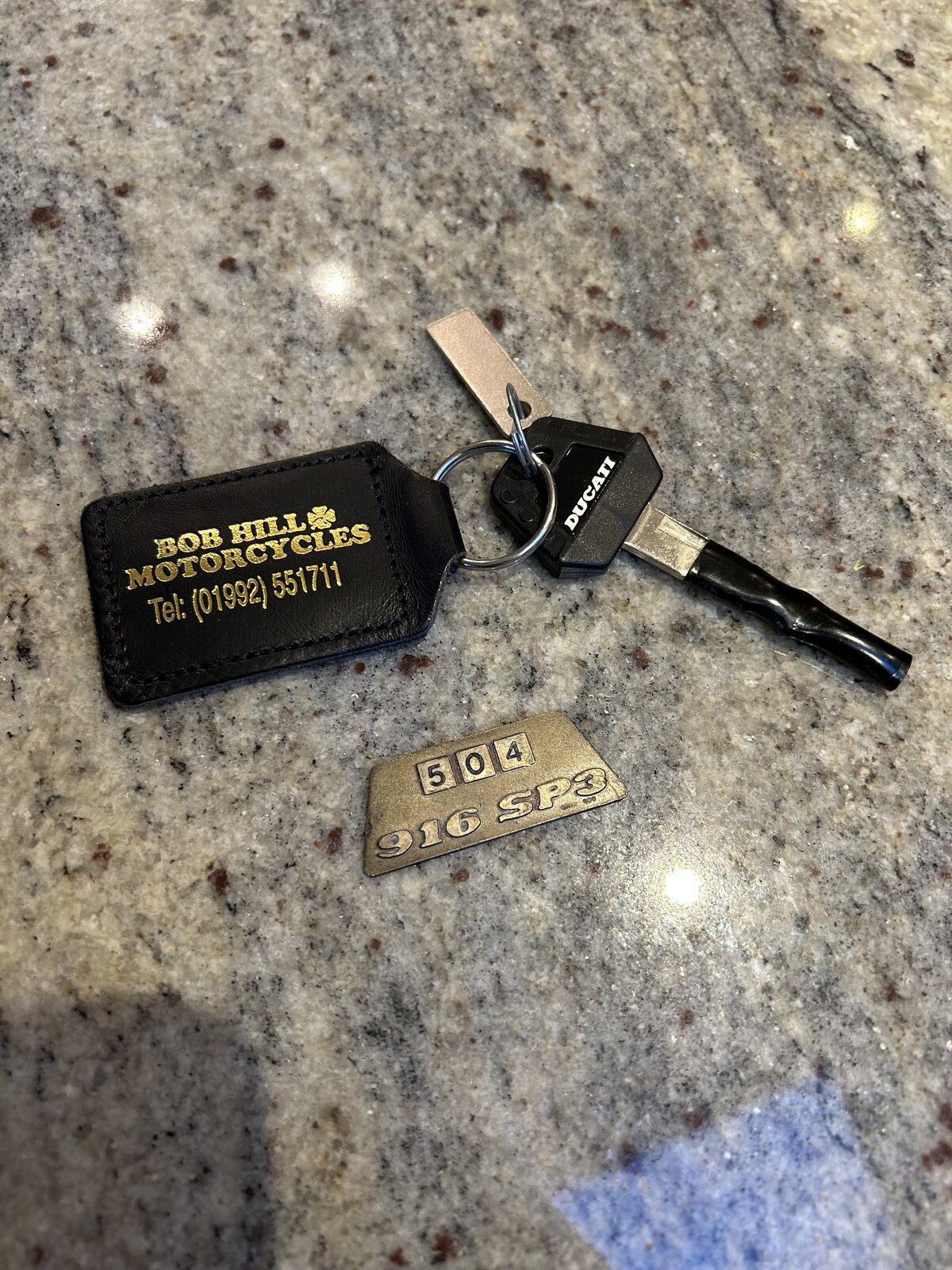

  16. Love all the commentary - makes a good read :) Just to add to the oddness of the Ducati numbering stuff, I have a 916 SP3 with plaque. Owned from new, verified, original spec, etc. The plaque number is 504. Always gets a discussion going given that 'records' state 497 SP3s were built...
  17. @KevB, would you mind sharing a picture of that plaque?
  18. That is a fantastic bit of info, thank you!

  19. Here you go. With the original spare key and fob from Bob Hill (now defunct!). I removed it off the yoke as a) I caught someone trying to prise it off and b) started a few debates I didn't need... They were only held on with glue so just keep it with the paper work.
  20. Now that’s interesting. It looks absolutely genuine (hallmarks et all) and silver too. And yep, glued. But that number contradicts everything we know about production numbers given by Ducati. Have you ever tried and asked them (WTF)? May be it’s a very special order sold to someone special ?
