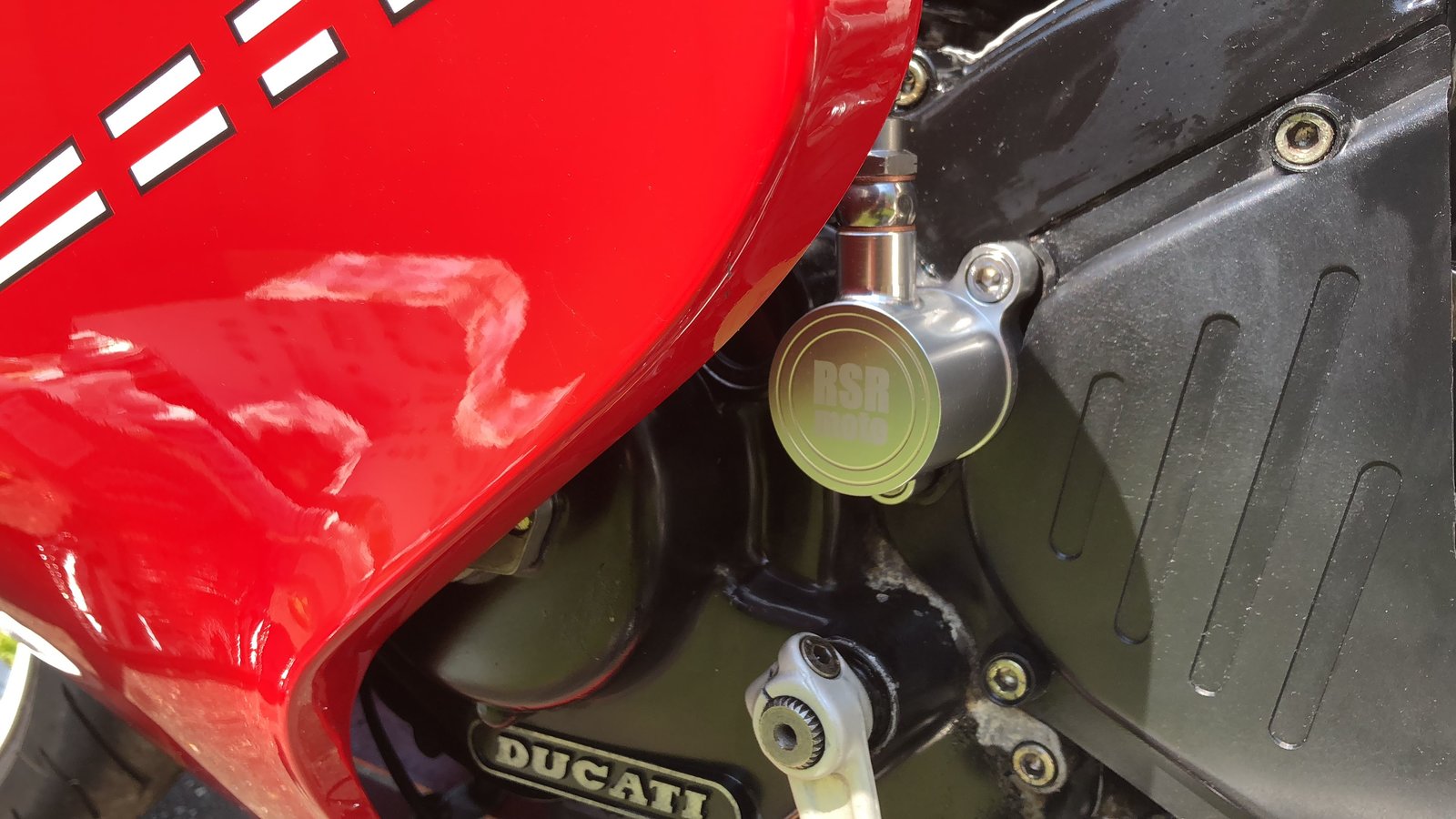

    • 900 SS had standard slave, swapped it for an RSR Moto one... slightly lighter clutch and is as good as the Oberon (talk to @richgilb about RSR Moto if interested. "He the man", as the kids say).
    That's my experience. Perhaps on 848 / 1098 / 1198 / 899 / 959 / 1199 / 1299 the difference is more pronounced. I'll likely put a grey / silver Oberon on the 999 when I get upset enough. Or an RSR Moto one as they're cheaper and look pretty much as good.
