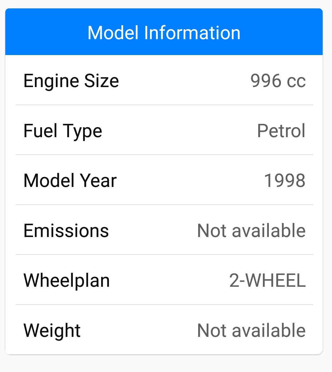

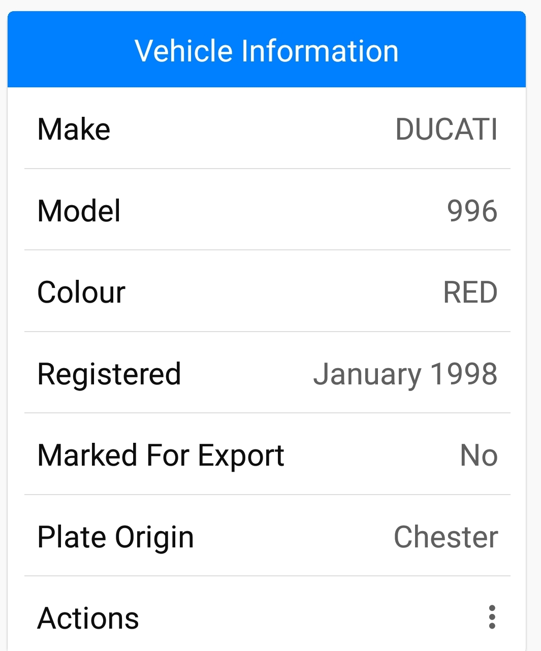

  6. Reg plate checker brings this up, probably should of said earlier....
  7. Air cooled ??
    But that's right 916sps's were 996cc
  8. '97 916 sps
  9. Or a 98 - they would have started 98 models around September '97 usually :thinkingface:
  10. tru, looking at the fairing it could be either, but jan reg will mean a 97 produced bike. think that went 996 sps tagged in '99. mine was a '98 and had the 'ducati' only fairing decal
